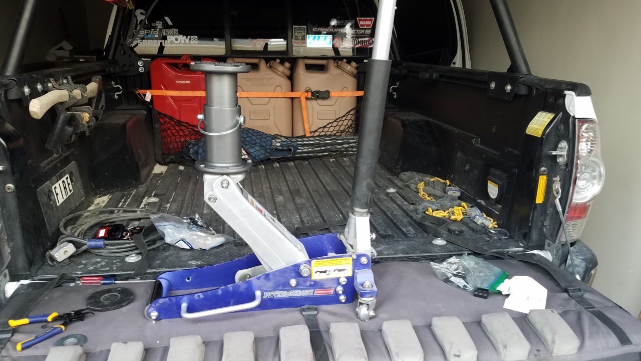

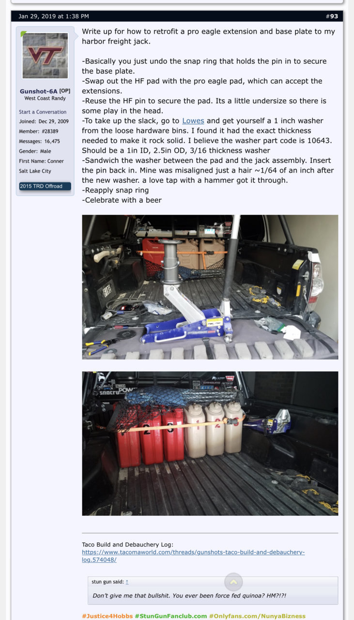

    The pro eagle extension can be retrofitted onto the Harbor freight aluminum racing jack. Pro eagle sells the extension for around $70 or you can build your own with some tube. Then I would build a belly skid so it doesn’t sink off road.
    Few simple steps and you have a “Poor” Eagle jack for around $150

    I have seen them on the web and wondered if the have a way to fasten to the jack or do they just sit on top

    through bolt and snap ring.

    Oh ok, it replaces the pad on the jack.

    correct
