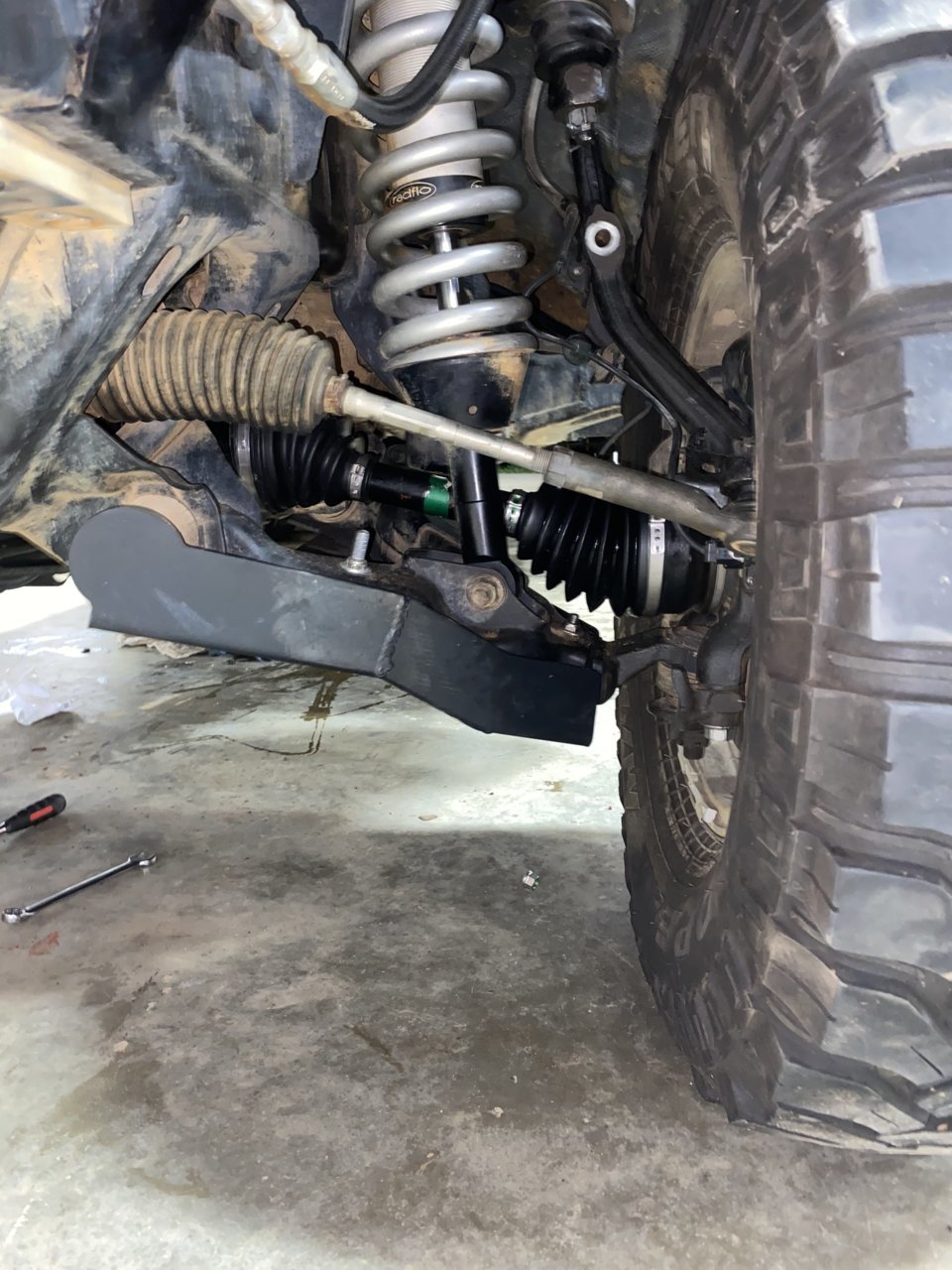

    Ha ha I actually didn’t get finished today still got a lot done but was helping otherGuys on their suspension as well. Front end is completely done CVs are in front driveshaft in swaybar is deleted LOL only thing left to do is wire it up and figure out my damn shifter situation.

    How do my cv angles look?

    Very envious of the radflo.

    On the steep side. You are likely lacking In the lacking down travel department.

    Like they rub.

    Looks like you are at or over 3” of lift. Reduce the preload on your coilovers a bit and it’ll be all good

    I’m at 2.5 :anonymous:

    I’ll just do a diff drop most likely idl don’t Want to go any lower

    I’d advise against the diff drop. They leave some low hanging fruit and could cause more problems than they are worth.
    the less lift you have (or can get away with), the better off you are off-road.
