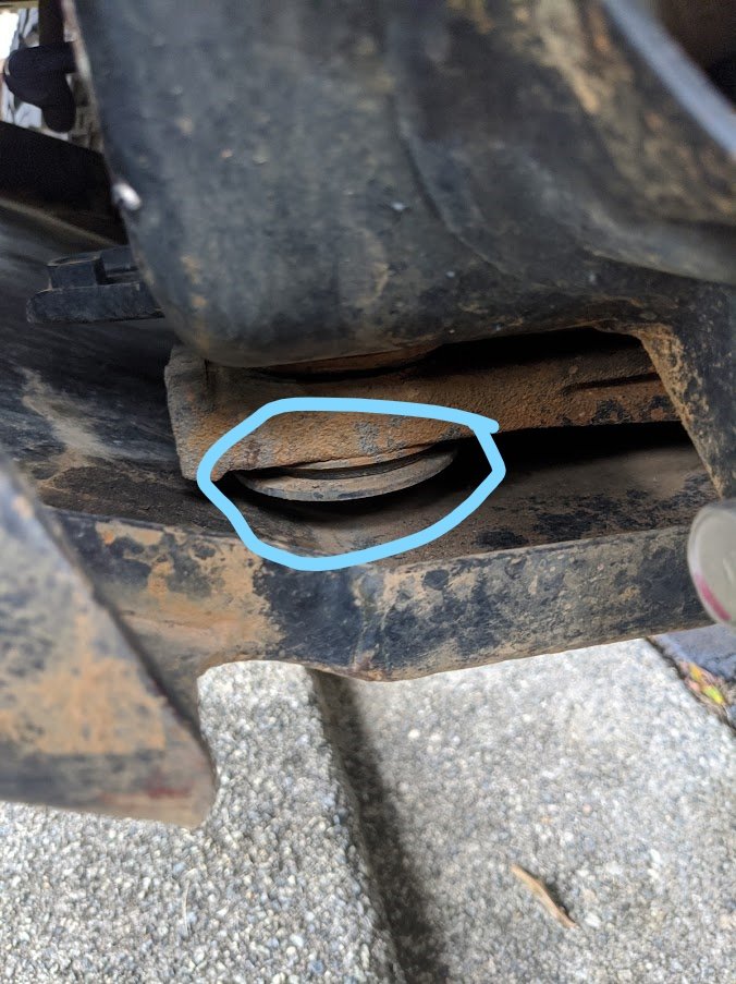

    I got a pic of mine working on some horrible Skip photoshop work on circling what it is I think happened and what you need. Computers are hard :anonymous:

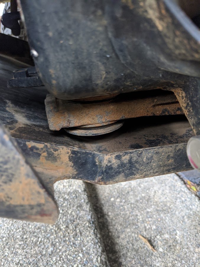

    Stock, they had brand new boots :(

    Ok so here you go @Brian422 . Like I mentioned in the coppinger cove thread it looks like it was missing a big washer of sorts on the underside. Now if this P/N has the washer built in I have no clue. I thought it strange for them to not have a failsafe catch of some sort in case of bushing failure so this wouldn't happen because it could potentially be extremely dangerous locking a wheel up or something.
    Your pic doesn't seem to have a metal washer mine does.
    Here is the part I think is supposed to be the metal washer to prevent this it's called a lower mount stopper
    https://www.toyotapartsdeal.com/oem/toyota~stopper~differential~mount~lower~41654-04020.html
    Red Mountain, nagorb and Brian422 like this.

    This is what it looked like.

    Yeah you're missing those cups I posted. I posted a link to a parts place you can buy them or search for them and maybe find them cheaper but you need them too!

    Idk what you mean by metal cap but it does have some sort of metal piece as you can see it still attached in that pic.

    Anyway you could get a pic of that washer thing from the underside?

    Yea I was missing that. So that was the issue. Also it looks like that bushing was captured inside the mount so I have to buy another mount as well. I need a go fund me at this point.
