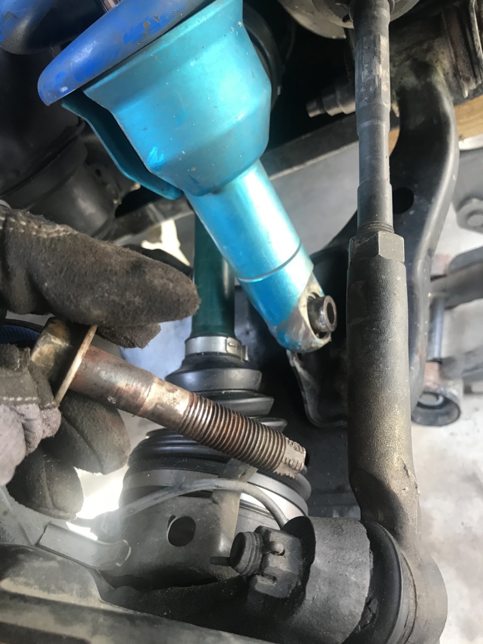

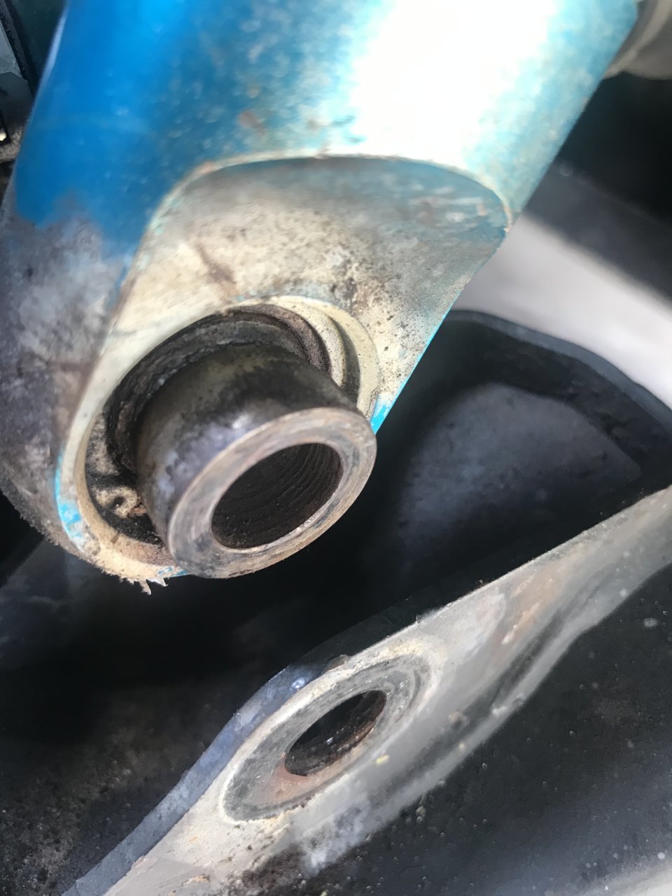

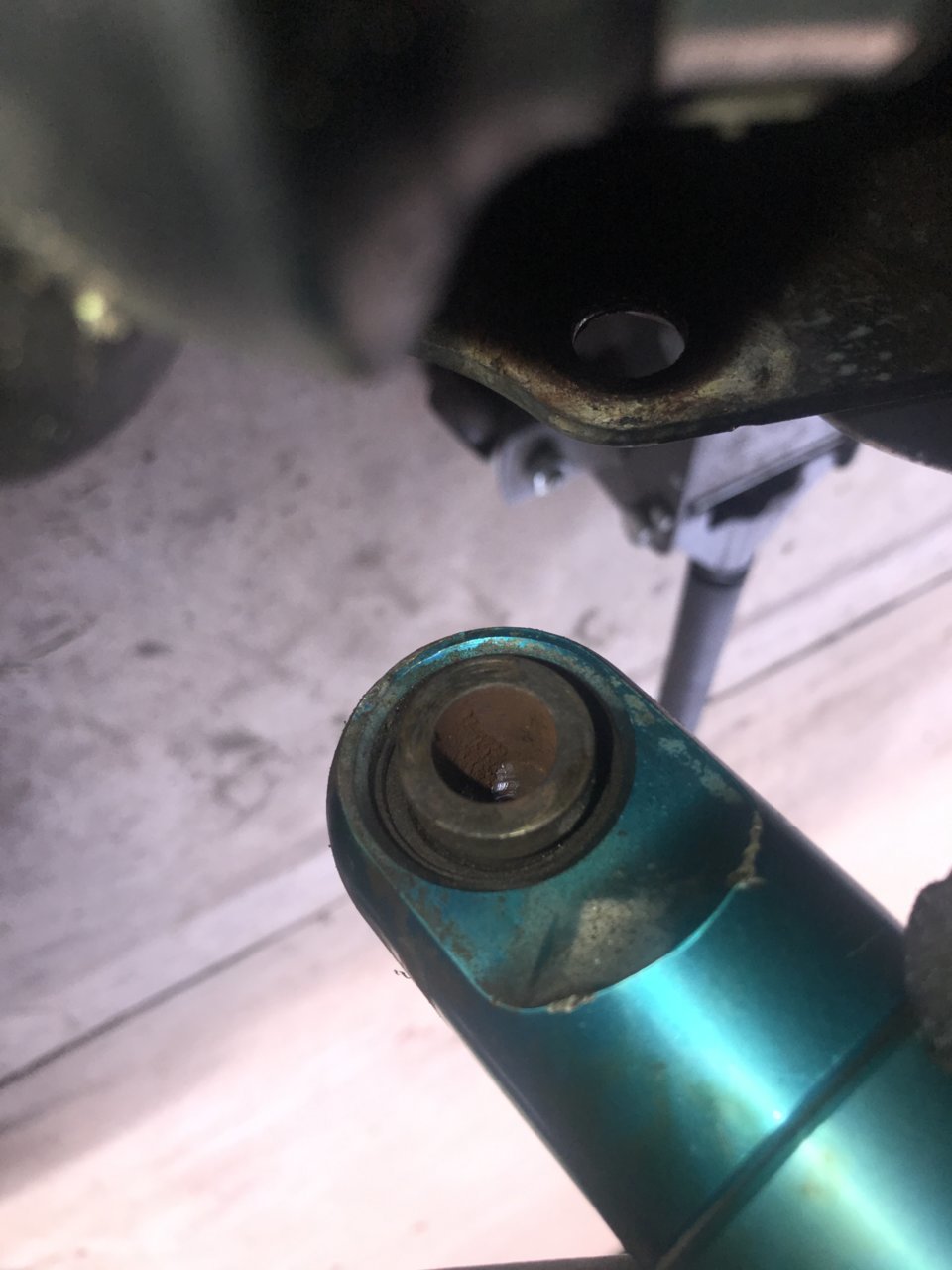

    Okay fellas need some help here I think I identified my problem but not sure, my thoughts are since this lower shock mount isn’t moving it’s froze up in turn making that lower shock bolt worn away so I’m thinking replace that and the bolt? No play but it will not move at all uniball seems tight no play.
    Nevermind lower mount moves is tight but uca front bushing has some movement think that’s it.

  15. Aug 23, 2020 at 8:30 AM
    JBTacoma
    JBTacoma Well-Known Member
    Feb 16, 2015
    #148844
    11,118
    Jeff
    Cullman Alabama
    2000 SR5, 2003 Double Cab and a Suzuki Samurai
    I have replace the bearing twice in mine. But I do run through a lot of water and mud. Was the bolts loose? If they are tight they shouldn't wear the bolt.
    They are hard to turn by hand, stick a screw drive part of the way in them for leverage and see if the move
    Try not to damage the spacers on each side of the bearings. They can be reused.

    Cred92
    Cred92 PAID4MOD
    Aug 29, 2015
    #162952
    2,634
    Caleb
    Jasper Al
    Indigo Ink Sport DCLB/White RC I4 5MT
    BLACK AND BLUE STUFF
    Nah the bolt wasn’t loose still gonna replace it from wear, I did put a screwdriver in and they move and are tight just nasty. But I have considerable play in uca front bushing need to figure out how to post a video.
