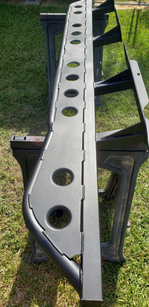

    I used Restoleum primer and paint and then that spray on bed liner :D

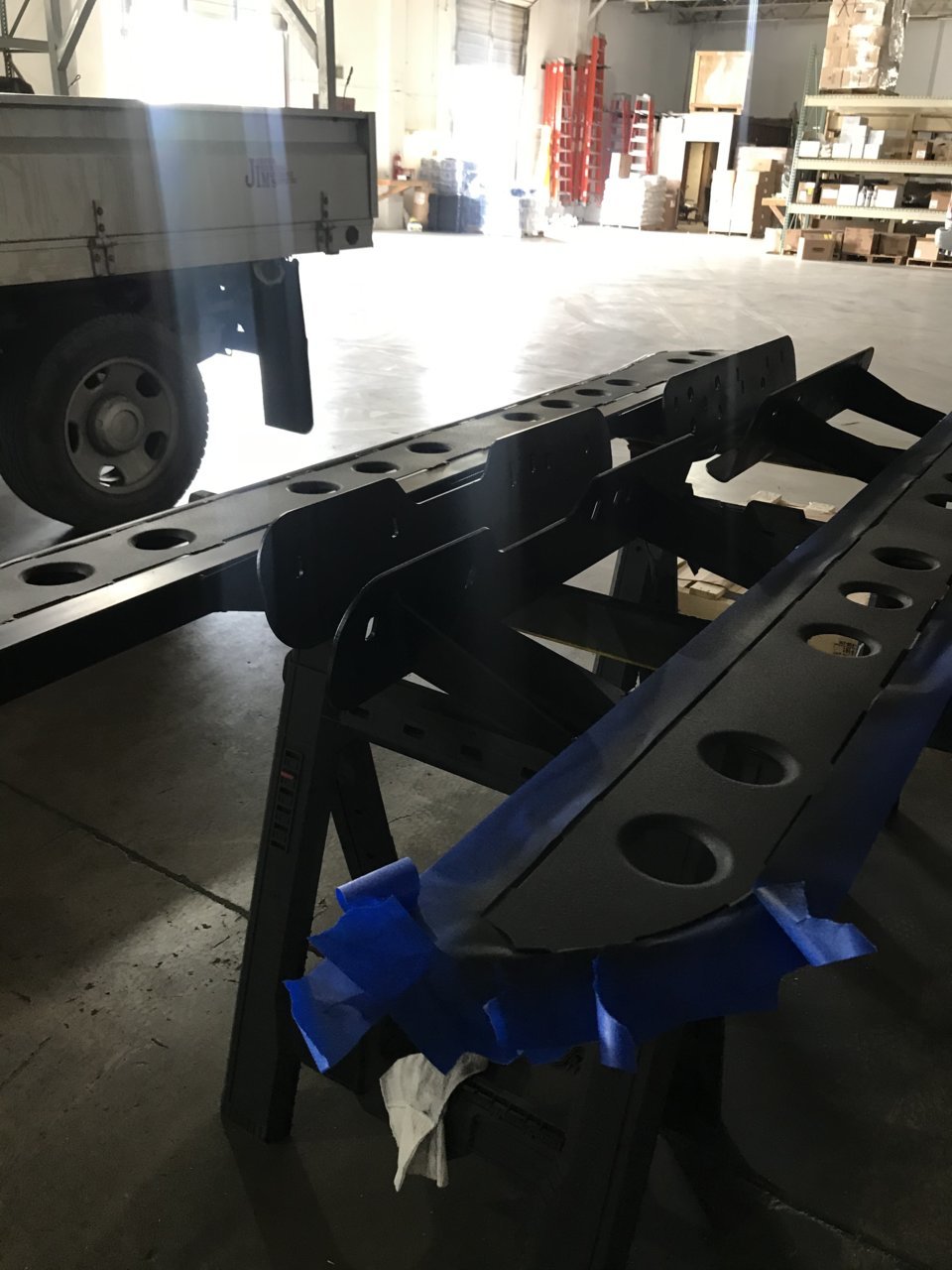

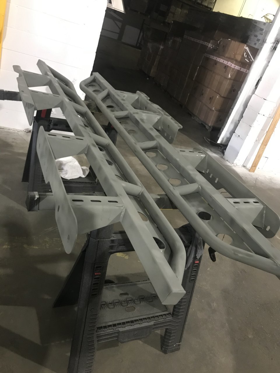

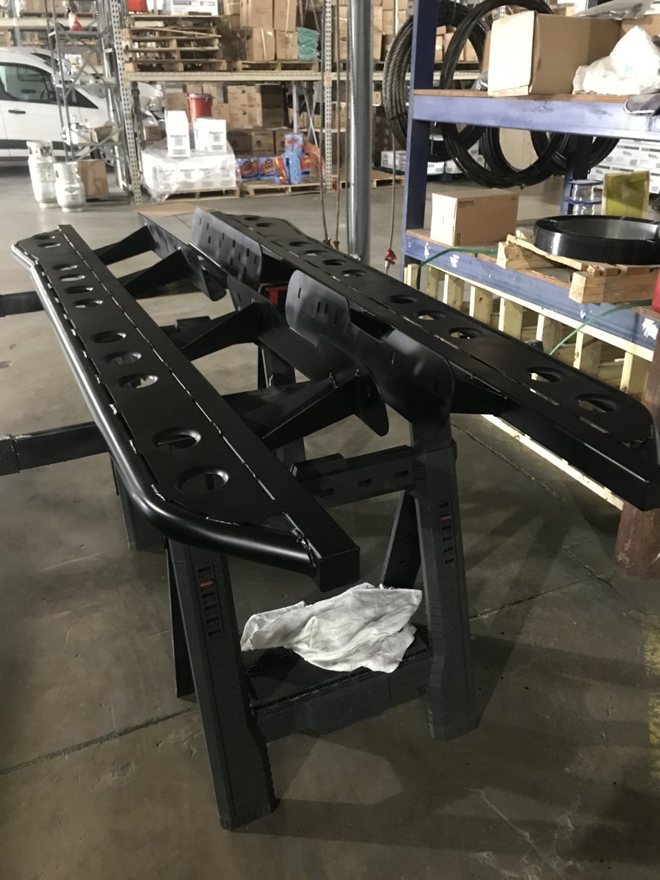

    I’m the same as everybody else used rustoleum self etching primer then semigloss black, then I taped off the filler plates and used duplicolor bedliner I’ve had way better luck out of their bedliner than rustoleum and quality. Also took more cans than I thought 3-4 primer 3 black.

    I honestly just painted until I liked the coverage. I went with bedliner just to give it some grip. Damn things are slick as greased owl shit when wet if not. I use mine as a step too :D

    Yea I started to not bedliner the fill plates but am glad I did helps a lot. I have busted my ass just on the slick outside tube without bedliner vs some very low tread crocks :anonymous:may or may not have kinda f’d my back on that one lol.

    I'm glad I bedlined mine. It gives just enough grip.

    Did I mention I like those sliders they look familiar :thumbsup:277D109B-FFE1-49AB-8B35-8D0DD42B626C.jpg

    Me too I wishd I had a better picture to compare your main legs are square tube while mine are bent plate angled wonder which is stronger?4E510AE1-F6F9-4119-923C-5D00CB7A53CB.jpg

    I have no clue. I can say I spent A LOT of time on mine in Moab without any issues :rofl: My heavy ass truck with stock suspension did a lot of scrapping out there. You gotta think they're all pretty much the same though.

    Those main legs look like they would be a nice place for mud and rocks to collect. Who made those?

    Nevermind, I see that they are SOS by the rear kickout. I didn't realize they made their legs like that.

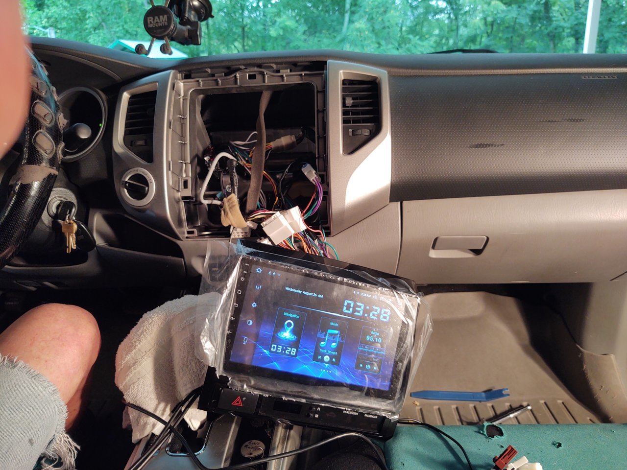

    So got everything hooked up and everything works (GPS, radio, WIFI, Phone/Bluetooth, Navigation, mobile hot spot) except steering wheel controls. In setting somewhere. Crazy amount of stuff to play with and download. IMG_20200825_152934763.jpg

    Yea I figure their all strong, I haven’t drug these yet but that long bed life makes it more prone.
    Those are sos they’ve got drain holes in the middle I just wonder why the switch from square tube?

    Looks good
    That long bed, stock suspension, bloated pig life is where I was at :rofl: :rofl: :rofl:

    Sup Phillip. Hopefully my last major mod (probably famous last words).
