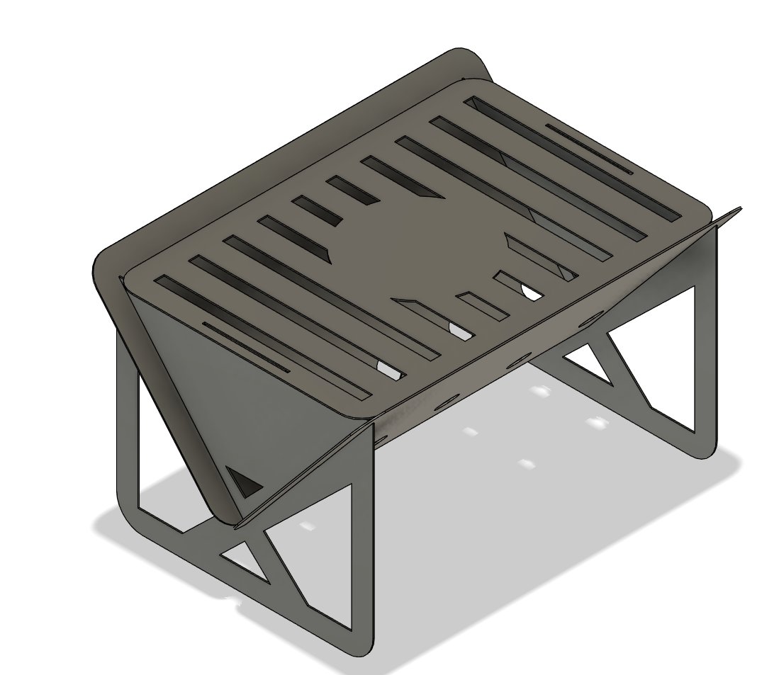

    So, new ideas and already a v2 before v1 was tested lol.
    Anyways, hope to cut one out this weekend.
    Now has the side useable as handles, and bolt holes through every piece to hold it all tightly together. Also changed top to not just be long slits and more supportive.

    I'm thinking these could sell once I figure out a decent price point.

    Oh dude I bet they will. It looks cool

    Ummmmmmm if you could tab the pieces so it can pack away flat that thing would be killer especially with the grill grate!

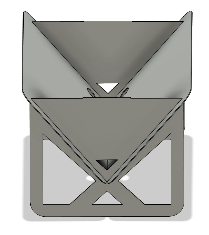

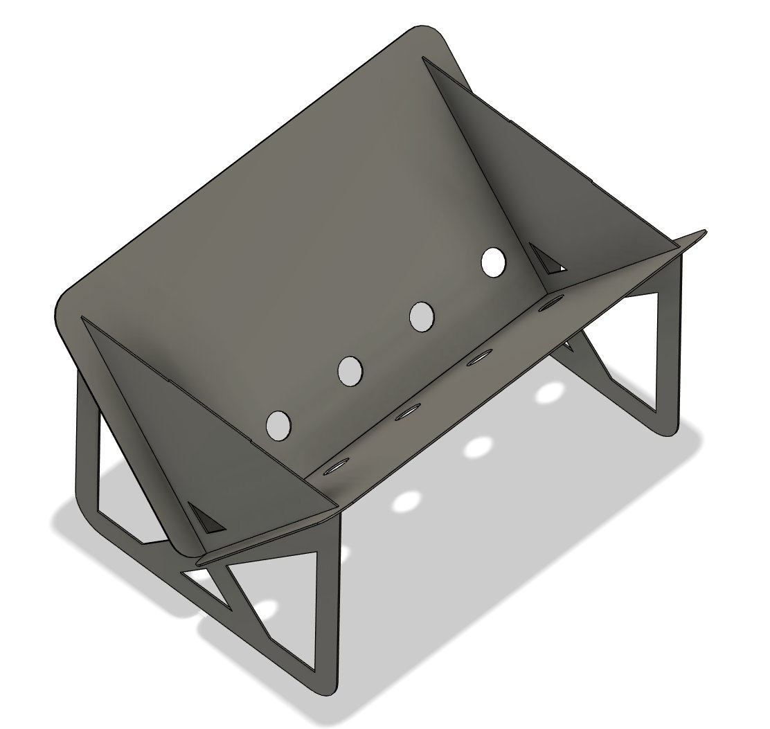

    It's a slip together design

    Haha, I'm still changing things. I want it to be sturdy and light.
    Hoping this weekend.
    It's cooking area is 17x11.5 inches. Can hold wood up to 16" and about as deep as 10" or 8" or so since you don't want the wood or charcoal touching the top plate.
    Should weight just under 20lbs.

    what thickness steel?
  19. Dec 2, 2020 at 8:33 AM
    whitedlite
    whitedlite Well-Known Member
    Jul 14, 2016
    #192033
    9,323
    USA!
    3RD Gen TRD 4WD
    I'm thinking 14G, probably test rigidity and go from there.
    I looked it up and most Webers and such are made from 18G or thinner so should work fine, and especially since these "overland" grills don't have ability to be smokers.

    Cutting team emblems out of side plates would be awesome too!
