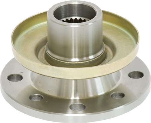

    Do you know anything about the solid spacer they have as an option?
  11. Dec 17, 2020 at 12:09 PM

    Yes upgrade to the solid spacer. I did

    Double drilled flange?

  14. Dec 17, 2020 at 12:40 PM

    All that means is it has 8 holes in the flange for the mounting bolts. One set for 8 inch ring and one for 9.5 ring is the most common.

    All new to me. Is one better than the other or specific to what I need?

    No need for double drilled, just order for your year and model unless you are using a different driveshaft. Where are you ordering from?

    ECGS, stock driveshaft. Not sure why they have the option.

    The option is for people like me that has an 89 Land Cruiser rear axle hooked to a 94 4Runner front driveshaft and a 85 4Runner front axle hooked to a 84 Toyota truck rear driveshaft, all in a 88 Suzuki Samurai. :rofl: It gives you the option to move things around if needed.
    If you are wanting to buy call ECGS and talk to one of their techs, they do this everyday and can and will answer all your question and will tell you what they think is the best and why it is.
    It will be a lot cheaper to send yours in for new gears than it will be to build one.
