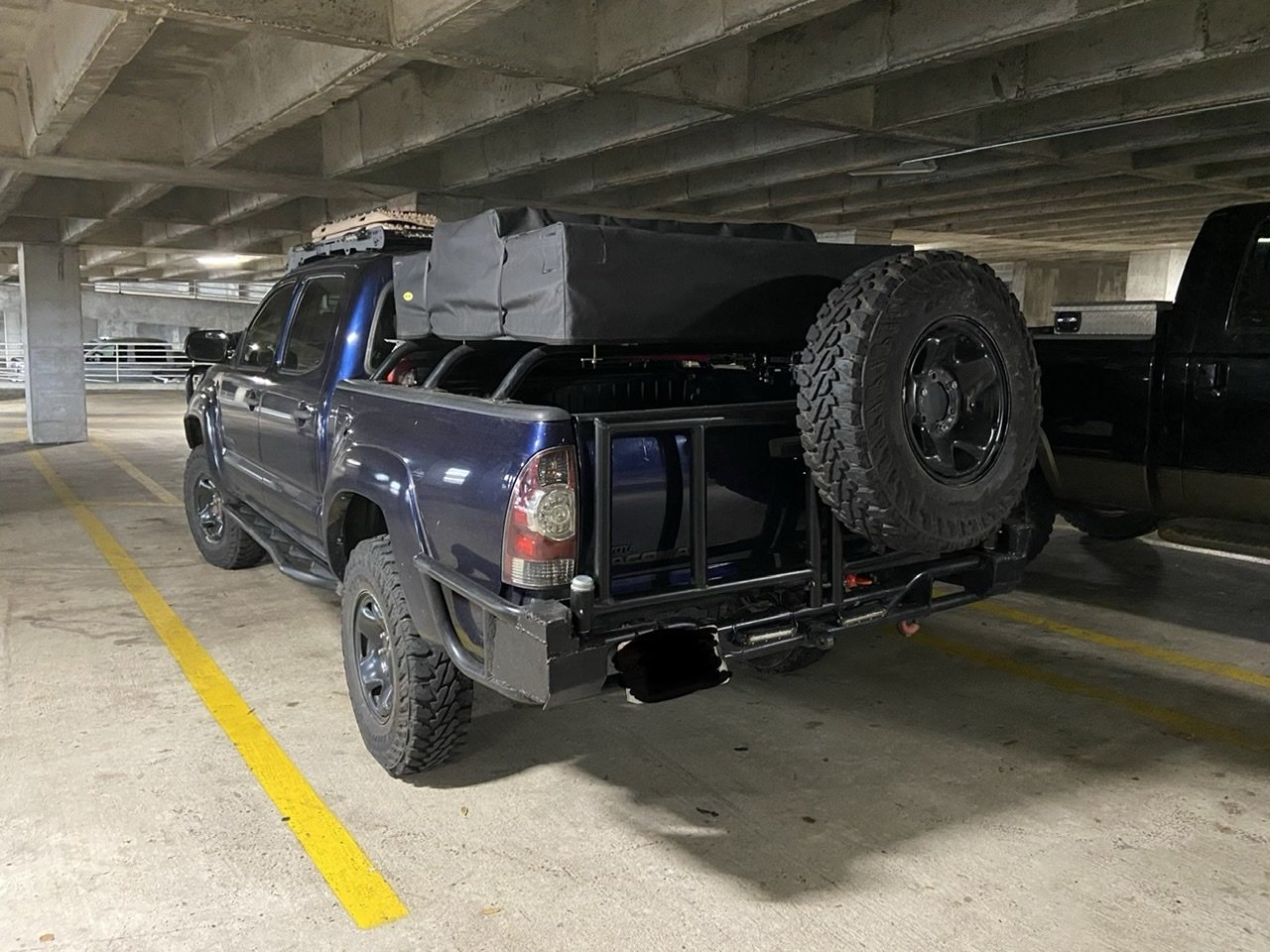

    Nice!! Earns my DYF seal of approval :cheers:

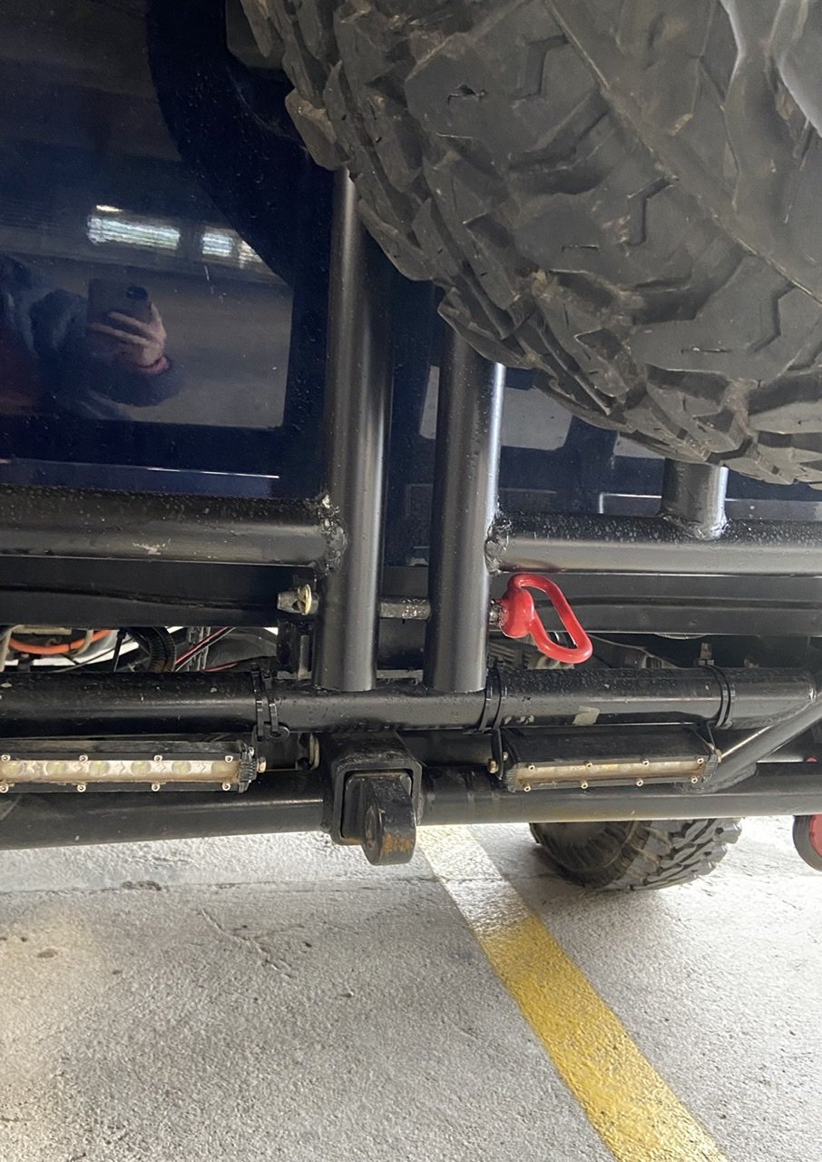

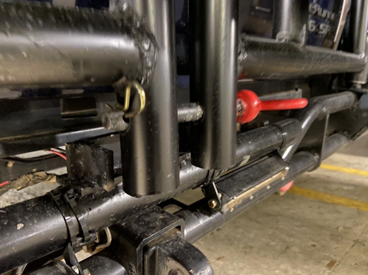

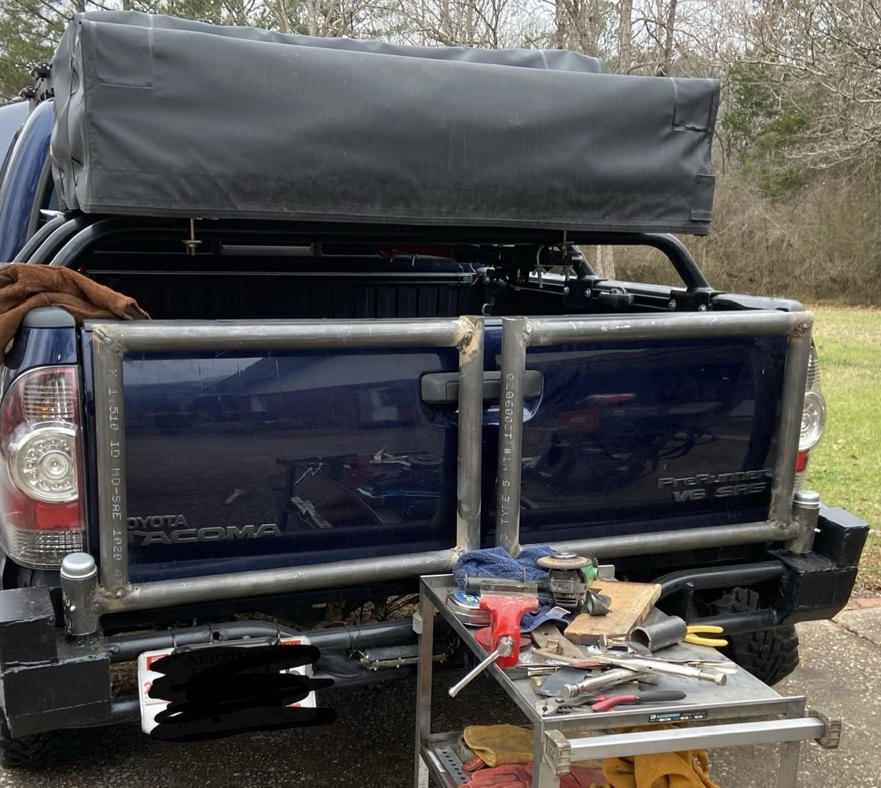

    As for the wobbles you could do two pins, or lower the pin location and put a tab up from the bumper between the two swingouts, pin goes through right swing, bumper tab, out the left swingout. Clearance with the tailgate will be the issue. Could holesaw some clearance into the tailgate tho :cheers:

    Ooo I like the tab idea! Think I’ll try that before anything else. You the man:bananadance:

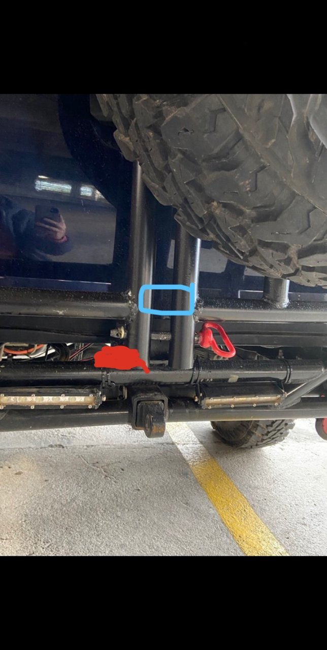

    You need to weld on a piece of flatbar on one side of the swing arm and a rubber pad on the other swing arm were my blue mark is. Then where the red mark is coming around the side weld in one of these latches. Behind the swing arms weld in a stop plate with more rubber pads. That way there will be tension on the swing arm and it wont rattle. Looks like you already have some sort of stop on back side
    POWERTEC 20306 Latch-Action Toggle Clamp, 2000 lbs Capacity, 40341 https://www.amazon.com/dp/B004K5YW0K/ref=cm_sw_r_cp_api_glc_i_nJgaGbCTYFXG1

    Or you could just leave that pin in and weld the latch in with the stop pads.

    Good idea, pics help me visualize it better. I think I’m gonna try to put a tab in the middle and see if that’s enough. I do like the idea of having tension on it tho, that’ll be my plan B

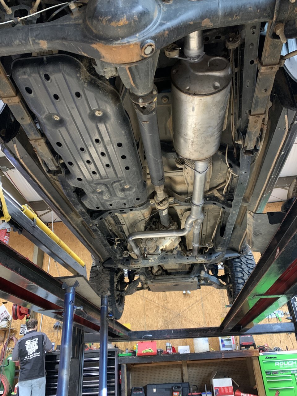

    Need some advice. Going to The Exhaust Shop in Pelham to get exhaust reroute done Monday. Think I’m going to ask to run the pipe behind the transfer case as I have seen in many pictures. Any downside? Skids from most places can still be added later if needed with the pipe there right? Amy other ideas that work better? Thanks for any advice.

    This is what I did. I added a heat shield (not seen in the photo) to keep some heat from the exhaust out of the TC.

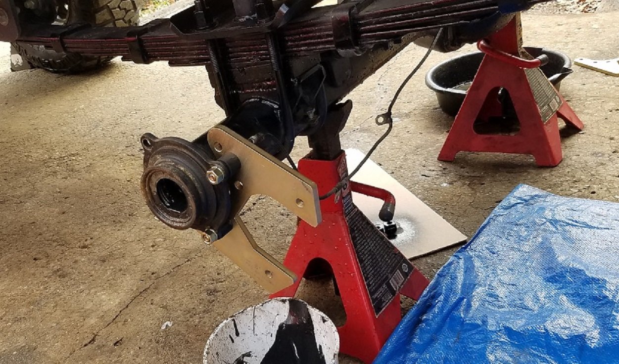

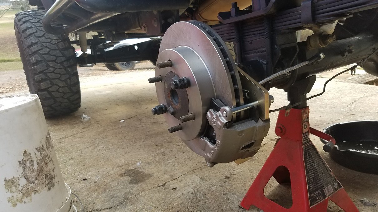

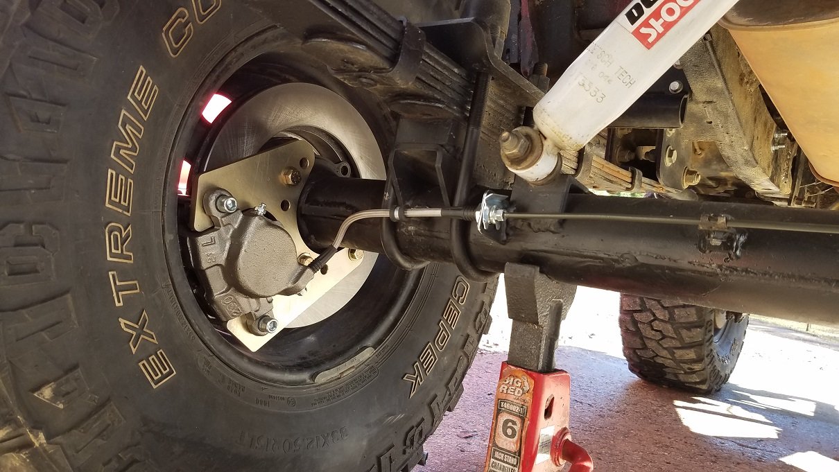

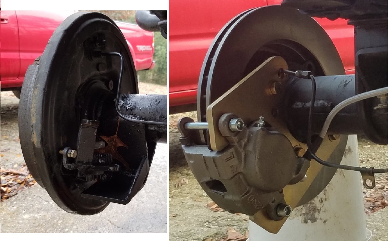

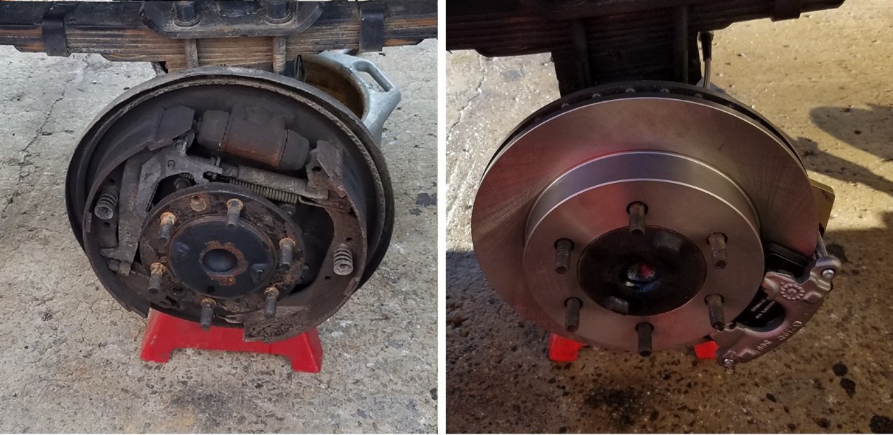

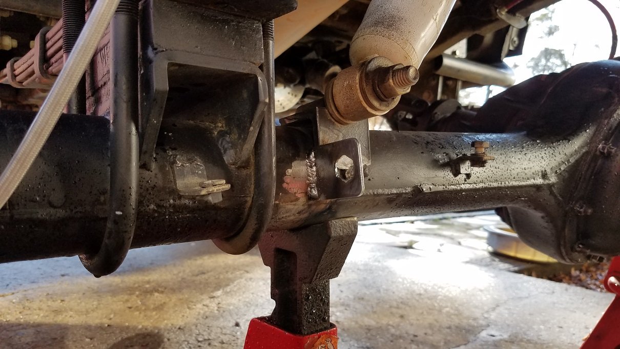

    Got the disk brake conversion finished, still have to install the proportioning valve.
