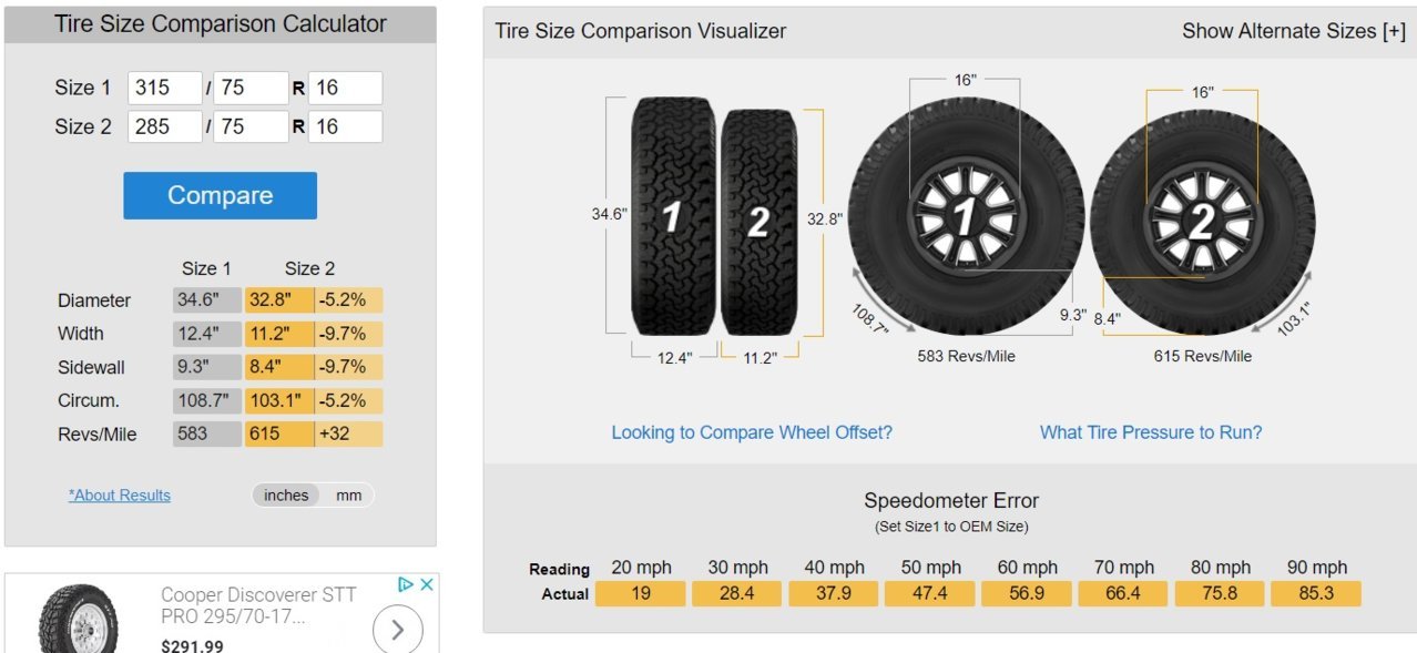

    You going two inches taller and an inch wider?

    More like 1.8 and .8 but throwing the idea around in my head :sawzall:

    More like 1.8 and 1.2, the extra width will cause issues

    I had nitto ridge grapplers that were 11.8 wide on a -24 inch wheel before my tires now that are 11.4 inches supposedly but seem thinner than that. My fenders and cab mount chop was done with those tires on and my tires cleared even offroad on the frame. It only rubbed on the plastic. My front is only about 2 inches of lift right now as well. Very little preload. Plus my spc still have a *of caster i can add to them to help. Between cutting and lifting .5 more inches and adding more caster i dont see it being a problem at all. My tires now dont even come close to rubbing even with 1.25 wheel spacers.
    Not saying it wouldn't happen though haha.

    Lifting your truck will only change where you sit within your suspension travel. If it doesn’t fit with 2” of lift it won’t fit with 2.5” of lift. But you are on the right track with more cutting, lol.
    that 1.8” will make a big difference. If you don’t want to tub and cut more out of the cab mount, you might not want to get 35s.

    I think i can make them fit at 2 inches. Lifting was my last resort anyways. I like how my truck rides with 2 inchs. Honestly cutting and caster change with the right alignment would probably be the best call. But then again lol idk. Ill probably end up with a 34
