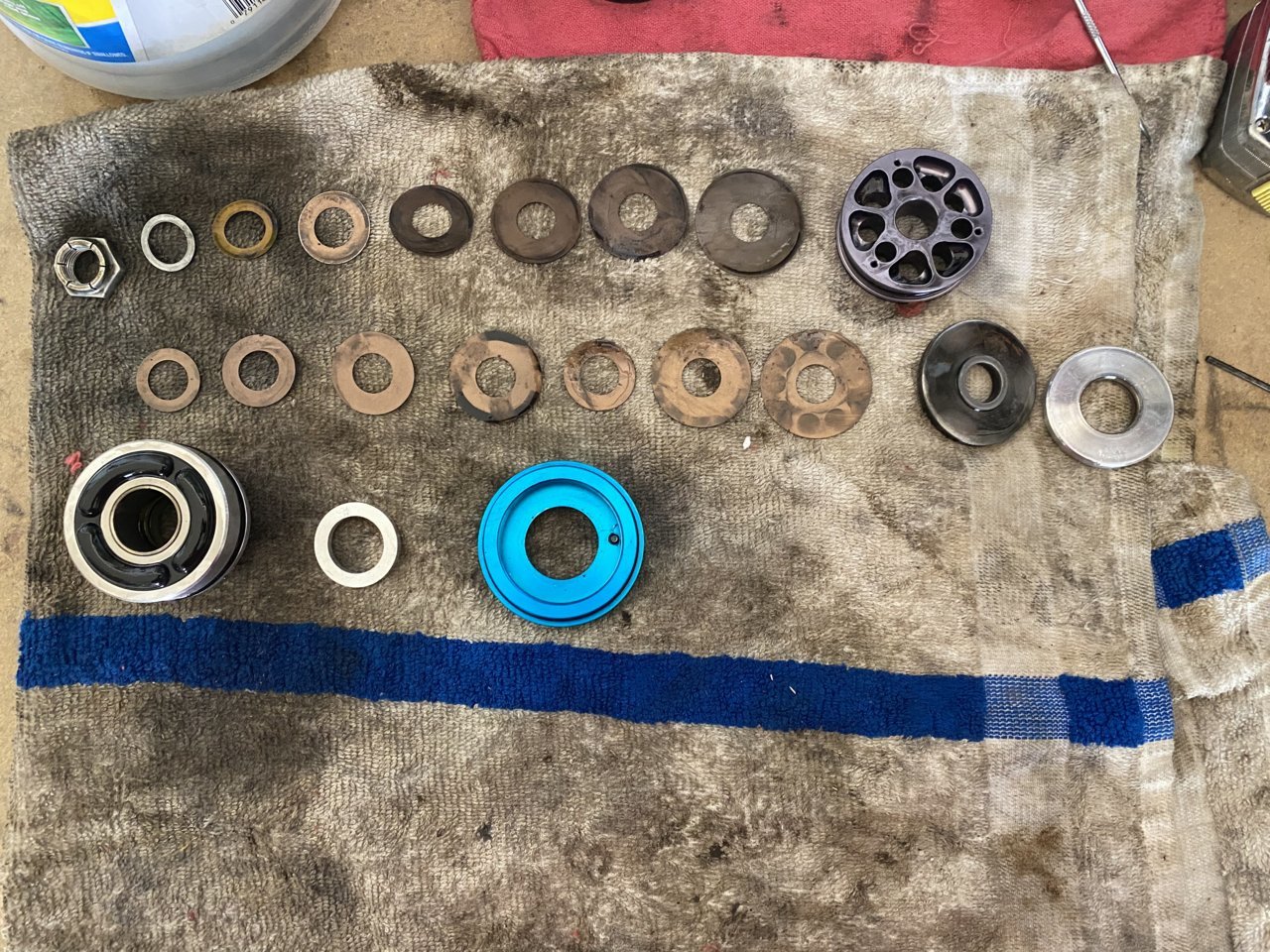

    not on the fly, I haven’t studied into tuning enough to be able to do it like the shock companies can. But if you got the specs or custom ordered the valve stacks, I could install them for you. Might be able to get it from accutune.
    This is what my king coilovers look like taken apart. All of the gold shims in this picture make up the rebound and compression valve stacks that sit on either side of the piston and control how the shock fluid moves through it via bleed holes. Changing this is basically what tubes a shock. There are other factors that come into play, such as the nitrogen pressure as well.

    I didn’t know you could order just the shim stacks for a specific tune, that’s good to know. Mine are riding much better since I added weight. I think I was oversprung and the shocks weren’t getting a say in much. Will probably wait and tune when it’s time for a rebuild.

    I’m not saying 100% that someone will sell just the stack, but they might
    maybe they can guide you in the right direction with these.
    https://accutuneoffroad.com/product/king-2-0-2-5-valve-stacks/
    @AccuTune Offroad ?
