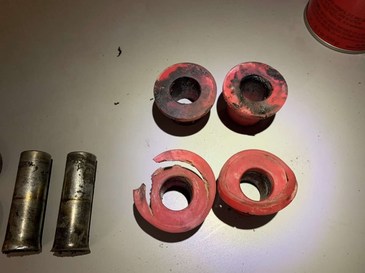

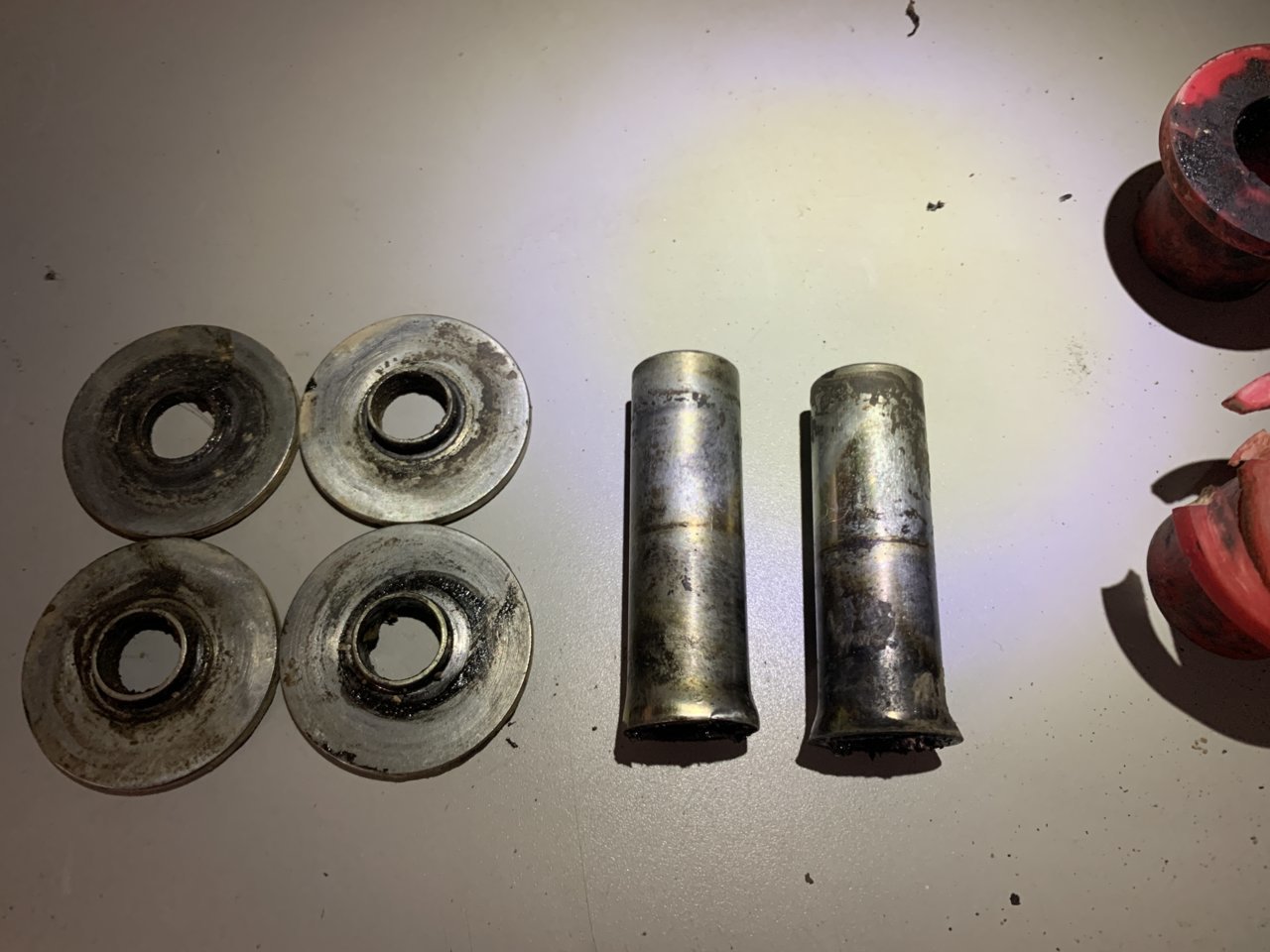

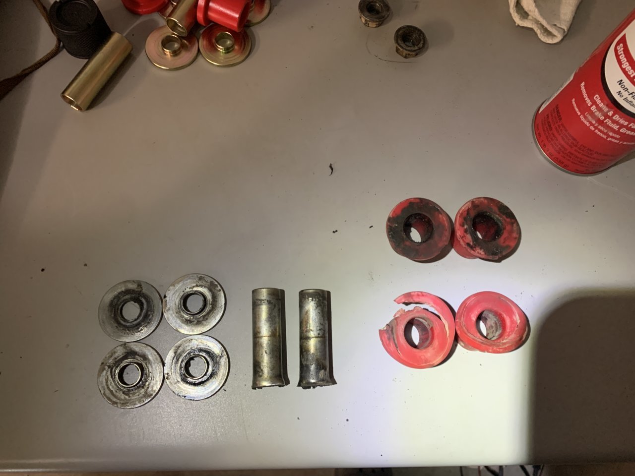

    Ive replaced them probably 5-6 times in the last year for the same issue seen below... the original design was much better, but this updated design is bootyhole
    Installed properly and torqued to spec every time. The sleeve starts to mushroom wheeling hard, which causes the rack to loosen from the frame. Torque them again, and this process repeats then eventually have to be replaced. I wish I would have kept the original bushings in the rack rather than replacing them as there aren’t any other companies offering aftermarket bushings(that I know of). When I get some time I plan on machining some bushings out of some high strength composite material that should be able to take a beating hopefully

    Damn i think my bushings are what's causing my popping noise. I think its from the last couple of wheeling trips. I was going to switch to energy but now its looking like i should just buy a new rack to avoid the headache?
    Sign me up for those bushings you make lol!!!

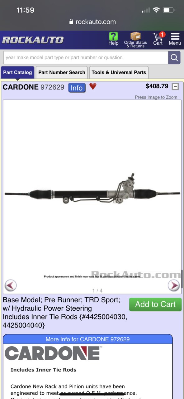

    This is the one I got
    Cardone 972629
