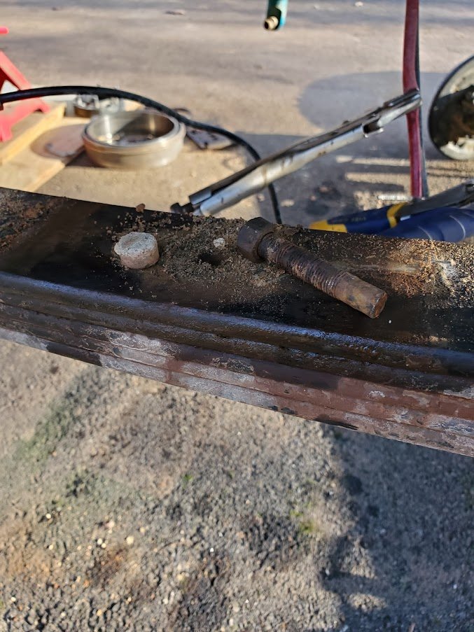

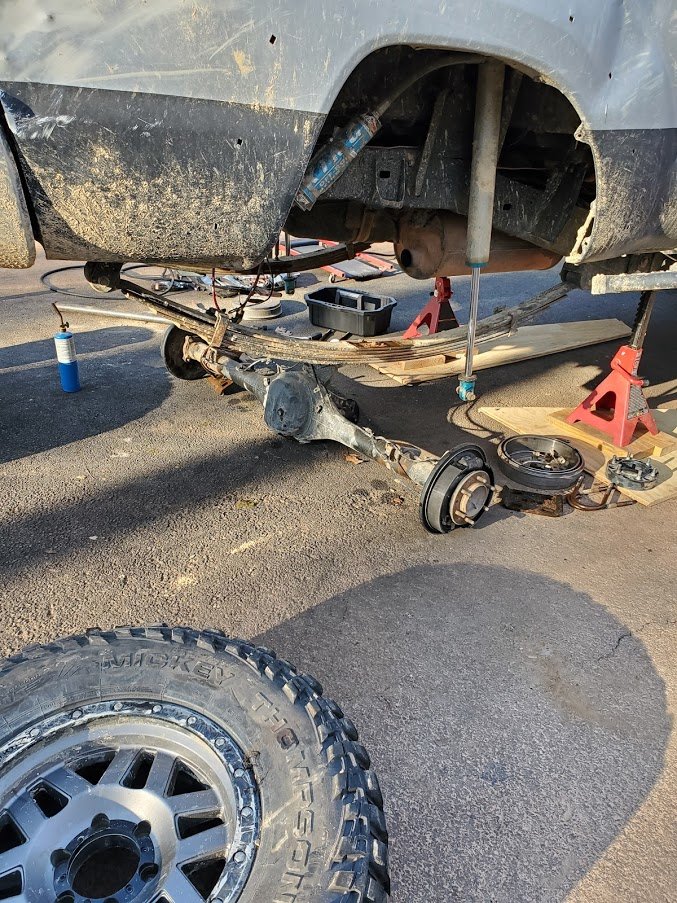

    Made some progress today. Found the DS center pin sheared, also at full droop like this my shocks still had like 2.5" of down travel looking at my shackle hangers they can go more vertical too. I've been wanting to work on getting the travel better. Time to work on figuring out some better geometry. I can definitely get more bump out of them but need to get the droop good too. It may be time to give Alcan a call and get a better spring set.

    Saving that for a different project. I just need to get the shackles better. It may be time for those missing link ones.

    I get a lot of down travel with the missing links

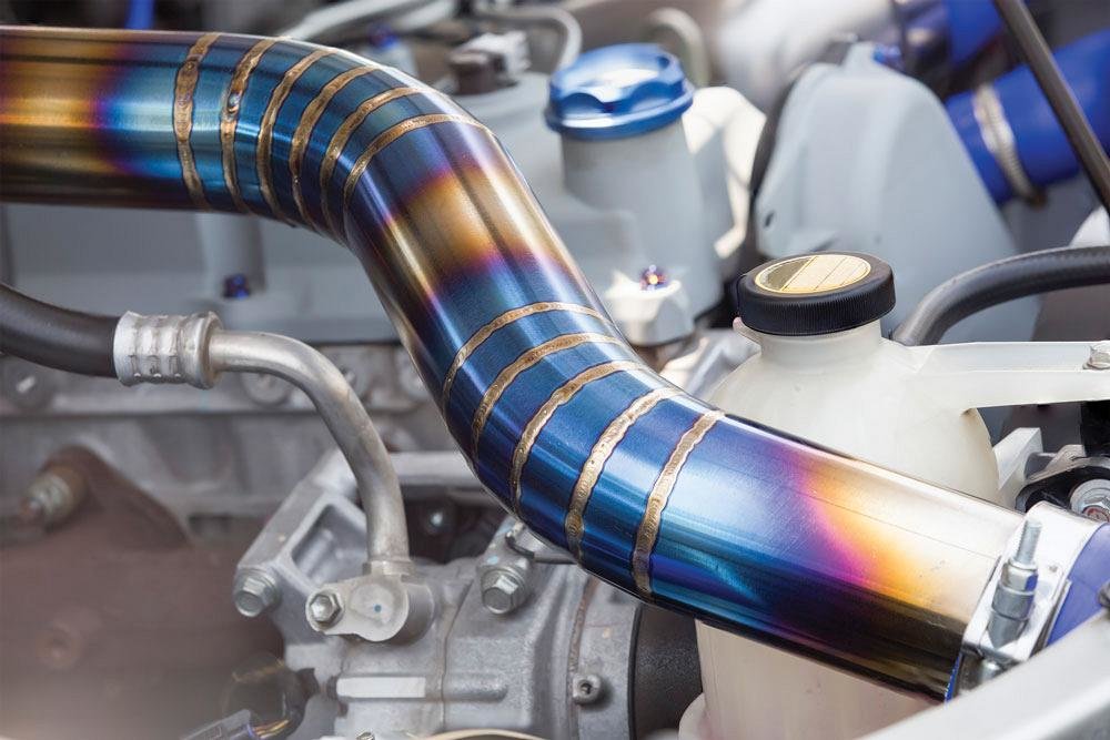

    Cullman Alabama
    2000 SR5, 2003 Double Cab and a Suzuki Samurai
    From silver to yellow to Blue
    cubie, Dirk Diggler, JEtaco03 and 3 others like this.
  11. Mar 6, 2021 at 5:46 PM
    ovrlndkull
    ovrlndkull STUKASFK - HC4LIFE
    Jan 7, 2017
    #206806
    37,785
    Skip
    Burlington, NC
    2005 DCLB Silver
    63s, XD Machete, Beat not Babied
    Touch it with your hands or wipe some oils on it like olive oil or the like. It'll do the heat anodizing to different colors more.

  13. Mar 6, 2021 at 5:48 PM
    JBTacoma
    JBTacoma Well-Known Member
    Feb 16, 2015
    #148844
    11,118
    Jeff
    Cullman Alabama
    Yes sir, I think it is going to do it without doing anything to it
    ovrlndkull[QUOTED] likes this.

    I like the change in colors some people try and stop it. To me it looks cooler.

    I like it too, I really like when the blue, yellow and purple blend
