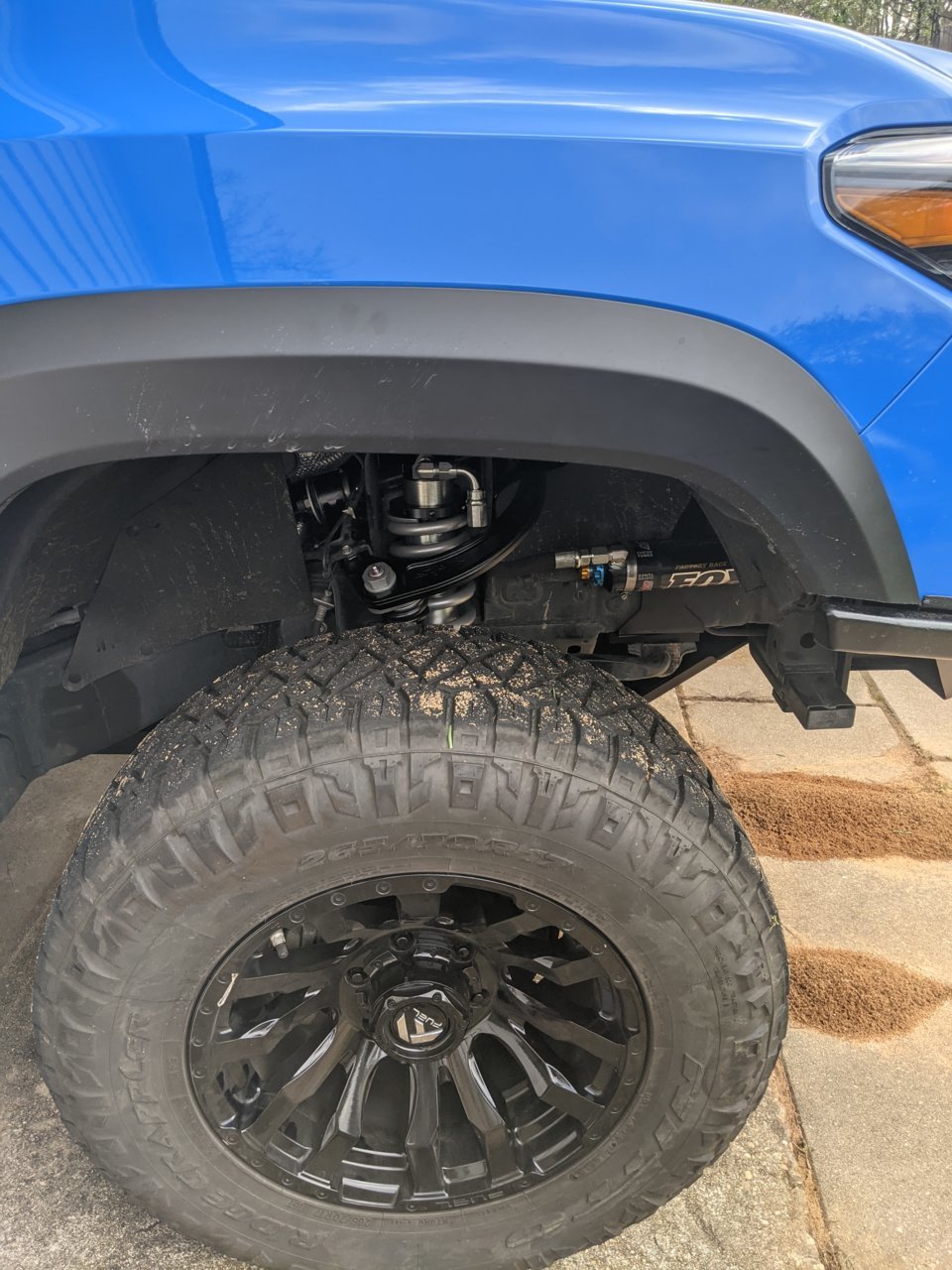

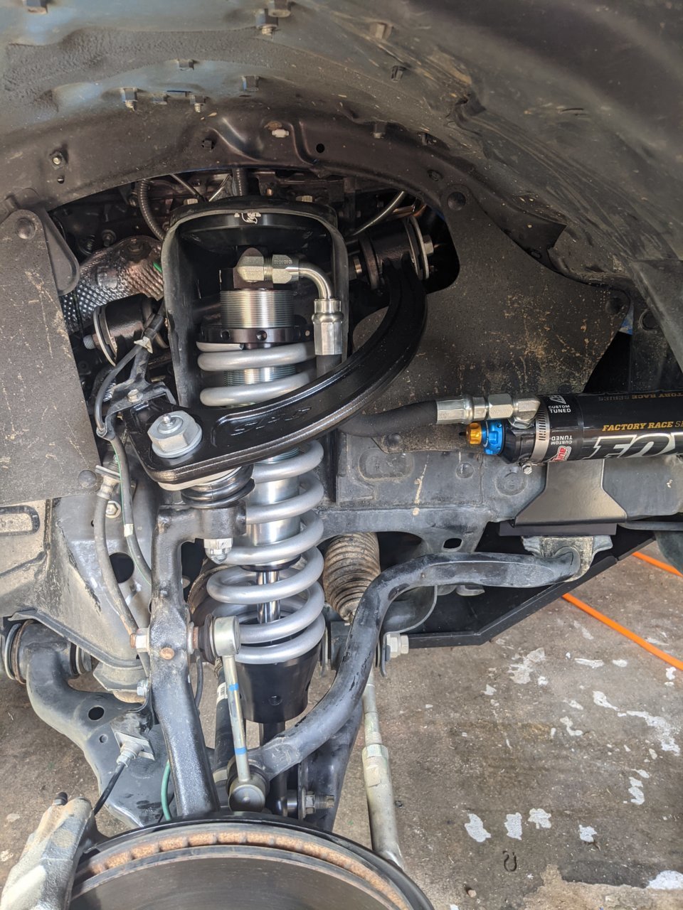

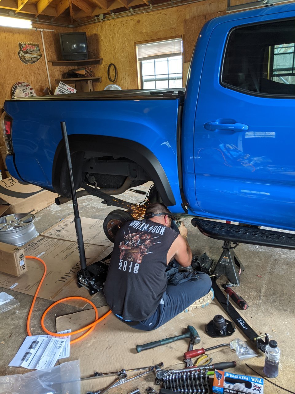

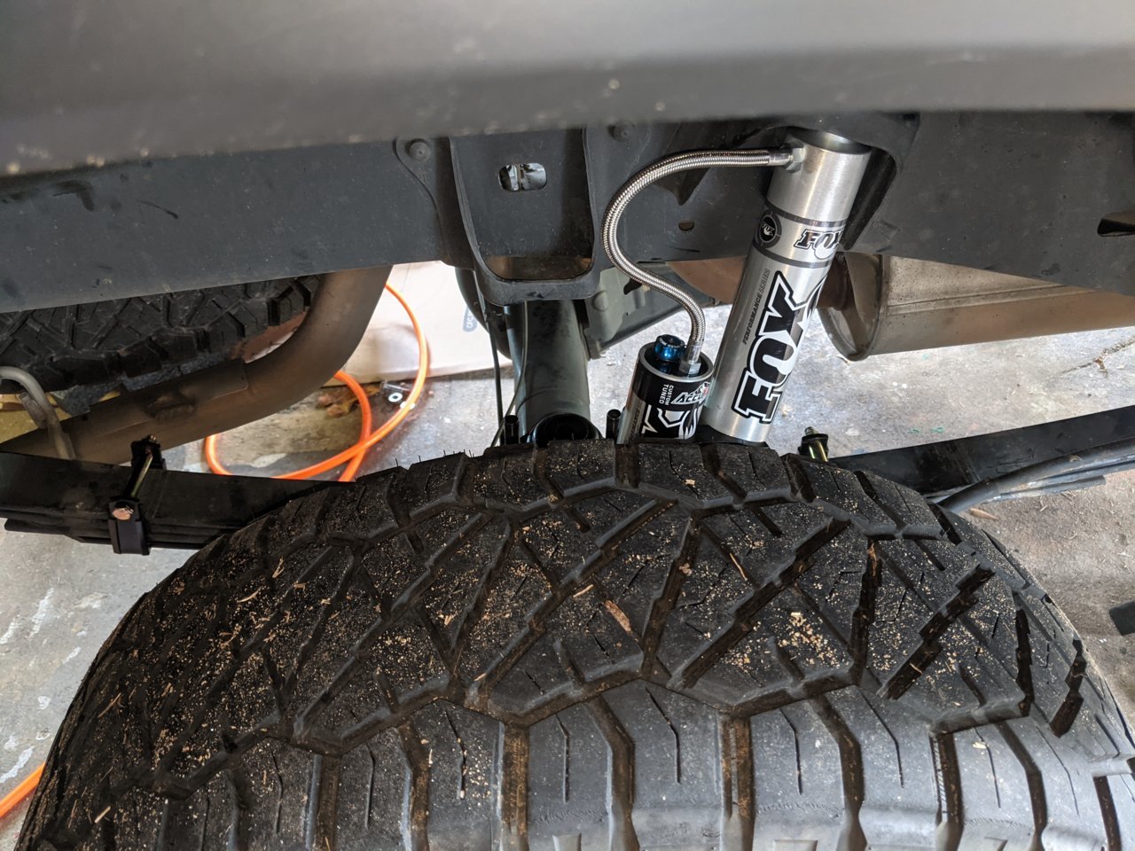

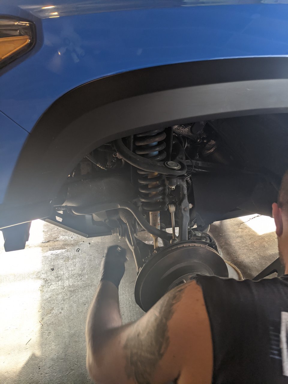

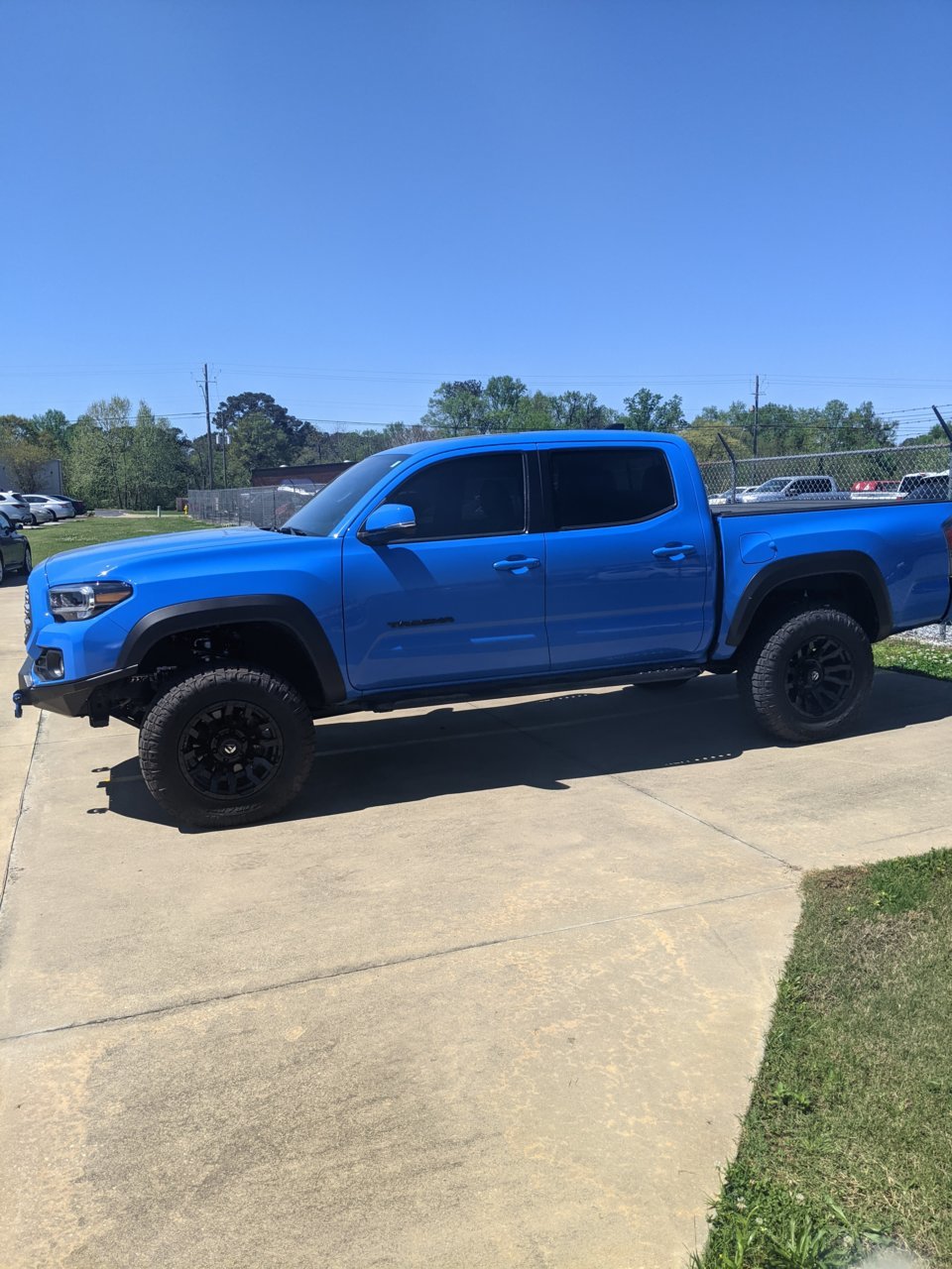

    I got my suspension installed with my brother this weekend and got the alignment this morning. Everything is working great so far! I am probably going to run up to Talladega on Saturday for a quick test run if anyone wants to go.
    Picture dump!
