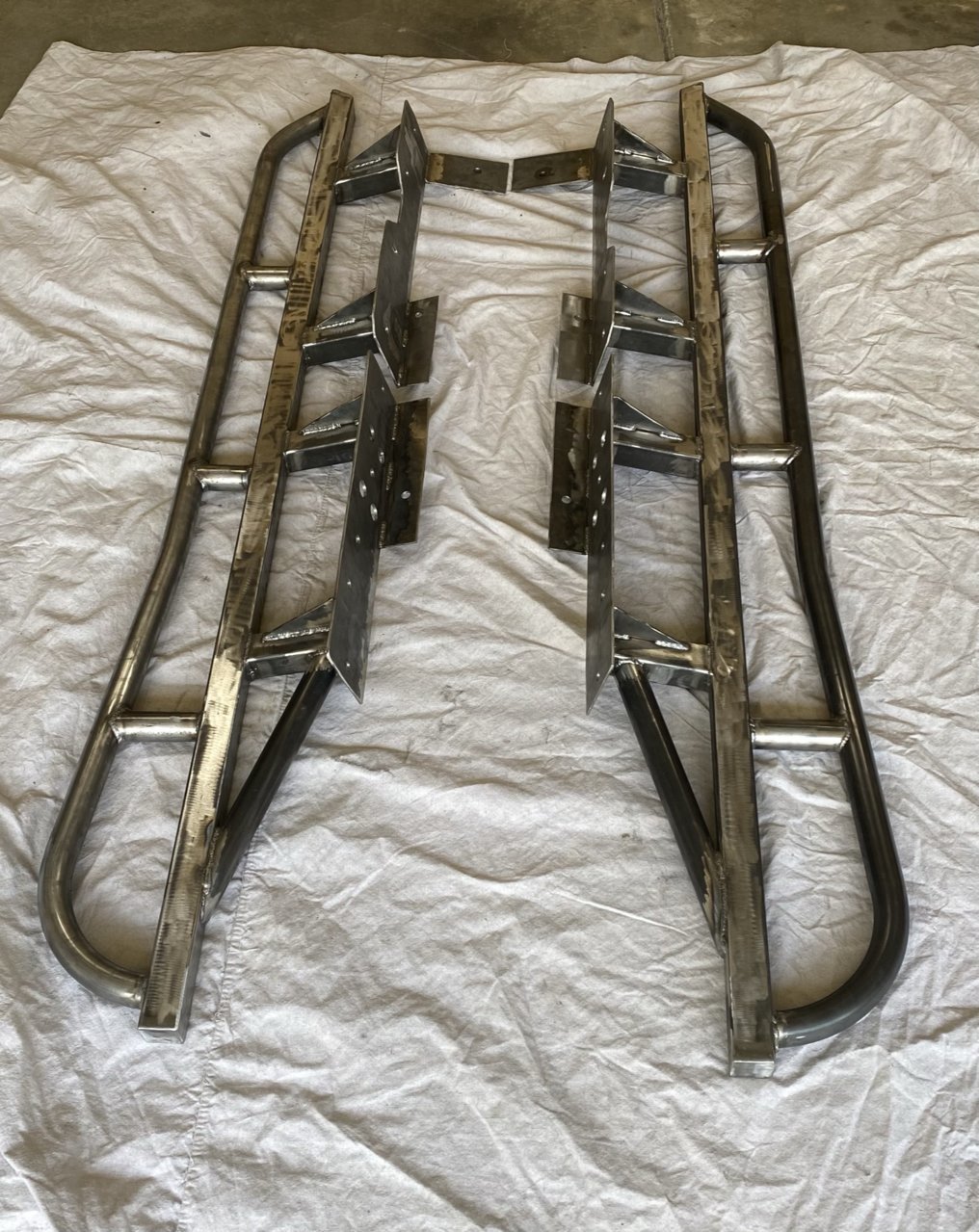

    If I can get it figured out, I would sell you a set I recently built and build another one for myself. These were a product of me not being happy with the strength of most sliders on the market

    Gotcha, they look as good as any other slider I’ve seen. What do you plan to do different with your next set?

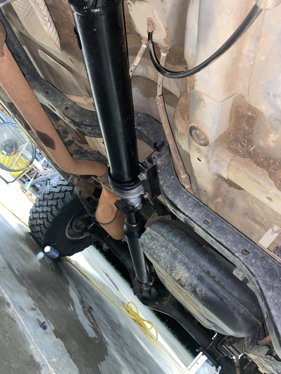

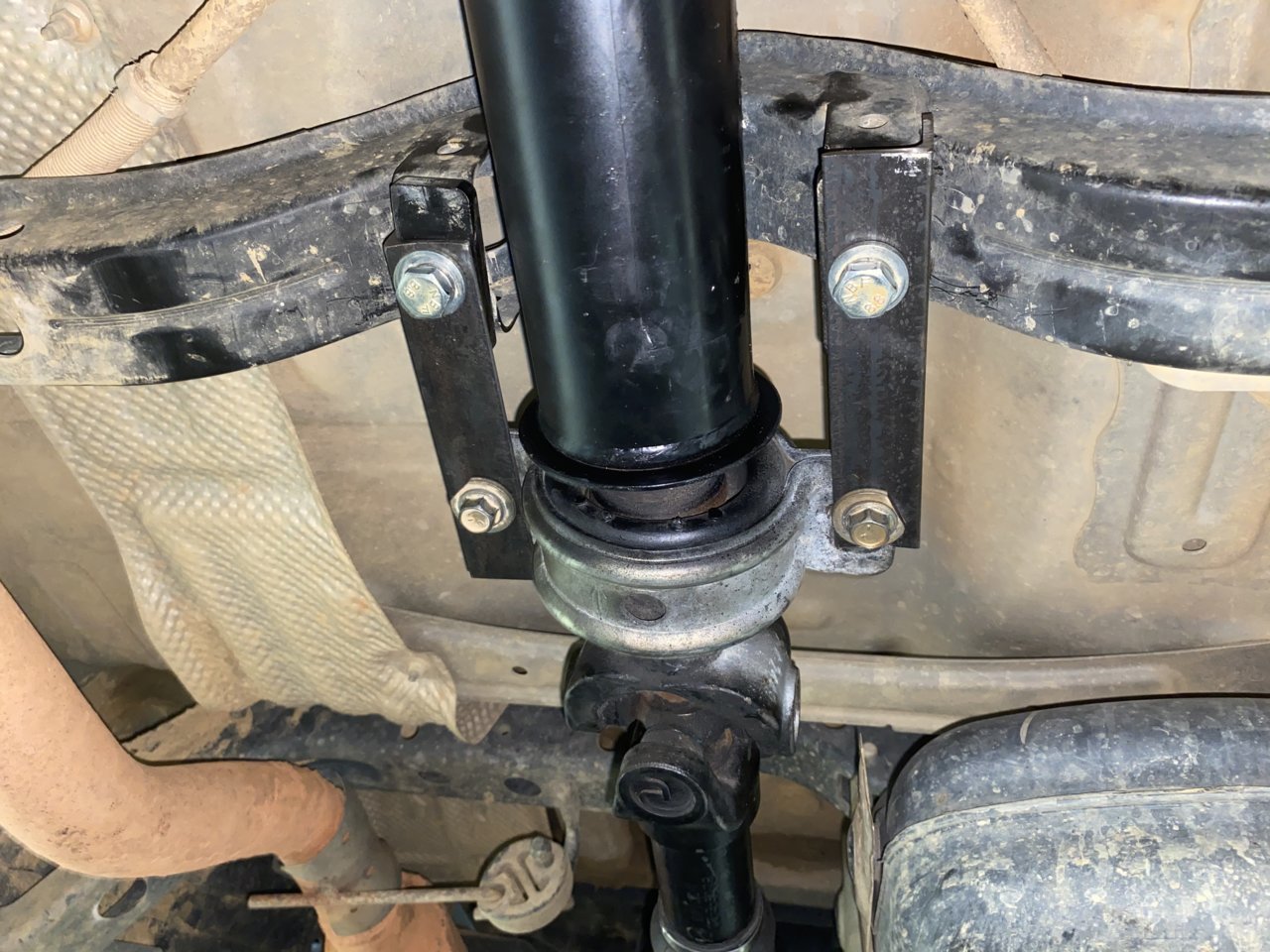

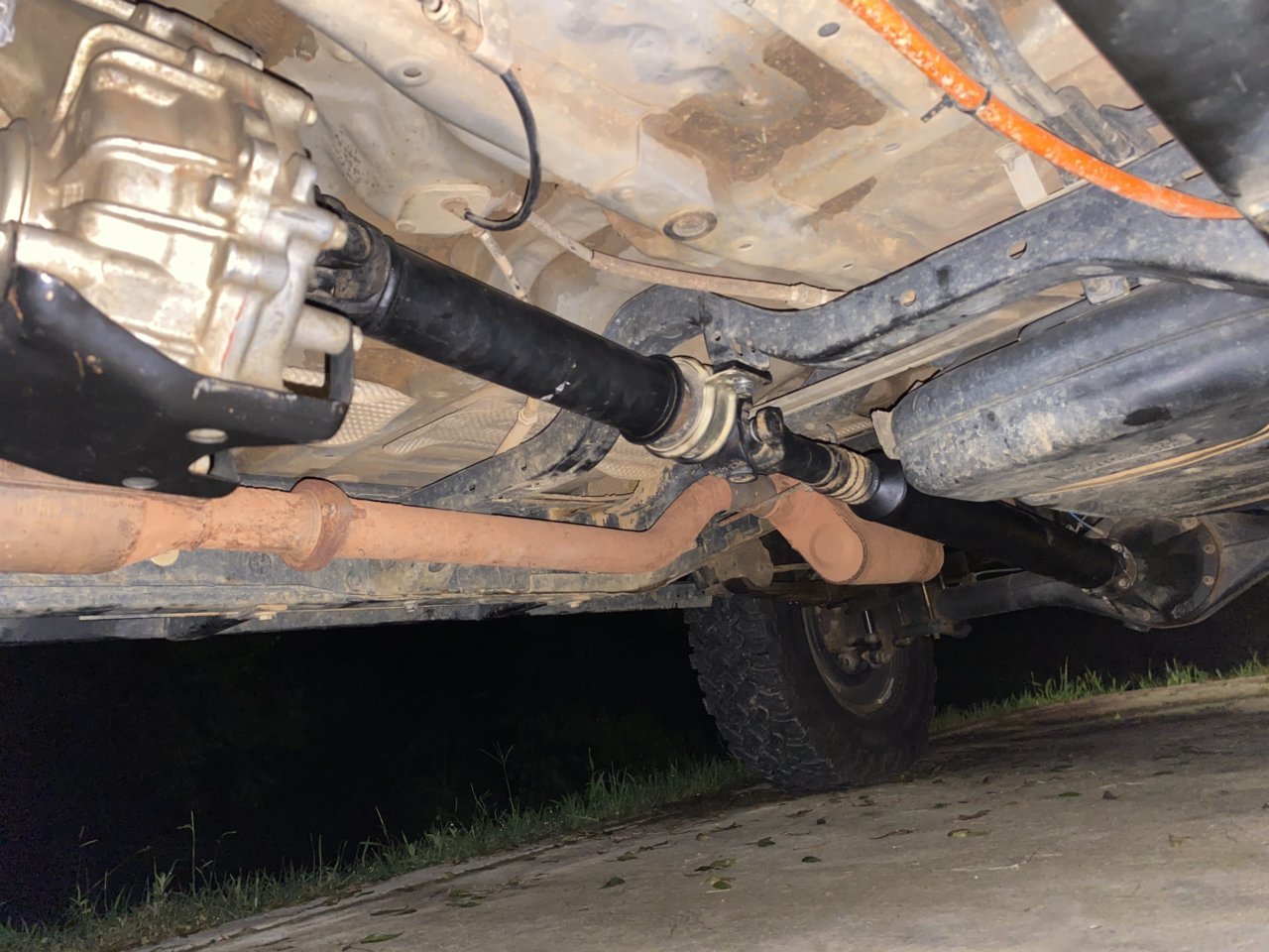

    I moved the mounting bracket but still had vibes then I realized Im pretty dumb. I installed the carrier bearing upside down lol now I have no vibes at all. Truck drives like it did before the conversion
    Before, hanging down pretty low
    POOLGUY, JEtaco03 and cubie like this.

    Make sure you have enough spline engagement. The first time your truck goes into some flexy situations the shaft could fall out or if its got too much it could bind the drivetrain.

    I think I do, it bolted right up where it should

    The shaft I had that was 4wd bolted up same way but spline was too jammed in there so it didn't provide enough room for it to compress. If i had taken it off-road it would have bound up.

    You used extension brackets? I extended my driveshaft mount back by about 2 inches. The thing that compresses isn’t compressed at all, that what you mean?

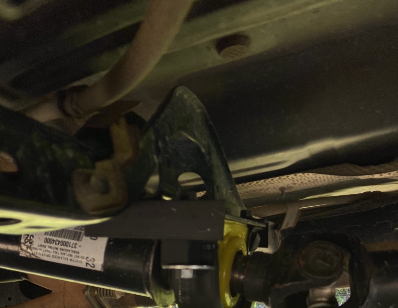

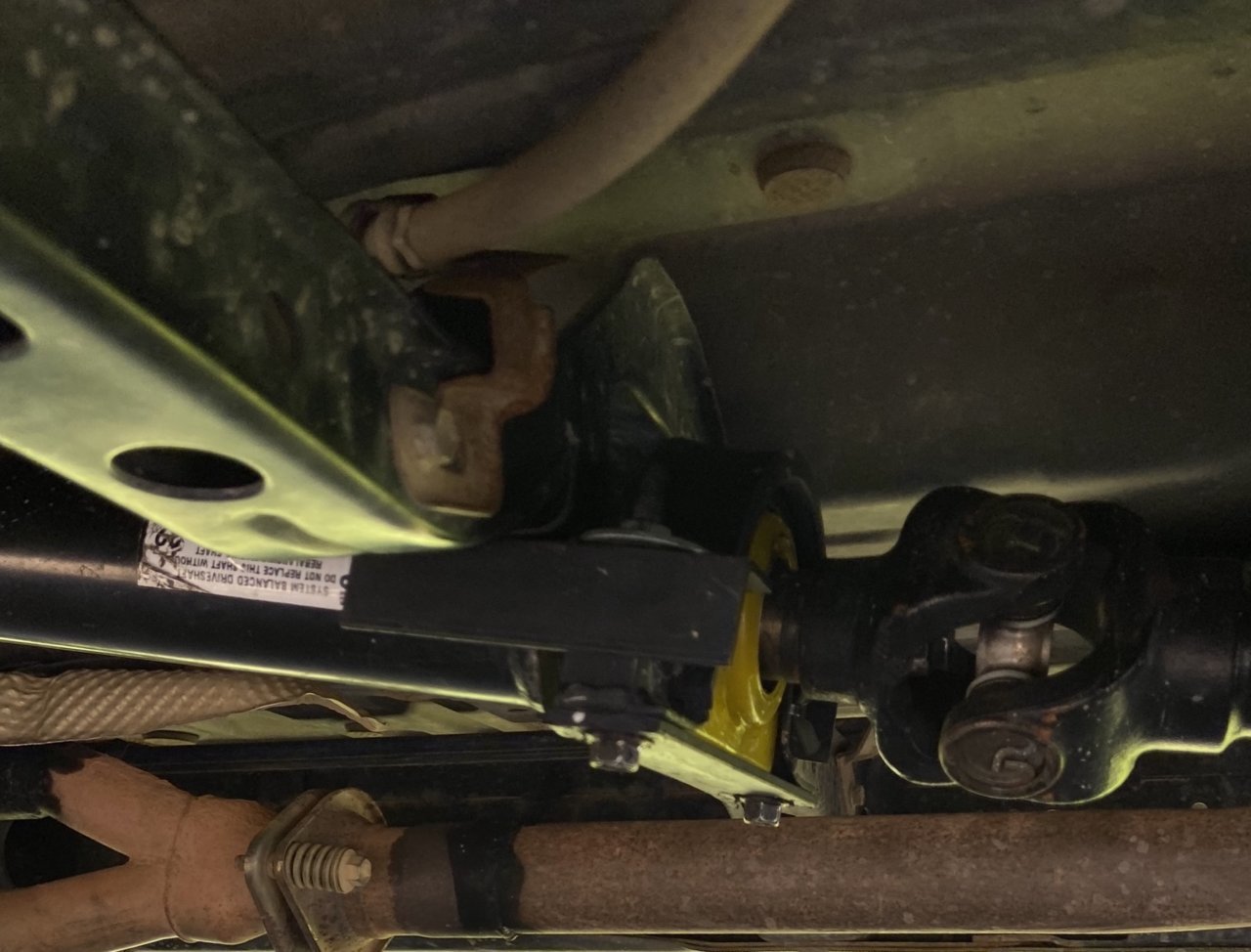

    Yes I did, I initially did that and then didn’t like it. For one reason it will be much stronger to mount directly to the frame. Also your have to take the boot off to see the spline engagement.
    https://4xshaft.com/blogs/faq/how-much-of-my-spline-should-be-showing
    Here’s what I had initially and after I shortened my prerunner one. Fits like OEM!

    Its also balanced a lot better than factory which i have a super smooth ride with it.

    Yea I’m going to eventually. Gonna put a flange, new u joints and a new carrier bearing on it before I get it shortened. The setup I have now will hold me over though. Already done some decent wheeling with it, seems to work well
