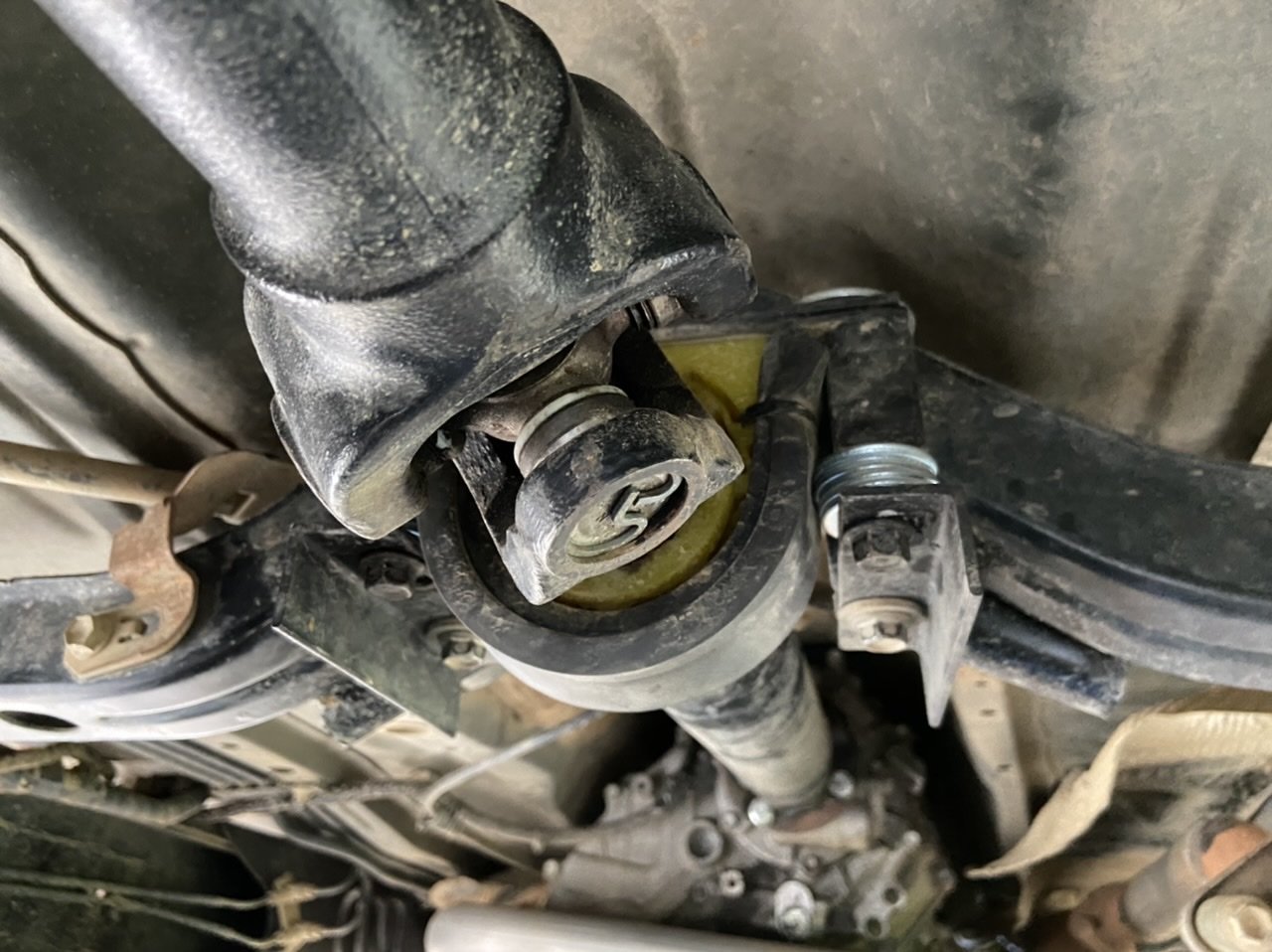

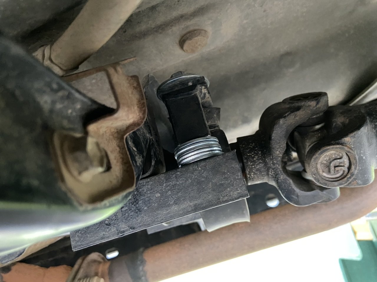

    I made my transfer case output and pinion parallel and dropped the carrier bearing until the two shafts were within one degree of each other. It ended up being a 3 degree shim with the thick side towards the front and whatever thickness the OME carrier bearing drop is. Even with the shitty wheel bearing I can tell the driveline is smooth.
