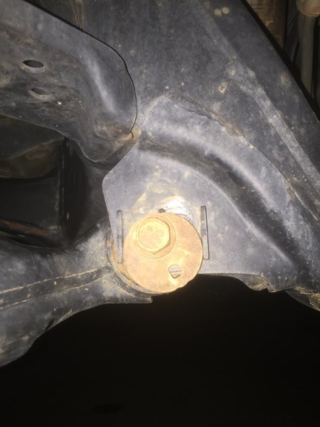

    Ok, got a quick video and snapped some pics.
    The sound is almost like a popping now, and happens almost every time i go from reverse to forward once.
    Uploaded the video to facebook because I couldn't to here. Looks to me like this could be the problem, possibly they forgot to torque this down? you can see where it use to be.

    Could the alignment cam jumping over the tabs if it's not torqued down. The reason you're hearing it on a bump is because the cam is moving with the arm.
    That cam bolt is def upside down.

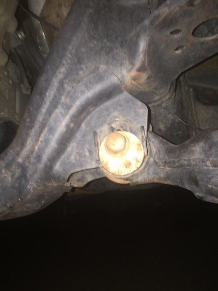

    Really?! this is the other side

    Oh well maybe not. I've just never seen them aligned like that. Usually flipped the other way.

    That last pic it looks like u can see a wear mark where the tab use to be but i could be wrong

    I'm on the LCA is not tight that or there is a tie rod end issue. I would call them first thing in the morning as soon as they open explain the issue and let them make the call to pay for you to have it brought to them on a flat bed or you to drive it and them assume responsibility for the damage that could possibly occur while traveling to their shop. Do not take NO for an answer. This is a laziness issue end of the day tech was tired and didn't check everything issue here

    Looks upside down to me too. They shouldn't be hanging off like that.

    Exactly.
    I'm no expert, but I've never seen a tab upsidedown like that.
