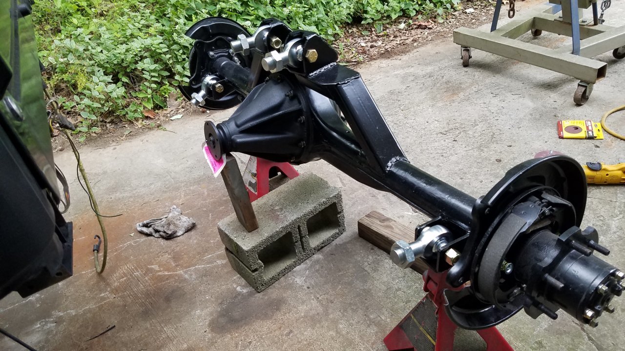

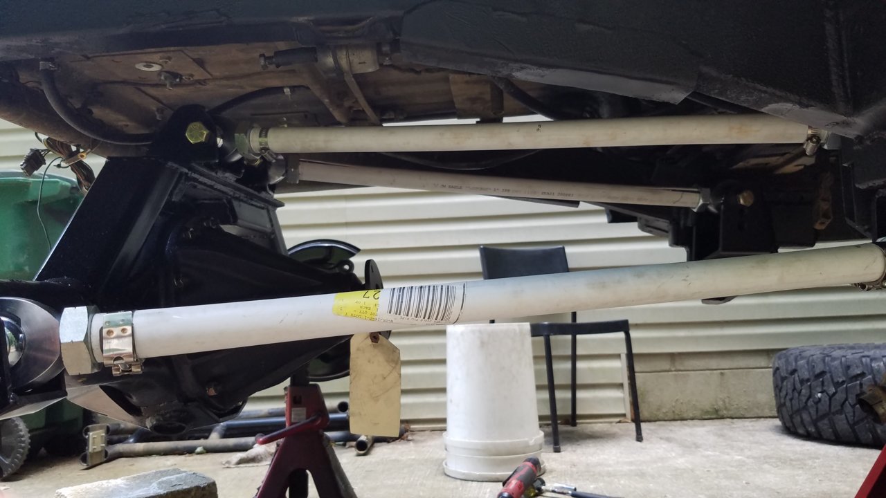

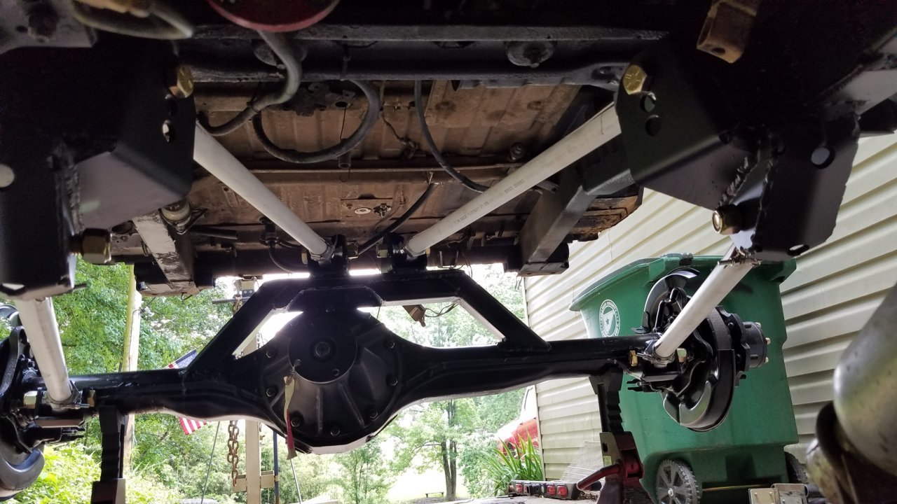

    Got the rear axle ready to go in

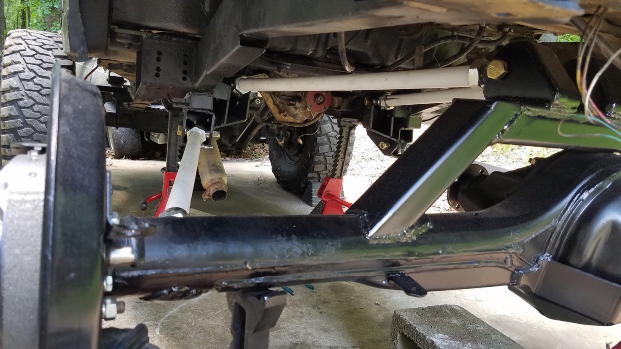

    One side done and painted. Gotta get to the other side now.

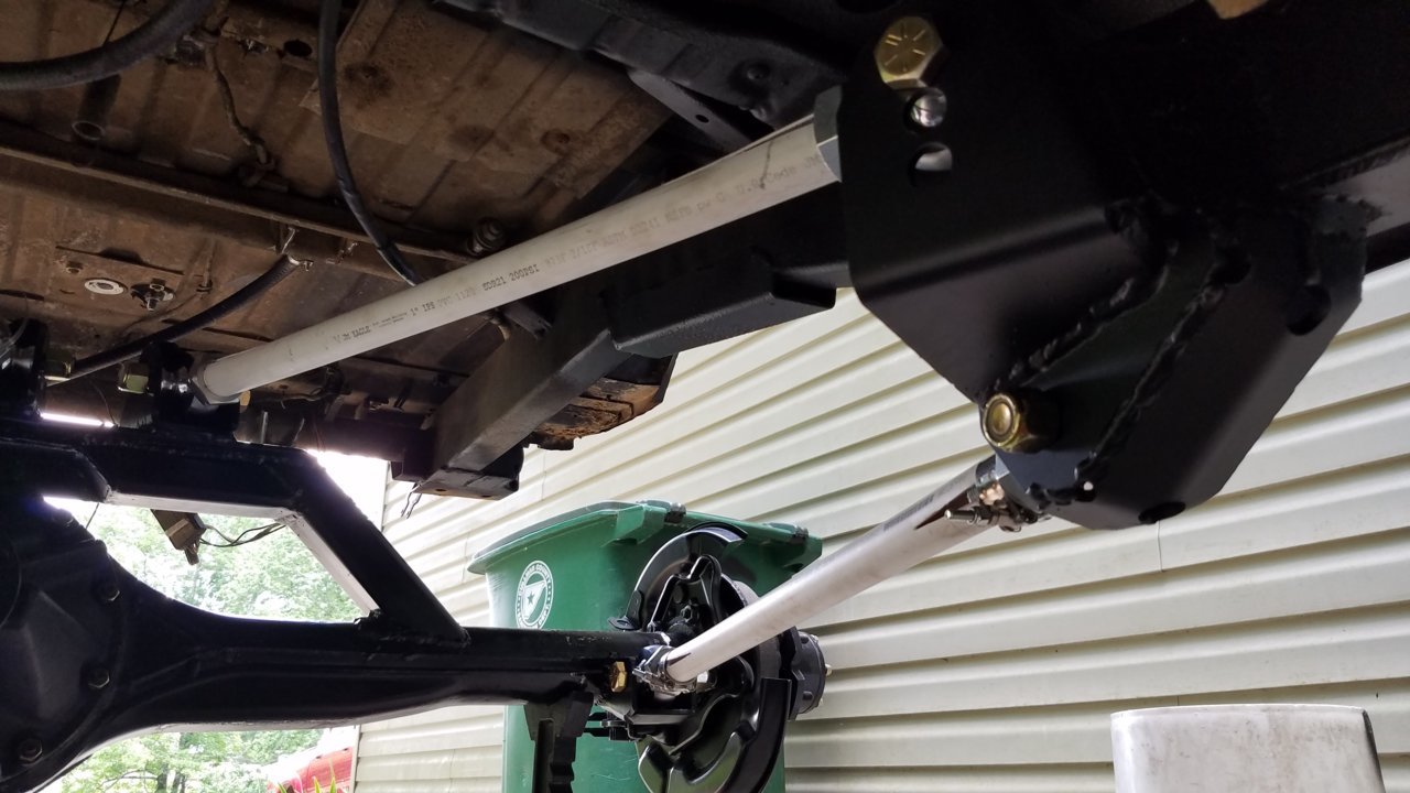

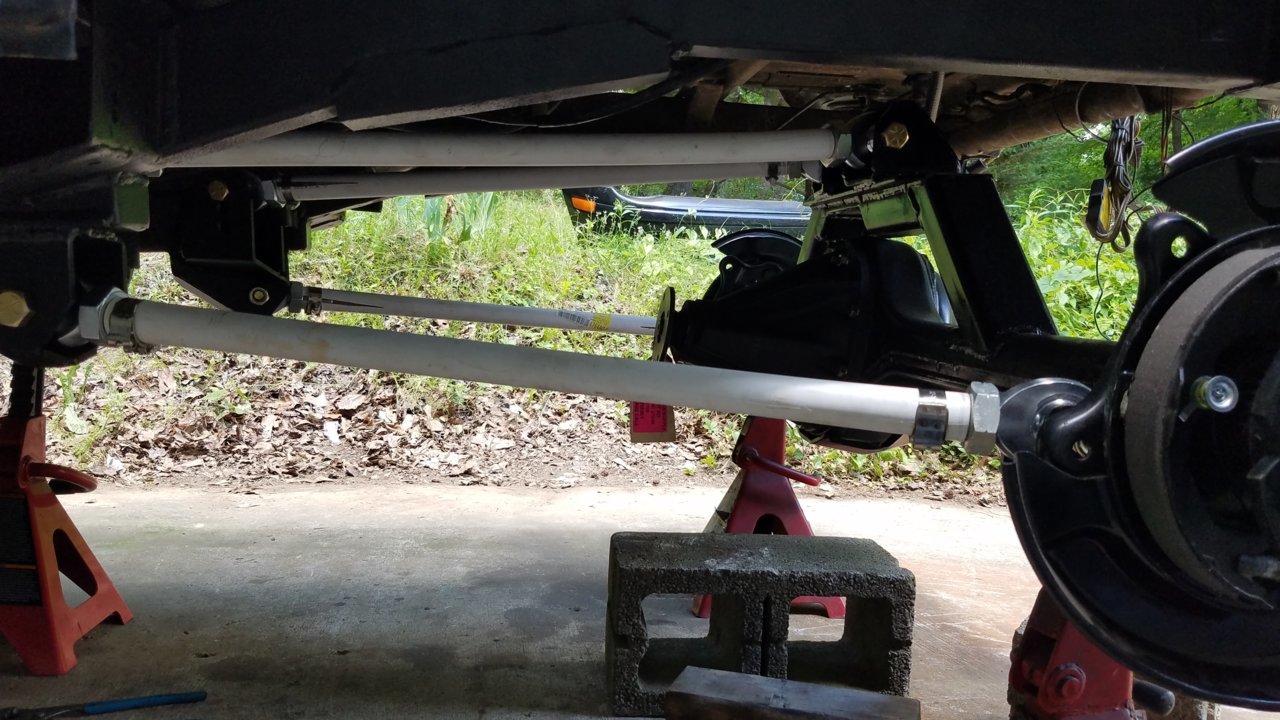

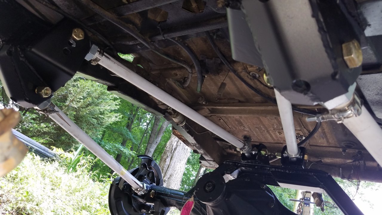

    Ordering links in the morning for the rear then start on the front.

    Sweet!!!! Aluminum? What wheelbase are you ending up with?

    2 inch 7075 T6 aluminum, should be 104 wheelbase
