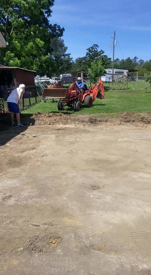

    I forgot, I got to play with the tractor this past week while at my folks' :D

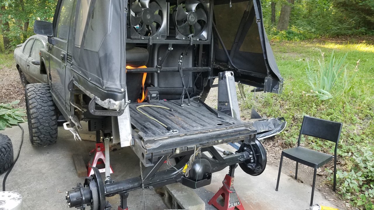

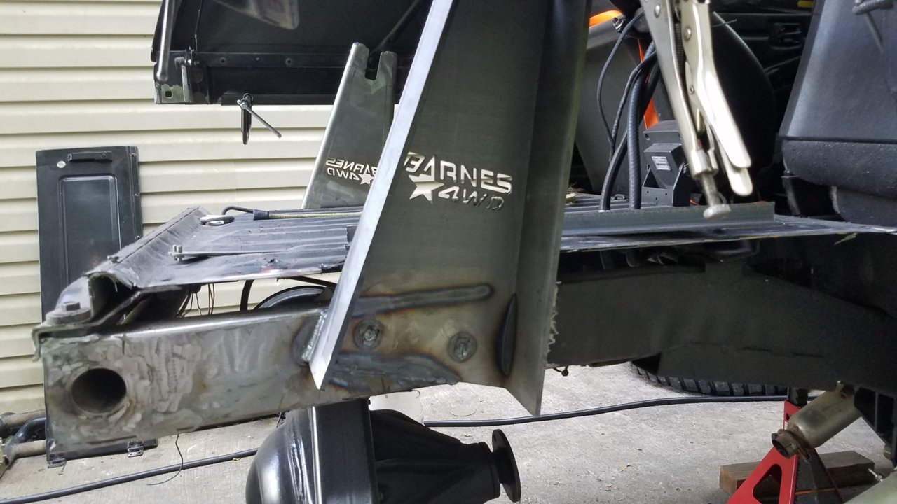

    I toyed around with getting those towers to do a shock relocation on my truck. Also another good example of a rosette weld.

    I have been using this style shock mount on the front but they were 3/16. I am using them on the front and rear this time but these are 1/4. You wouldn't think a 1/16 thicker would be much but it is a lot, much heavier. But this time they support the entire weight of the vehicle.

    Are you planning on tuning braces between the mounts to prevent twisting?
