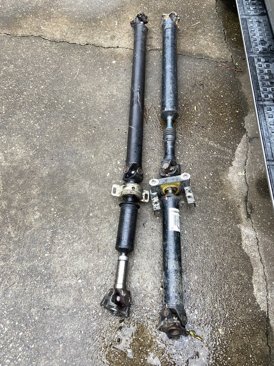

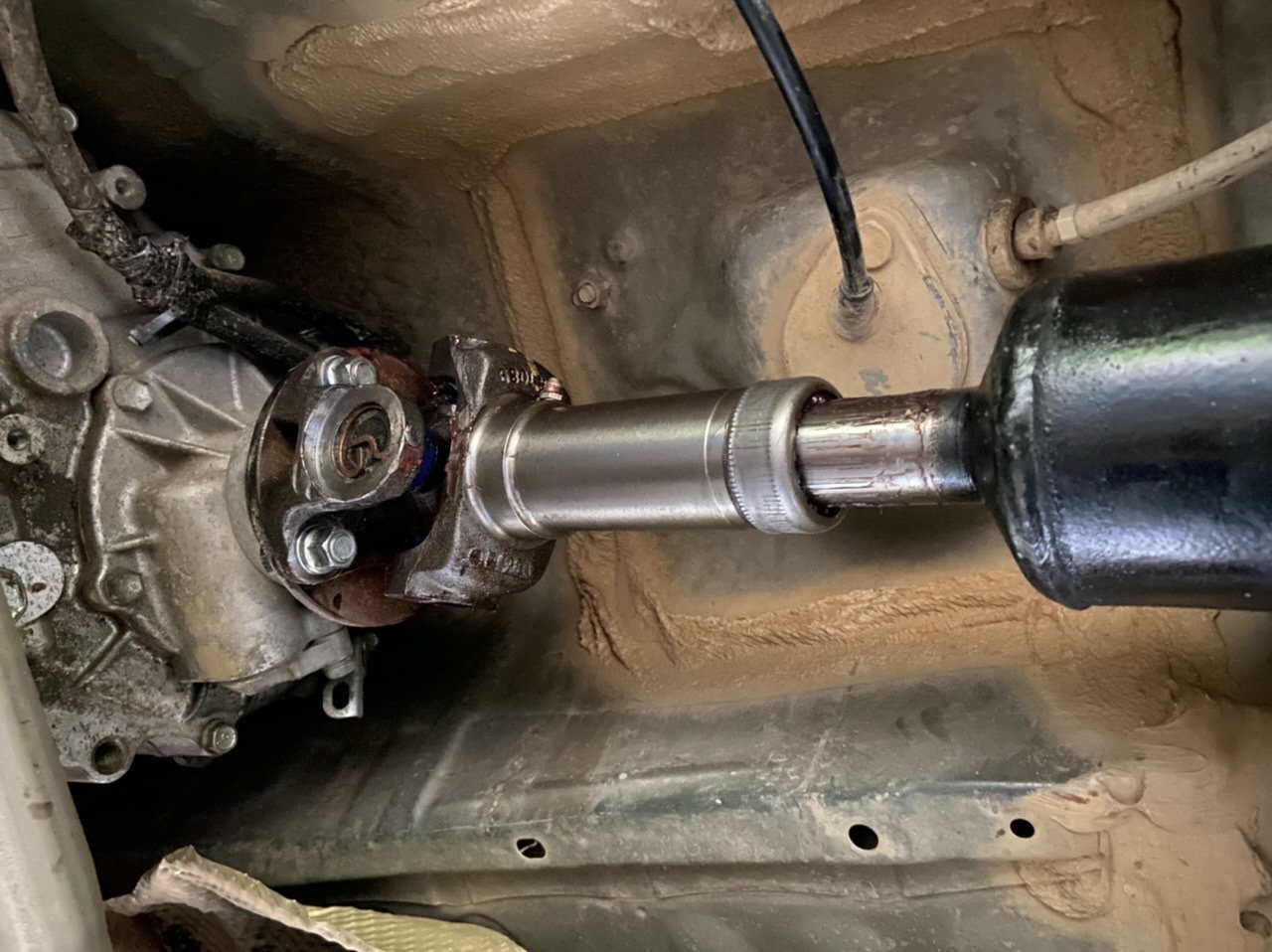

    Finally got around to shortening my shaft, fixed all my vibes. How does my spline engagement look? Do I need a cover over it?

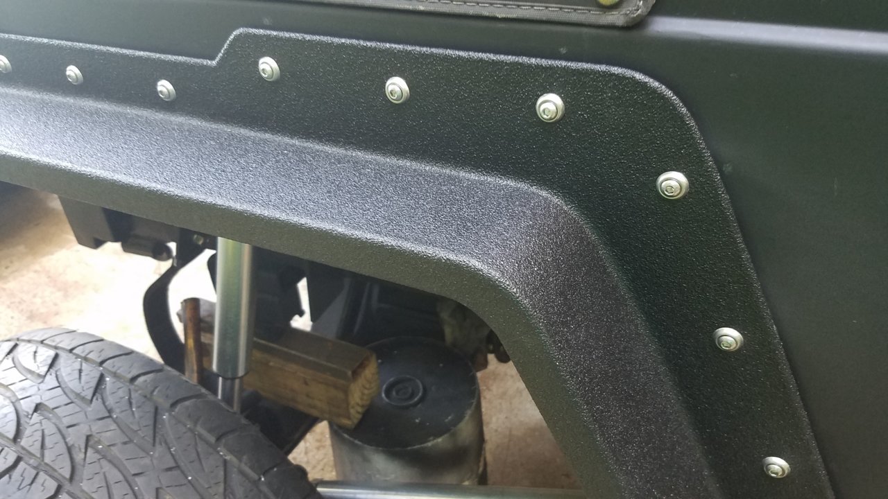

    Got the rear fender flares on

    That looks awesome Jeff, can't wait to see it in action!

    You need Atleast 2 inches of exposed thread.

    Cool so that’s about 2 inches

    I’d get a boot for that

    Coming together

    You need to get it lengthened lol. Where’d you get that slip spline? I have a prerunner shaft I’m gonna cut down to make a bottom portion out of.

    Thanks, they were a lot of work

    I dropped it off at Kurt’s. Parts and everything was $290, pretty good deal I think

    The slip yoke at the T-case side isnt' critical since that doesn't move with suspension. The rear section needs to have a slip yoke you could run into bind issues also putting undo stress on the u-joints and carrier bearing.

    Well crap I missed that. Could I have a slip yoke on both sides then? I wonder if I could just take the back end from my old one and put it on the new one. I guess I just assumed since my old prerunner shaft had a slip yoke that went inside the transmission, the new slip yoke needed to be on the front too

    I was trying to figure out why my old prerunner shaft didn’t have a rear slip yoke and I think it’s because the carrier bearing is designed to move whereas the 4wd has a different carrier bearing design. Not 100% sure tho
