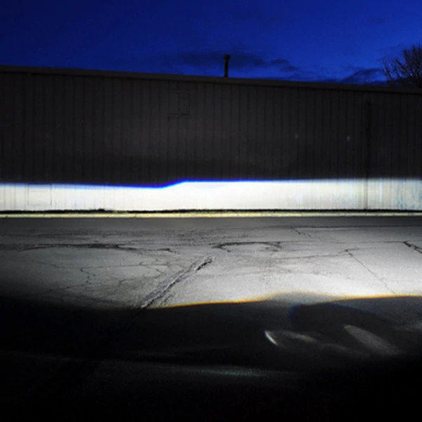

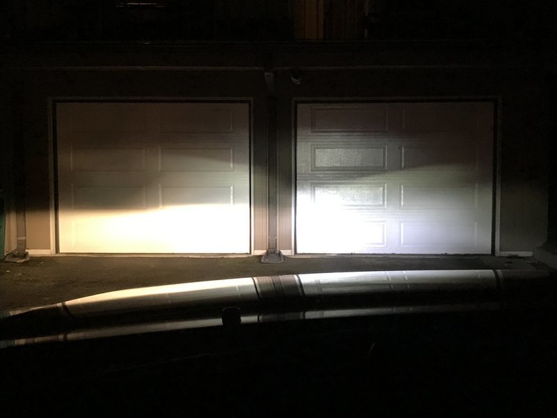

    yes im sure because i run LED in my projectors lol and they are angled below driver seating position. You cant do that with a reflector.
    cutoff-sheild-for-projector-headlights-1024x642_600x600_crop_center.jpgProjector as you can see has a cutoff so you cant blind ppl. Although you will need to adjust the angle of the light when you install the new bulb.
    IMG_0424.jpgReflector has no cutoff and throws light everywhere.

    I had it backwards. I know there is a guy in my neighborhood with super bright ass LEDs in his Silverado and they blind the shot out if everybody. Now that I’m corrected, I’ll look into some DD LEDs to drop into my headlights.

    Most brights on cars are reflector and low beams are projector. Just makes more sense since your not supposed to have brights on anyways around others. My truck headlights are like that. Just make sure to park your truck like 5 feet away from a wall and angle the light down enough.
