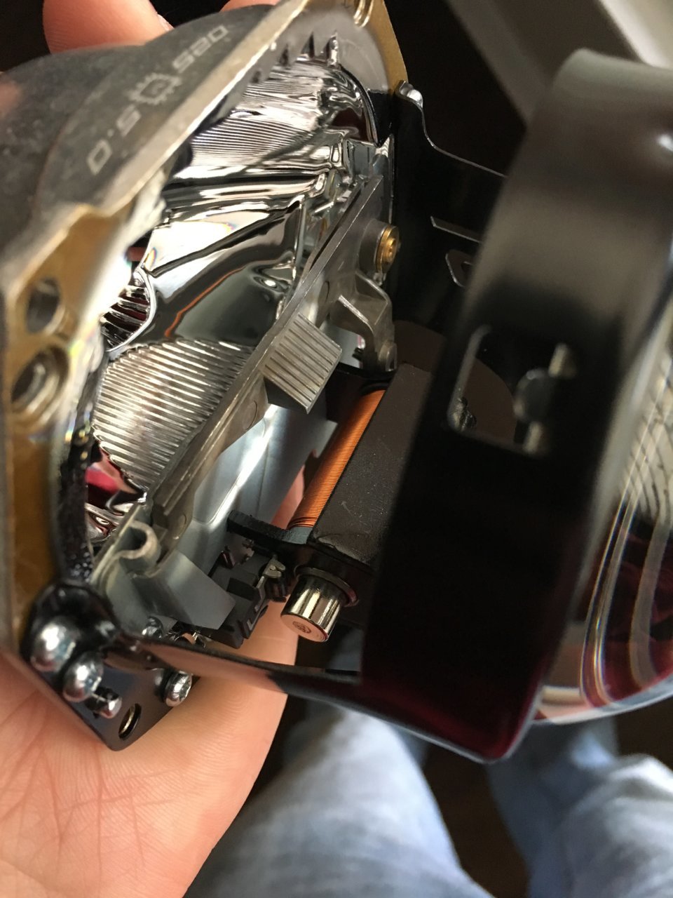

    I haven’t seen LED projectors / cutoff in person but the mini D2S setup is pretty solid!
    sorry for the blurry pics, it was late and I was tired of adjusting.
