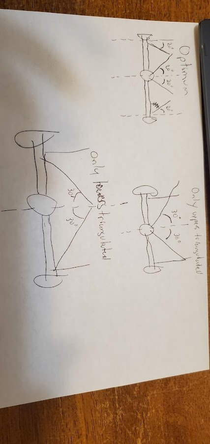

    John

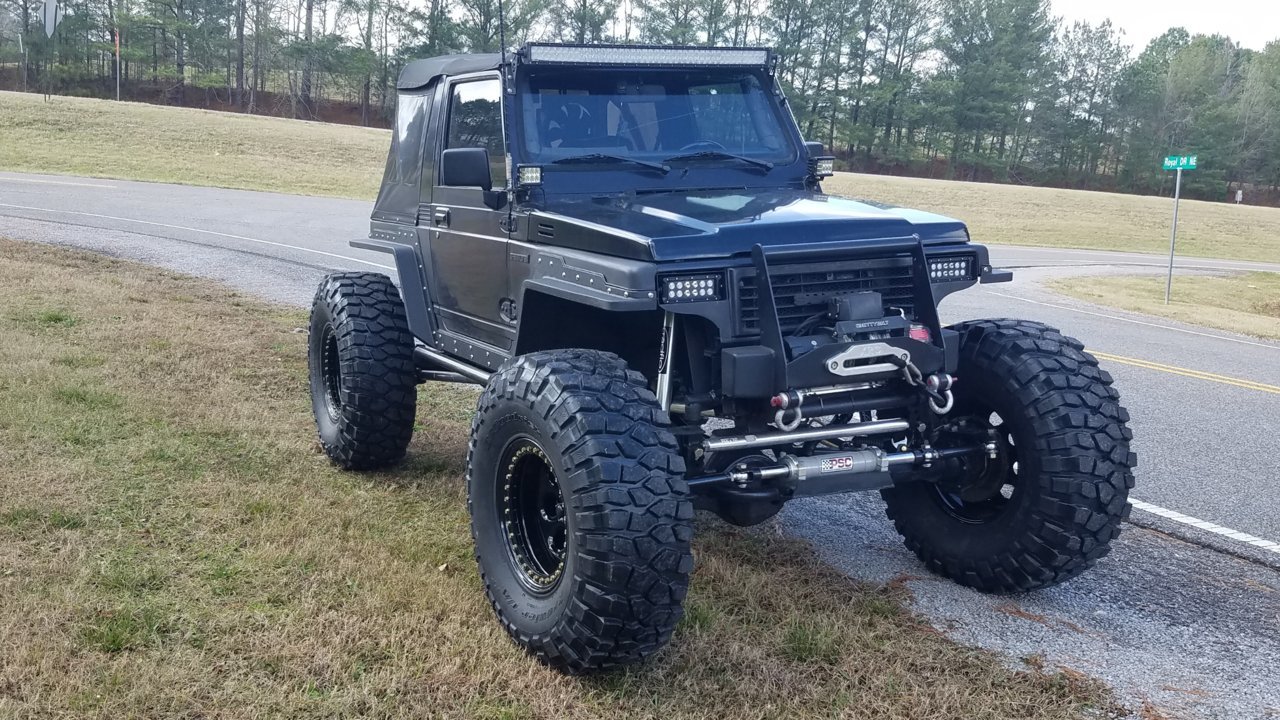

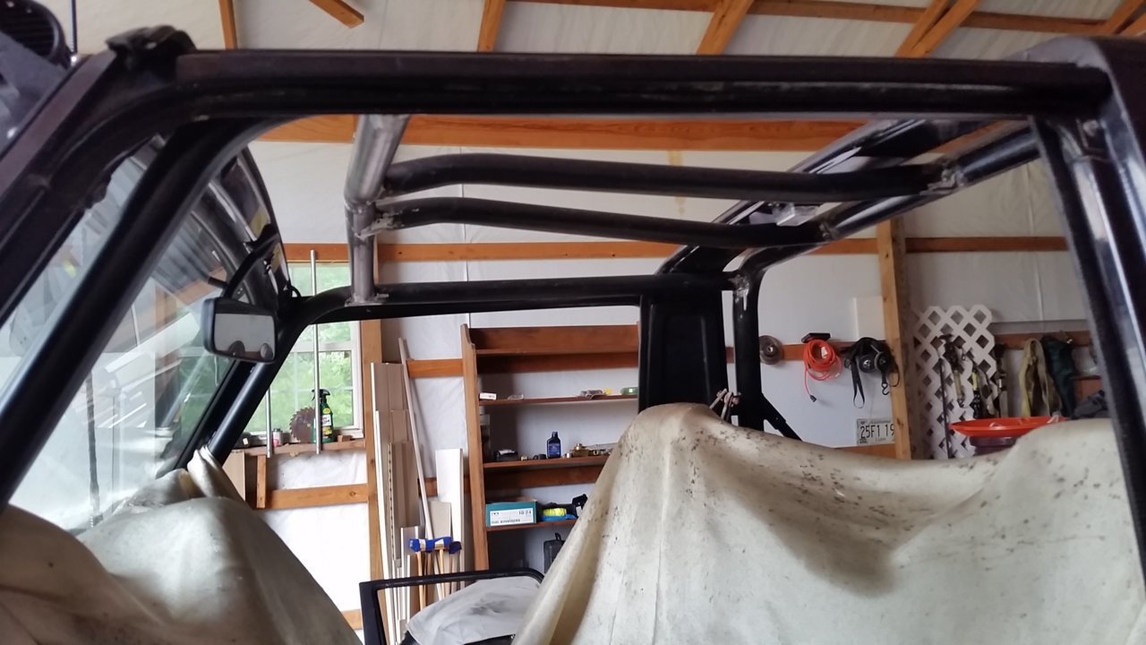

    I built a cage inside it

    Not done yet but close, it is finished enough to go ride.
    It isn't too bad just a lot of measuring and calculating.

    Here's a pic to explain for #1. The angle is taken from PP looking from above. These are exaggerated and just basic ballpark what they would look like. You can have anything really in between and the angles aren't definitive. The optimum is what #1, 2 are really referencing.
    As far as that x-member I'd look at going single piece and then reworking that X-member. If you go longer than the DS from u-joint to u-joint that could potentially cause some issues with binding and too much flex for the DS to handle. Most comp bouncers, crawlers, regular buggies, etc try and put the pivots at the front front U-joint. reality if you make your links that long they'll be a pretty good length
