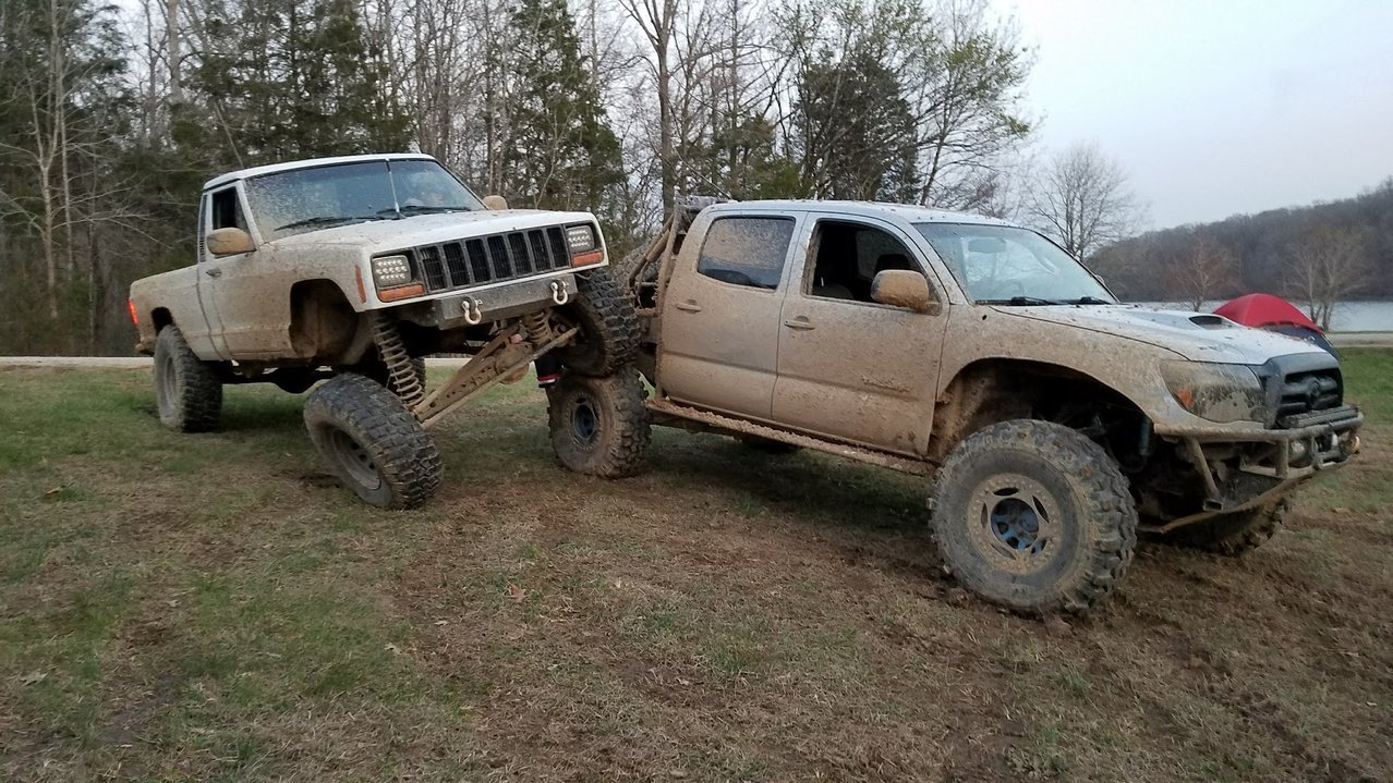

    Thats Levi, his truck does really well, I have followed him around on a few rides at AOP, Land Between the Lakes and Turkey Bay.
    I videoed him racing a jeep up a steep hill at Turkey Bay in Kentucky, Jeep won.
    https://www.youtube.com/watch?v=ADZz1HhpNf0
