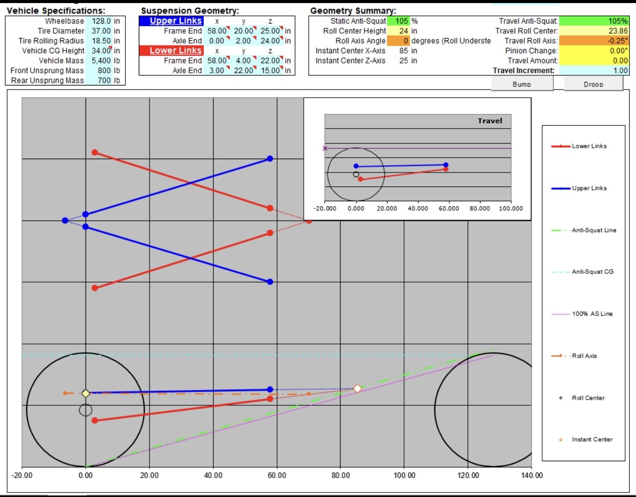

    @JBTacoma did you go with air shocks? What length? Been looking at 18 or 20” ORIs over 16” coilovers mounted to the axle…

    I got 14s, they are 22 inches collapsed and 36 extended.
    An 18 is 26 collapsed and 44 extended.
    Not sure what the specs on a 20 inch would be but it would be pretty long. Do you have a link to the ones you are looking at?

    Well after some more research I don’t think they will work. Looking like 16” coilovers mounted to the axle are the ticket.

    Which ones are you looking at getting?

    Some Fox 2.5 body performance series. Length will really depend on links of course, but here are two scenarios I’m looking at for the links.

    Big difference
    When you get the axles under it jack them up to full compression to see if your links will clear. I had to cut some mounts off and redo them because what I thought would clear didn't

    I’ve got plenty back there since I’m doing a tube bed. It’ll be back halved if necessary, but first round should clear everything at full bump besides the crossmember that the charcoal canister mounts to. Easily removed. Of course until I get the mounts in my hand I won’t know 100% what needs to get chopped. Getting big picture stuff now.

    My drive shaft hit is why I had to move a mount but it was on the front I had a lot of room in the rear. Are you linking the front too or just the rear?

    Just the rear. It’s pretty wide open back there. There may be a happy medium in between those two scenarios to keep the links shorter and a little less anti squat than the short link scenario

    Yeah, If you are tubing the rear you can do anything you want to do
