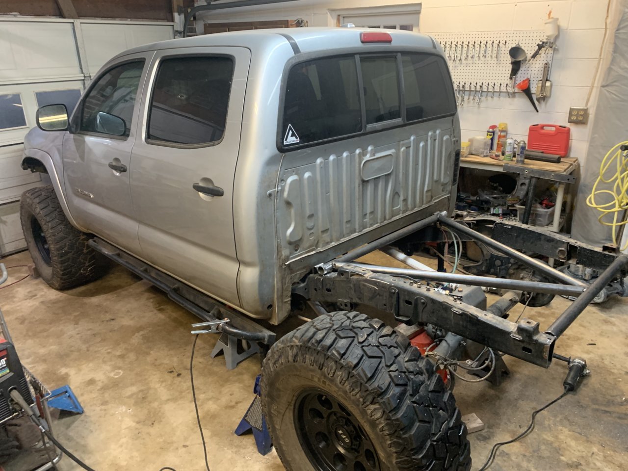

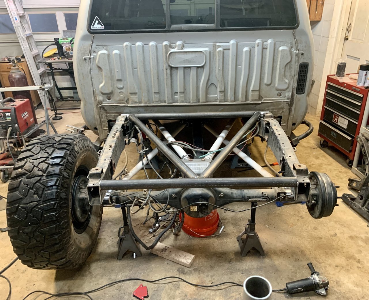

    I didn’t see a scenario where the coilovers wouldn’t hit the tire or frame when stuffed so I guess I’m back halving it :rofl: I’m using the original frame as a reference point and cutting it out as I shape the truggy cage.

    You could just cut the frame where the COs are going to go and then inset the COs into that part kinda like step notching but on the side instead of the bottom.

    I thought about notching the frame, but that became more work than just ditching it at this point. This way I can mount them wherever I want and it’s much easier to build with tube than fight that crazy tapered frame

    Flex that thing and let me know how much space you have between the front of the tire and the cab. I'm really pondering things and stuffs

    Right at five inches with my 35s. Not much room to play if you go to 40’s, but I’m going to try to tie my sliders in to the new frame right there if I can.

    That's lots of room. Where are you going to bump it so the widest part of your tire is even with the cab or just below.

    For reference I’m going to bump four inches down from the factory bump pad if bumping from the spring perch. That should be 7” of up travel. I may shoot for less if I’m not happy with the down travel.

    So 9 down 7 up or approx that with a 16" CO

    That’s what I’m thinking. I’m going to tilt a bit forward and try to get 17” out of it but Accutune said not to go much further than that with how they’re tuning it. I’m jumping the gun ordering them without knowing weights but I’ve got to have something to mock them up with. I’m not experienced enough to do it blind. I told them about 200lbs over a stock rear but that’s probably too light with the fuel cell and spare being further back plus the tube
