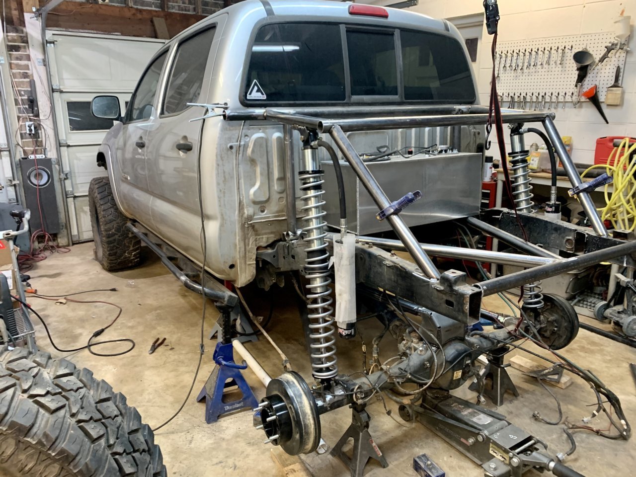

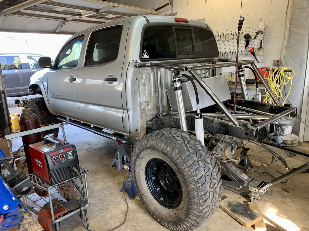

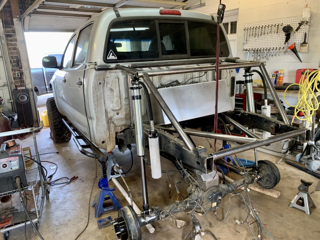

    Nah just the bed cage. Going to tie into the sliders, add some more triangulation and build a tire mount off the back. I don’t like the short stumpy look so I’ll hang the tire off a bit to even things out. Double cab problems haha

    It’s a crazy amount of travel. Coils will clear everything but the bump pad it appears. I left myself 6” uptravel, but I may be off on my ride height a bit so might be 5”. Do you know the thickness of your leaf pack?

    I'd have to measure. I can do that tomorrow for ya but I think it's about 2-2.5"

    That’s what I was thinking. I’ve been using a 2” block and the factory bump as a reference point.

    Well these coils are a lot easier to get on than the front. No spring compressor needed.

    Looking good, what spring rates did you go with?
