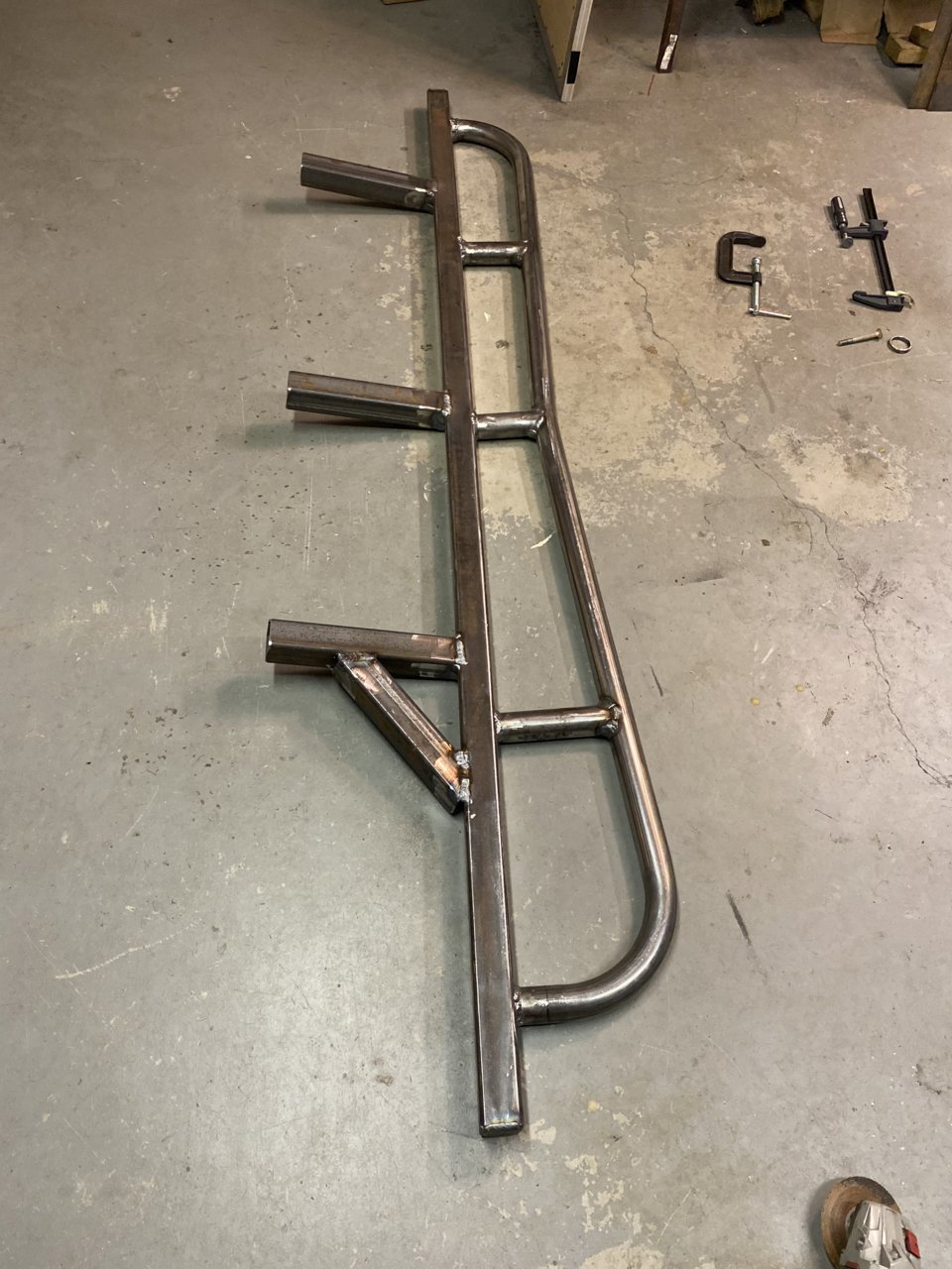

    Almost done. Just gotta do the final welds on main slider and weld frame plates to sliders. Then be ready for a test fit @Thunder Fist
