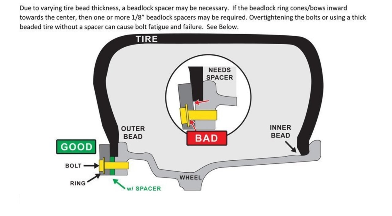

    Got the first ring on fine but on the second I’ve snapped two bolts on the final torque.

    Thats no good, are the rings coning?

    Yep this one is. Not sure what to do about it

    Spacers, you can buy them but they are pricy and hard to find in stock, I used a fan belt

    edit: reading the description makes me believe that would work. Think I’d need longer bolts?

    You shouldn't need longer bolts as long as your spacer is not thicker than the tire bead.

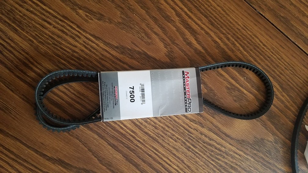

    I used used a v-belt
    You can see it in this picture

    Yes, the bolts do not go through the belt, a lot of people use v-belts because they work well and are a lot cheaper than the rings they sell. One ring is around $18 and only 1/8 inch thick, so you may need 3 or 4 per wheel, could cost $68 a wheel. That v-belt in the picture cost me under $6. The side you see in the picture is the thick outer side of the belt.

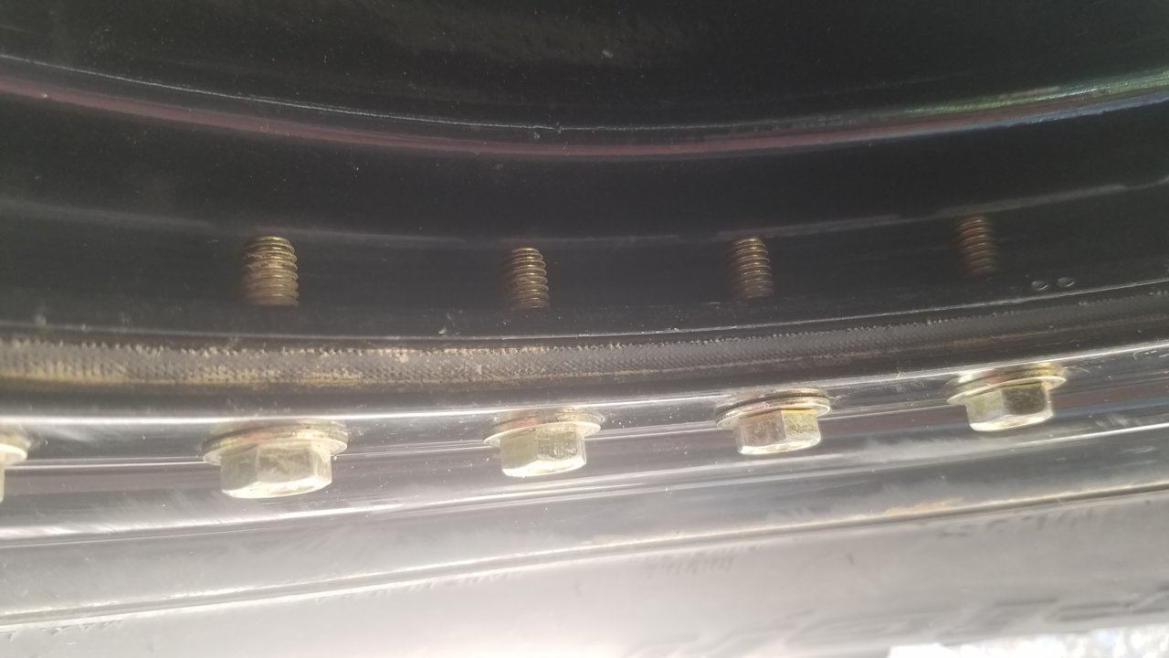

    Apparently three of my five tires have a bead that measures 0.75” and the other two measure 1”. That explains why one fit fine

    I have seen that before, they will pull down a lot.

    Looks like you have a pretty good groove where the bead sits on the wheel you shouldn't need much.
