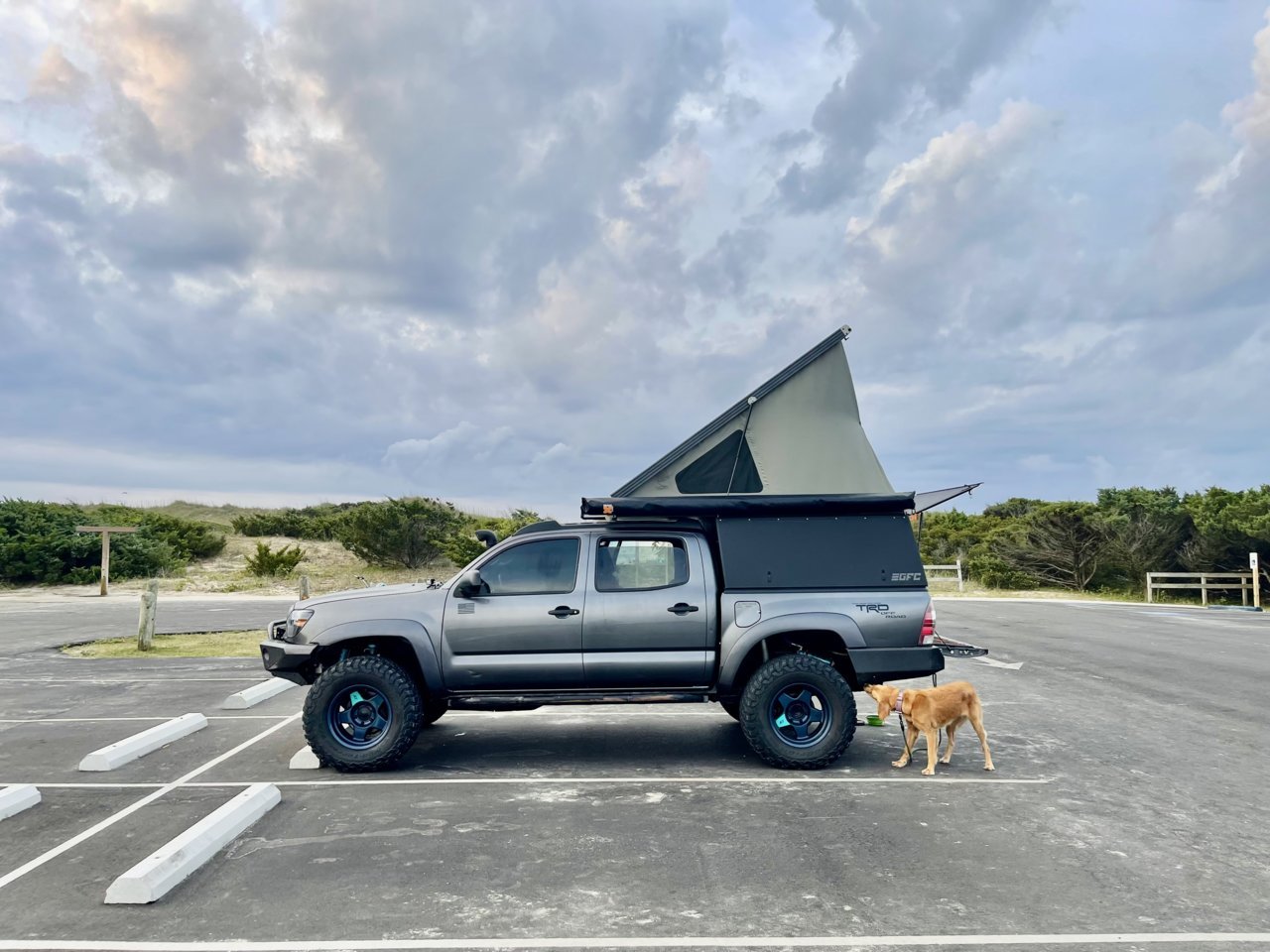

    Have a few questions for y’all(in addition to the one I posted the other day):
    1. Those of you that have the URD LT headers installed; what did you do to minimize the additional heat the headers generate? Didn’t anticipate the extra heat they create and sitting on trails with the AC on, the factory cooling fan just doesn’t cut it, even with the oversized radiator. MASSIVE amounts of heat soak with these things. Everything in my coolant system is new, with the exception of the hoses (thermostat, water pump, radiator, fan clutch, etc…) I think my options are wrap the headers, ceramic coat them, and/or put louvers in the hood to allow air to come out? I’d even consider possibly putting my factory manifolds back on…
    *EDIT - just realized these headers are ceramic coated from the manufacturer, so that removes that option… honestly don’t know if the performance gain of these is worth the additional impacts all the extra heat generated will have…hmmmmm…. Reinstalling factory manifolds would also probably mitigate issue #3…
    2. I’m considering a regear + a front locker. For those of y’all that are supercharged, regeared, heavy and offroad, how long did your rear end last after regearing? I’m on 35’s, fully armored, ~1000lbs in the bed. I’ve been apprehensive about regearing as it would make an already weak diff weaker (smaller pinion) and I’ve already gone through one diff (stupid line). When I talked to folks at ECGS, and I quote “a regeared diff in your setup will see a limited life on earth” lol. The route I want to go is a Dana 60 but $5.5k vs $700 (as far as ECGS goes). I know it’s largely dependent on driving style but just figured I’d see if they are blowing immediately or holding together for a while under a bit of abuse.
    3. My current exhaust setup has a ton of rasp from 2-3k RPM. I have the URD LT headers to a custom 3” setup from the headers back. I have a 3” vibrant ultra quiet resonator into a 3” RAM muffler. I don’t mind a little volume, although I’d like it to be as quiet as possible. Absolutely can’t stand the rasp though. I was thinking of swapping the muffler with a Walker quiet flow muffler but then have also had recommendations of adding a high flow cat or another resonator. Any suggestions?
    Pic of truck in question:

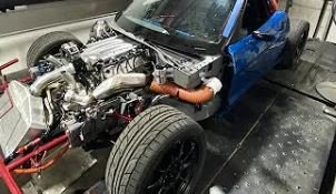

    You ever watch Taylor Ray on you tube? He is building a corvette into a comp drift car. He put a boat blower and ducting on each side of his engine bay to help evacuate hot air. Don't know if it really works yet as he just got it running but seems like it should work. Also wouldn't be too expensive if it didn't work. you can see one side in the pic.

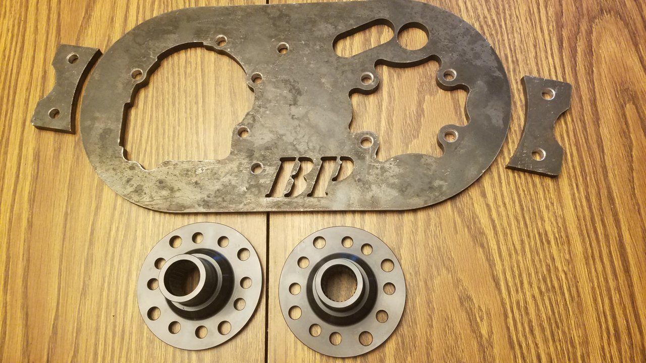

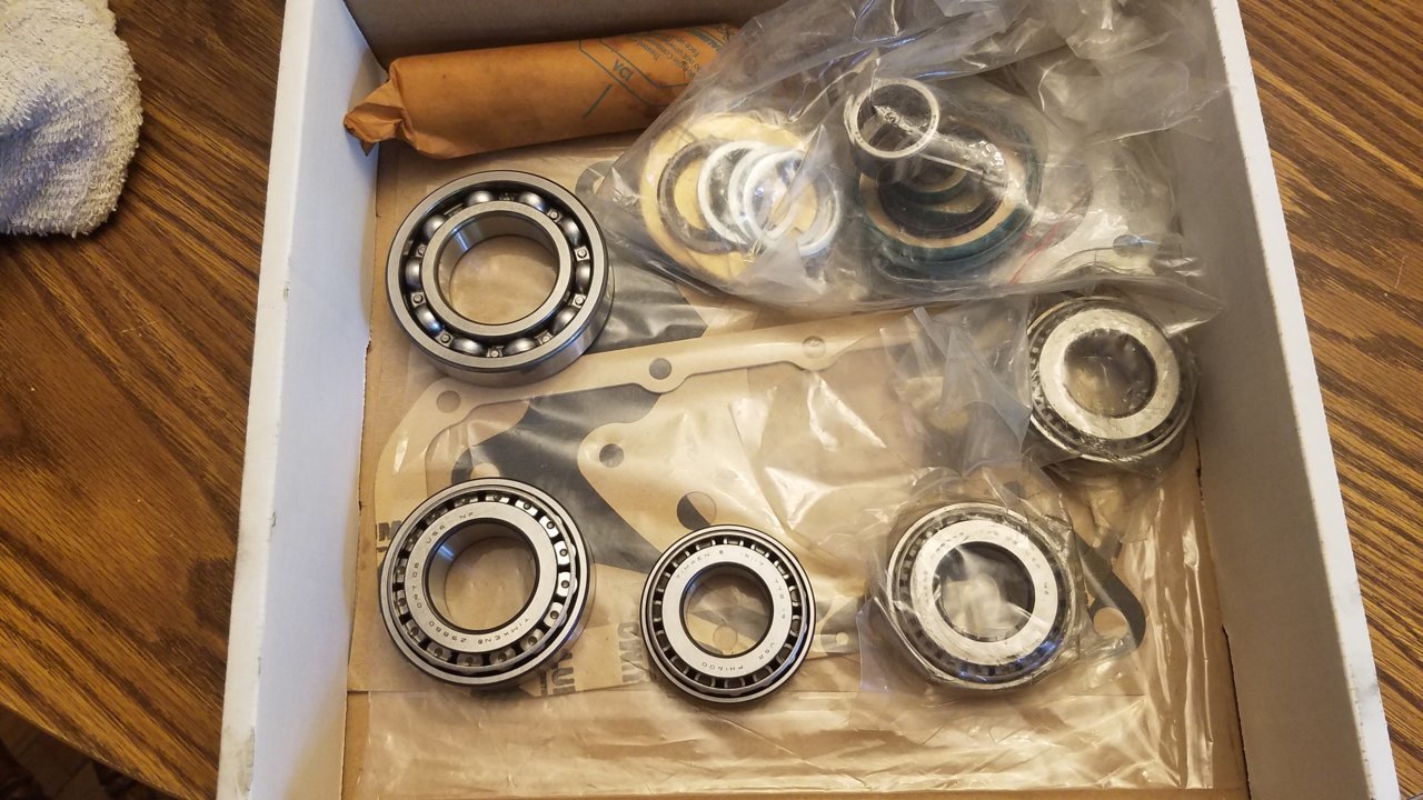

    Got some new parts for my Dana transfer case. Got a 3/8 crossmember, rebuild kit and two Dana to Toyota triple drilled drive shaft flanges.
