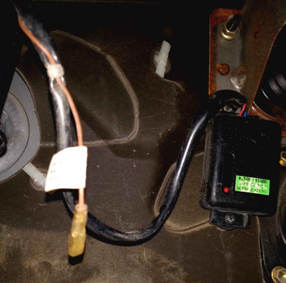

    The Audiovox type you just look under the dash behind the fuse box area and there were several large boxes labeled "shock sensor" and so forth which you can tell are out of place.

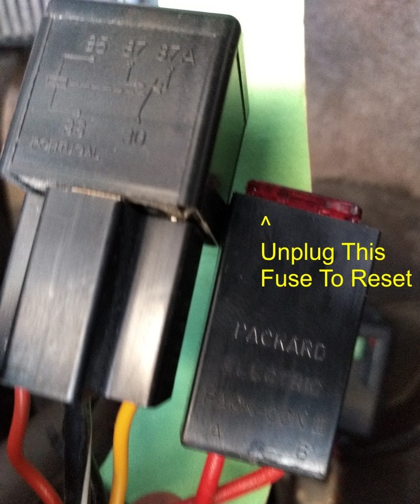

    I had to unplug this RED 10A fuse and then turn the switch on and try to start it. Then pull the fuse again, then plug it back in, rinse and repeat. Finally, it reset the system.

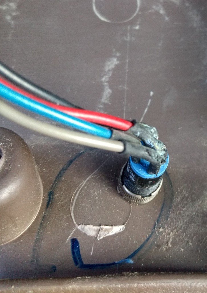

    This is supposed to be the little monitor light by the fuse box. Does this look familiar?

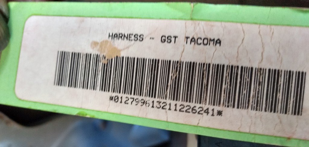

    This tag was wrapped around the wires where the fuse and the other box are together.

    Okay, so the only thing I remember matching mine is that red button which I think you posted a picture of the back of; look under the dash like above where your left foot would rest when driving are there any 2-3" plastic boxes labeled "shock sensor"? Its a white label in small print and has a part number too.
    I cant remember if you said, but the Audiovox type uses a boomerang looking remote.

    Found it just where you said it would be. It has a red light.
    The brown/orange wire's label says "For Remote Starter Option".

    Those wire connectors look maybe bad going into the monitor light .

    The monitor light and valet switch has been broken out. Not much left there.

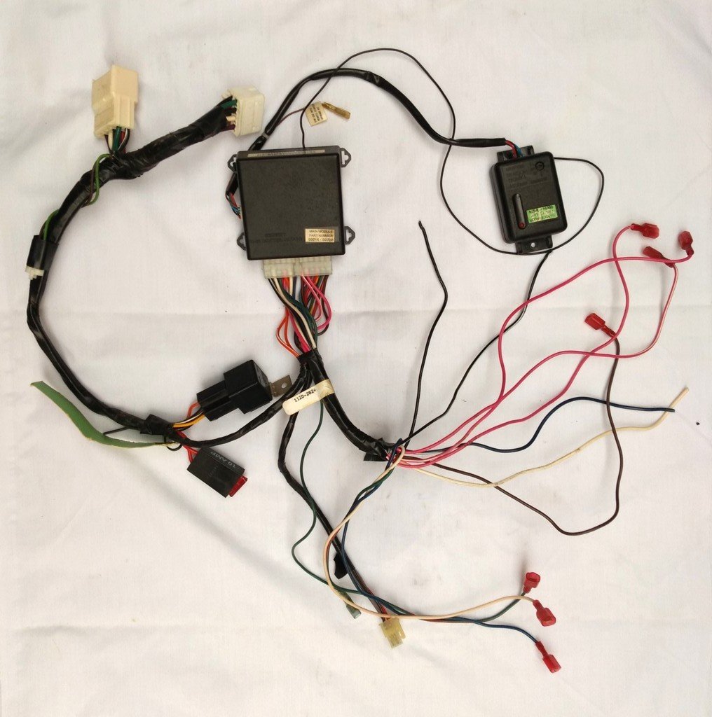

    Here's a picture of the troubled "Gulf States Toyota Alarm System". A friend recommended I stop by to see a local car audio and audio shop that where the guys actually have owned 1st gen Tacos and removed it from their trucks. They pulled it while I waited. It took them about 30 minutes. We can dissect this while I have the old parts.
    My recommendation is for owners with this system to get it removed before it leaves you stranded.
    Also, this removed the annoying door lock system.
