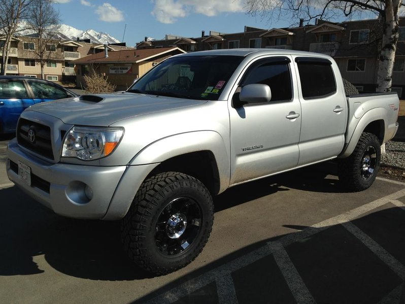

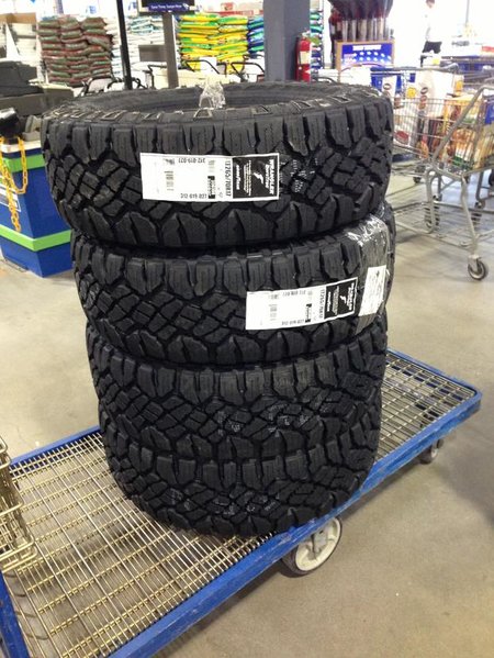

    Quick tip I just received from a long time mechanic and a different family member who welds for a living; they cautioned against welding those sliders that a bunch of people ordered to the frame. Doing that will weaken the frame and make it brittle since the engineers heat treat the metal so it can flex. The mechanic said he has seen too many cracked frames at the welds when it is strained during off-roading. They suggested welding brackets to the supports to align with holes that are already in the frame and bolting it on. Just thought I'd pass that info along. I recently bought John's sliders off him and decided that's what I'm doing.
    Also, just got my Duratracs in at Sam's Club. Had to buy new wheels since the new 265/70R17 tires were too narrow for the M/T 17x9 rims. Ended up getting 17x8 KMC XD Series 797 Spy's and mounted the Duratracs on them. Definitely a smaller wheel from what I had but I could already feel an improvement in acceleration over the 285's
