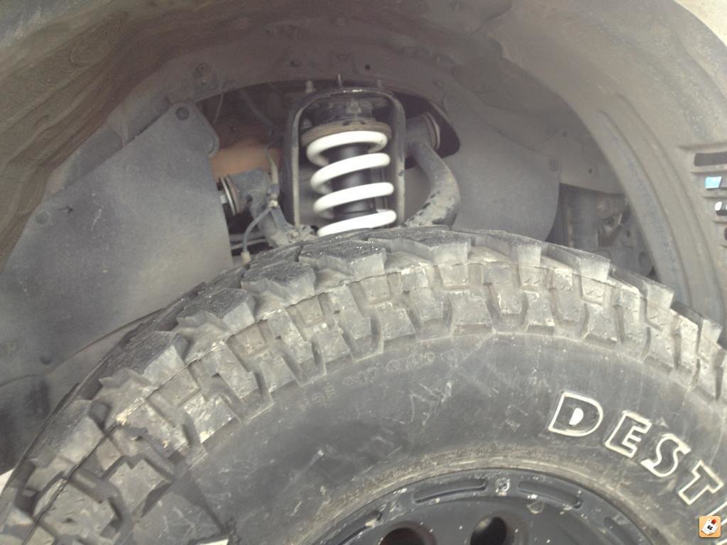

    Lol gotta take stuff when its available!!! AAL can be bought whenever :p and personally, if it were my daily driver id go without the spacers and have a little less lift rather than spend the cash just raise the back and now u gotta worry about the brake lines and driveline angle and all that that starts happening when u keep her up above 3 inches. Gets annoying after a while. But thats just me.

    I like the whit springs :D
    Like nick said, id just get rid of the spacer and get the bumper while its available! :)

    Yea. Those are my thoughts too. The 2.5" lift I had has always been just the right height. If I leave the spacer, I gotta spends tons more money down the road, which honestly I would not be looking forward to doing when my truck is a daily driver/ part time off roader. That was going to be my question to you guys- lift the back more, costing more money? Or just remove the stupid Ready Lift Spacer up front. I still don't know wtf the guys at underground were talking about saying THIS 2"spacer fit, yet the ones I wanted for just an additional .5" wouldn't! They must have been trying to stack spacers, but that makes no sense, I don't think they'd be that dumb to try that. Sooooo, looks like this weekend ill get under there and remove the spacers and see how it sitswith just the coils. I don't think I need a spring compressor to remove a TOP spacer, right? Maybe u can tell me. Here's a close up photo. ydarare8_9d199fd2fefb4ed782ee6c3618df0245a27bbf06.jpg

    If u want to try to take it out withought undoing ur LCA and strut mount then it might be nice. But itll scratch those pretty coils. Id just drop the lca and undo the top screws of the coil and it should lean out towards you just by pulling on it. Enough to get a spacer out i would think. But i think your picking the smarter route. Your truck is more than capable with the 2.5 inches you have and will drive a lot nicer and cost less in the long run lol. And that bumpers gonna look real perty like on there ;p

    It drives like shite, by the way. Probably because of the extra spacer on top. The front end has got to be pushing close to 4" over stock. WAY too high.

    Ya thats too much haha. Take em out itll be much better lol

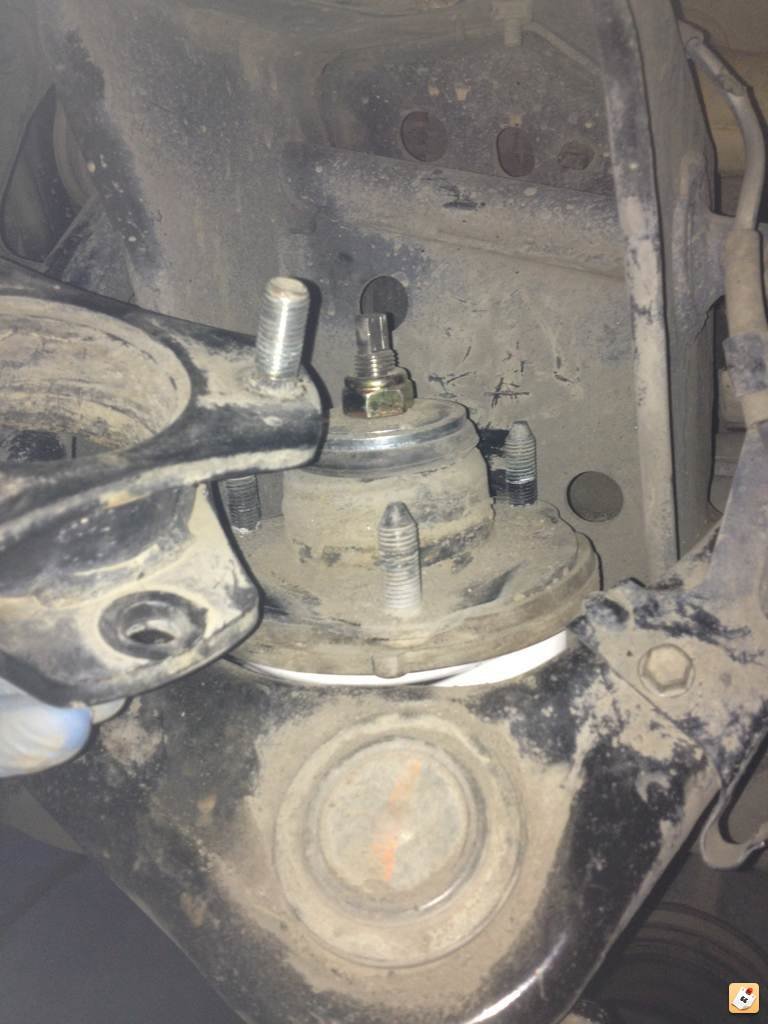

    Underground owes me a refund. Now that I've got the ready lift spacer off, I can see they didn't even attempt to use the longer top bolts provided to put the 1/2" spacers in. yte5a5a8_18cc680083ca99312818669c6efda43f006e72c0.jpg

    Damn $400 :eek::eek: if I wast on kodiak I would prob scoop that bad boy up :mad:

    ....and this is why i HATE having other people work on my truck. Too bad we don't have tons of free tome, tools, and shop space....
