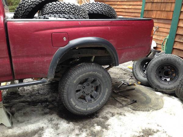

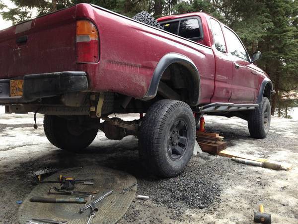

    found em: keep in mind that the droop was only from the weight of the axle and tires pulling down, if it had been out on a trail with the opposite side compressed I would guess that both before and after would droop more.
    before shackle droop
    after shackle install droop
    and ride height with ~250lbs of tires and rims in the bed
