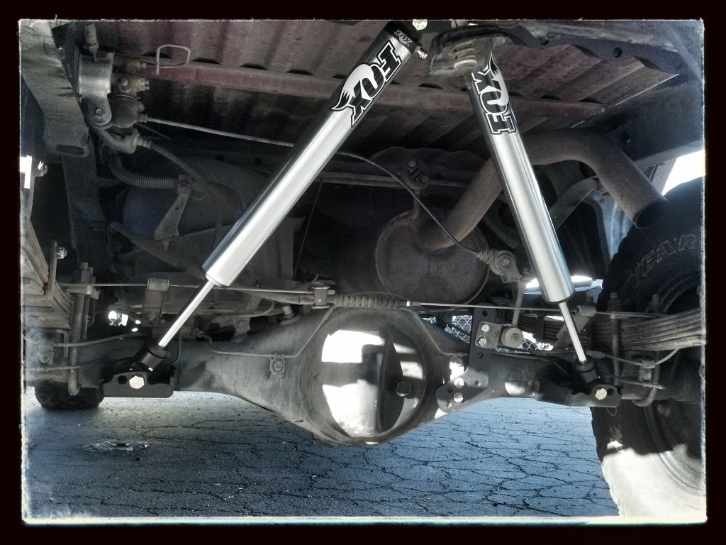

    Yep. I was thinking of keeping the | | rather than a pure rock crawler /\
    and obviously I ditch the spare at this point, just keep it in the bed I guess.
    Hopefully with something like this BAMF kit, even if I just make a cross member to mount them to

    I believe Matt made his own cross member and did his like that not too long ago. l l not / \

    And yeah, I did. I'll hopefully be getting some longer shocks soonish. The crossmember I made is great, but instill think the cheap 5100s are limiting my droop

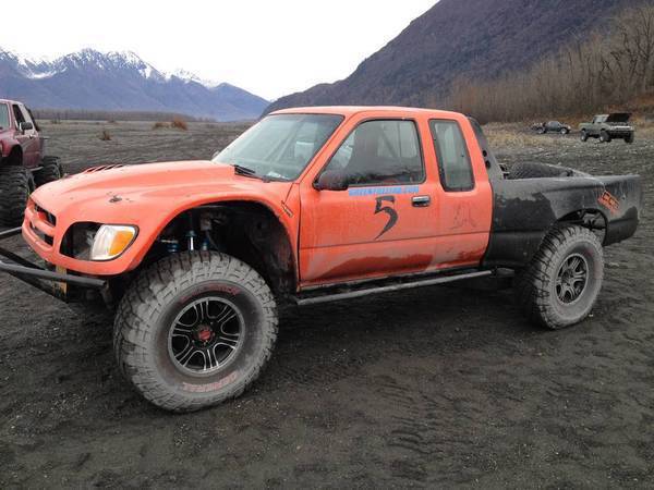

    I want to say some 12" fox's sound cool. :notsure:

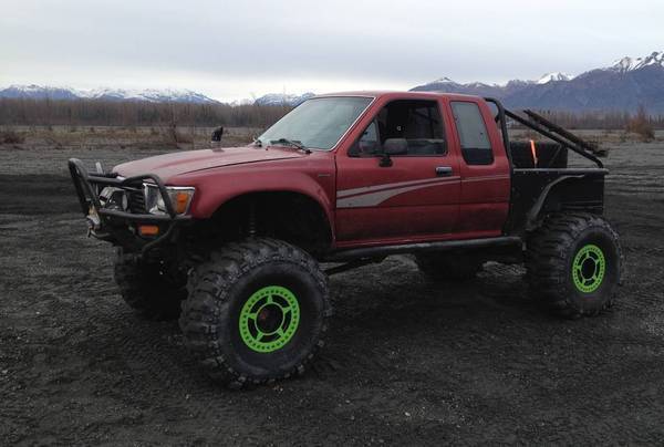

    ^^^ this thing

    My friend Slodgetto did his V with I think 14" foxes

    That thing was nasty lol. I'm not going quite that crazy

    If you want to keep the shocks like ||, I don't think you have room for a 12" stroke shock unless you go with a short body. Plus, when you move the shocks closer the the center of the axle, you can get the same flex with a shorter shock.

    Unless you have longer shackles or a super flex leaf pack, you really done need to relocate the shocks though. But if you're gonna do a 63 swap, go for it.
