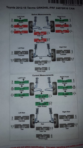

    Ok guys... So I have this godawful vibration. That appeared after my fucked up year long tires are shit fiasco. I now have new tires. I watched them zero it out on the balance. I also got an alignment because my uniballs were shit and had a ton of play. It was so bad the guy asked me what the hell I had done to my truck. They have also checked my wheels for balance and they are fine. So I am thinking that the vibe might be elsewhere.
    I always get a vibe from 40-50 mph. Sometimes at higher speeds too. Sometimes at lower speeds. At low speeds it feels like I am driving on rectangles. Sometimes at lower speeds it is smooth though....
    Any ideas? It is making me a little crazy :(

    Did you fix your clutch yet?
    Maybe u joints?

    was the driveshaft put back together correctly for balance purposes? a u-joint could be bad again. make sure all mounting points and bolts are tight and not missing.

    Yeah, it could be out of phase. Seen that a few times on our trucks

    Marked the drive shaft and pretty sure it went back together the way it came apart. Torqued all the bolts and checked em pretty recently. Ill crawl under it again and look at it to make sure...
