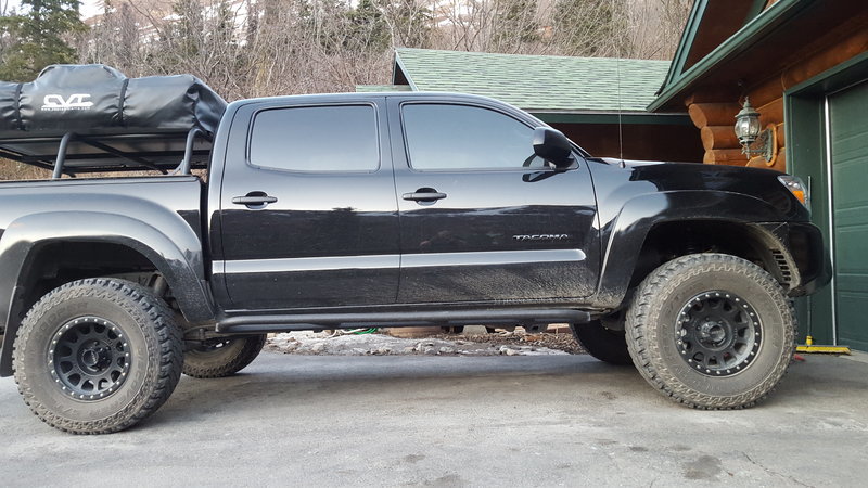

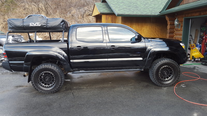

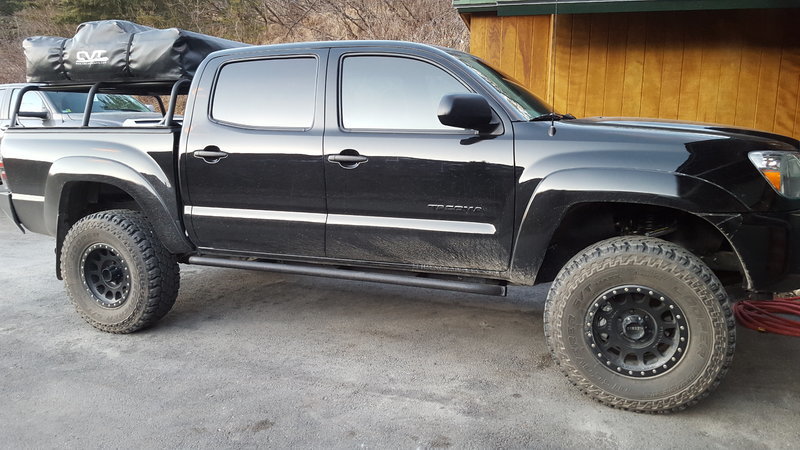

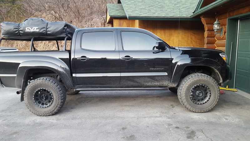

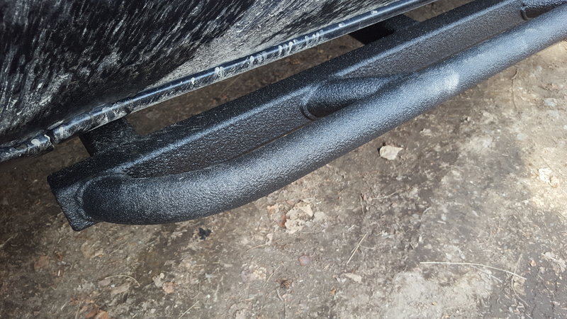

    So today I had Total Truck Accessory Center unbolt my Pelfreybilt rock sliders, rhino line them, and then bolt them back on. It took them only about 30 minutes to unbolt them, and 30 minutes to bolt them back on. Which I was impressed by. They look great but I'm curious and wondering if they didn't put them on right, because of the space between the front passenger door and the slider, it just looks bigger than it used to be. When I had Green Tree Fab install them for the first time back in August or July they said it took them 3 hours to install them but they looked totally flush and the spacing was even from the way it looked. Am I missing something here or am I seeing things? The picture where my truck is clean is how they used to look before rhino lining and when GTF had installed them
    Look at the gap between the bottom of the rocker panel and the top of the slider

    Loosen the bolts and readjust them if they aren't perfect. Shouldn't need a shop to do that

    Double check along the frame that there isn't something snagging where the break lines run.

    I will if I need to but just didn't feel like messing with them if it wasn't necessary

    Can also get one end bolted flush and tight. Then use a jack to help push the other end up to the frame and bolt it down all the way.

    I was wondering about the brake lines, I thought you had to reroute em, not sure how long that'd take em in case they didn't do it and it should've taken them longer, I'll take a look today

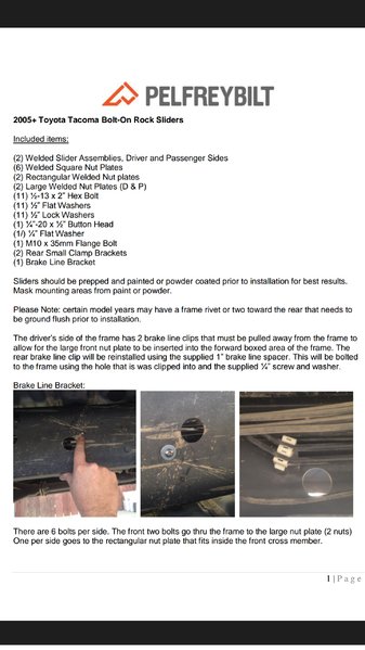

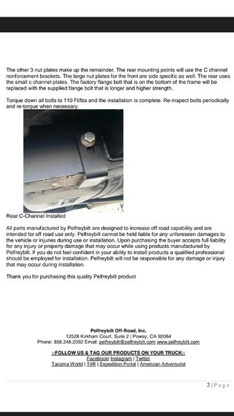

    6 bolts to the frame + more, see my problem is I don't have the right tools so I always rely on a buddy down the street when he's available lol which isn't often
