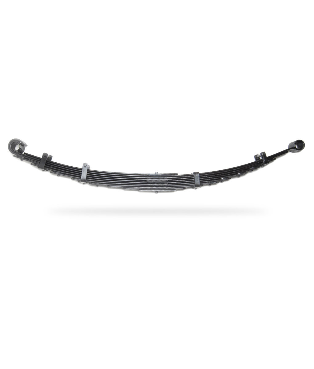

    Post a pic of them. The forward spring eye is usually larger.

    Here is what I am talking about.

    Smaller eye connets to the shackle. Larger eye connects to the frame. Good luck and safe wheeling.

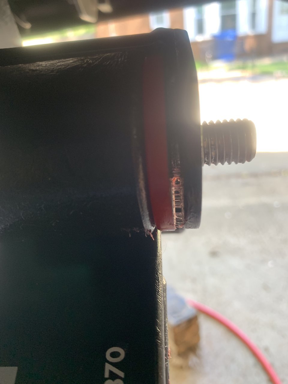

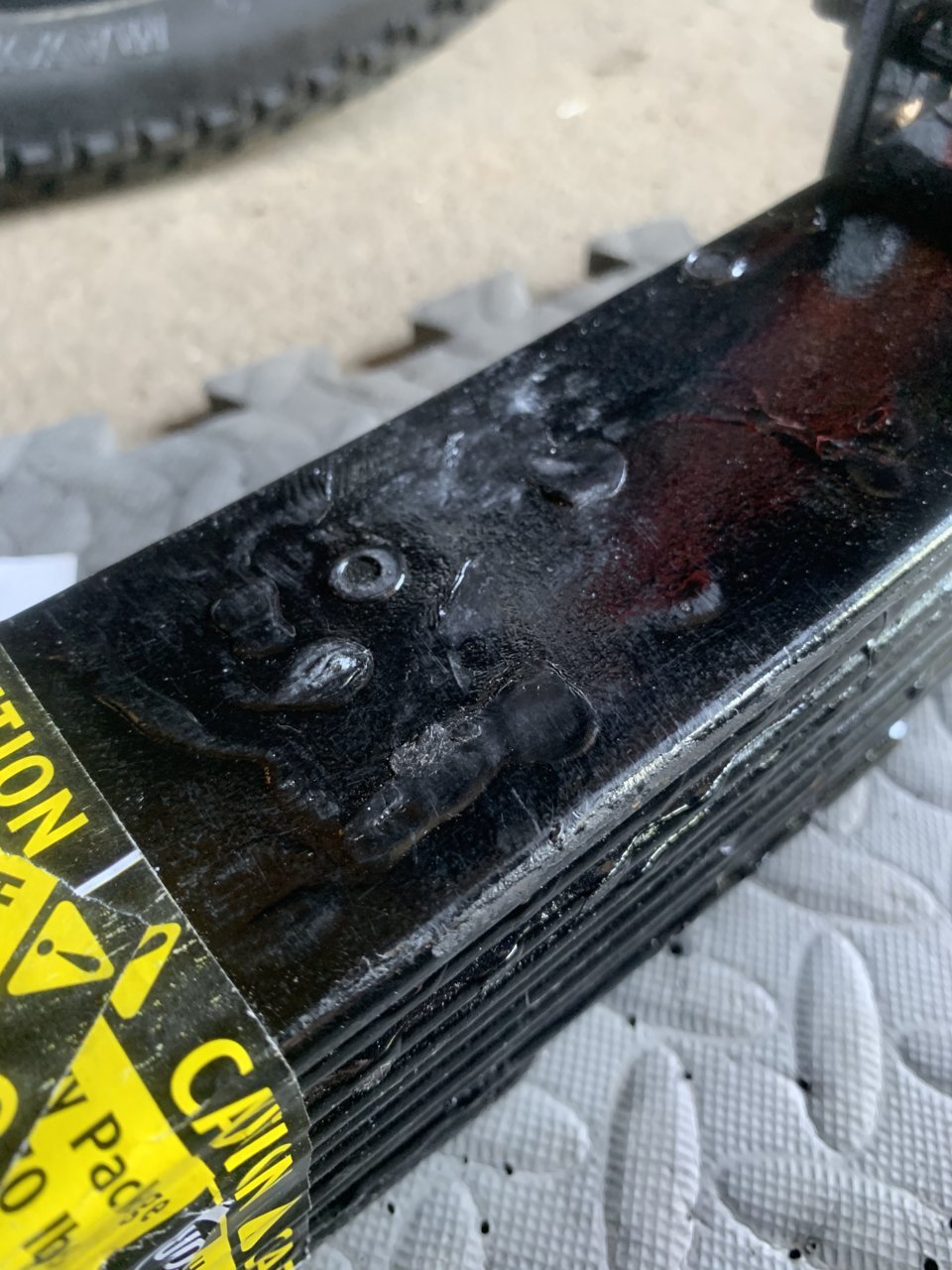

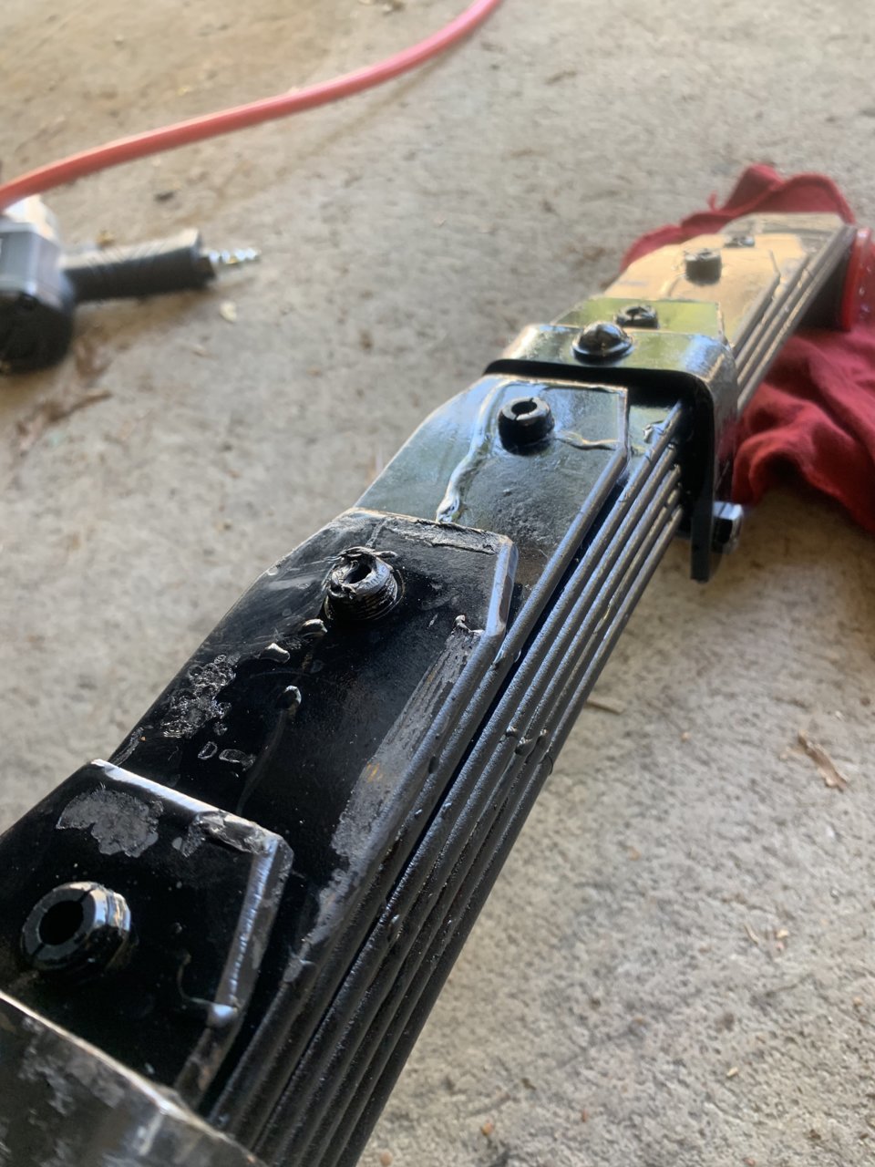

    Ok, it appears that Alcan does not give a damn when it comes to QC. My leafs were shipped still with wet paint and there is runoff EVERYWHERE! One of the spring retainers is already falling out and to add to all of that, the pack is .115” narrower so it has good play in it.
    Now I have to find shims for this Tacoma frame rot cover up paint job leaf packs. Wonderful.

    Is it really paint? Or grease/lubricant?
    I ask because I'm about to order some leaf springs, and it seems a lot of companies ship these bare. They're coated before being shipped out to prevent rust, and it's disclosed that they'll arrive with cosmetic damage (which is normal).

    Paint. It was squeezing out as I was tightening the ubolts. I got some grade 8 washers that fit in just right. One thing they seem to have forgot is to add more arch in the drivers side leaf to even out taco lean. I will go for a test drive and report back on the rest of it.

    Yeah the paint situation made it seem like they rushed my order even though it took 5 weeks before shipping. I wouldn’t care about small blemishes but cmon. This is some Friday afternoon, get out the door, idgaf attitude. Already one of the spring clamps is loose and dangling off the drivers back.

    I had a similar leaf pack. The stock bushing sleeves are a little wider. I just installed some stainless fender washers from fastenal so the ears wouldn’t pinch in on the bushings.
    The paint is more of a temporary protective under-coating. The Deaver’s I have now have the same coating with runs. It will be more or less gone after a salty winter.
    I really liked my Alcans; great ride. They’re on my buddies truck now, still going strong. Kept their arch too. Just do a couple initial retorques and another after your first off-road adventure.

    Careful @jp_flynavy dont over tighten the nut and or too thick washer. Can cause binding on the pivot and leak pack struggles to cycle smoothly.
