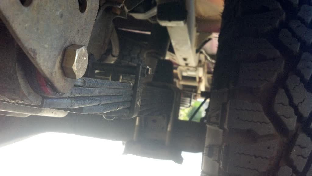

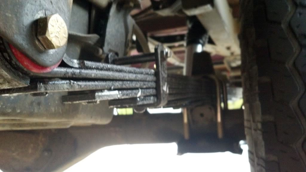

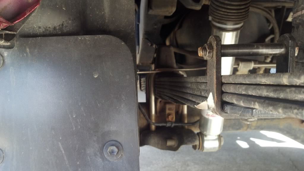

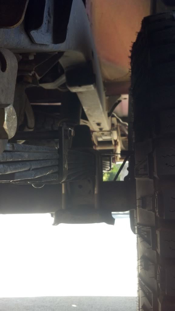

    I recently got a pair of Alcan springs made. Specs were stock height and 300 lbs over stock load capacity. Initially the sat nearly flat which I figured was normal and axle wrap was eliminated. After about a week or so the springs started to sagg and axle wrap started to come back.
    My question is, is this normal for tacoma springs to sit with a negative arch even with 300lbs over stock?

    Today
    This if a few days/week after install
