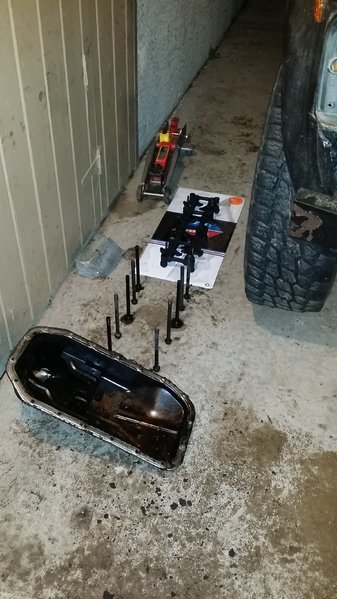

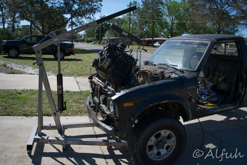

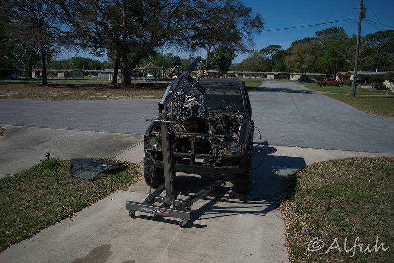

  7. Apr 8, 2016 at 11:54 AM
    #187
    Alfuh
    Alfuh [OP] It's pronounced alpha
    Aug 21, 2013
    #110878
    6,786
    Bismarck, North Dakota
    2006 Prerunner
    I have a few mods

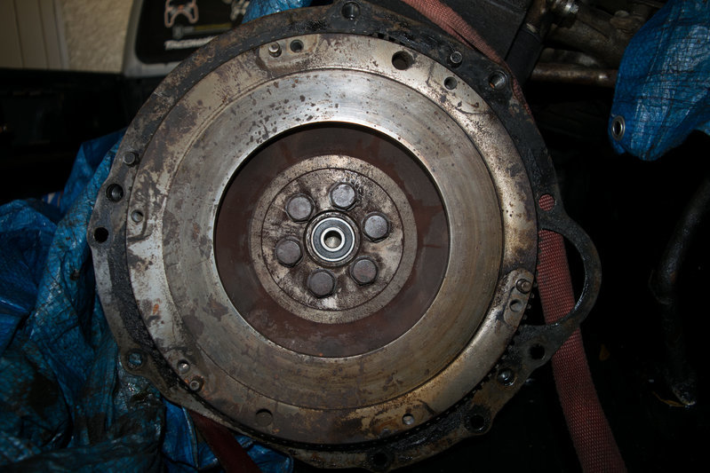

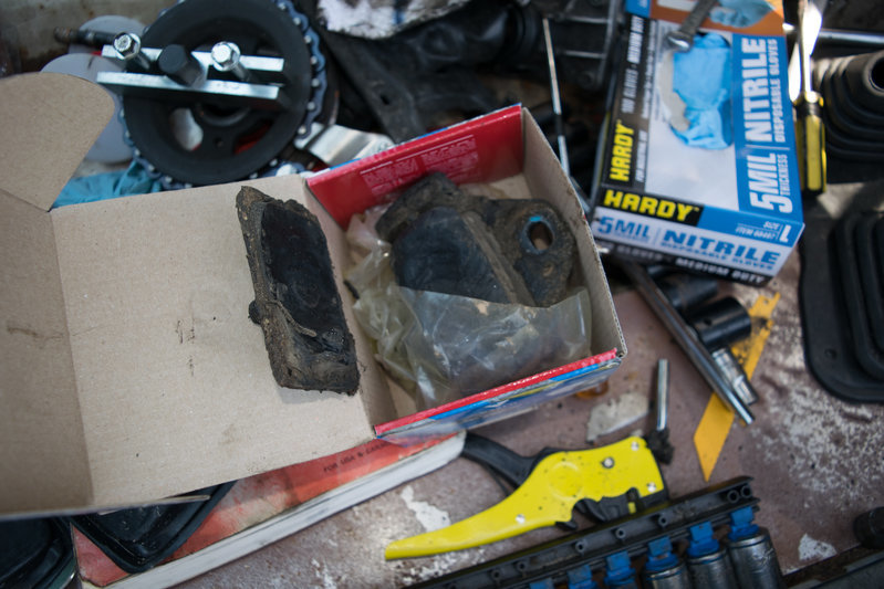

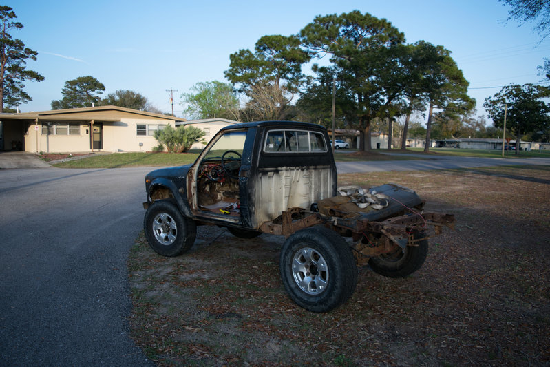

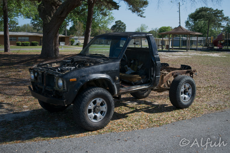

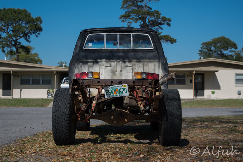

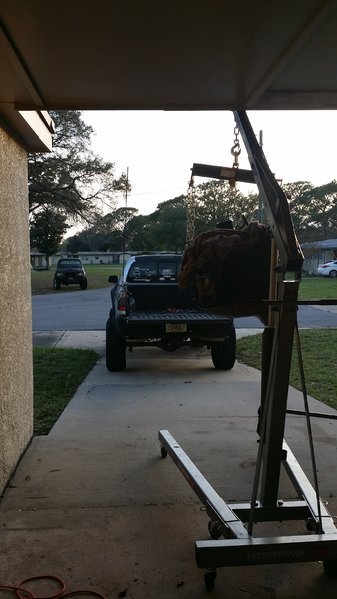

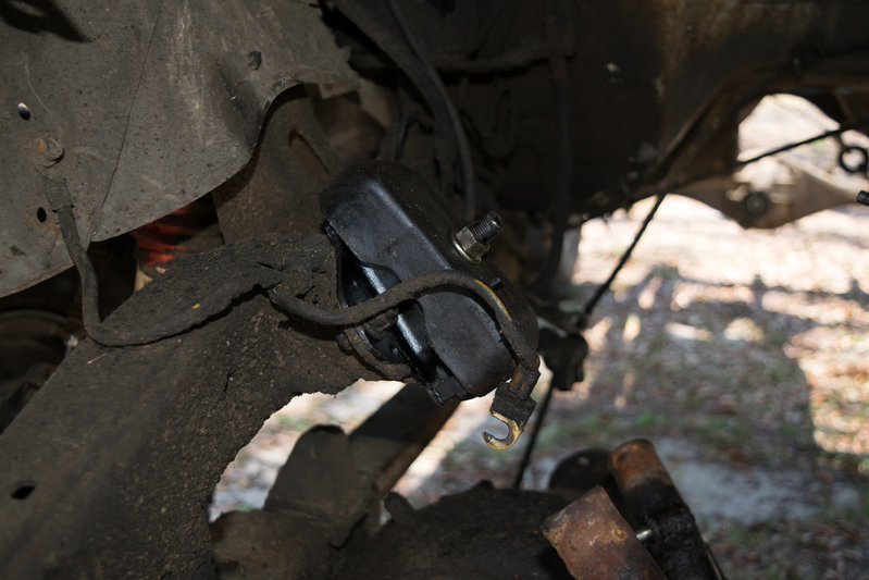

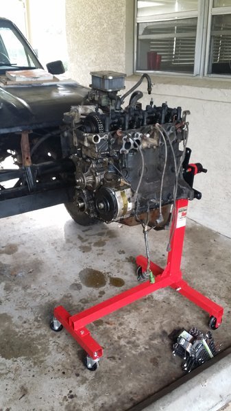

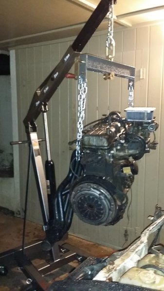

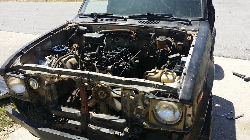

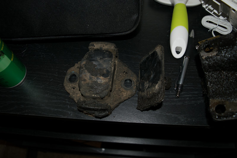

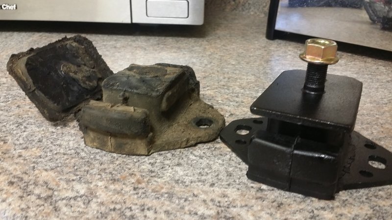

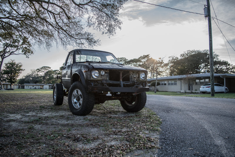

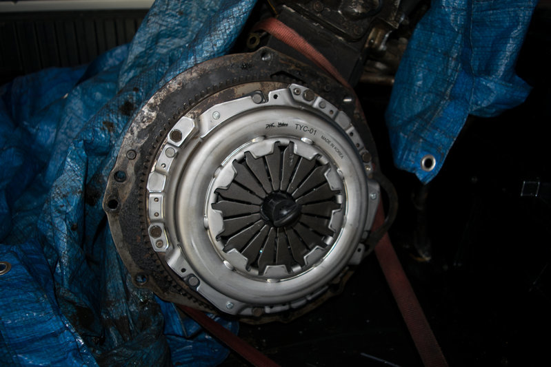

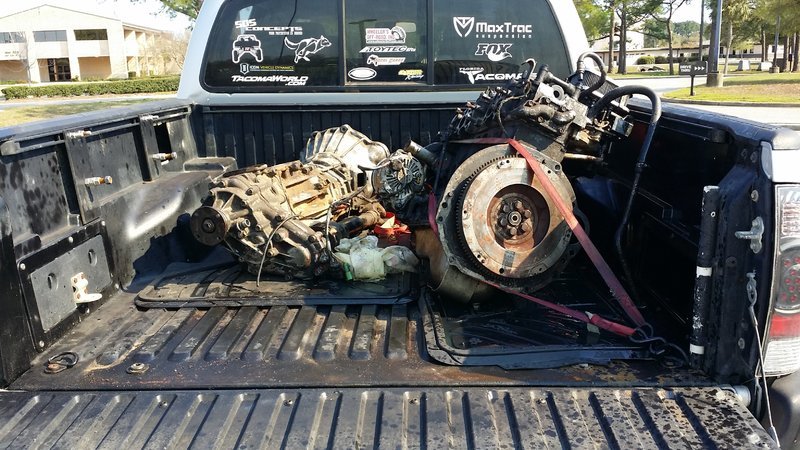

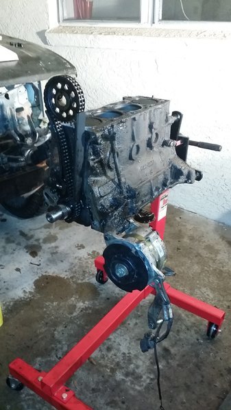

    man, havent updated you guys in awhile lol, a lot has happened in the last 3 weeks or so. finished up getting the timing cover gaskets replaced, but what I ended up doing was buying an engine hoist/load leveler/engine stand and taking the entire motor apart and replacing all the other gaskets. Cleaned up the motor as best I could, didnt replace the intake gaskets though since i dont see any issues with them; if they eventually need to be replaced, all that can be done with the motor in the truck.

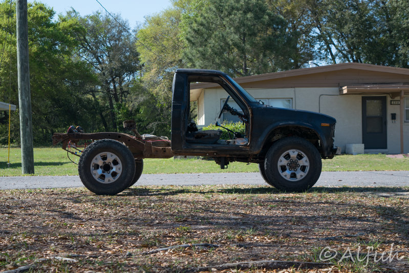

    Removed the bed while I was at it too since it is pretty much done lol, got new motor mounts since the ones in the truck were severely done, got the pilot bearing installed along with the new clutch and cover. Tomorrow hopefully the motor and trans will get put back in and I will be able to hopefully start driving the truck again....lol

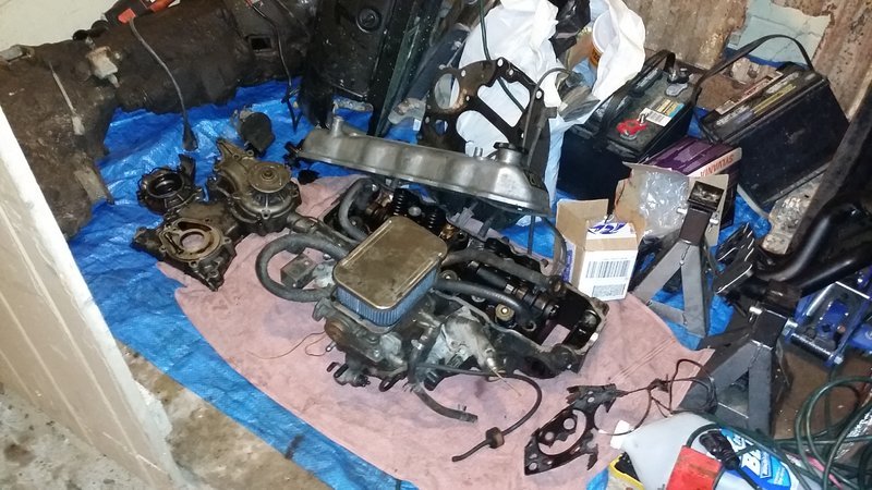

  8. Apr 8, 2016 at 12:01 PM
    #188
    Alfuh
    Aug 21, 2013
    #110878
    6,786
    2006 Prerunner
    I have a few mods
    More picture spam since I had to swap over to my phone to post these lol

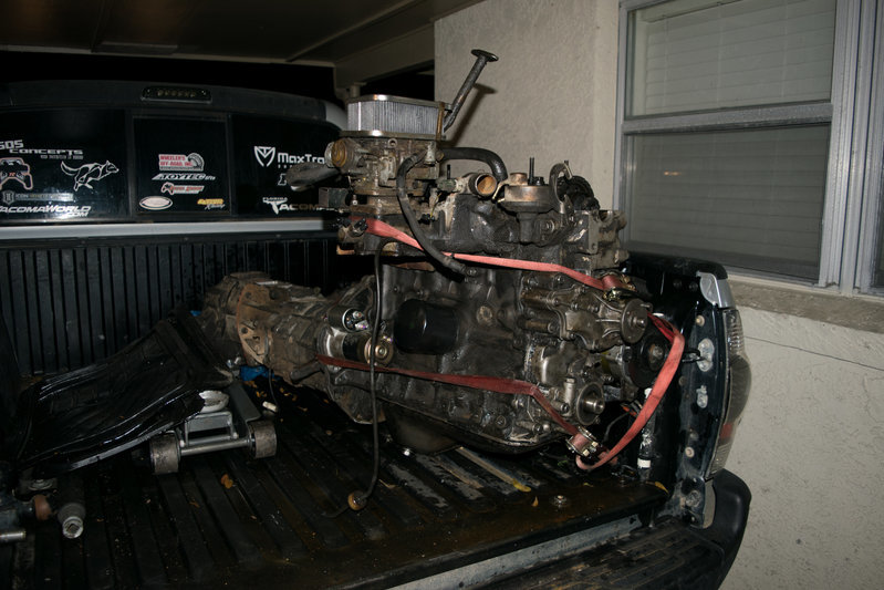

    got the trans bolted to the motor yesterday evening, motor is going in hopefully today, but I still gotta mess with the crank and cam to make sure they are lined up properly. crank looks like its at 8* BTDC and the cam is still at the 12 o'clock position. pretty sure they need to both be at 12

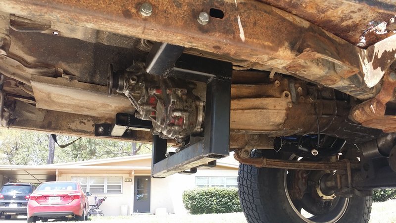

    One step closer to firing Aleu up! Motor and trans are back in and crossmember bolted up. Just need to finish up putting everything together and fill her up with fluids, and then lastly bleed the new slave cylinder

    Looking at the heads of the trans mount bolts, you may want to get a rectangle piece of plate to sandwich the frame.

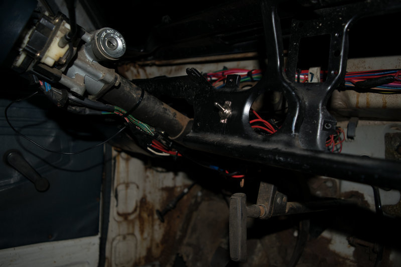

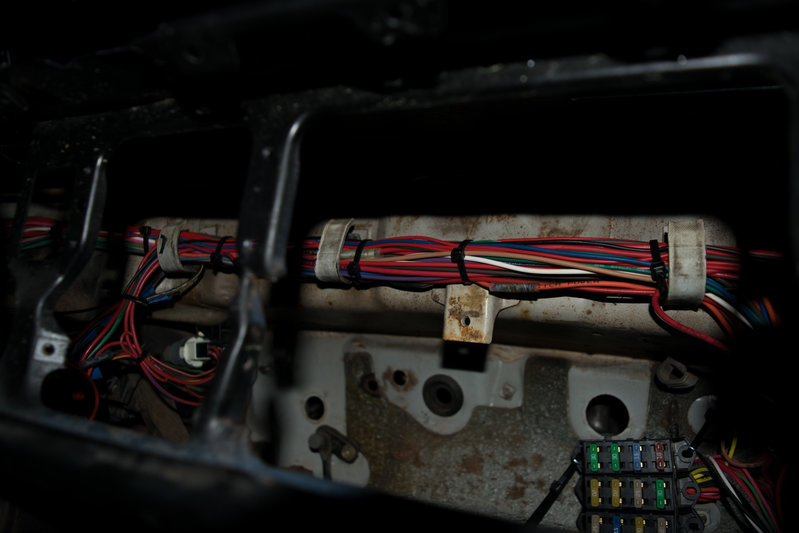

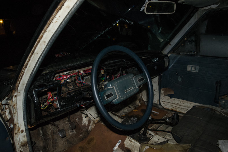

    got the doors, hood, dash, and grille back on today. Went and zip tied the crap out of the wiring harness to make it look nicer so the wires arent just loose everywhere. Fixed my headlight wiring issue I was having with the column switch connection AAAANNND I FINALLY mounted my headlight switch to the dash piece so instead of just being zip tied to the column, it's bolts to the dash now. nice and stiff and is really fun to switch on and off lol. The best part is I got my Toyota name emblems in the other day and she finally has her name badge on the dash!

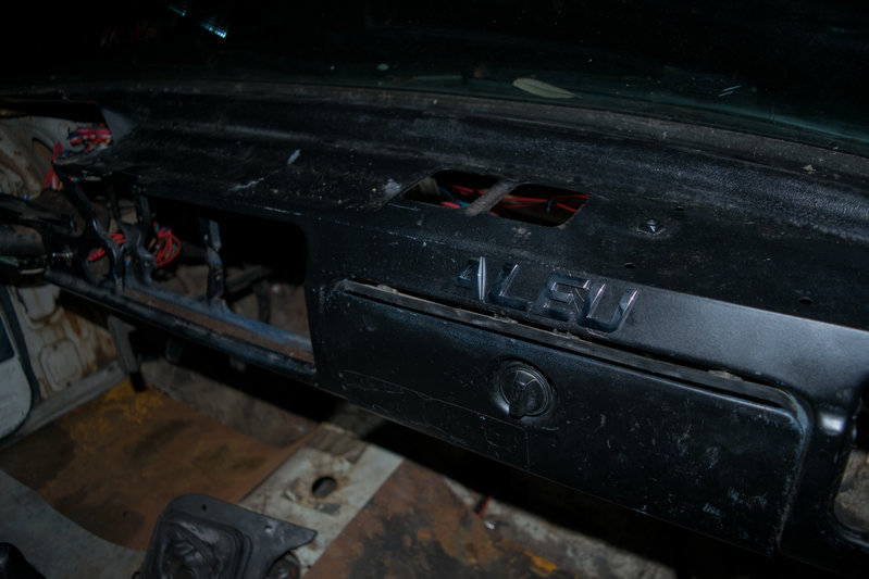

  20. Apr 13, 2016 at 7:47 AM
    #200
    Alfuh
    Aug 21, 2013
    #110878
    6,786
    2006 Prerunner
    I have a few mods
    Drove the girl to work today, really nice having the doors and dash back in. Finally have a place to put my insurance and registration now that my glove box is back in lol
