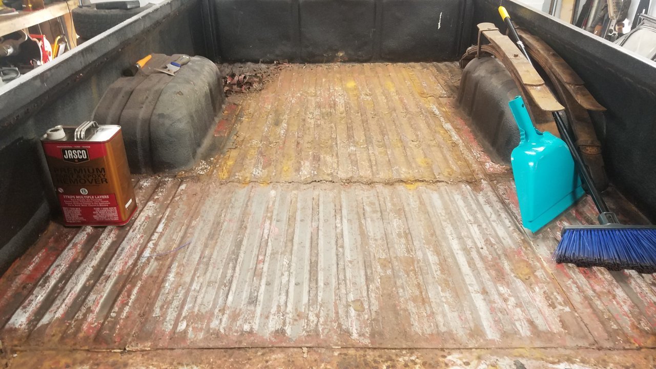

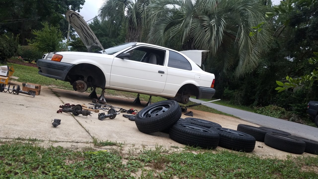

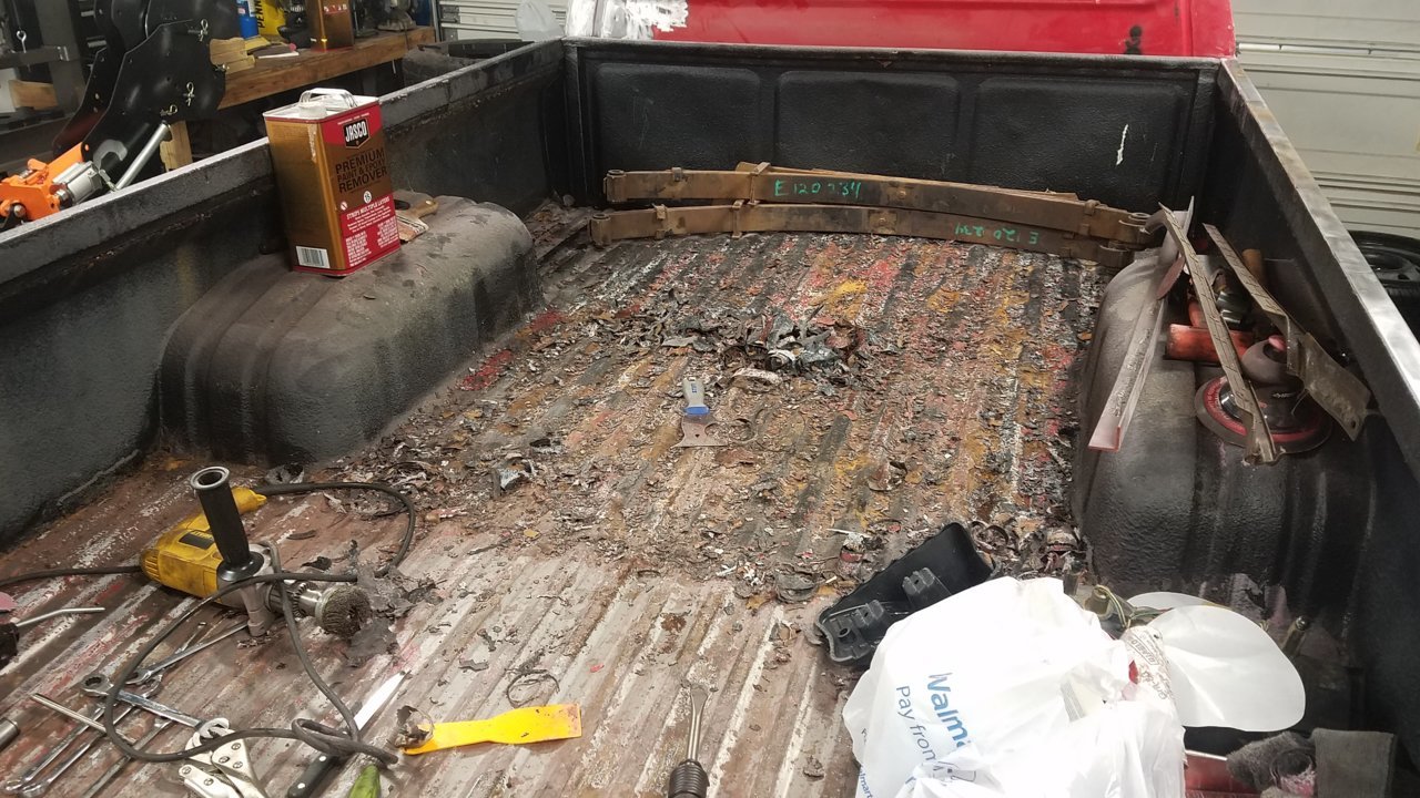

    ok so a tiny update today. i poured some more paint stripper on the back part of the bed to continue getting the whatever the hell it is of the bed lol. but i was caught up with working on my other turd with new shocks, tie rods, and wheels/tires.

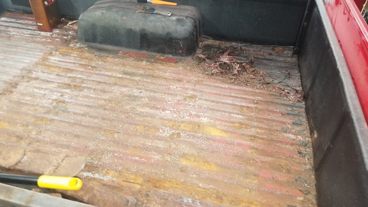

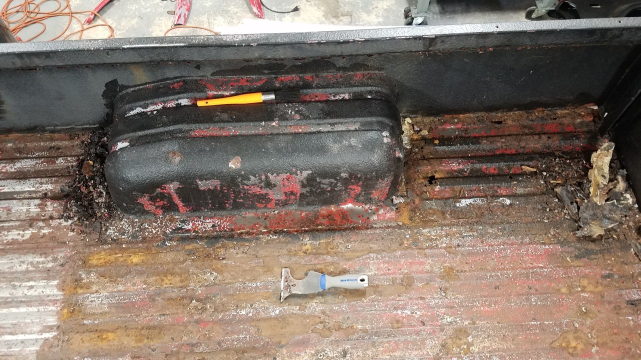

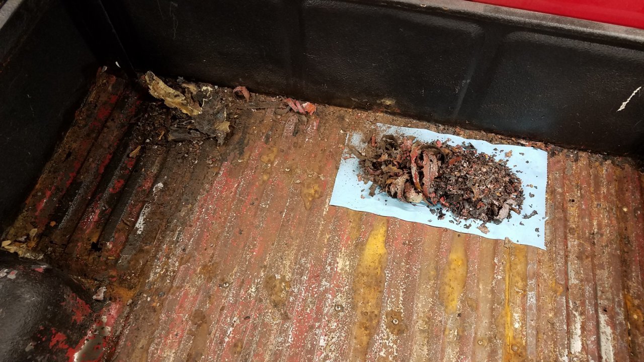

    got some decent headway on the bed floor. still a slow progress scraping this crap off...anyone wanna do this for me???? lol

    I'd consider finding a mobile dustless blaster dude to come by.

    they are charging way too much for what ive seen, unless my searching is being a potato, I havent seen anyone that would do it for around $300 or so. one place wanted $1500......I was like, no...I'll spend 30 hours scraping and grinding before I spend that haha
    Thanks lol, once I get this body done, it'll be smooth sailing from there!

    Those last gen Tercels were great cars. Very durable. Really the last of the truly rugged small cars Toyota produced.

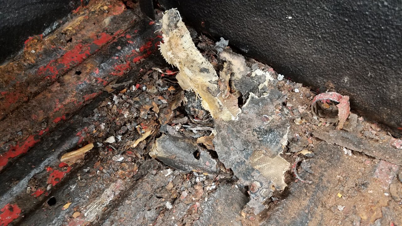

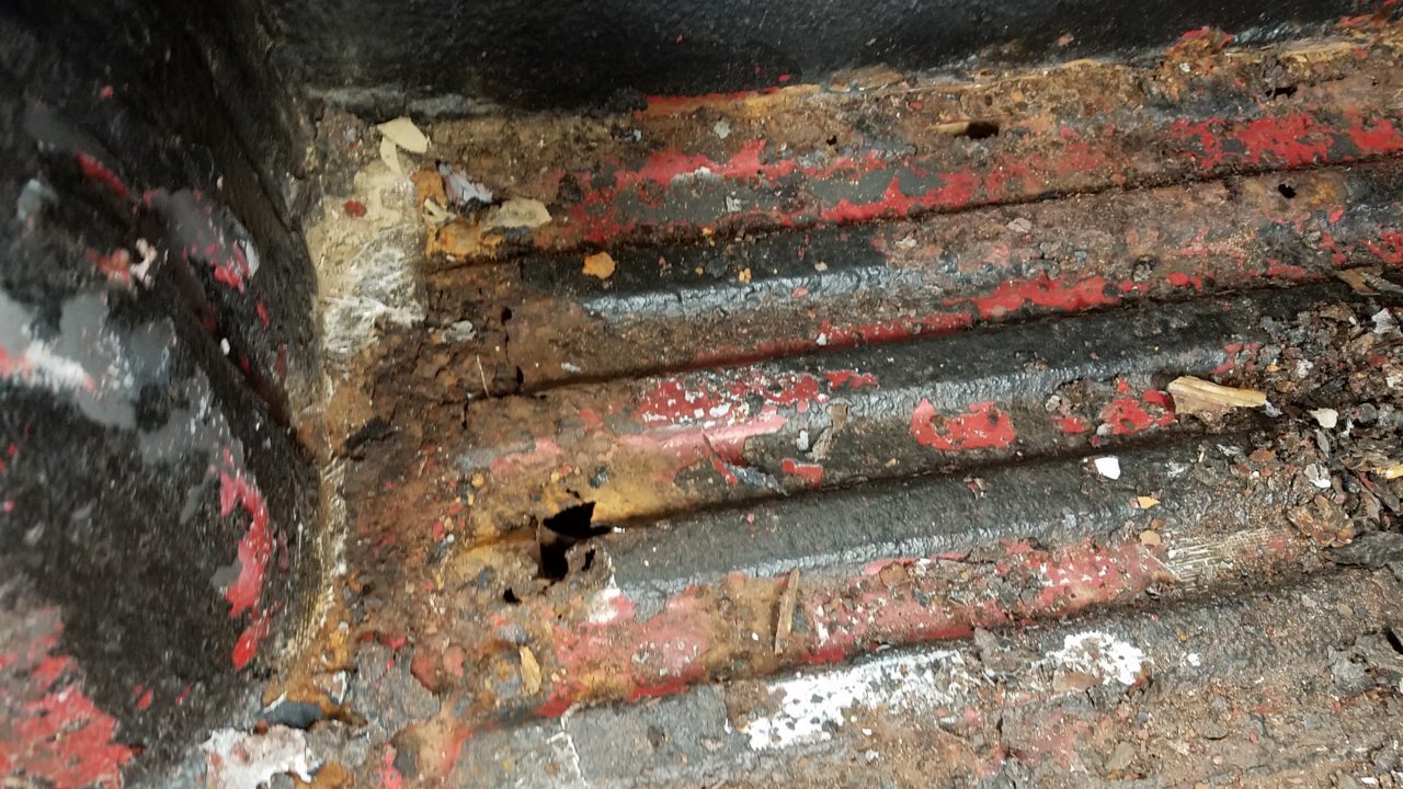

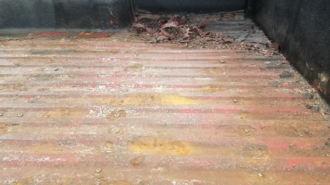

    late update, got a little further on the bed thanks to the help of paint stripper. found fiberglass and the first rust hole in the bed floor itself
    i know! mines a 97 and it had 7 previous owners and had 208k miles when i got it. smoked bad on startup, but she still chugged along and i fixed a lot of things on her and she is almost good to go as far as fixing things

    Is that entire bed floor fiberglass screwed over metal? I see all kids of screws that aren't original.

    no, there are only a few patches here and there. what the guy told that i got the bed from, the previous owner took 2 beds and made one. so thats all another bed that was screwed into this bed lol

    What's the plan? Wipe out the rust, patch holes, POR15, and bed liner?

    im not 100% sure at the moment. Definitely clean up the rust and patch the holes with sheet metal, from there, not too sure what to do; I would like to use POR15, but thats really supposed to be used on rusted surfaces and not clean sheet metal. From what I read it doesnt adhere properly and wont last long at all.

    I have gray and black POR-15 for projects around here, it lays really flat/glossy. I just hit the surface with about 120 grit so it has some grip, and do thin coats.

    ahhh ok, I didnt think about that at all. would it be good to hit it with some rust stopper from Bondo then lay down the POR15 or just clean the metal and lay the POR down
