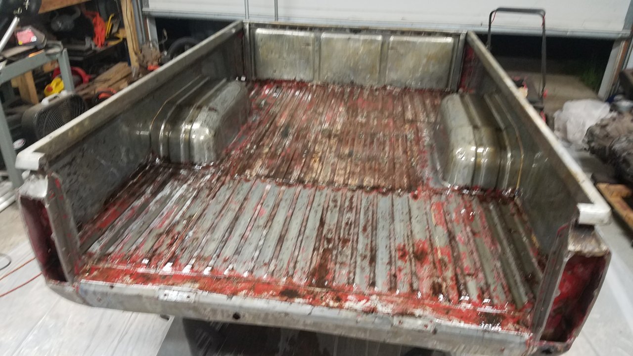

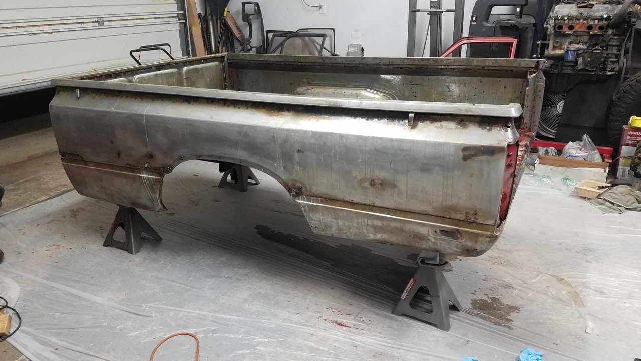

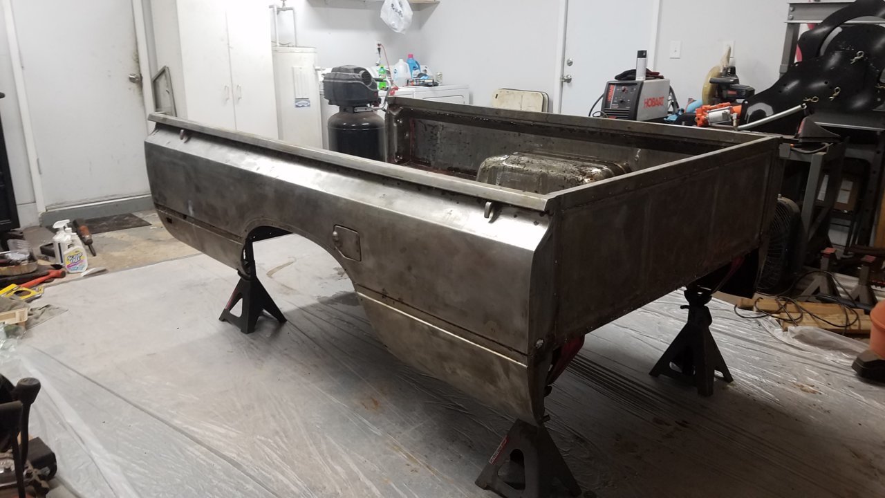

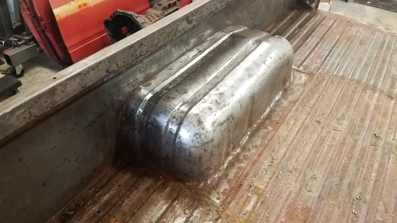

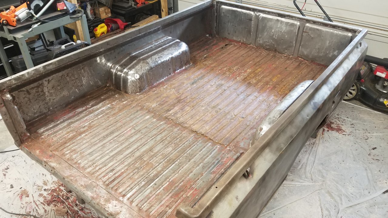

    finished up the wheel wells and got the bed floor wire wheeled. gonna wire wheel and clean the rust from underneath either later tonight or tomorrow. then once thats done, i can start laying down the POR and primer!

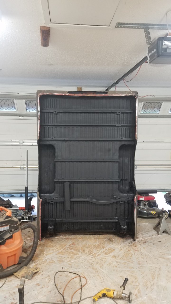

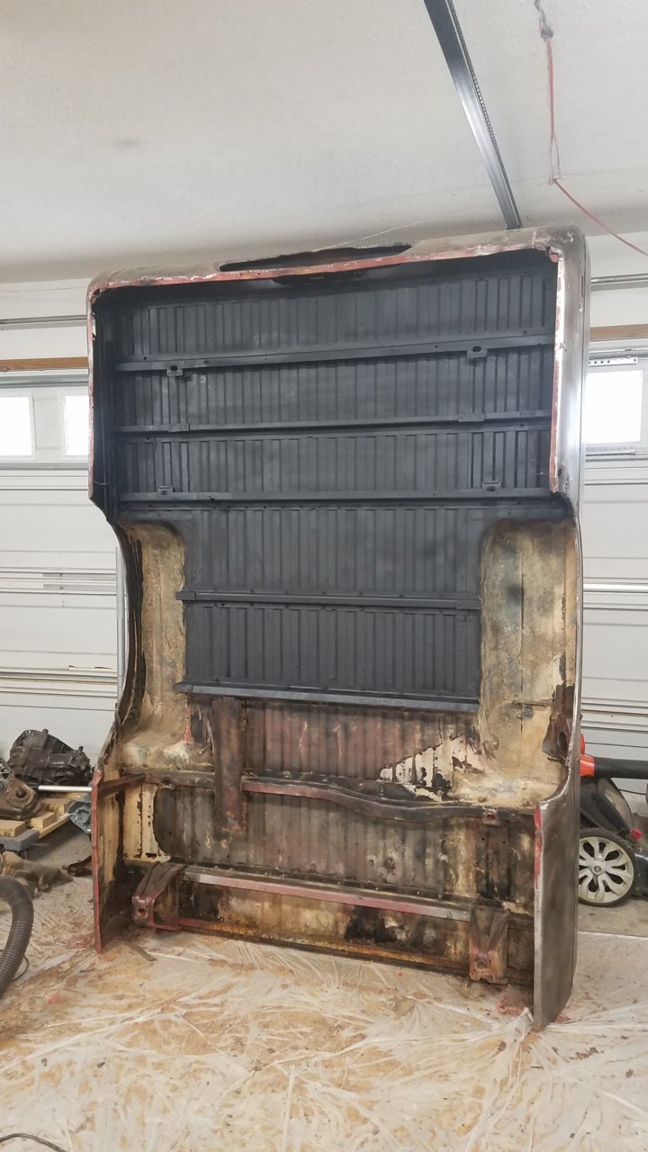

    well today was kinda short lived lol. completely forgot the rust converter requires 24 hours before you can paint over it. BUT the entire underside has been cleaned of all the dirt, rust converter sprayed, and i have an undercoating that will be going on. once thats on and dry....que the POR 15 and primer! cross your fingers...but i should be "done" with this bed by the end of this week.
    that way i can finally clean the garage and get started on the cab!

    well shiiiit. thought 2 cans of undercoating was gonna be enough....NOPE got me about 2/3rds done lol. need to go pick up 2 more cans haha
    haha, thanks lol, trust me....i know the feeling haha. almost 40 hours so far just into rust prevention on the bed. still got the cab to do lol

    whooo, 3 more cans later, and the bottom is about 95% covered. need to get another can and i can finish up the spot of the bed thats closest to the floor. i should HOPEFULLY be starting the POR and what not tomorrow

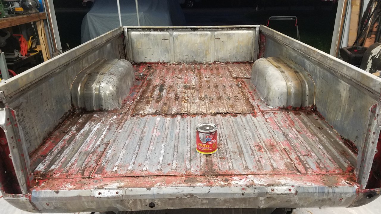

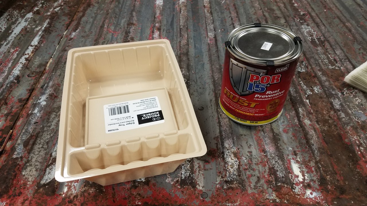

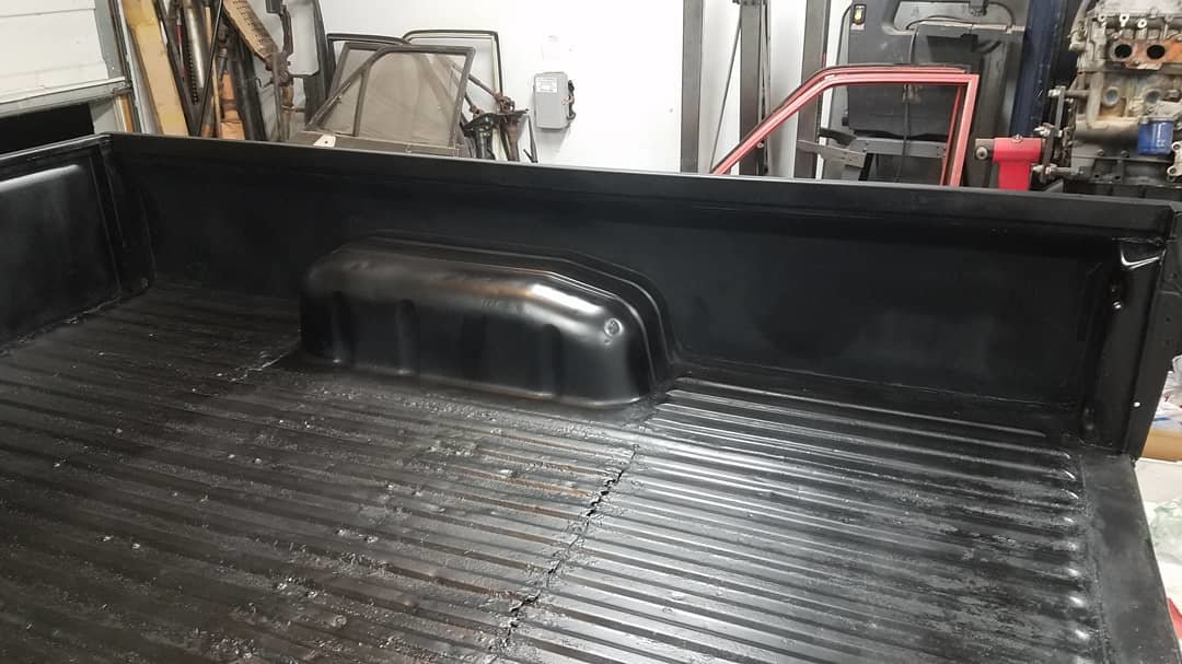

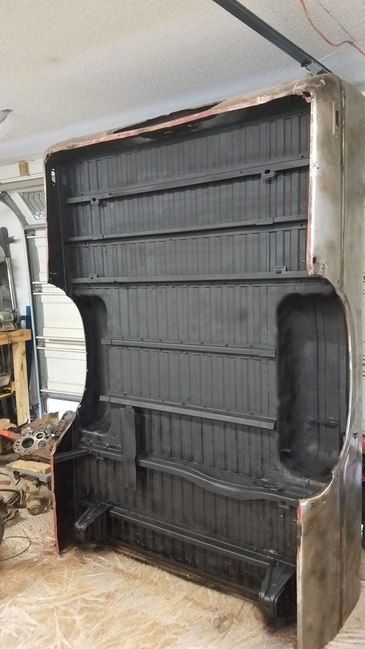

    today was a great leap forward. got the bed degreased, metal prepped, and got my POR15 laid down on the floor and side walls. I used the entire can I got, but POR recommends 2 coats, and I got 3.5 coats out of what I had. super happy with the outcome. just need to finish the underside as there are a few more spots that need undercoating, then tomorrow, 320 grit the floor, sand the bedsides, bumper, and front, and I can lay my primer! lets hope things go as planned lol

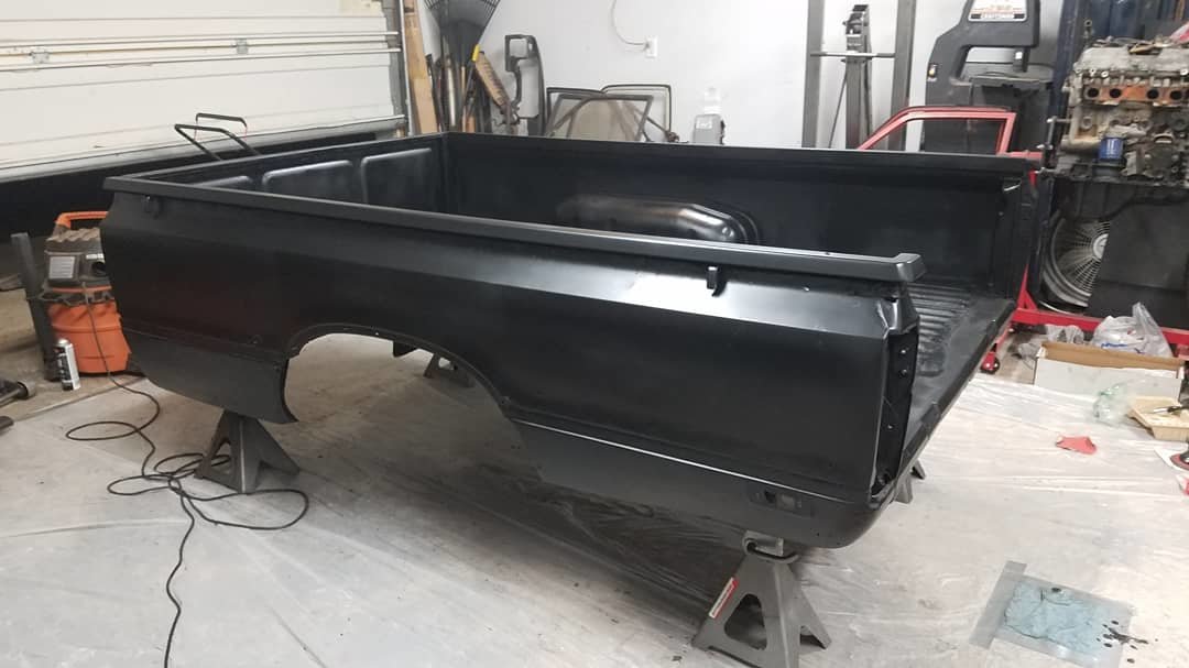

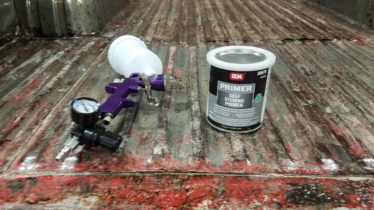

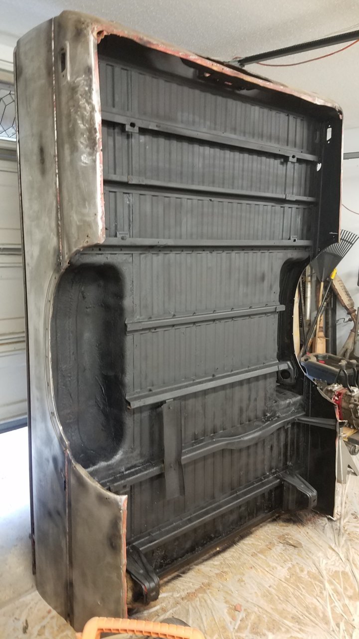

    check it out guys! FINALLY primed, took me 5 hours almost to scuff up the POR15, sand down the bedside surfaces again, and get the long bed primed. 45 hours total (give or take lol) and the bed is finally in a spot to go back on the truck. i THINK this will be the last time it will be off
    it aint perfect in no way, no barrett jackson resto in any way lol. more of a rust rescue lol

    Aleu is coming together and I like the flat black I know its just primer but it looks bad ass

    thanks man! i cant wait to get the cab done

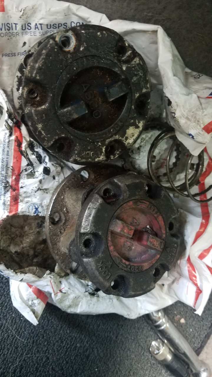

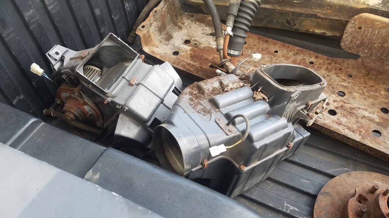

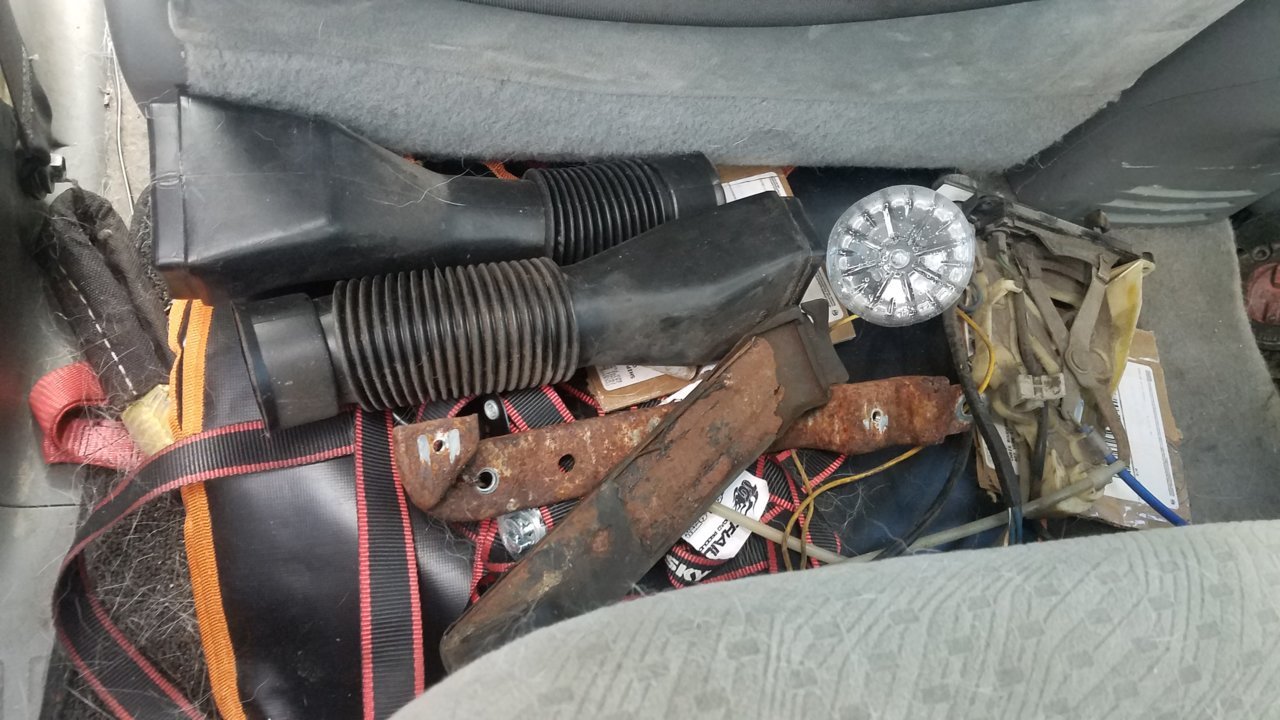

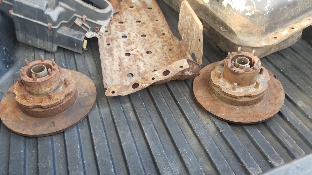

    this long weekend was a success. got most of the AC parts, still looking for more pieces though. got my axle parts, spindles, hub/rotor assembly, locking hubs, 22re longbed fuel tank, factory skid, blower motor evaporator, climate control module, bunch of misc AC related parts. I cant wait to get this baby driving again
