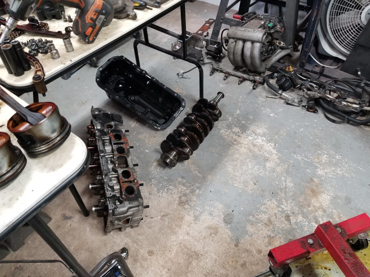

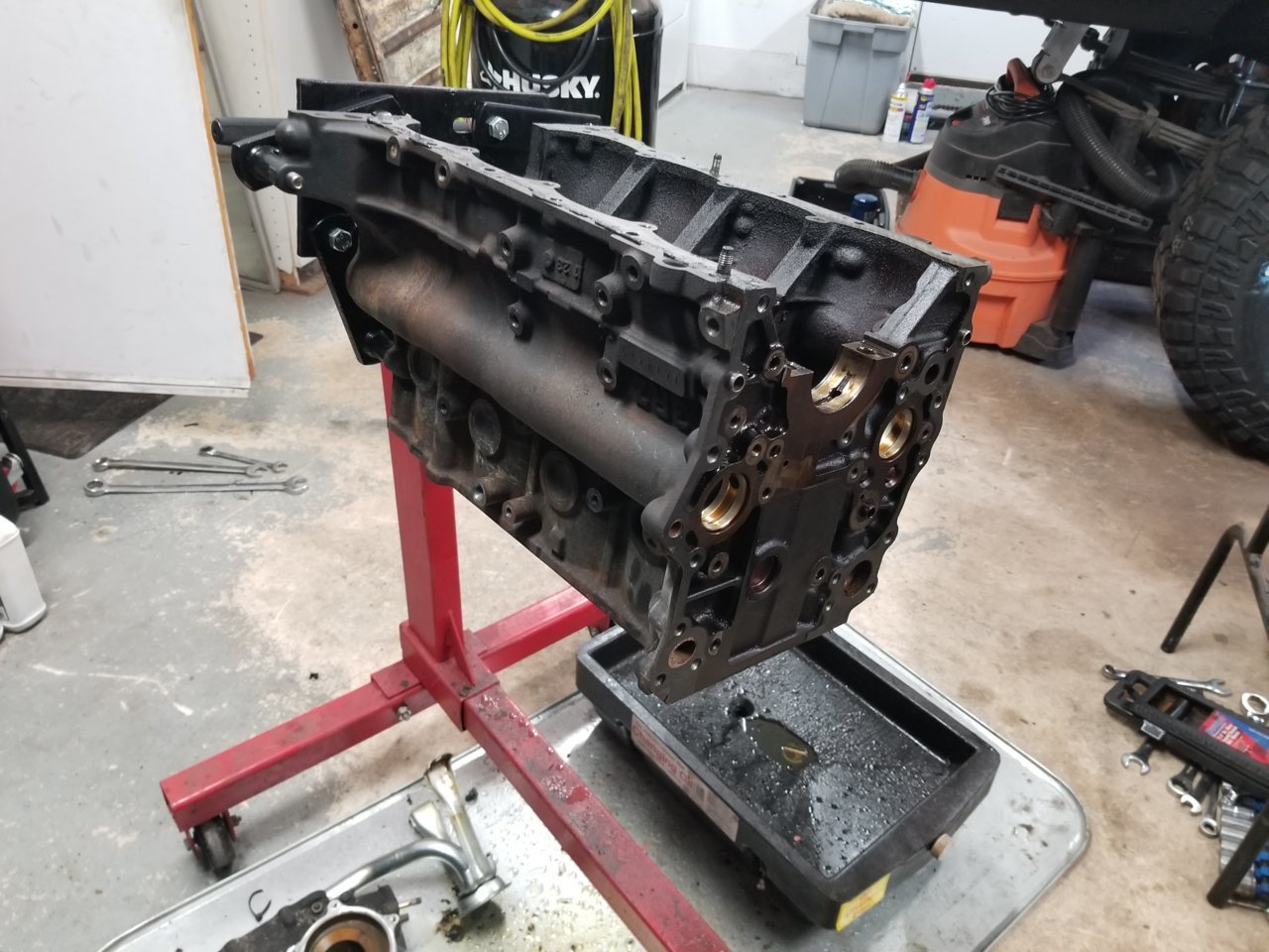

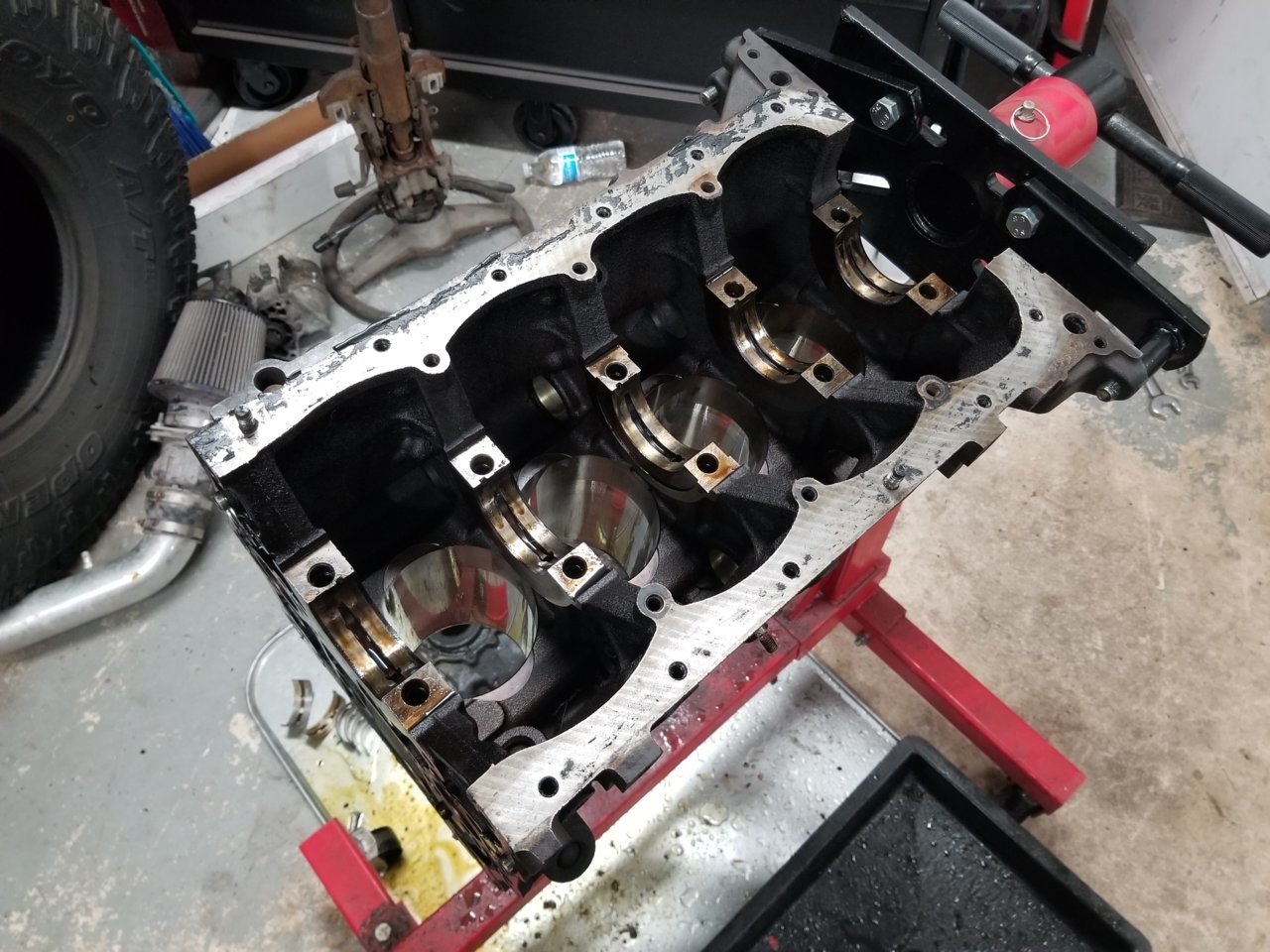

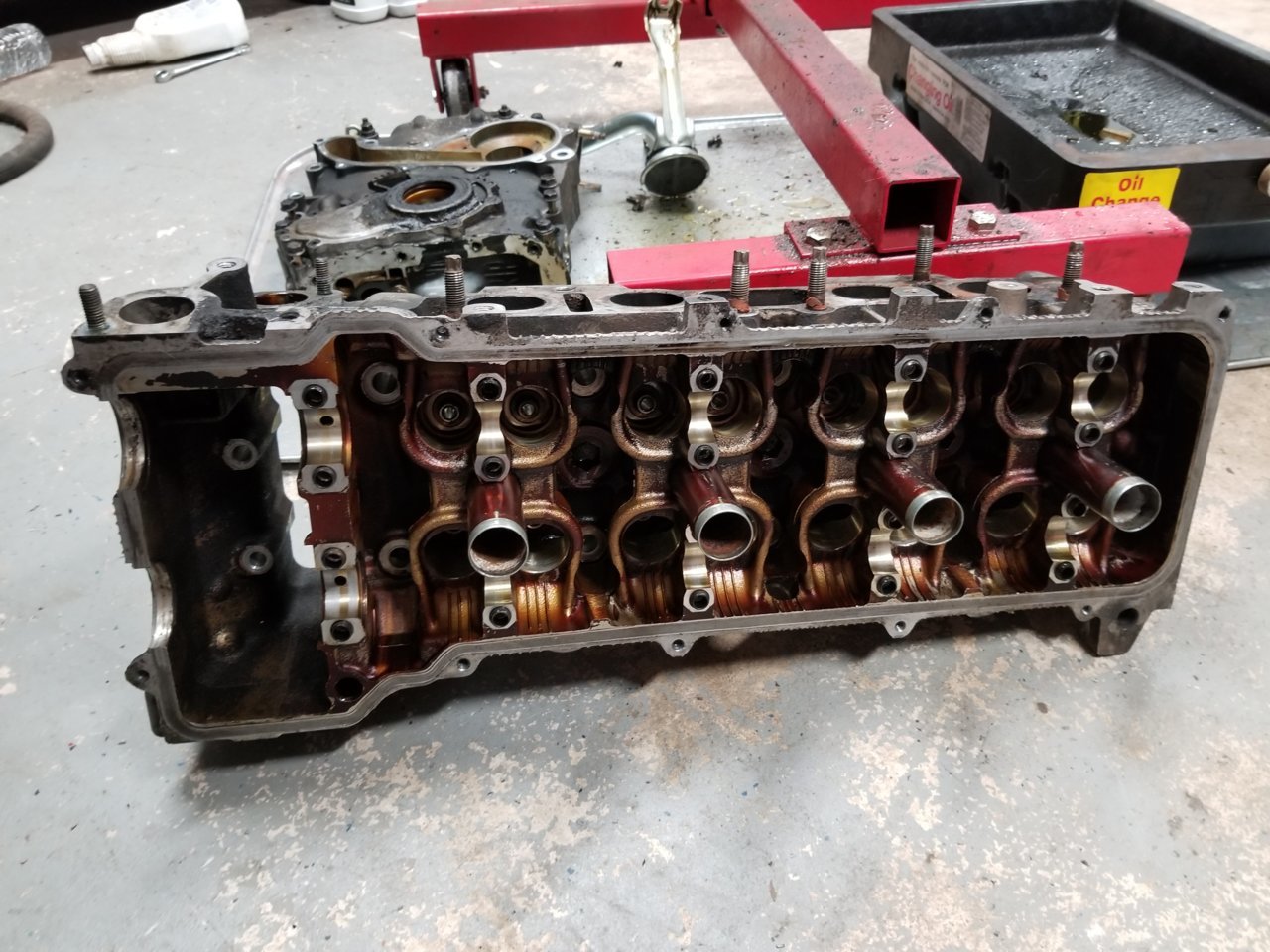

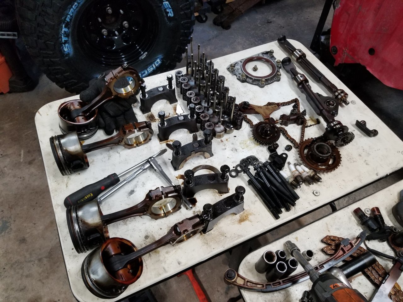

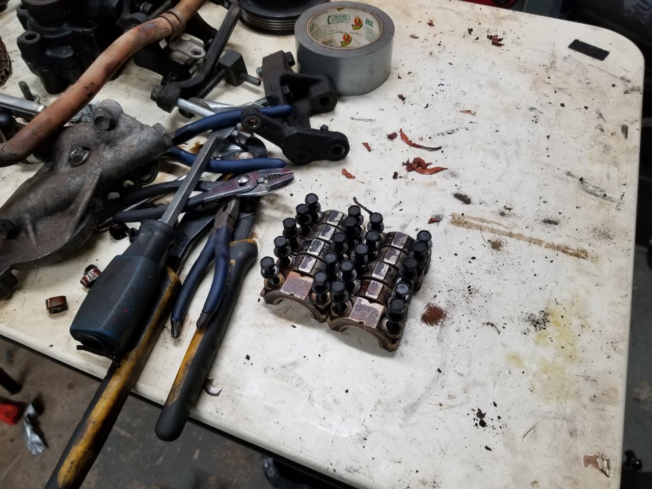

    engine is finally completely torn apart now, just need to bring it to the machine shop to get the work done and I can start reassembling the 3rz. it's awesome to have the proper tools to remove the valve spring locks haha
    Plans:
    - 0.040 bore
    - clean block/head
    - machine the deck and head surface
    - stage 1 port/polish
    - machine shop install freeze/galley plugs

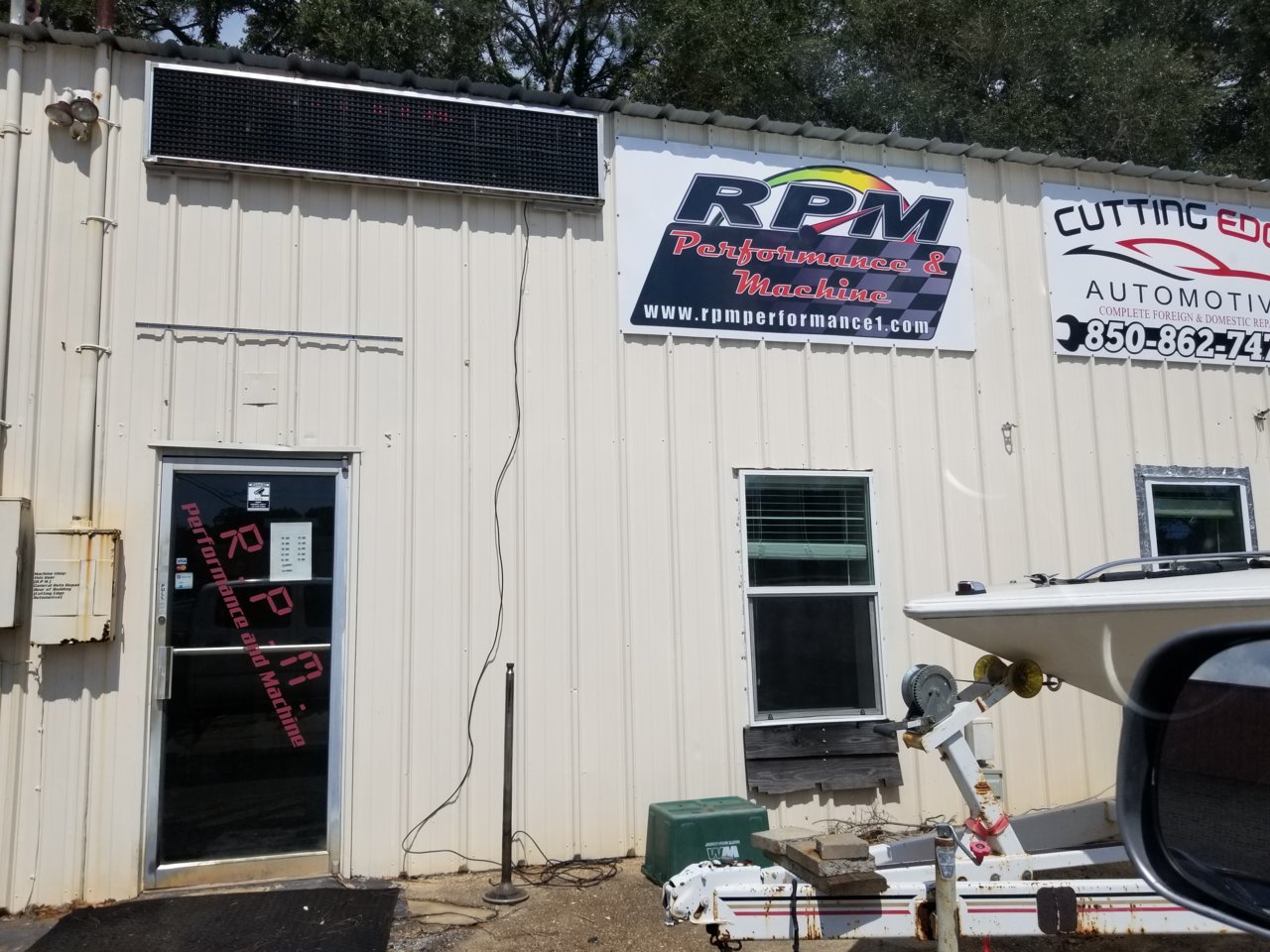

    well the block, head, and crank are now at the machine shop!
    - head and block getting cleaned
    - head and deck getting resurfaced
    - block bored 0.040 over and honed
    - head getting stage 1 port/polish
    - crank shaft getting polished
    gonna take about 2 or so weeks! but now I have to get to gettin on the rest of the truck lol

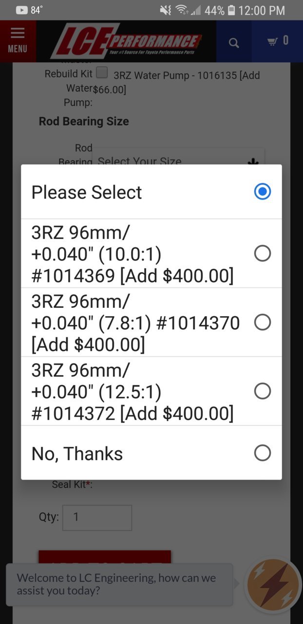

    Curious why you're going .040 over?

    eventually I want to put a turbo on, the forged internals are 0.040 over to begin with. so I figured just go with 0.040 now and then I can just swap the internals for forged when the time comes

    Why not forged now?

    And LCE has .020 10:1 forged

    because I don't have the money for the forged internals lol, I have to use that money for seats and sliders.
    nope not for the forged option on the rebuild kit section. I didn't see those initially but I have to get chromo rods to use the 0.020 over pistons. nothing wrong with doing 0.040 over, this 3rz is getting some nice upgrades put in, so why not do 0.040 over and that way I have a choice of 3 different compression ratios when I do upgrade

    Was just curious because usually it's .010, .020, 030. 040 is a full mm over and just takes a lot of usable life out of the block. Forged, aight, question answered.

    yeah LCE only offers the .020 and .040 for the 3rz, these blocks are so robust anyways, but yeah, im gonna throw forged internals in when I decide to throw a turbo on the little block. How's your other car coming along? I guess you could say im future proofing the engine lol. forced induction is down the road, just not anytime soon sadly

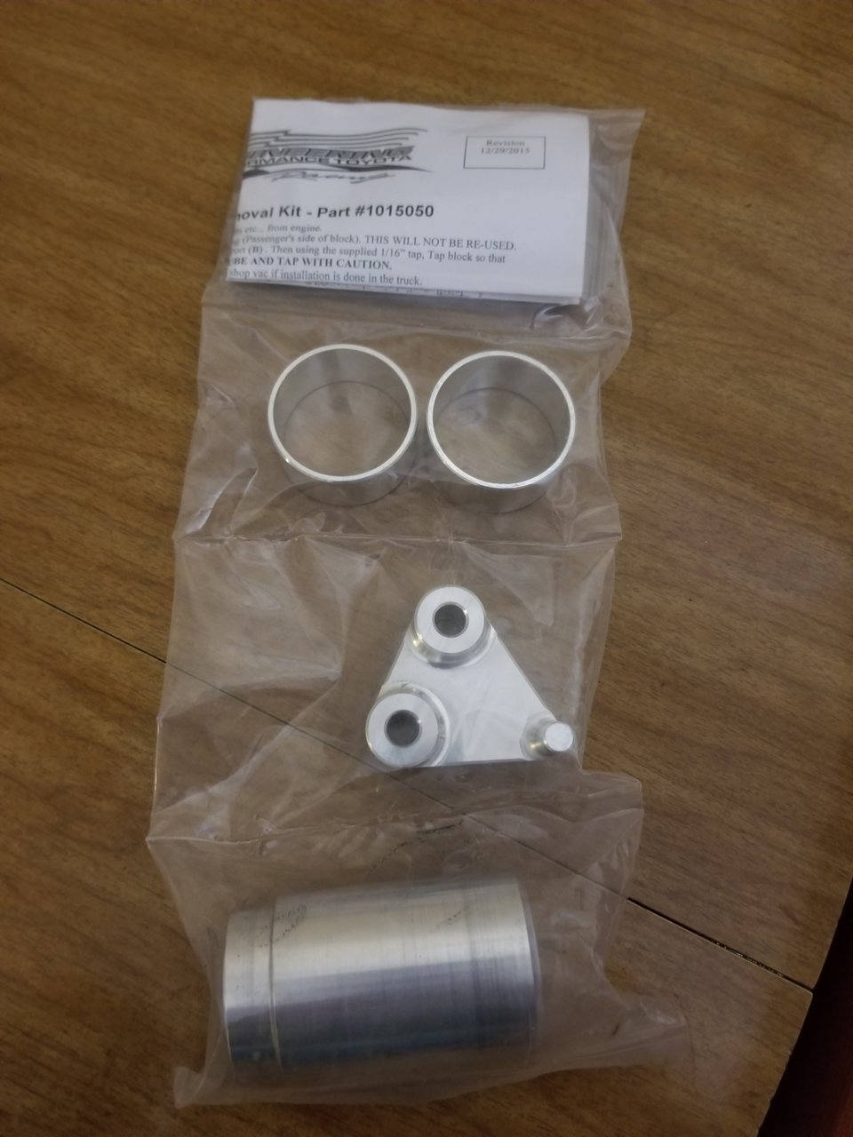

    well a couple more things on the way, new timing cover and balance shaft delete. didn't feel like dealing with cleaning my current cover and drilling the stripped oil pump screws out. balance shaft delete kit will be another thing I'm doing for down the road when I do forced Induction, just get it out if the way now.

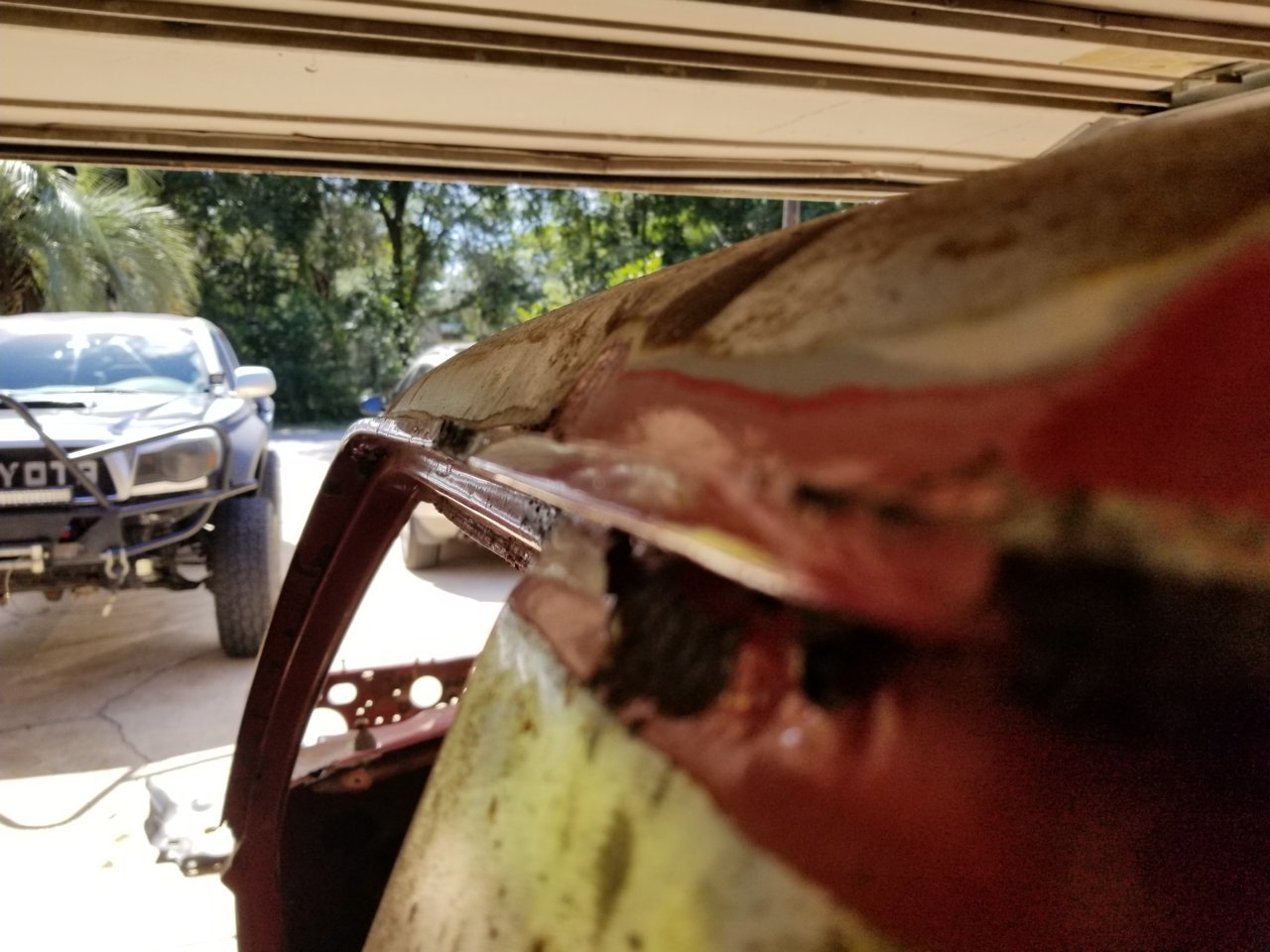

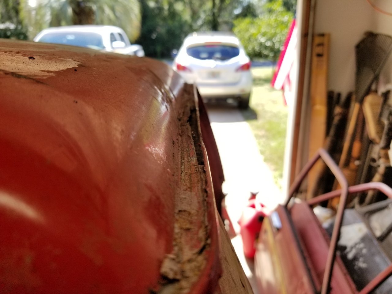

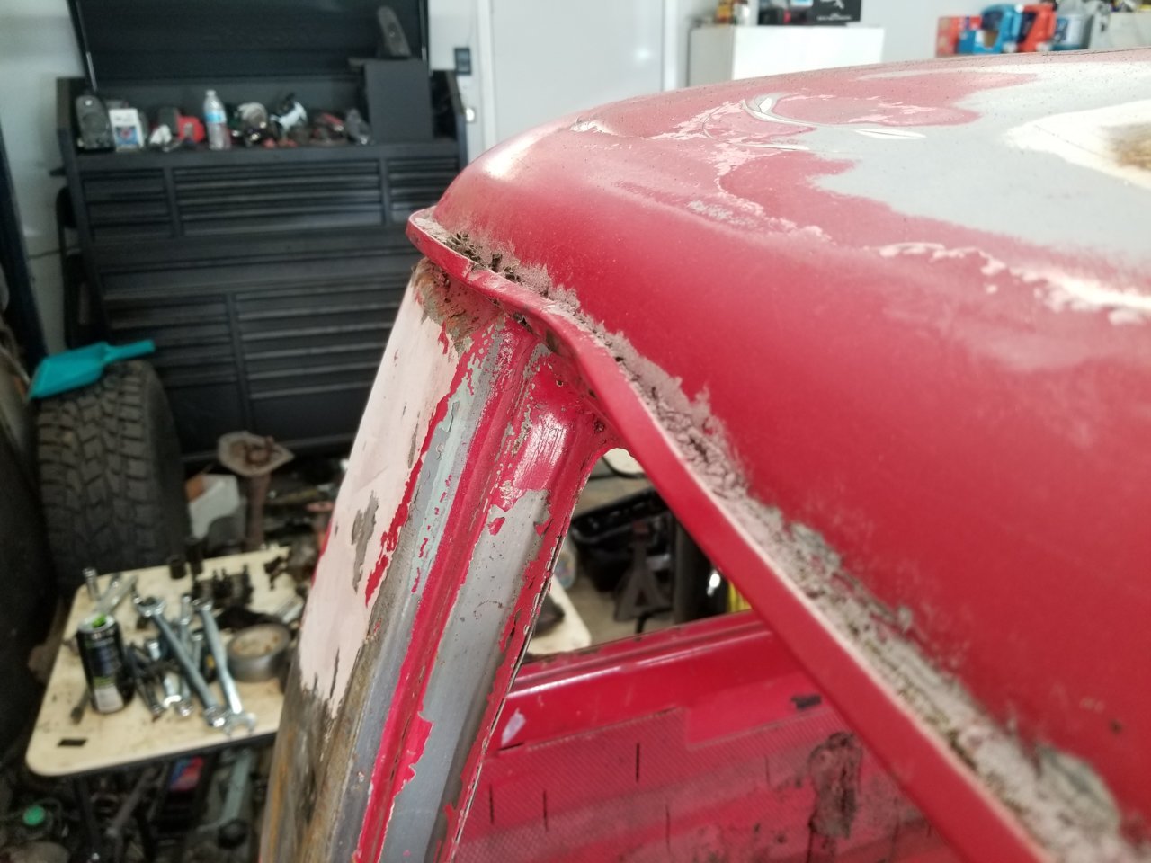

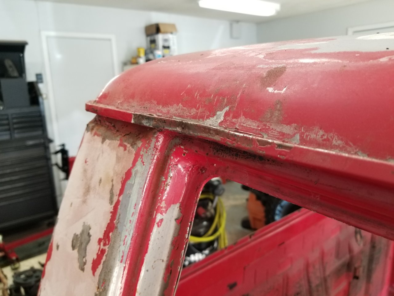

    not much done today, but I got the 2 dents in the rain guards straightened out. not the best work, but it looks a lot better now. nothing some grinding and bondo cant fix! also got the headliner and seat belts out. need to get another paint pan and paint brush so I can start putting the paint stripper on the cab

    forgot to post this earlier, my balance shaft delete kit came in the other day. I should have my motor back sometime next week!
