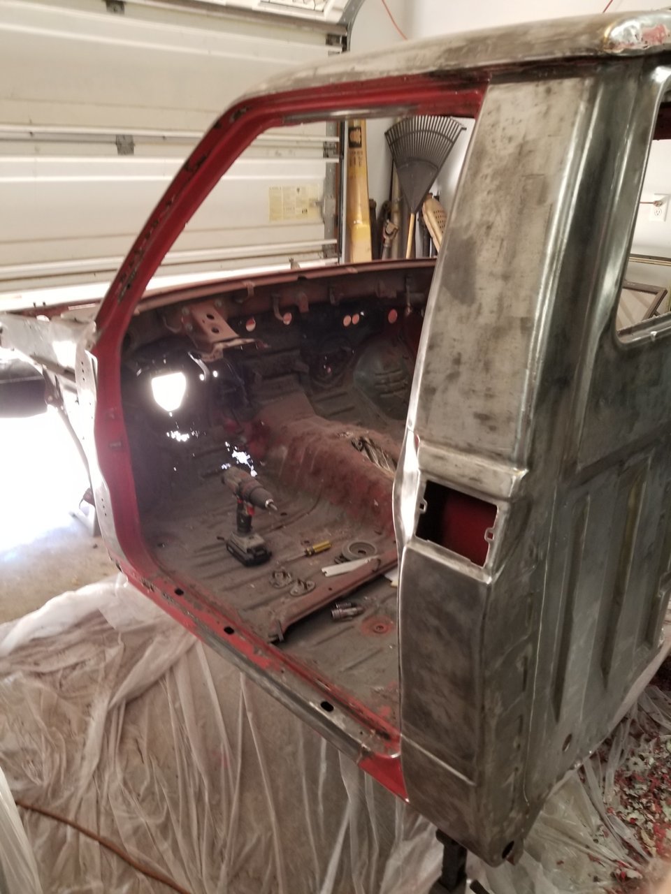

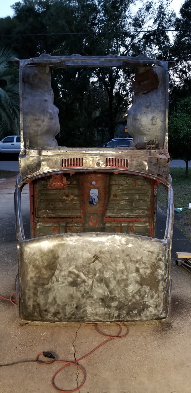

    got some more progress on the cab today, really trying to get this done this weekend. I do however need to buy more primer for when I get done with the body work

    What's the plan about that rusty floor? Patching it or going to cut the whole area?

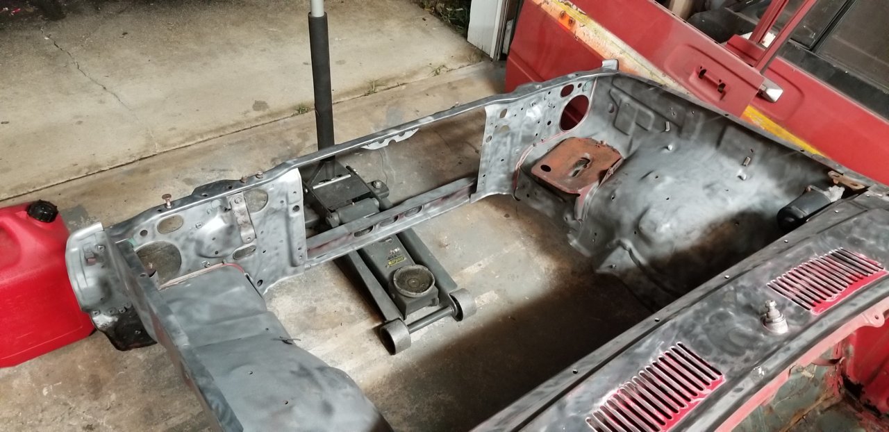

    theres only like 2 spots that need fixing on the inside, side firewalls need a few patches and then the cowl needs fixing. but ill just cut out whats there and weld in new sheet metal

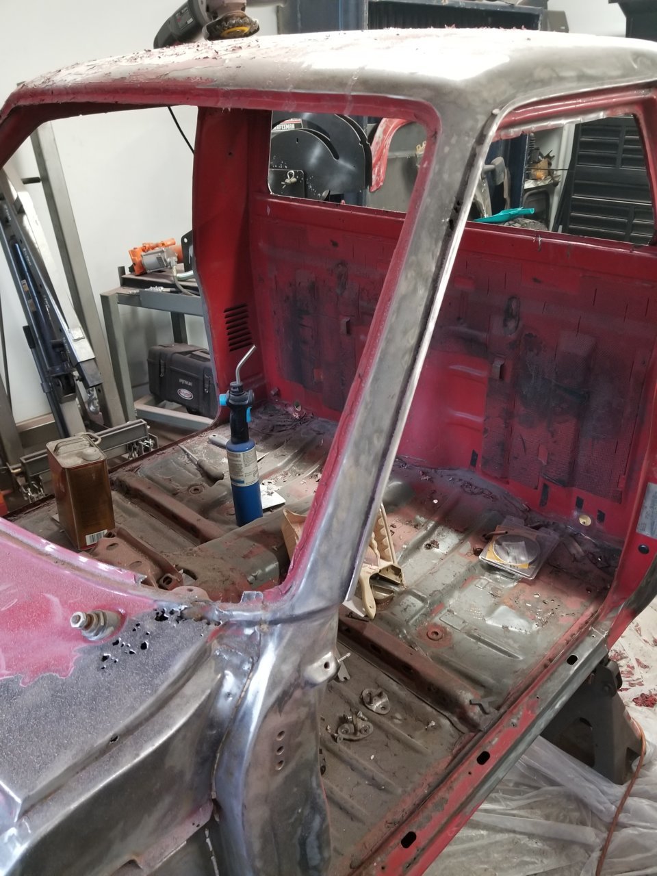

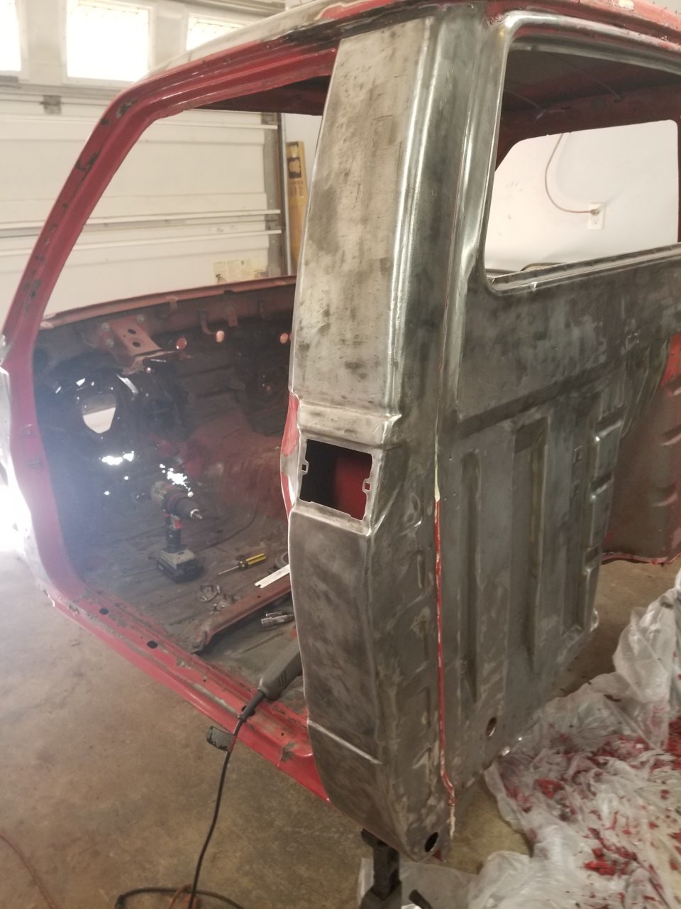

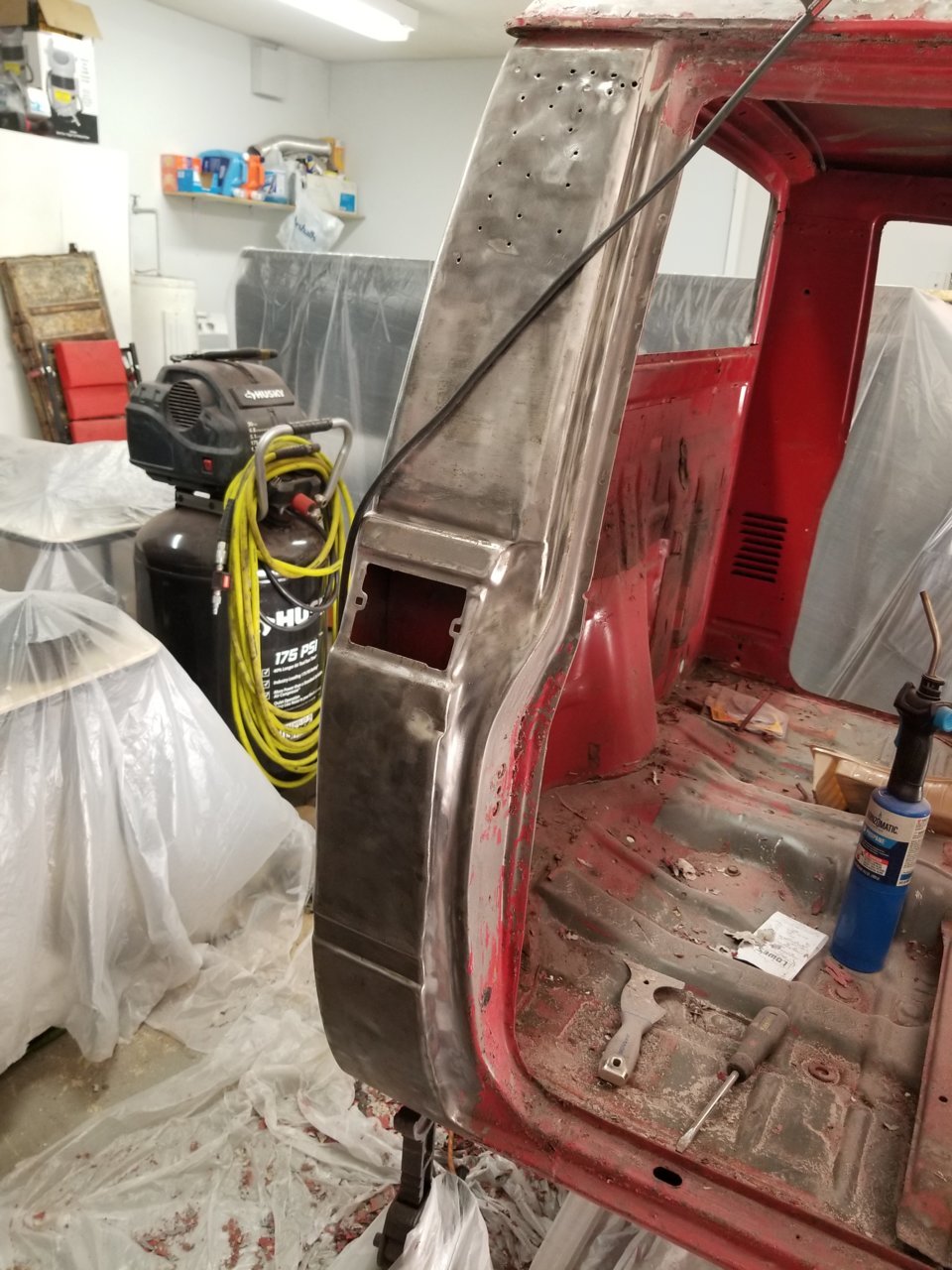

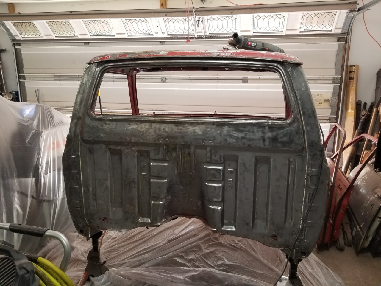

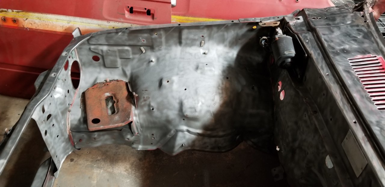

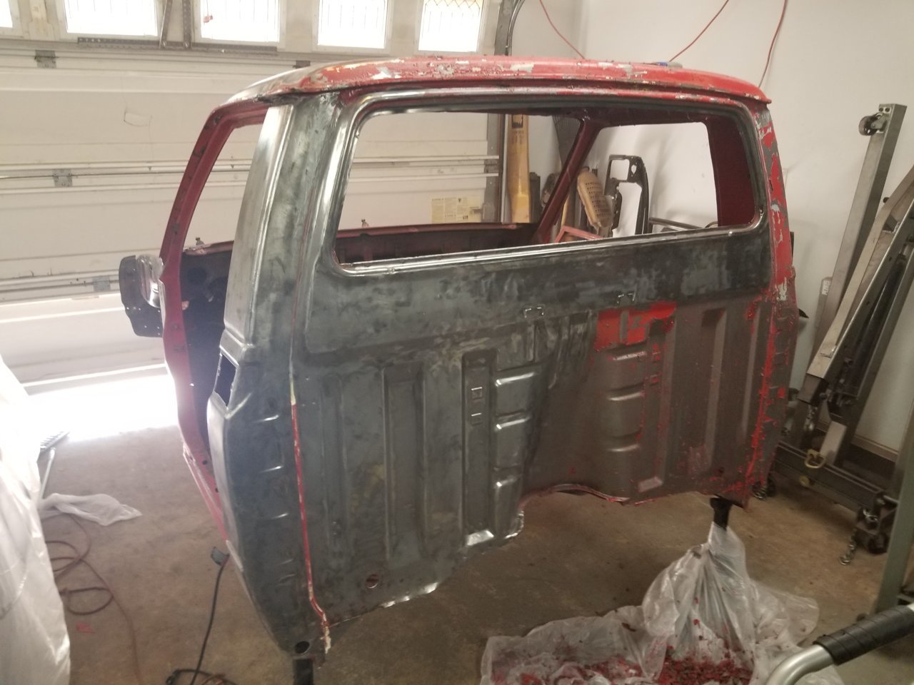

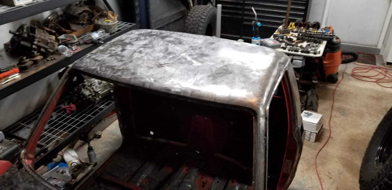

    man, 2 hours today and got a good bit further on the cab. I seriously want to just sit here all day and grind away, but I just cant lol. was trying to get this cab done by the end of this long weekend, but between the heat and my energy levels...I haven't really been able to lol. I've got about 1/3 of the cab done so far.
    depending how this hurricane is that's coming up this way towards me, I'm gon a see how far i can get this week by doing what i was doing with the bed and just slowly chipping away at it

    forgot to upload this one

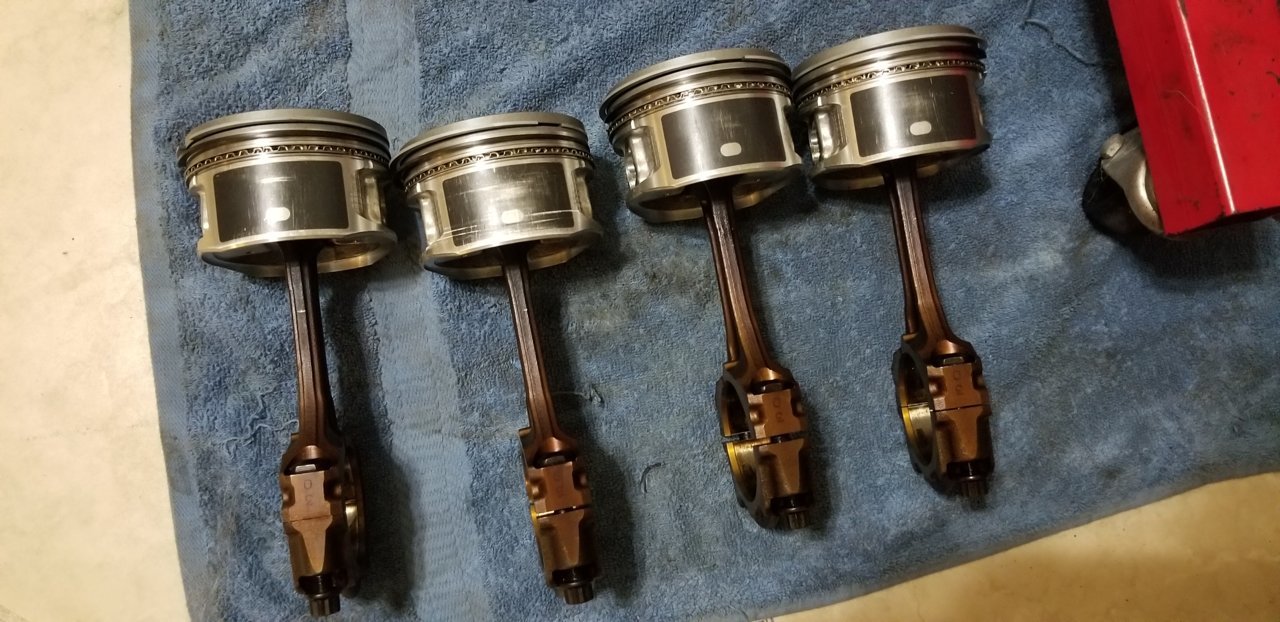

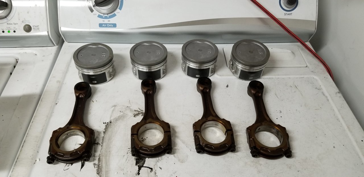

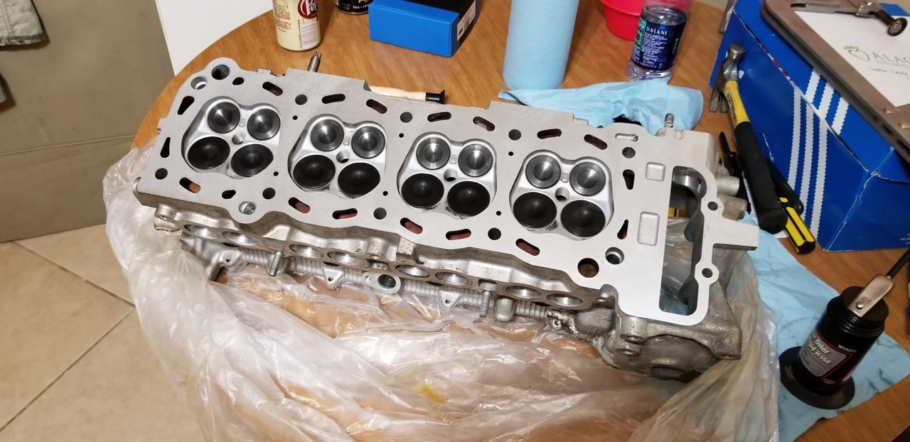

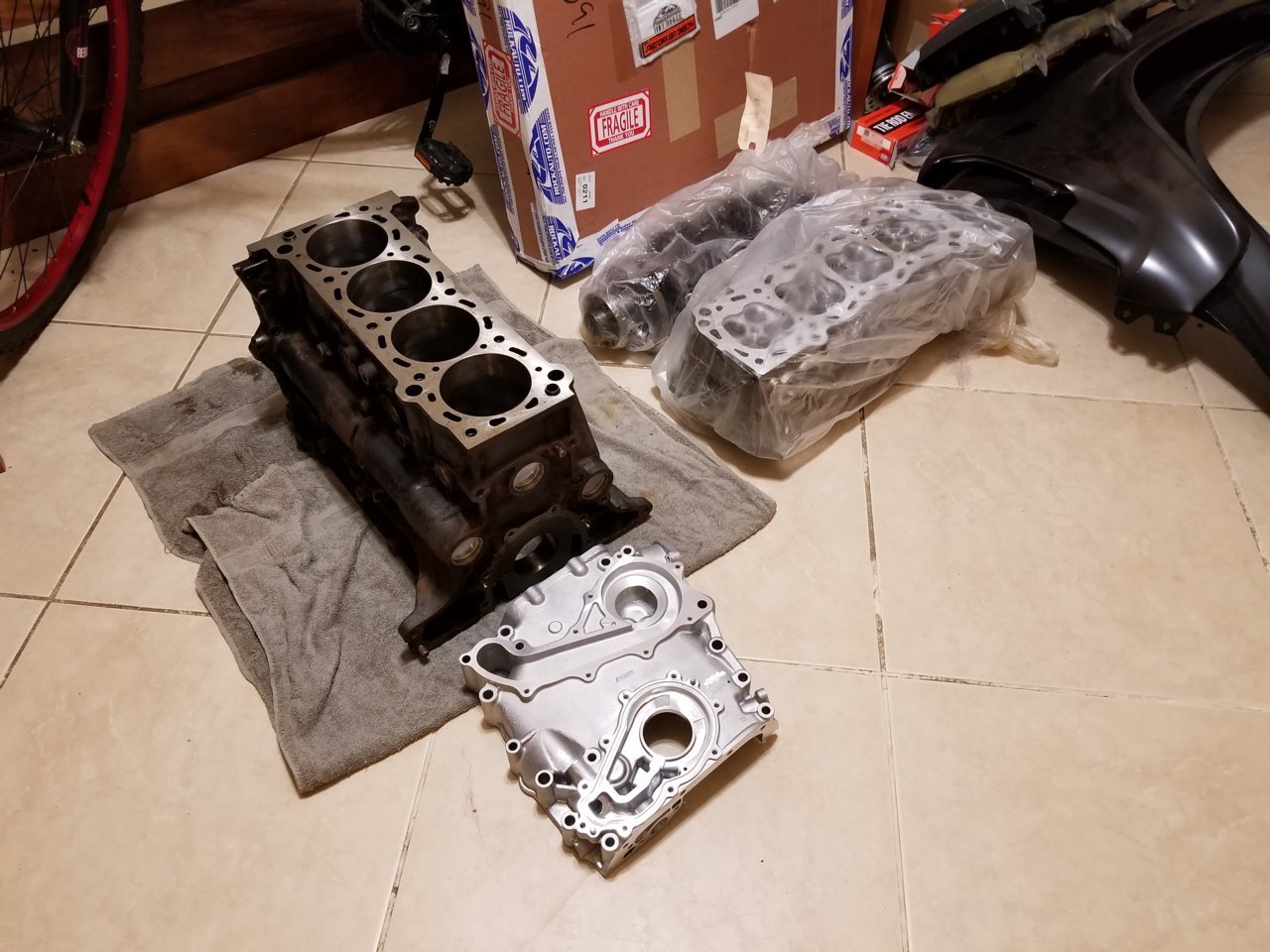

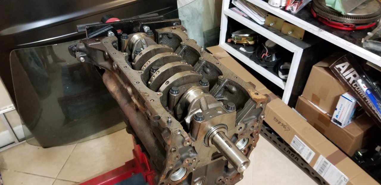

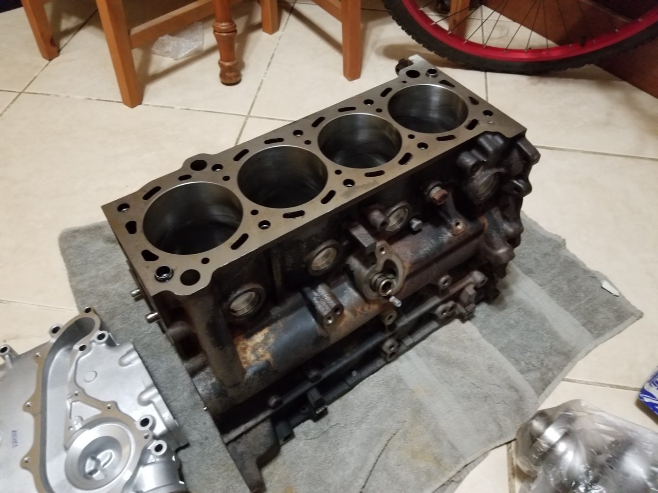

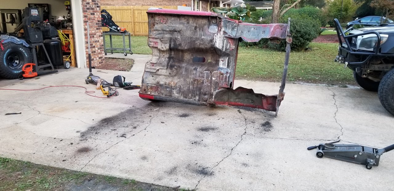

    hey guys, sorry for the lack of updates. been tied up helping with Hurricane Michael relief over near Panama city (my town didnt get hit). but I got a good bit done, finally got the correct hub for the rear end, they are matching 84/85 hubs lol.

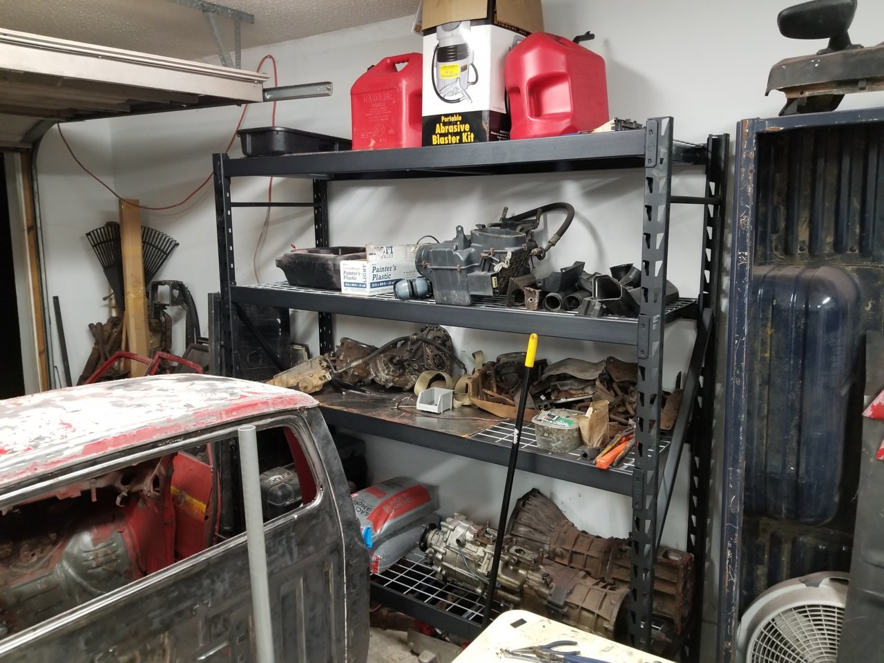

    got a new shelf for the garage which helped substantially with organizing better

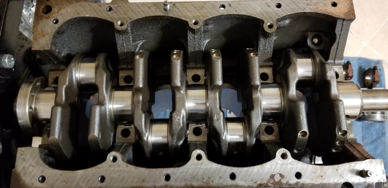

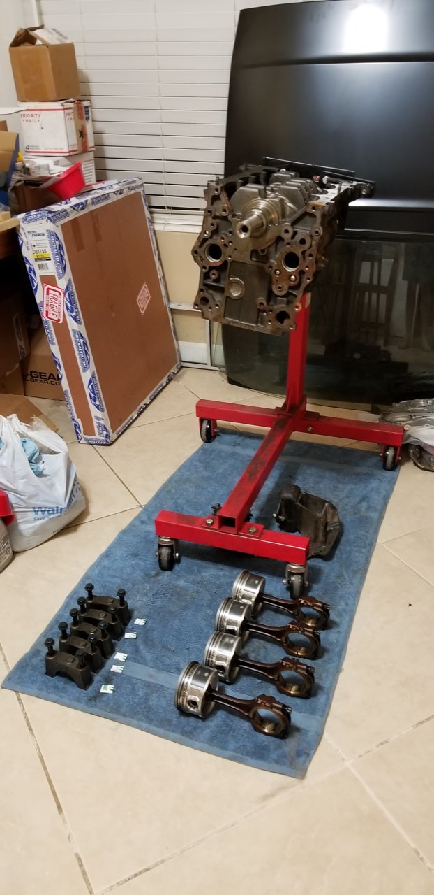

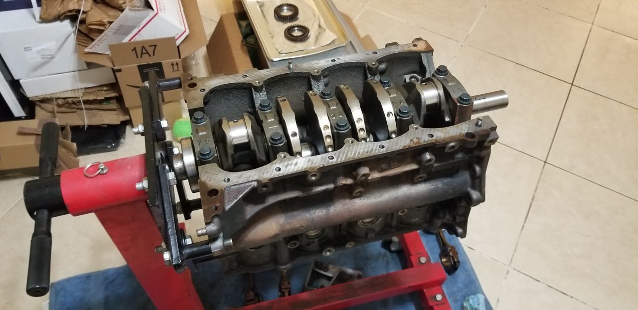

    got my block back FINALLY but there's a bit of a snag that SHOULDNT be a factor but im not happy about it though. cylinder 3 at the top is probably a thousand or even less off at the top, so it's not true 0.040 bore. all piston heads in 1, 2, and 4 slide in and out easily, but the bottom half of every piston head at the very top of #3 I cant slide in by hand. I have to use my dead blow and tap it in, BUT once it's in, it slides freely and the spot the gets caught up, literally has to shove the piston out of the cylinder to cause anything. so I dont THINK itll be an issue, but I'm still calling the machine shop tomorrow about it.
    but other than that, also got the head and crank back too, bought a new timing cover since the screws stripped in the original oil pump on the other cover, didnt feel like drilling it all out. the head got cleaned, machined and a stage 1 port and polish, crank got polished and the block got cleaned, deck machined, and an .040 bore with a hone

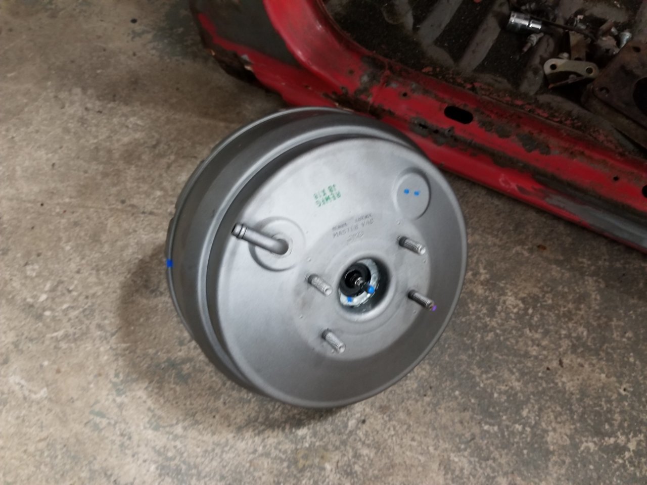

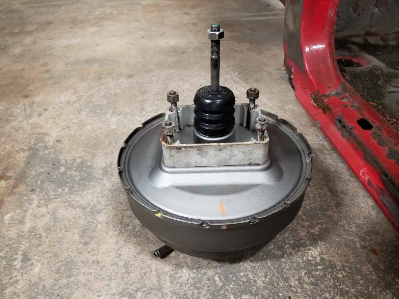

    bought an 89 2wd 3.0 V6 dual diaphragm brake booster to upgrade from a single diaphragm that the 1st gens come with. the tabs on the booster need to be bent, I found my booster spacer (thank god) and it ALMOST clears, barely makes contact with the clutch master. I'm glad I got the 2wd aw it has longer studs to accommodate the spacer. just need to see if the steering shaft runs which I think it will
    finally, bought a 1" body lift from skys offroad, I dont like body lifts...but I'm needing to do it. I need bolts mostly....lol, but I'm hoping that the 1" BL helps clear the brake booster from the intake runners on the 3rz. 1st gens are notorious for not fitting anything other than small diameter boosters. lastly, the BL should help clear the EFI long bed fuel tank that's going in the stock spot. I wanted all my body lines to match up. no way in hell i was gonna shim just the bed up and mess all the body lines up.

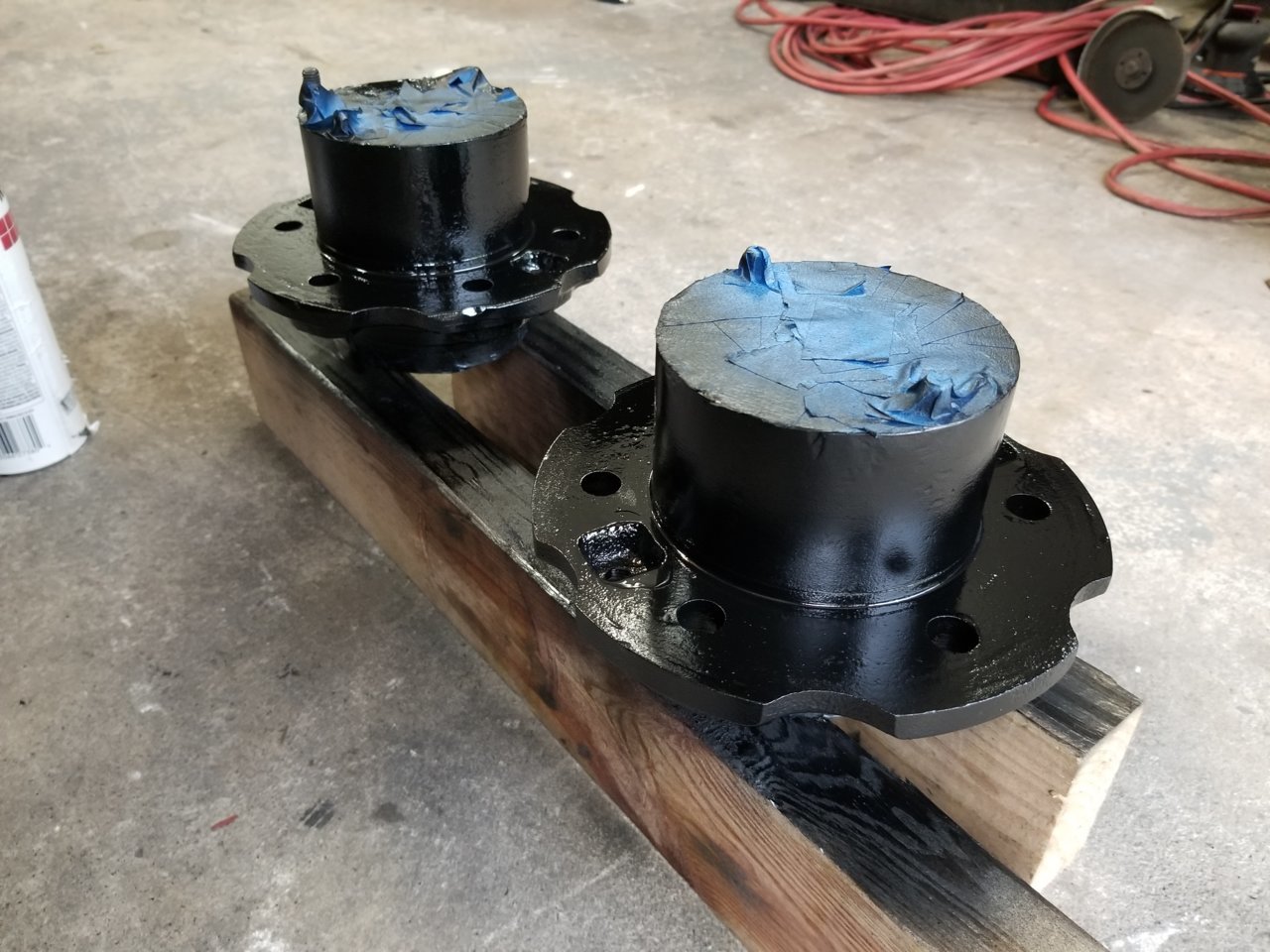

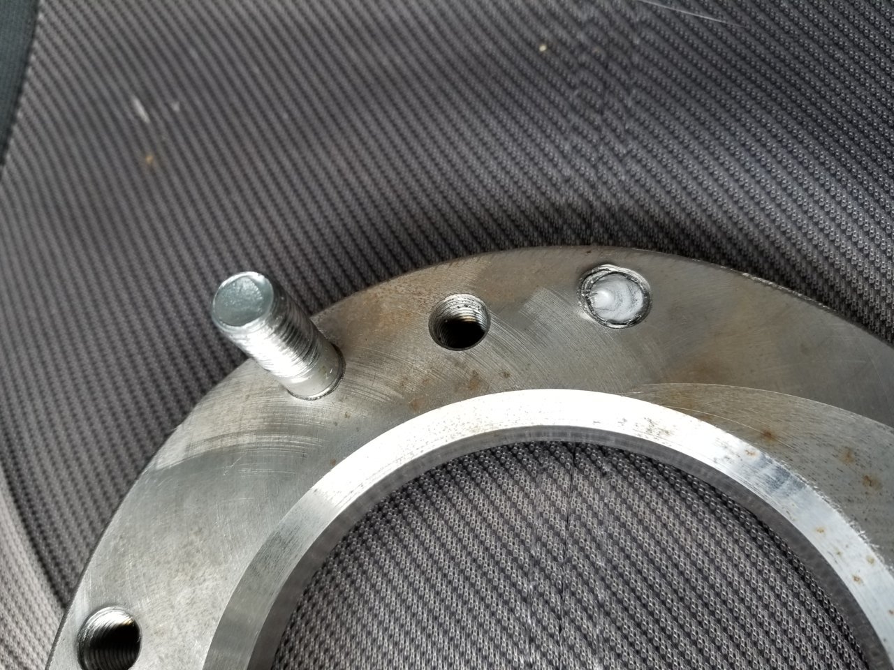

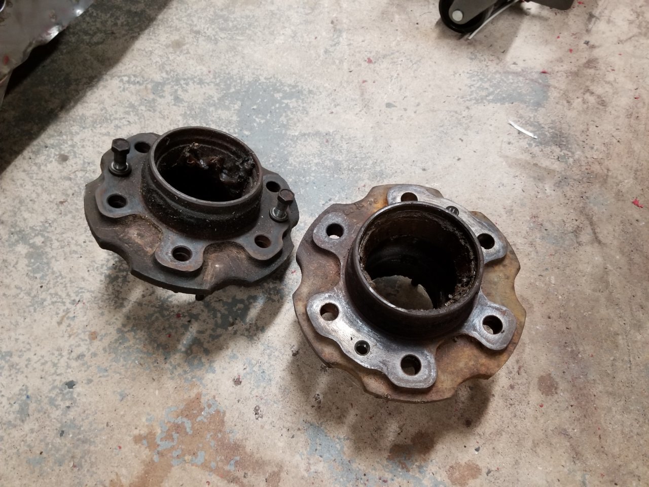

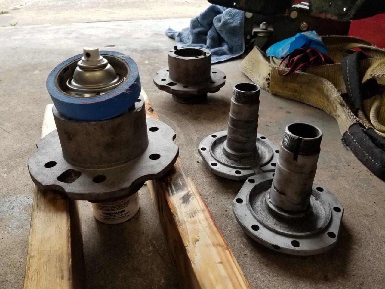

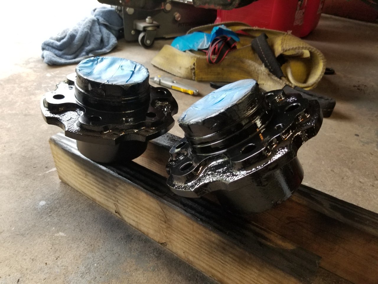

    hey guys, a few updates, haven't gotten to work on the truck as much as I've wanted to the last 2 weeks. ran into an issue with my full float adapters. put one on backwards and went to pull the studs out and 2 got stuck and one snapped off. had a local buddy get it all fixed up for me, so now I'm just waiting on my new spindle stud kit to come in sometime this week, hopefully tomorrow.
    but, aside from that, blasted my spindles and hubs down and got them all painted up, gotta pull one stud out and drill another out and those will be good to go.
    have to fab me up a bearing pocket removal tool to remove the bearing pocket on the stock semi float axle to remove the rotor and studs to swap over to the front solid axle hubs. once that's done the rear end will fully have full float installed.
    also got a bunch of brackets cut off to install my marlin crawler steering box mount. I had to wait to get a bearing preload tool so I can properly install my high steer setup

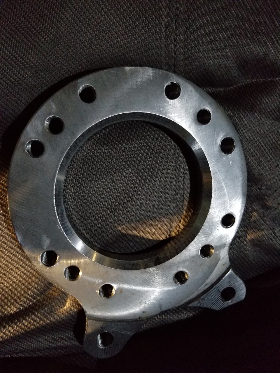

    well its late at night for me, I just got home from work...but look at what was at home waiting for me! now I just need to pull the rotor and studs out of the semi float axles...and my rear end can be put together and I'll be one step closer

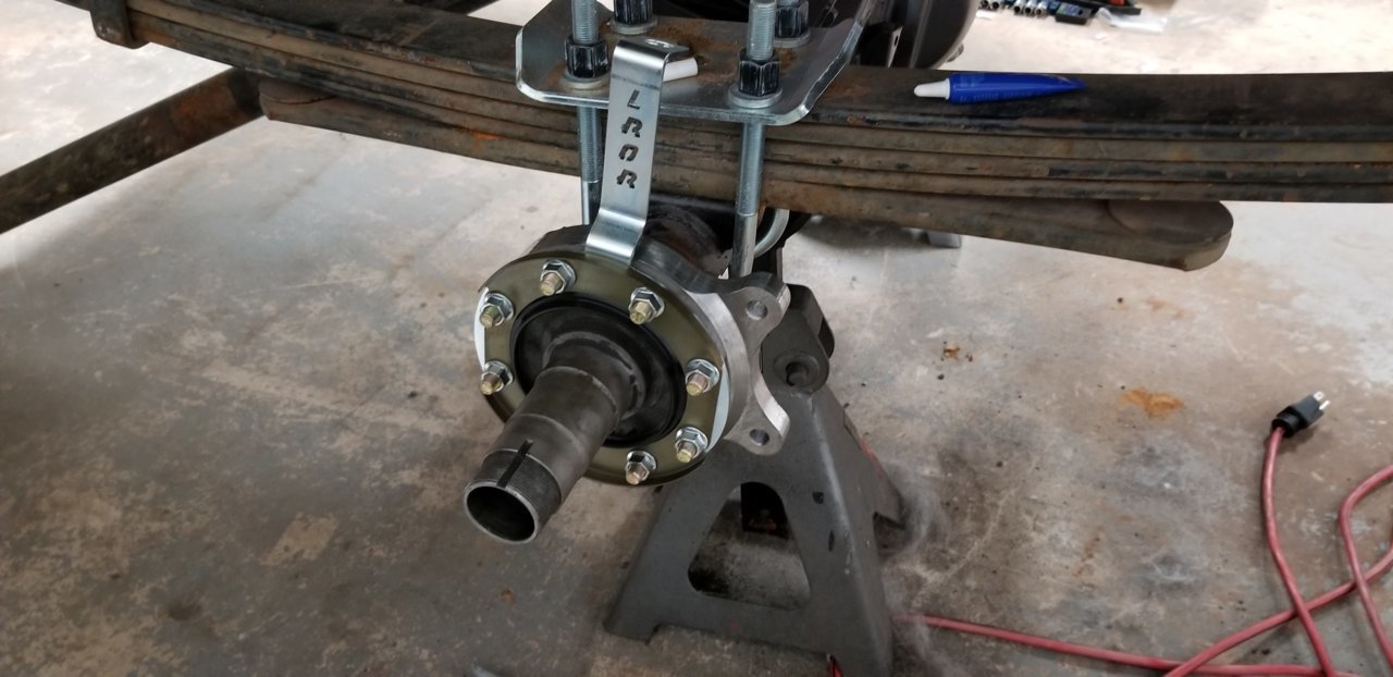

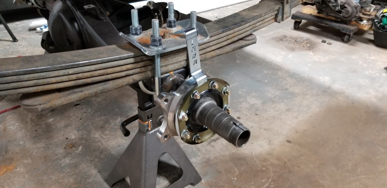

    was supposed to upload a bunch of photos....but that got away from me lol. so here's some pics of the full float half way installed. its nearly impossible for me to get the old rotors and studs off the old semi float axle because now I dont have a way of pressing the axle out. whereas before I used a set of jacks to support the drum and press the axle out. I dont have the proper tool to remove the axle out of the pocket...so I'm kinda forced to get new rotors, I can prob salvage the studs by hitting em out with a 2x4 and the dead blow lol

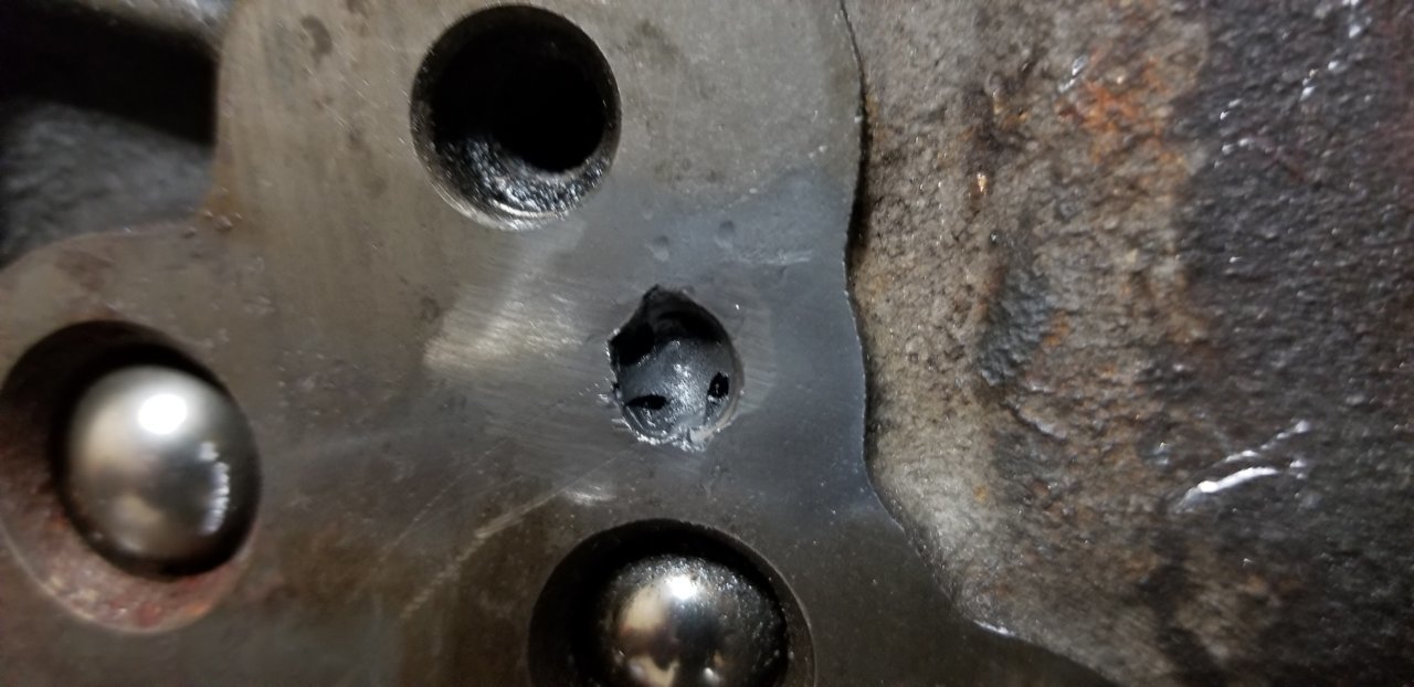

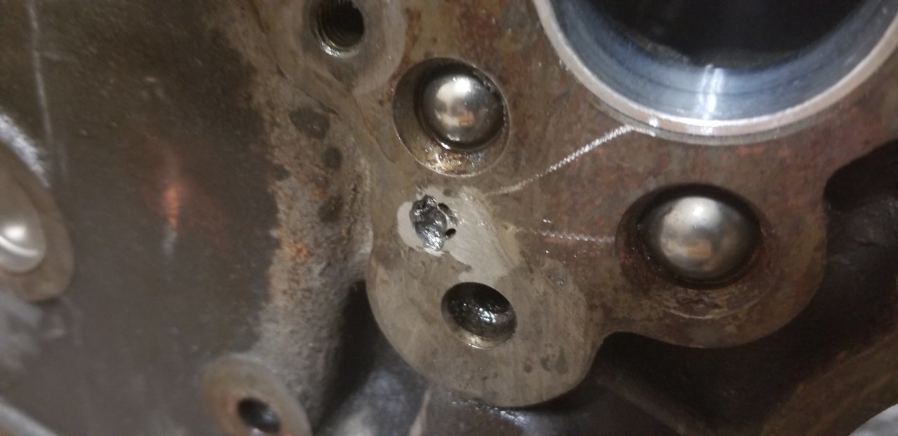

    good news yay, I called the machine shop and they were able to drill the broken tap out and save the threads, they ran another tap through behind what I did to clean the threads up. glad the oil jet hole is good to go and the block didnt get damaged further lol

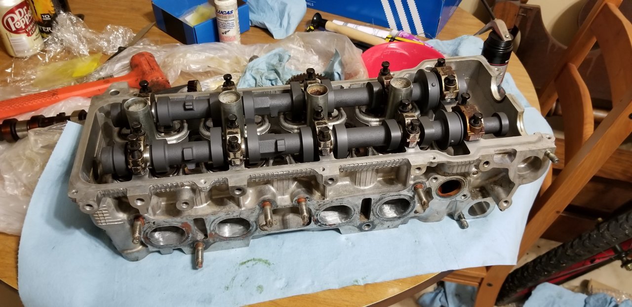

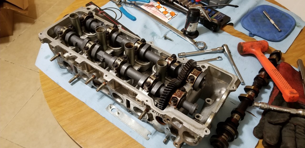

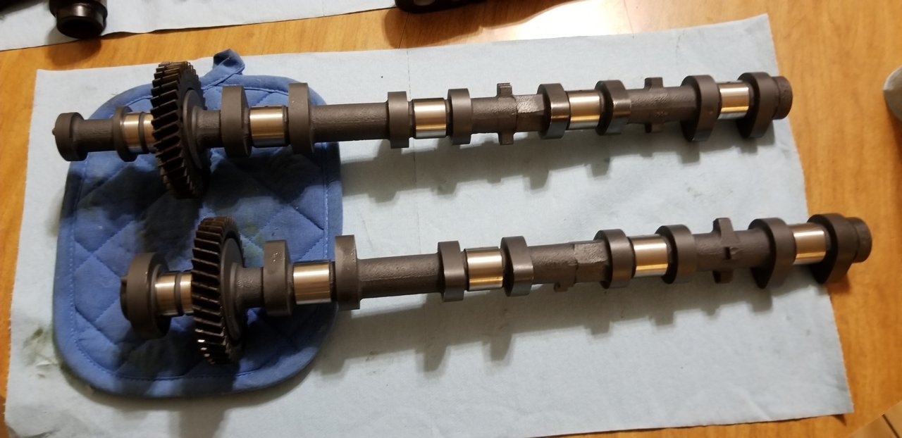

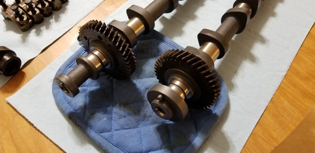

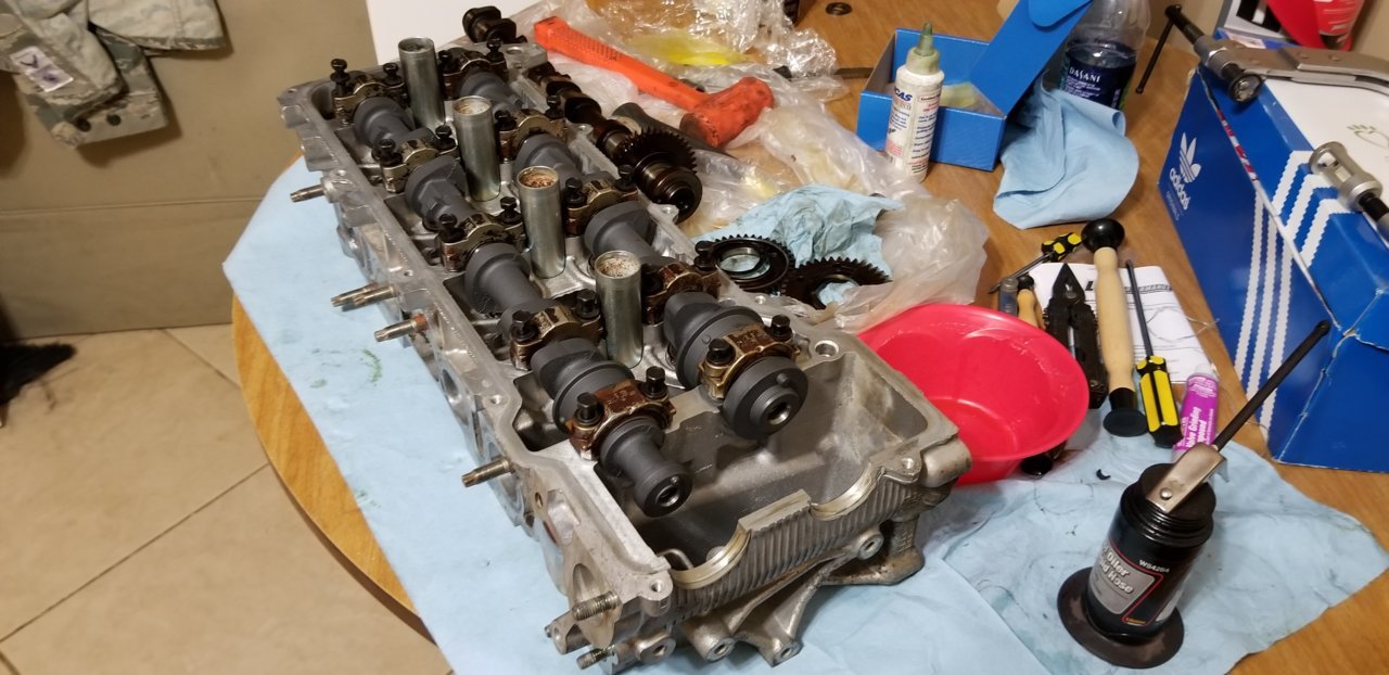

    literal photo dump I promised 2 days ago haha, all i can say is......I HATE valve keepers and the valvetrain on these Toyotas...lol, cab is almost done as well
