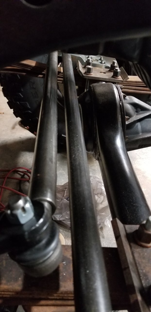

    it might fit with some bending, but it may take a good bit to get it to clear. its actually making contact with the shackle, so it needs to be further in to clear that

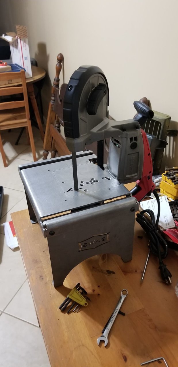

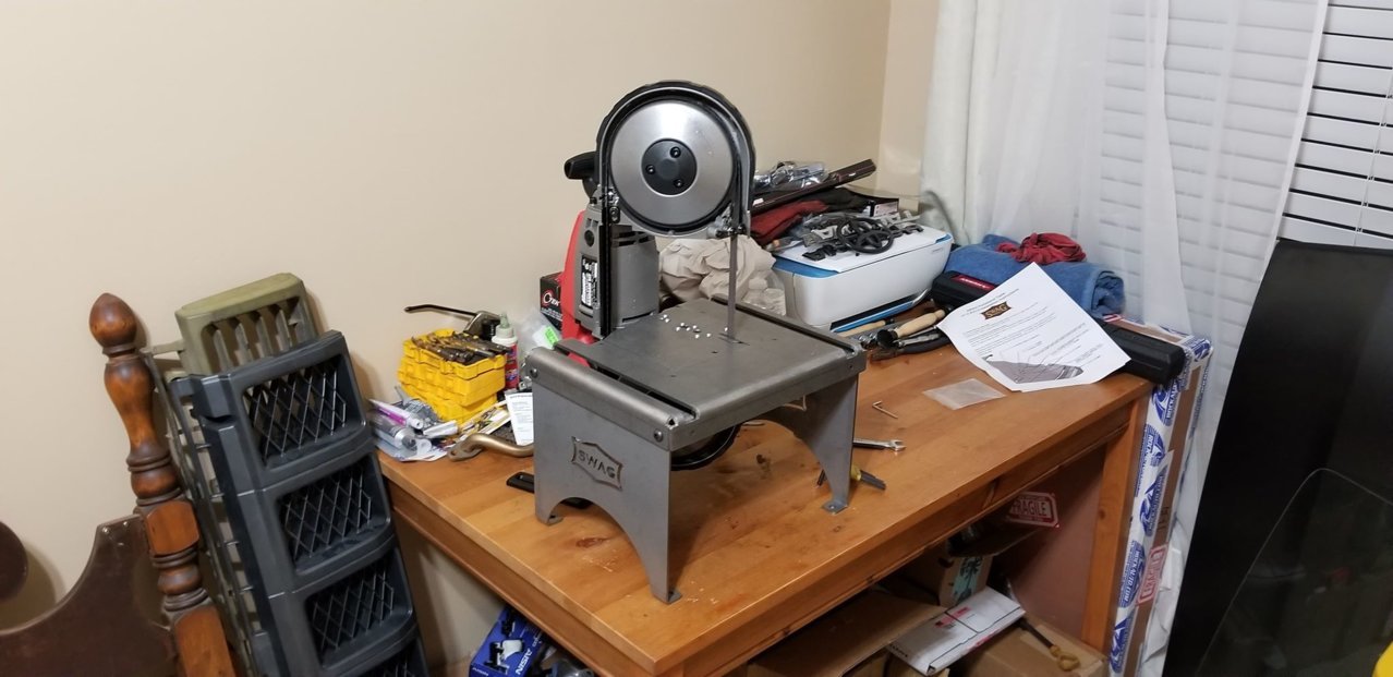

    latest tool added to my arsenal! Bauer Porta Band with Dewalt blades and a SWAG Offroad V3.0 Portaband Stand. Time to finally be able to cut some sheet metal to fix the rest of the cab so I can actually prime it....

    Bauer Bandsaw from HF with their super coupon....$100 lol, and the SWAG table and foot pedal was $180

    My most used cutting device is easily my portaband on my swag table. You'll love it.

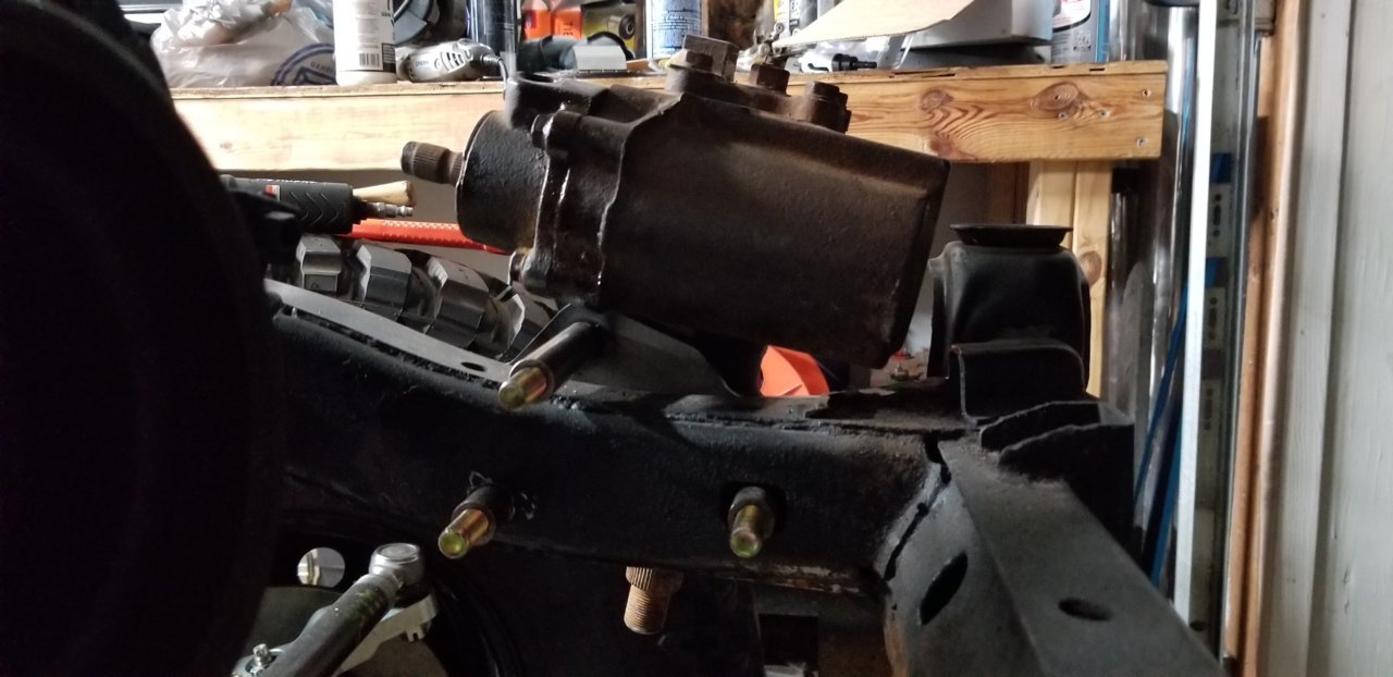

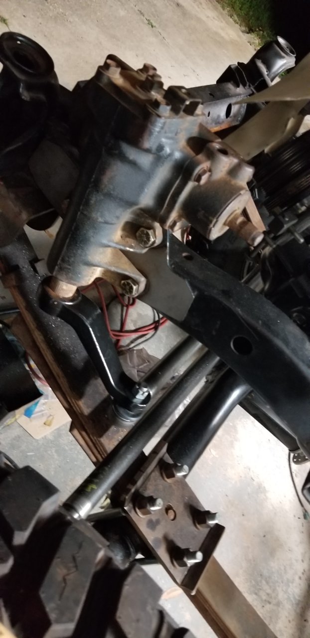

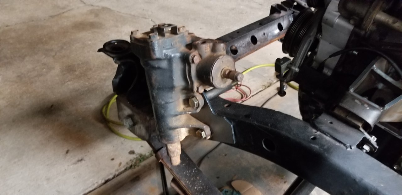

    finally made some progress...probably the most stressful part too. got the holes drilled in the frame for the IFS box mount. had to buy a 3/4" bit and a 1/2" bit to get everything drilled out properly. i was worried that it wouldnt line up or id screw something up...but i have to say....i turned out pretty decent for something so tedious. everything seems to be lined up and so far looks to clear everything. oh, and i also sliced my finger pretty good when i was setting the steering box in place, i hit the top of the mount when it dropped down a bit lol

    Getting the IFS all lined up is tedious. I had to get a shorter pitman since I flubbed mine about a 1/4" to the right :)
    Are you going to burn in the mount plate?

    damn lol, yeah i pushed the bracket as far forward as i could. i had to cut part of the body mount support bracket to get the box to clear. yeah i plan on welding it in, the marlin crawler one calls for welding it
