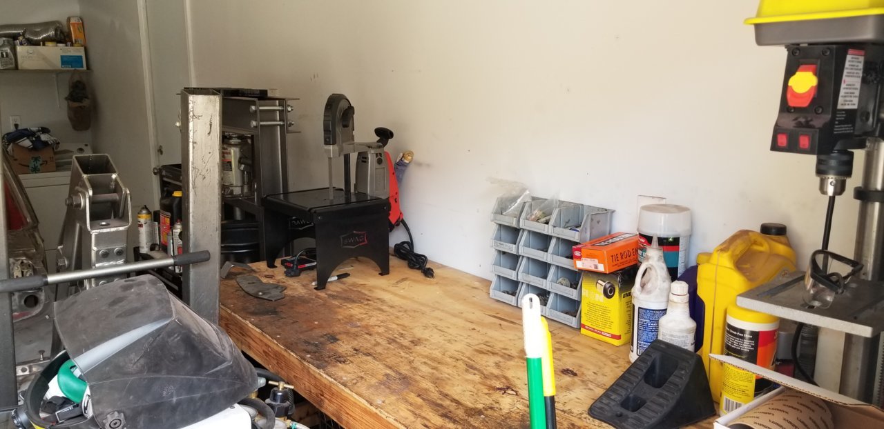

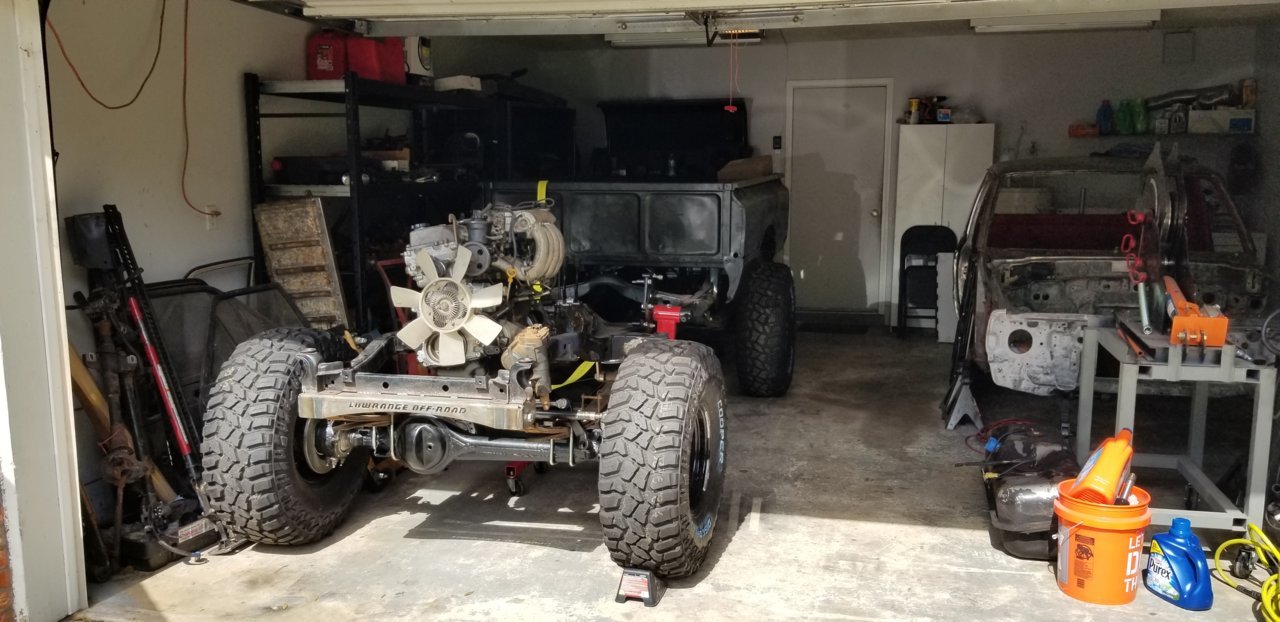

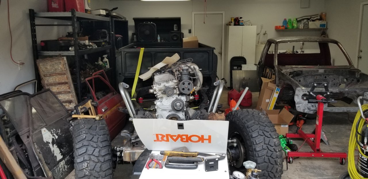

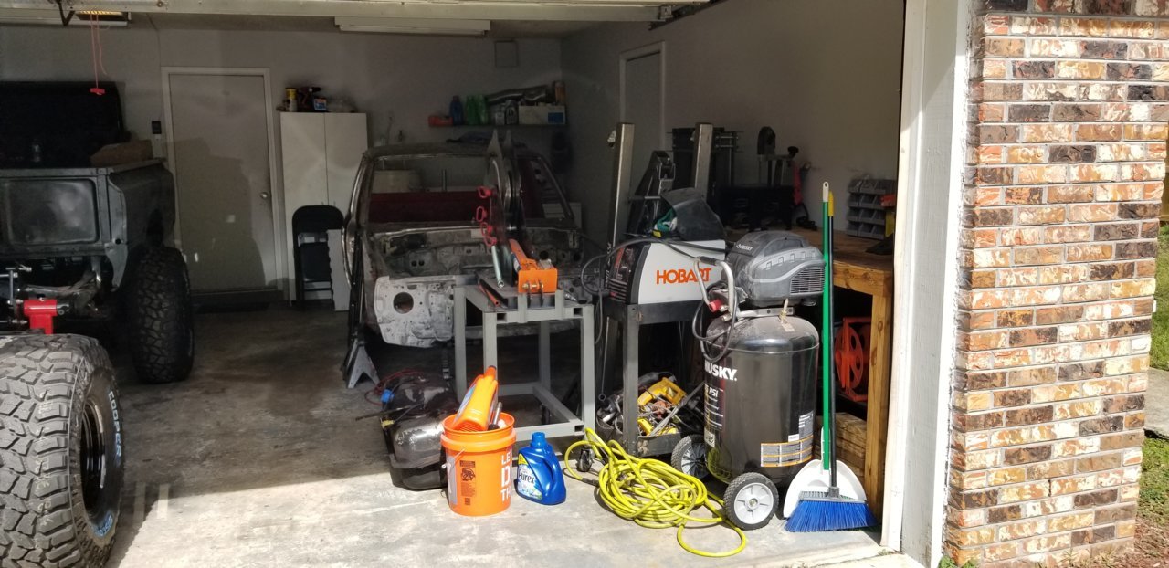

    didnt get much done today, but i did finally reorganize the garage for the most part. now i have plenty of room (just have to move the tools to the left) to work on the cab. next step is to use my fancy porta swag stand and cut my steering box mount to fit on the inside and weld the bitch up. then i need to get more sheet metal and i can proceed with fixing the holes on the cab and prime it up and drop it back down lol

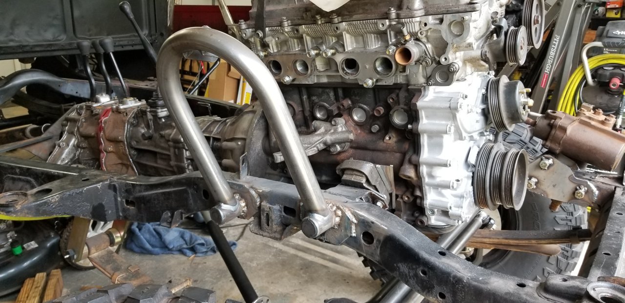

  3. Feb 19, 2019 at 1:00 PM
    #563
    Alfuh
    Alfuh [OP] It's pronounced alpha
    Aug 21, 2013
    #110878
    6,786
    Bismarck, North Dakota
    2006 Prerunner
    I have a few mods

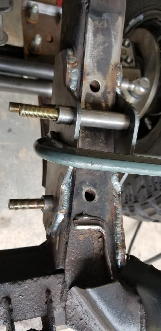

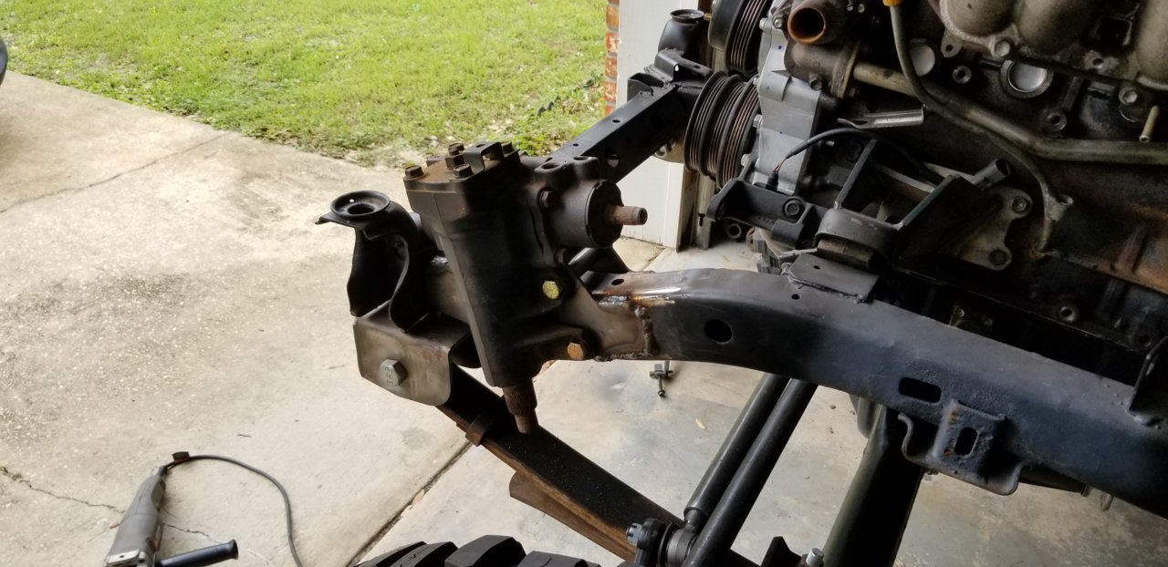

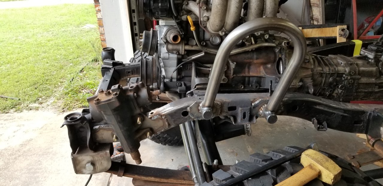

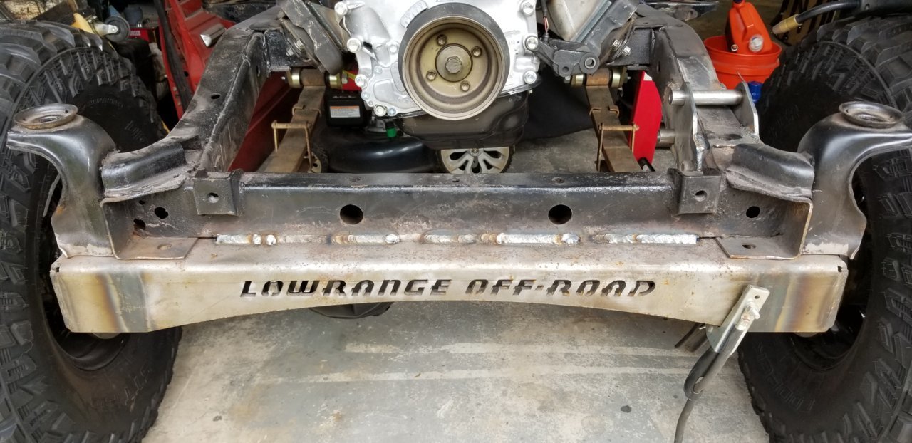

    got my steering box mount welded in today, think i may hit the tubes on up the inside to weld the 2 plates together. not the best welding...but i mean, im self taught and havent welded in months almost haha. also finished up the front hangar assembly welding the front in and underneath.
    tomorrow is gonna be the trans x member and shock hoops probably. then i need the rear shock mount and rear suspension finished up

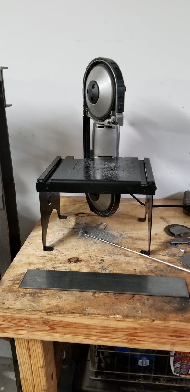

  4. Feb 21, 2019 at 5:31 PM
    #564
    Alfuh
    Aug 21, 2013
    #110878
    6,786
    2006 Prerunner
    I have a few mods

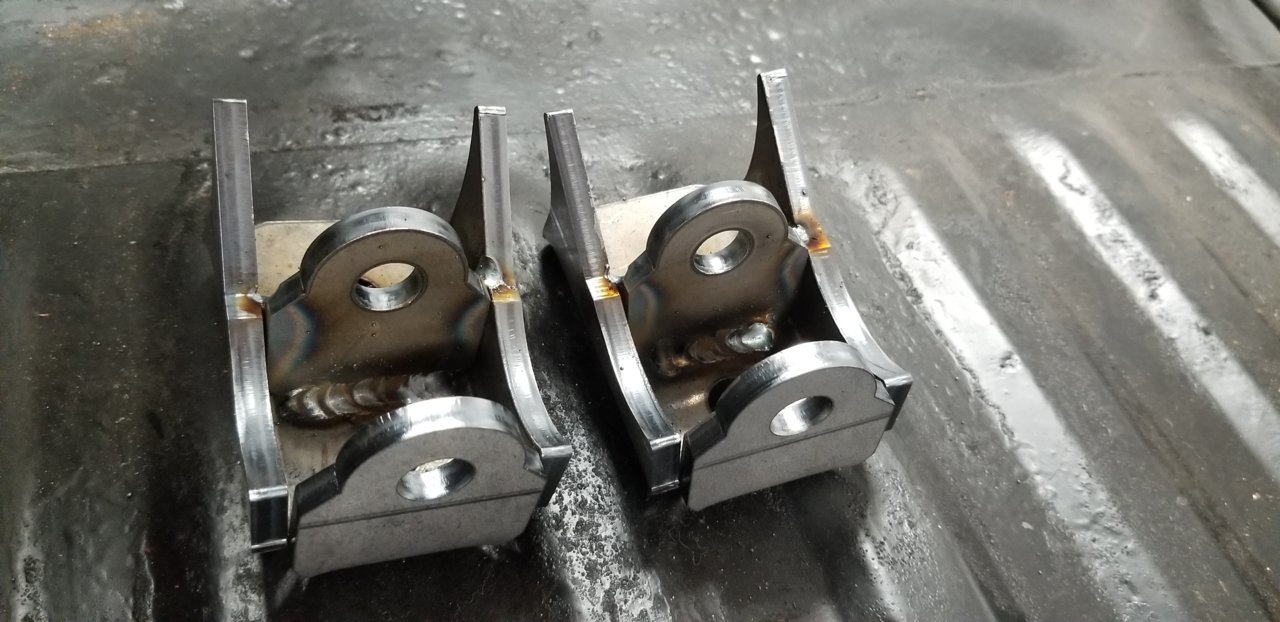

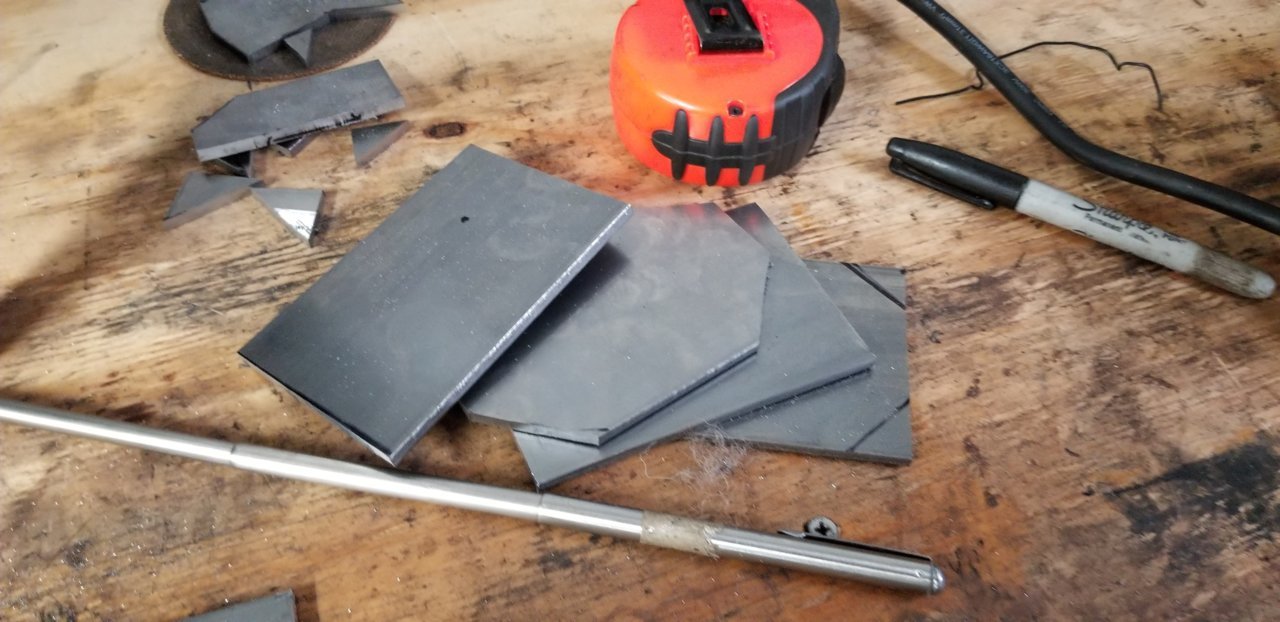

    didnt get too much done today, but i did get some more 22 gauge sheet metal for repairs and cut out some 3/16" plates to weld to the frame for the shock hoops. i do have to say, this porta band is amazing, cuts through metal like nothing

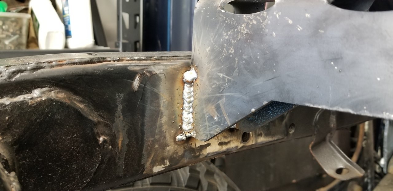

  5. Feb 22, 2019 at 3:35 PM
    #565
    Alfuh
    Aug 21, 2013
    #110878
    6,786
    2006 Prerunner
    I have a few mods

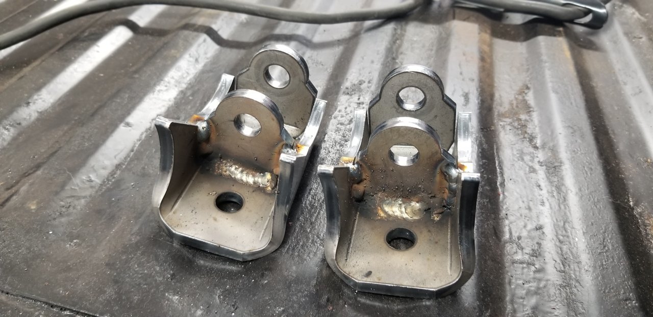

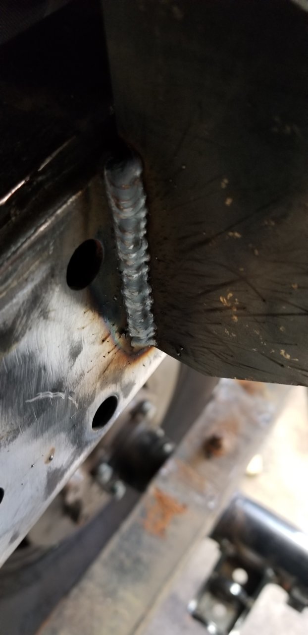

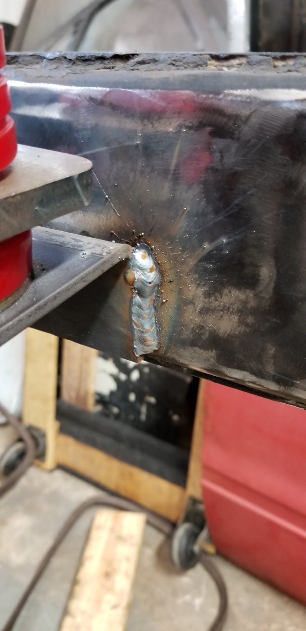

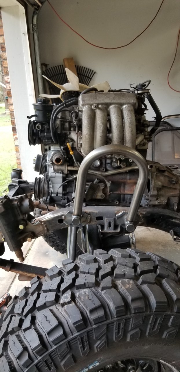

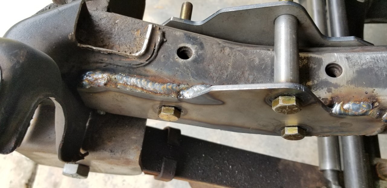

    more progress today, not the best result since my welder was acting up. not sure if it was just not a good enough ground or what. but some of the welds look terrbile and its mediocre at best. im gonna most likely take the chassis by a buddy and have him look over everything and touch some spots up to make sure its good to go
    but im happy the plates and hoops are on, just need the braces on and get the trans crossmember and rear shock brace in

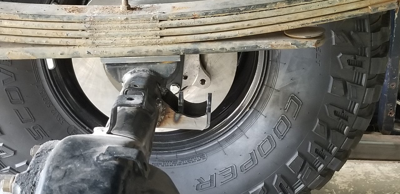

    Where did you get the rear spring perches for the rear axle leaf springs? Im needing to move mine a few inches forward

    what I got was axle relocation plates, they are literally just a pair of steel plates with a center pin notch and 2 holes for either 3/4" or 1" movement forwards or back. Got them off YotaMasters but they are All Pro plates
    https://www.yotamasters.com/shop/su...rear-suspension-parts/axle-relocation-plates/

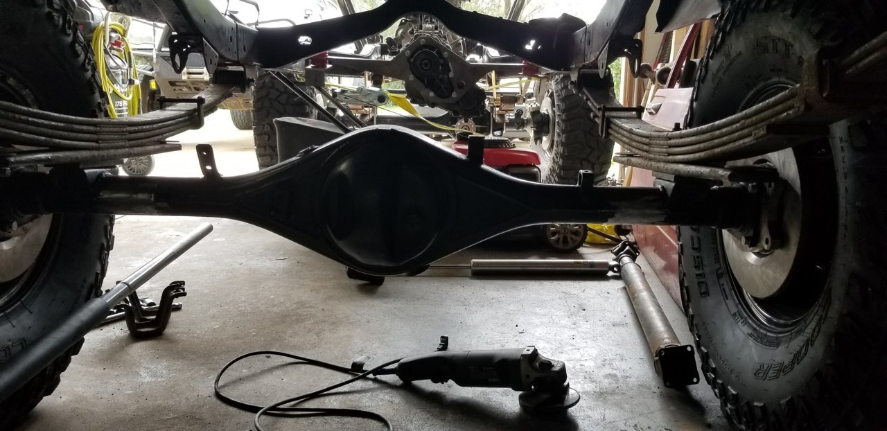

  9. Mar 2, 2019 at 7:38 AM
    #569
    Alfuh
    Aug 21, 2013
    #110878
    6,786
    2006 Prerunner
    I have a few mods

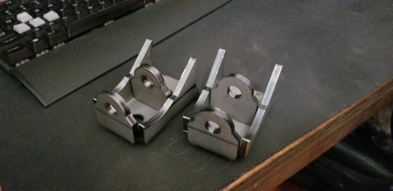

    got these babies in yesterday, can finally get the rear shocks put in place and welded in
  10. Mar 3, 2019 at 4:48 PM
    #570
    Alfuh
    Aug 21, 2013
    #110878
    6,786
    2006 Prerunner
    I have a few mods

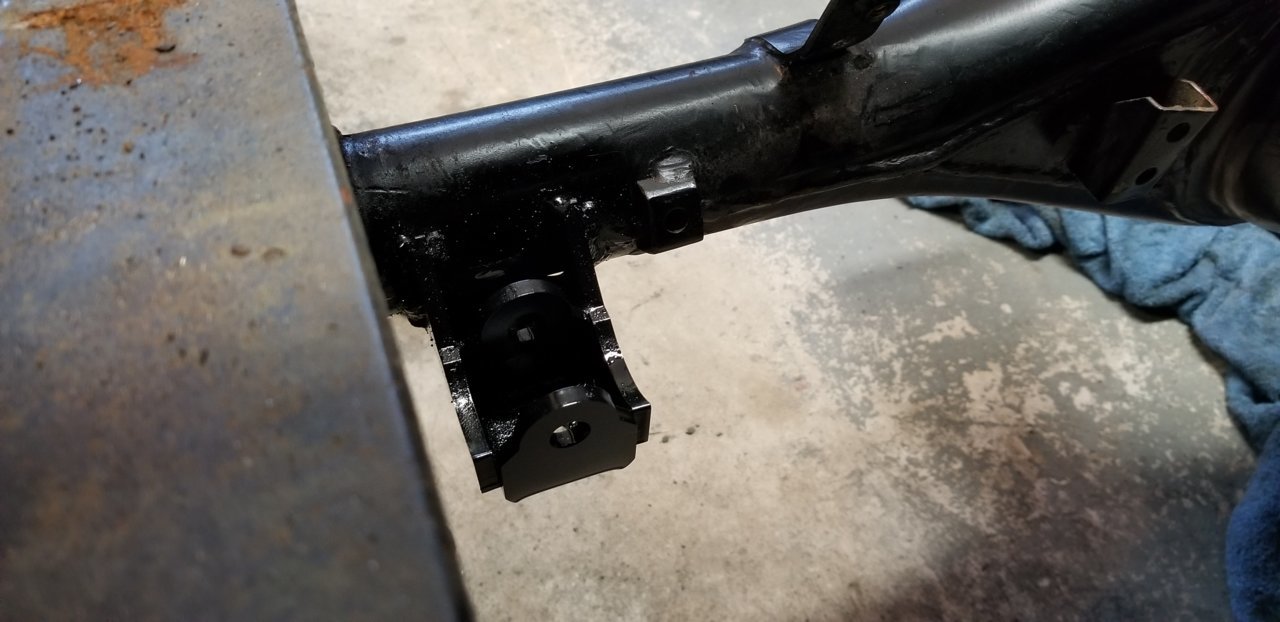

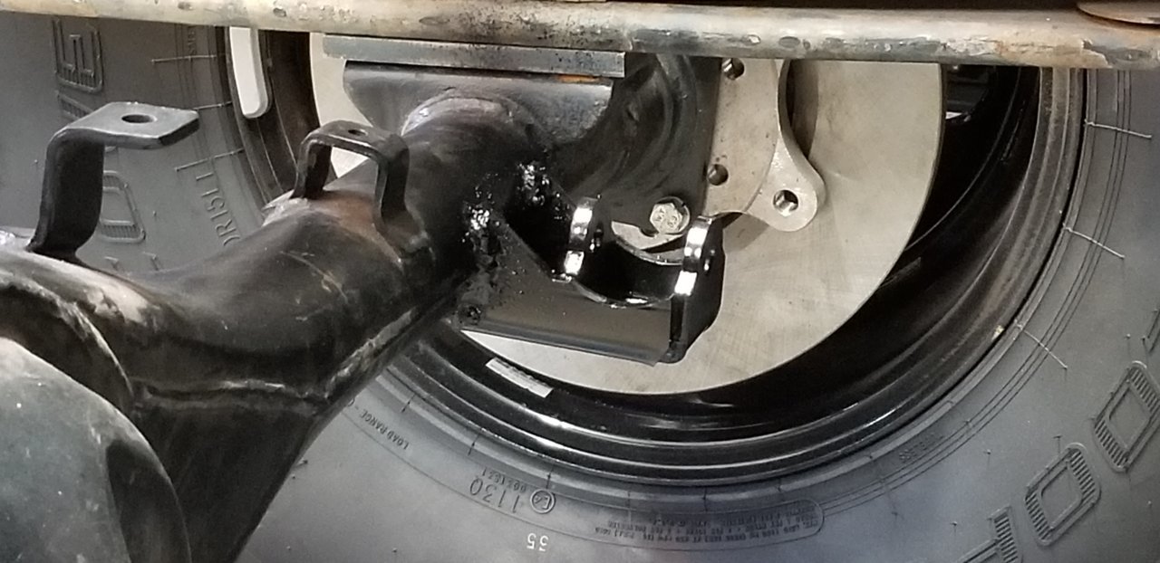

    got the mounts welded up and axle cleaned up to get ready to weld the shock mounts on
  11. Mar 4, 2019 at 11:06 AM
    #571
    Alfuh
    Aug 21, 2013
    #110878
    6,786
    2006 Prerunner
    I have a few mods

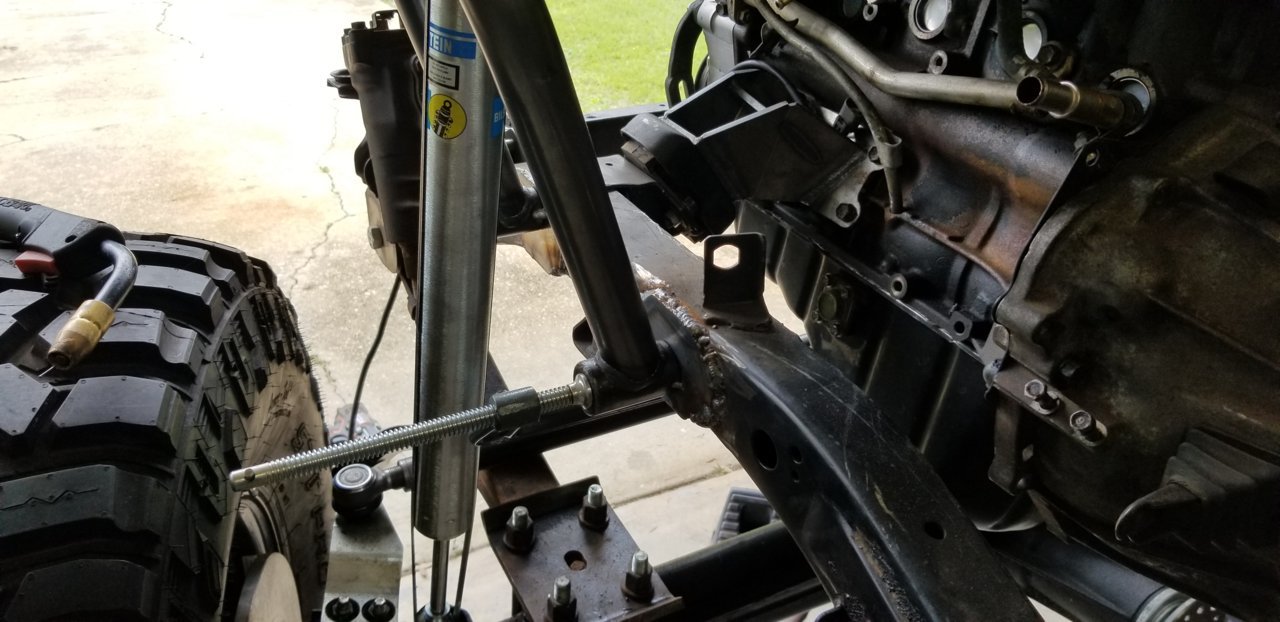

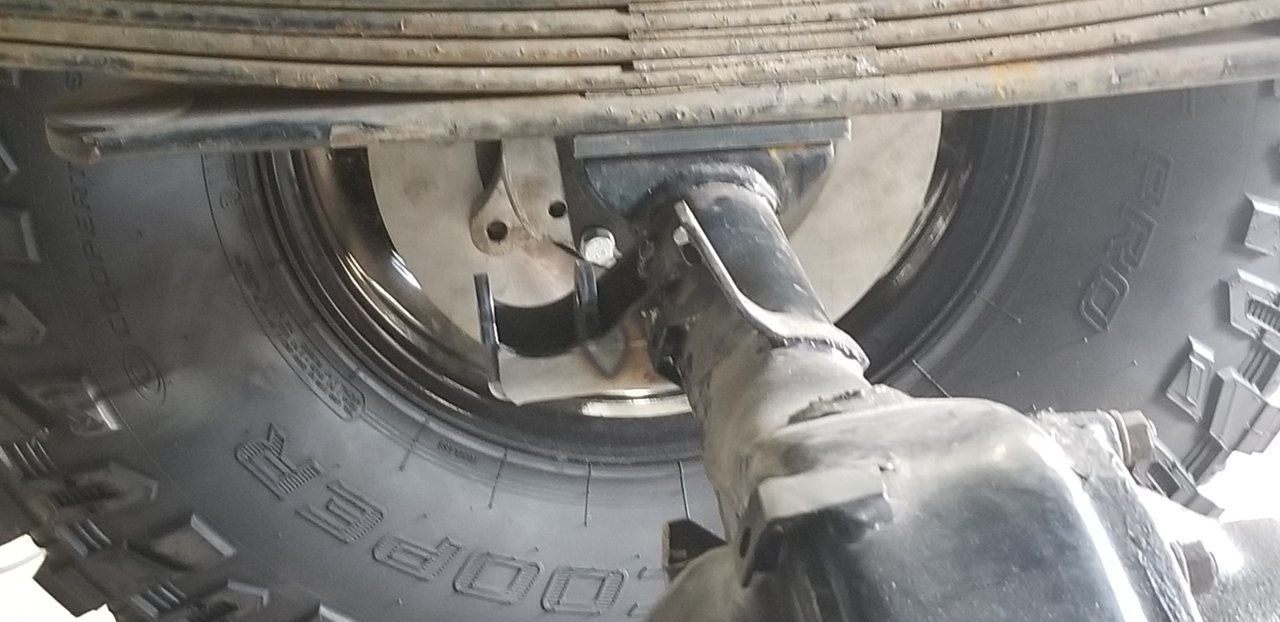

    not much progress today, flipped my relocation plates around to the 3/4" side to get a little more forward for the top shock mount so the top and bottom align better. Got the lower shock mounts welded in today, tomorrow ill get the top mount welded in and possibly get the trans x member done too. just taking this one little thing at a time

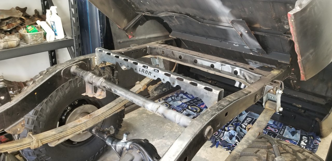

  12. Mar 7, 2019 at 8:52 PM
    #572
    Alfuh
    Aug 21, 2013
    #110878
    6,786
    2006 Prerunner
    I have a few mods

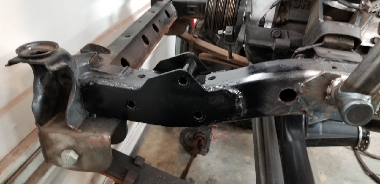

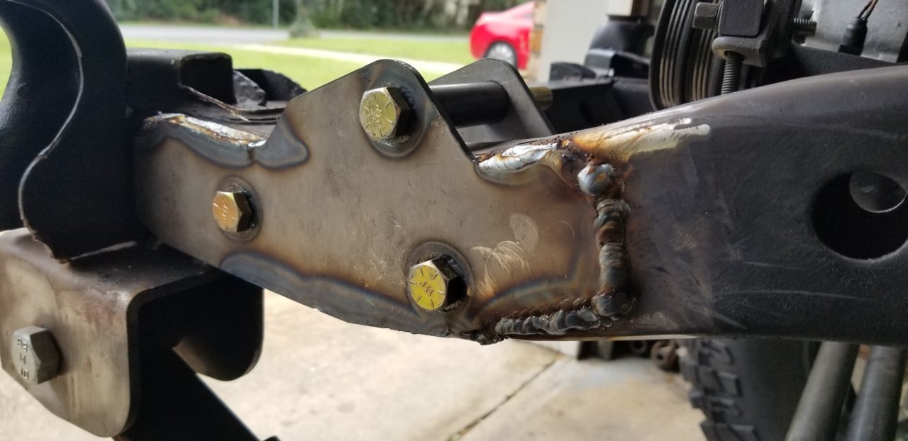

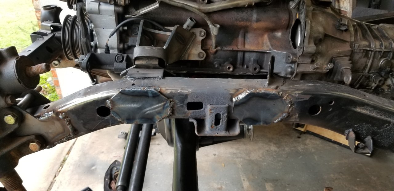

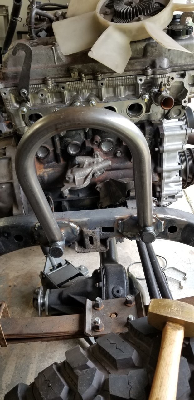

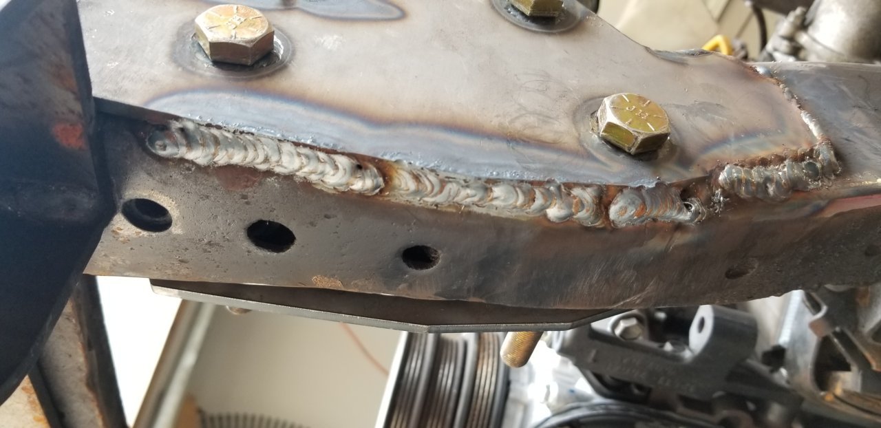

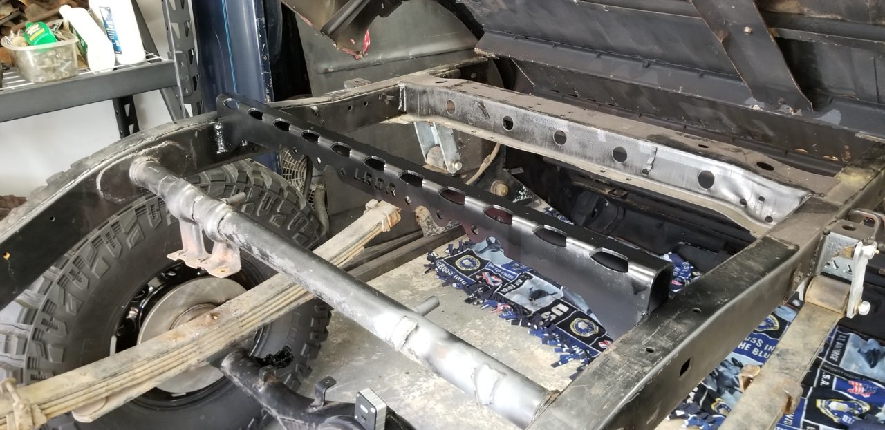

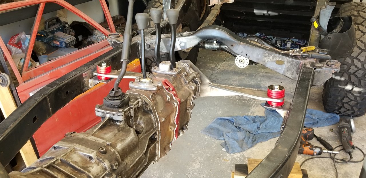

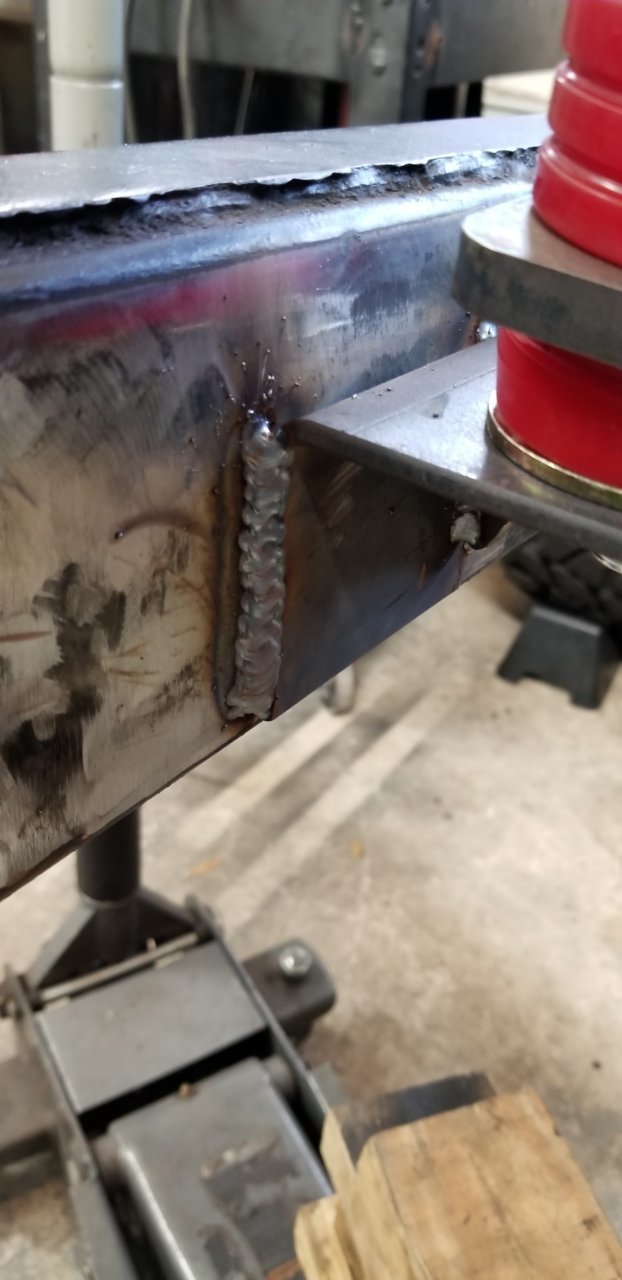

    got the upper shock mount, then got the trans crossmember brackets welded in. I might hit up some other spots on the brackets to ensure it doesnt go anywhere. slowly getting better with the welding....a lot better than what i was able to do previously

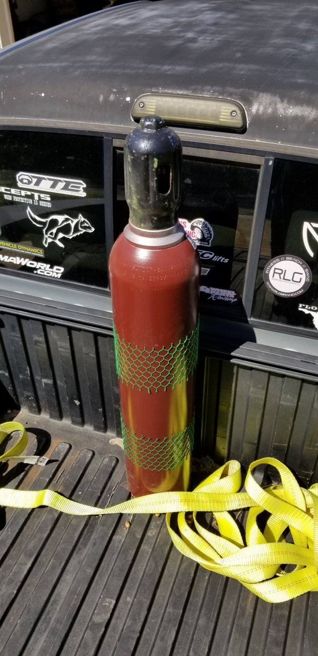

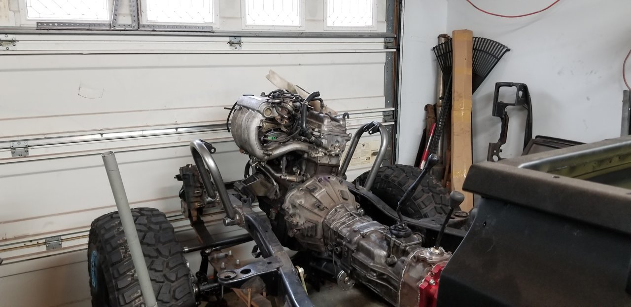

    finally had to get a new tank of shielding gas for my welder, ran out finally haha. other than that, got the rear shock mounts painted along with the steering box. just need to get the shock hoop braces cut and welded in and i can paint everything else. after that...I do believe everything is finally welded in place...the truck is seriously getting really close to firing for the first time in almost 2 years... i cant wait haha

  13. Mar 8, 2019 at 7:35 AM
    #573
    Bigdaddy4760
    Aug 6, 2017
    #226049
    77,337
    Maner
    Poolville Texas
    Where did you get this rear transmission brace. Thanks
    96accord and ChadsPride like this.
  14. Mar 8, 2019 at 8:21 AM
    #574
    Alfuh
    Aug 21, 2013
    #110878
    6,786
    2006 Prerunner
    I have a few mods
    Front Range Offroad my man!

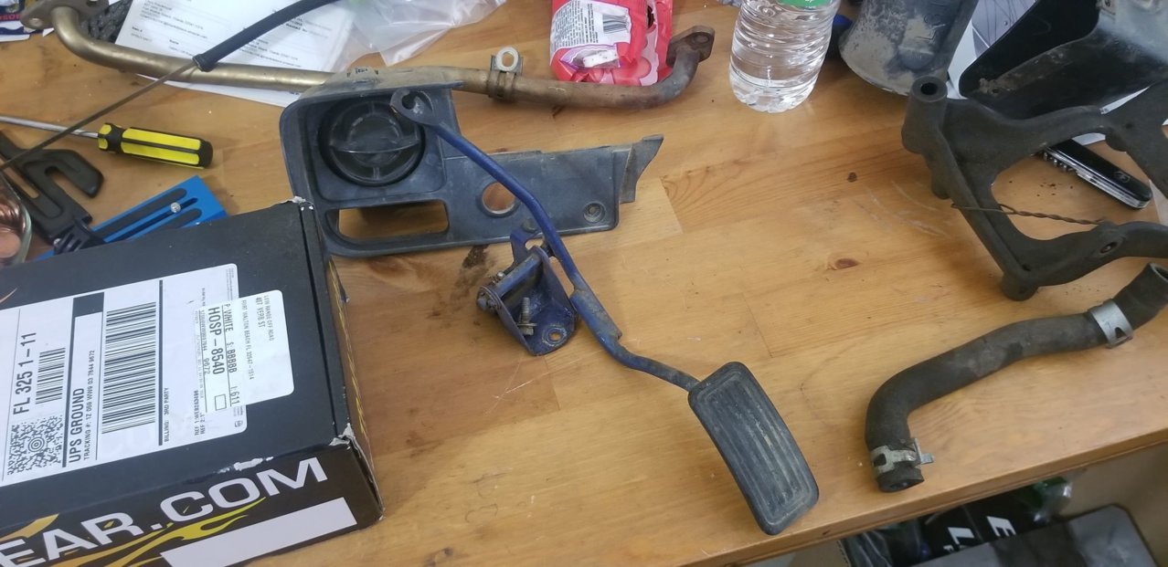

  20. Mar 9, 2019 at 5:44 PM
    #580
    Alfuh
    Aug 21, 2013
    #110878
    6,786
    2006 Prerunner
    I have a few mods

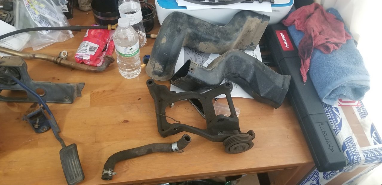

    scored some more stuff today! got some seats from a DLX 1st gen I think, these arent the best, but not too bad. some cleaning and they will be good to go, they should bolt right in too! got a new accelerator pedal thats a different style that will work way better than the previous style. also got a an AC compressor bracket for my 3rz and some extra AC tube routing and dash piece for the dash in the 1st gen to route the air to the driver side
