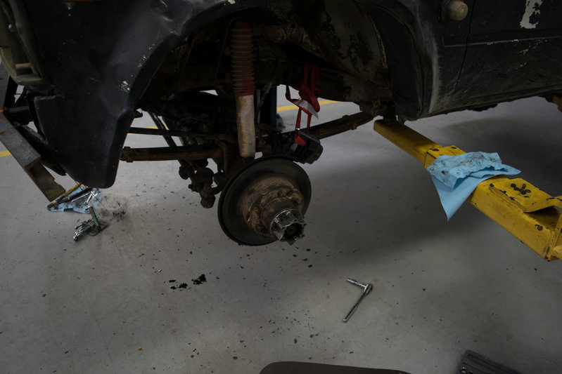

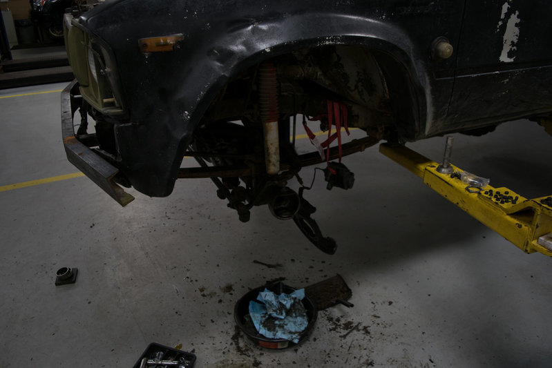

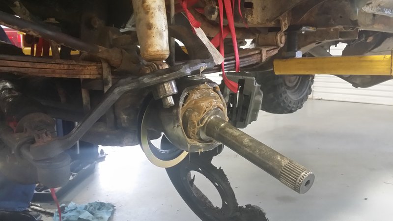

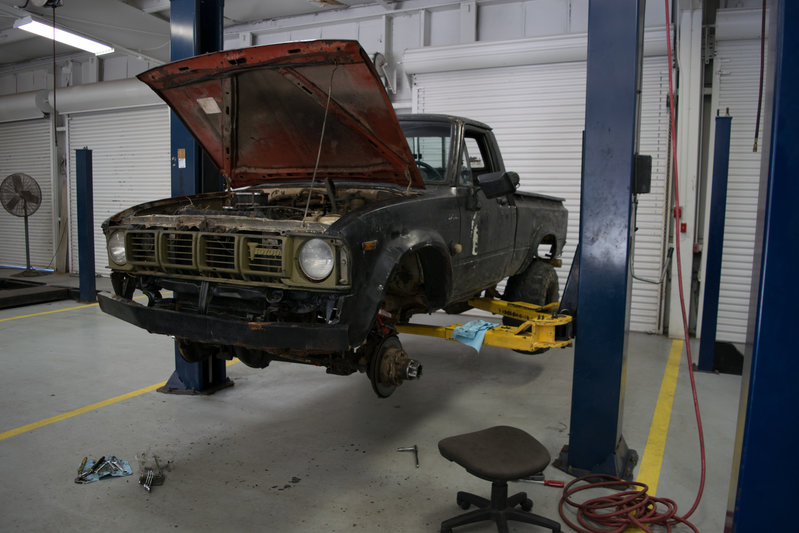

    got my front end rebuilt last weekend, just need to figure out why my locking hub dial assembly doesnt want to slide in like its supposed to. Other than that, front end is rebuilt, put 2" wheel spacers on from trail gear so i can fit my TRD Offroad wheels and my old 265/75r16 Nitto Terra Grapplers. The old super swampers had a death wobble at 28mph lol, once the "new" tires were on the death wobble went away haha.
    I still need to get that damned transmission in with getting the driveshaft cut down for it. Just waiting on my FSM I bought off Ebay to get in so I can start on putting in the new wiring harness then I'll be buying some 24"x54" sheets of 22 gauge sheet metal so I can redo the joke of a floor thats in there lol, so rotted, but its only gonna cost $106 with shipping for those 2 sheets of 22 gauge sheet metal. Once I get these things done...the truck will be pretty much streetable again and then I can start working on getting her some new wheels and tires and some flexy suspension so she'll be trail worthy finally

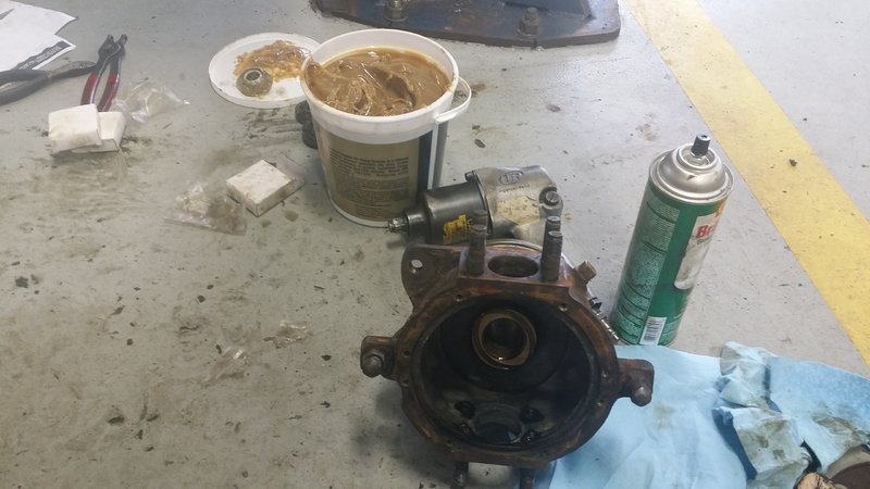

    got a small thing done today, finally went out and messed with my passenger side locking hub dial and figured out why it wasnt wanting to slide in or operate properly. the spring that holds the clutch to the dial itself came out of the teeth inside the clutch. So I just took the whole thing apart and put it back together and it all went right back together
