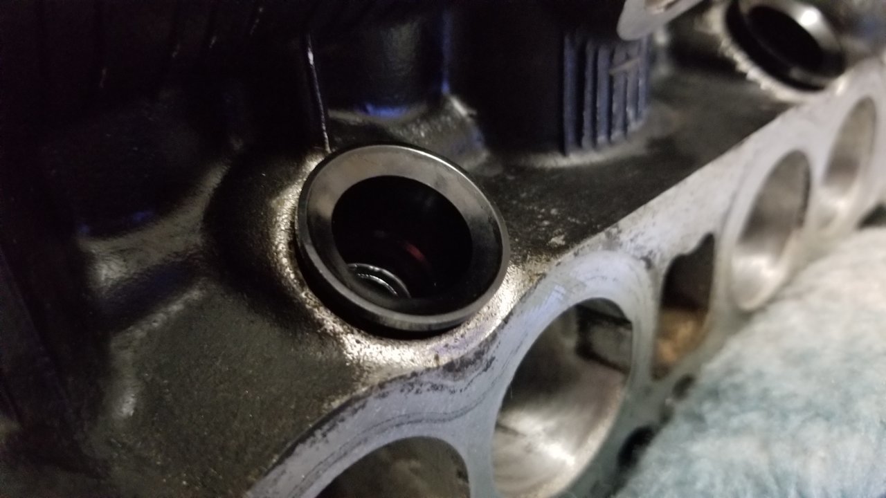

    I have a few mods
    finally got this bullshit out of the way lmao. new injector cups in, also got new seals for all injectors, new temp sensors too. next step is pulling the oil pan again and resealing that up and teflon taping my fuel fittings to stop the leaking. then just mess with the brakelines again

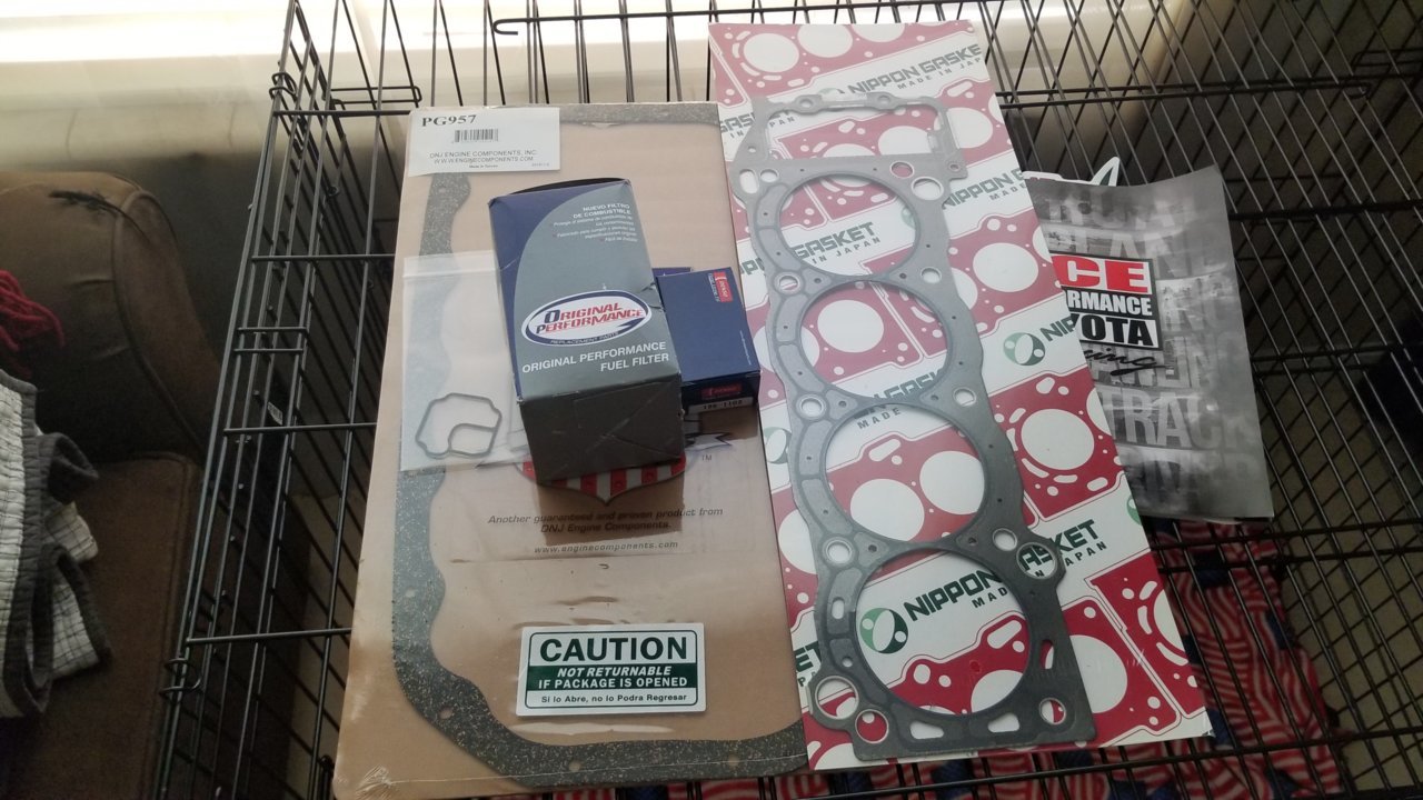

    I have a few mods
    quick update, got the cylinder head and the new headgasket back on finally. Not sure how much work I'm actually gonna be able to do in the next few weeks, I fell off my long board running my dog and semi fractured my right wrist (my dominant hand of course), an Avulsion fracture is what the Doc called it. Not a true fracture, but when the muscles pulled it brought bone fragments with it, hurts like hell when I bend it after a certain degree. So it's kinda hard to get anything done lmao, had to have my roommate help me lift the cylinder head into position. But I need some help too, I need to find a 3rz MANUAL engine harness. The harness I have I think is an automatic harness and I need to find a manual harness to make things easier even though I only have a manual ECU

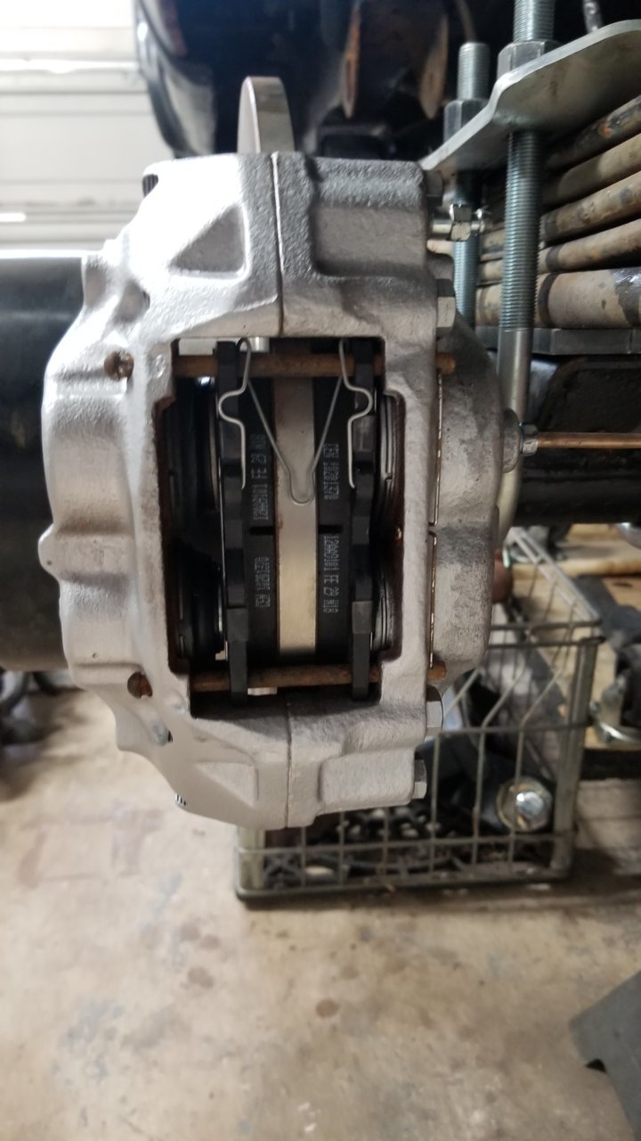

    thanks! yeah i definitely didn't cheap out on my kit, i got a nice OTC double flare kit. i did get copper/nickle 3/16 lines, so those are more forgiving over steel. although i had a local offroad group guy come by to look at the lines and because they are copper nickle, all I really needed to do was tighten and loosen several times. he got my clutch master to stop leaking by doing that lol

    thanks man, yeah I cant wait to start working on the truck again. Yeah I had a buddy come by and show me that all I needed to do was loosen and tighten several times to get the line to seat properly, he got my clutch master to stop leaking. so I need to do that to all the other lines now lol

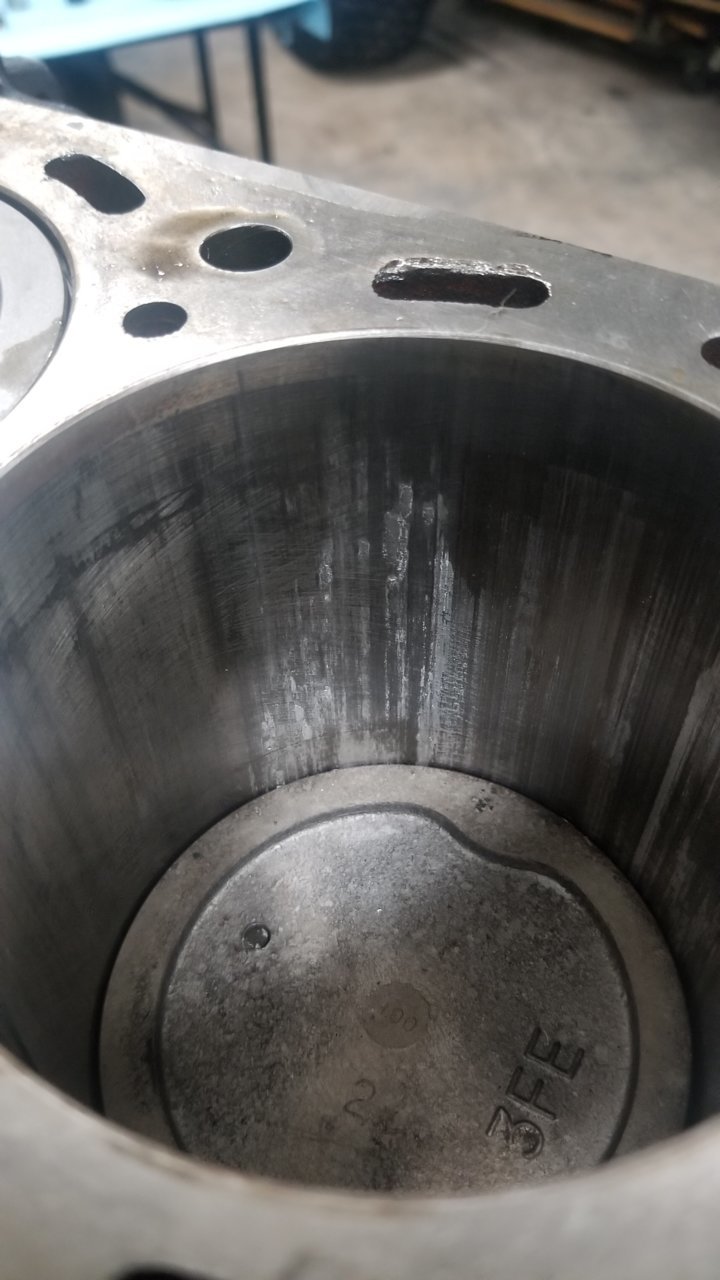

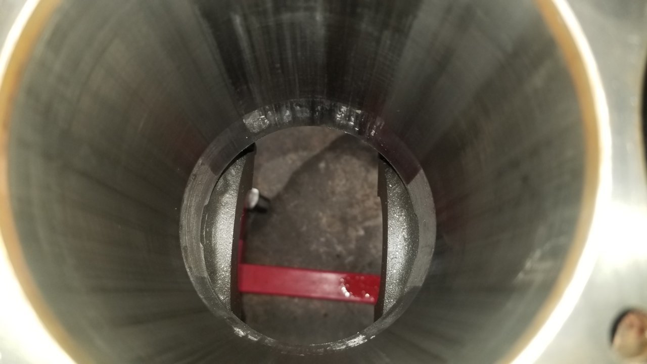

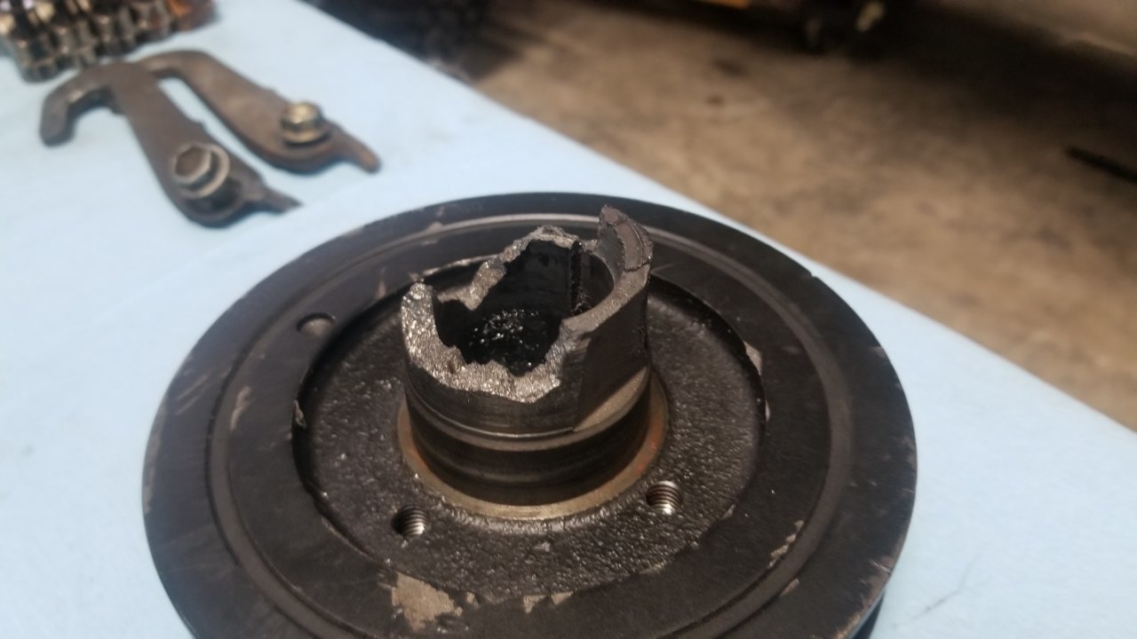

    I have a few mods

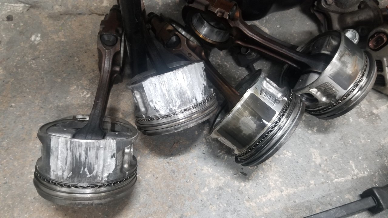

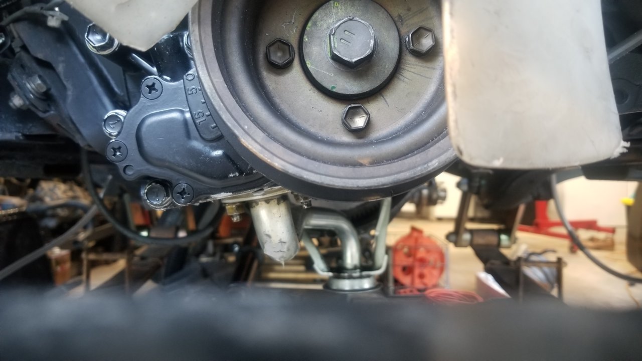

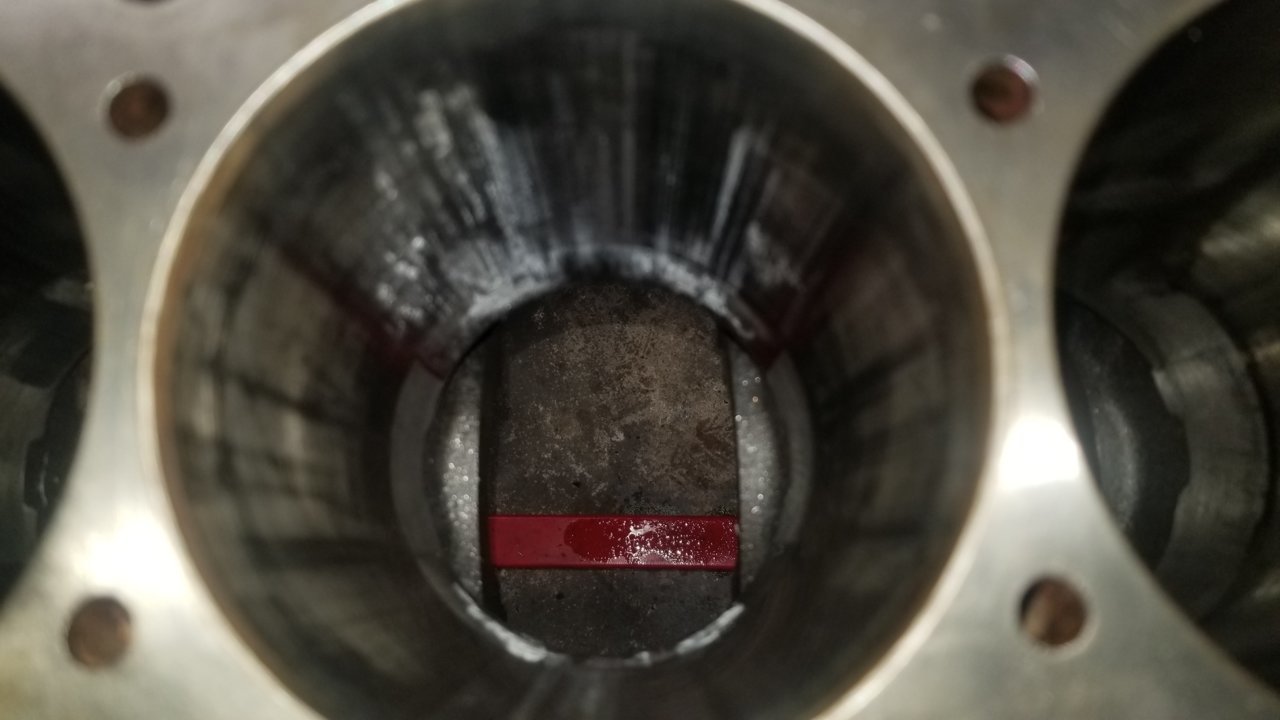

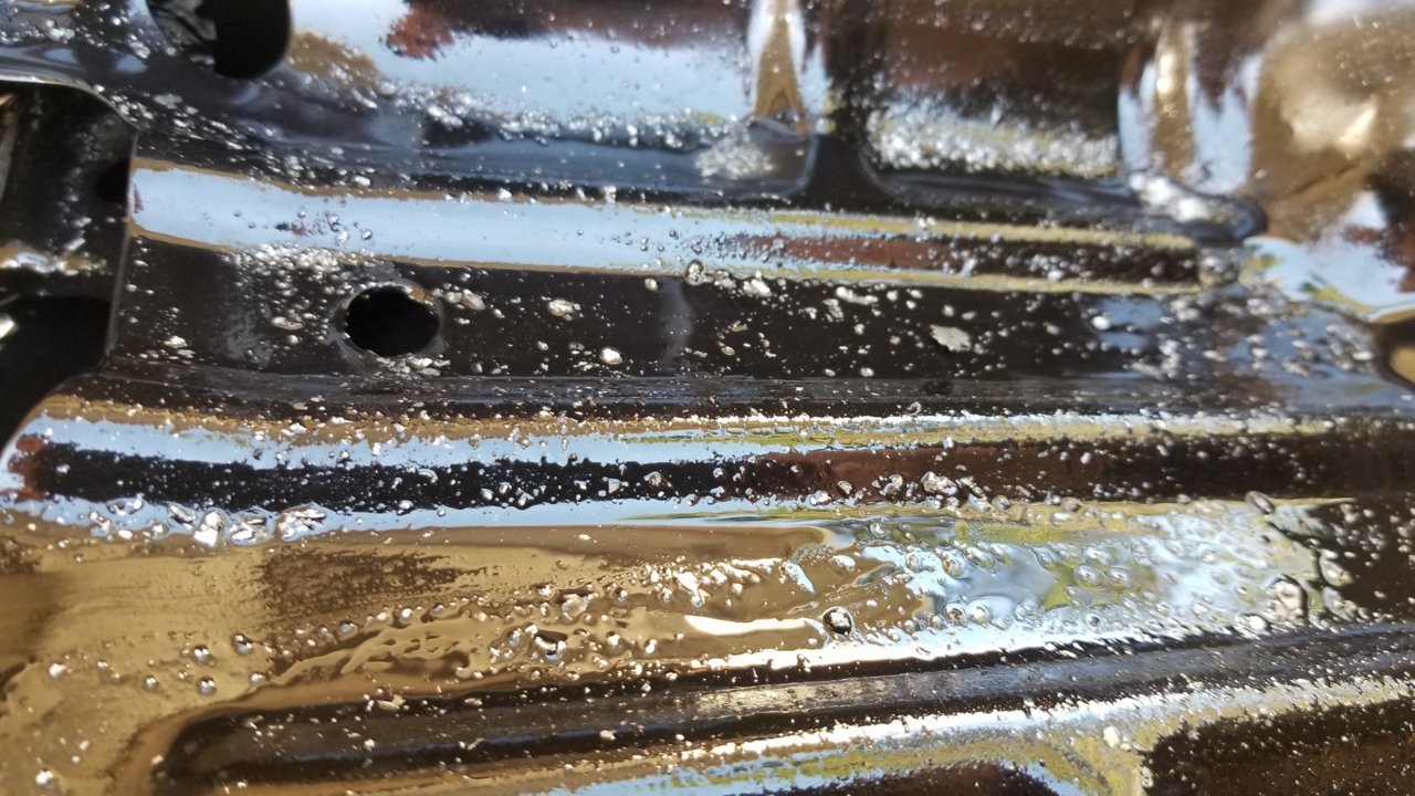

    welp. so I had needed to pull the oil pan to reseal it up since a spot got messed up; well....I then find shavings galore in the pan. my balancer was also off almost 180* for the TDC mark. so I had a feeling SOMETHING was wrong. just to be safe i pulled the engine (at this point its stupid easy for me) and pull it all apart again. I thought it may have been something I did mechanically. NOPE, damn harmonic balancer snout blew up IN the timing cover, which in turn threw shavings all in the oil pan, also got all up into cylinders #1 and #2 ruining them and damaging the walls pretty good.
    it doesn't look good right now, brought it to a performance shop to have it looked at and since their machinist wasn't in, they told me to bring it by monday again. But, since I already have an .040 bore over...it's an iffy save. Ill find out monday. Need to find me a junkyard 3rz so i can get this truck driving.
    Good news though, the brake lines are like 95% a few fittings need better seating, but all 4 calipers have pressure and all pistons are working which is awesome
    Thunder Fist and ChadsPride like this.

    I have a few mods
    more like 12 steps lmao. this always happens to me haha. This most definitely happened on the very first startup. there was a pretty big spark that came from the engine that I have no idea where it originated. I thought it may have been electrical, but, all the wiring was good to go. so im thinking that was the balancer blowing up
  19. Nov 8, 2019 at 8:23 AM

    Well you found the root cause now you just have to fix it. I think Lee had a 3rz block but not sure.

    I have a few mods
    yeaaaaaa, i have to wait until Monday to see if it is even fixable sadly :( theres a very good chance its not saveable because of the .040 bore already
