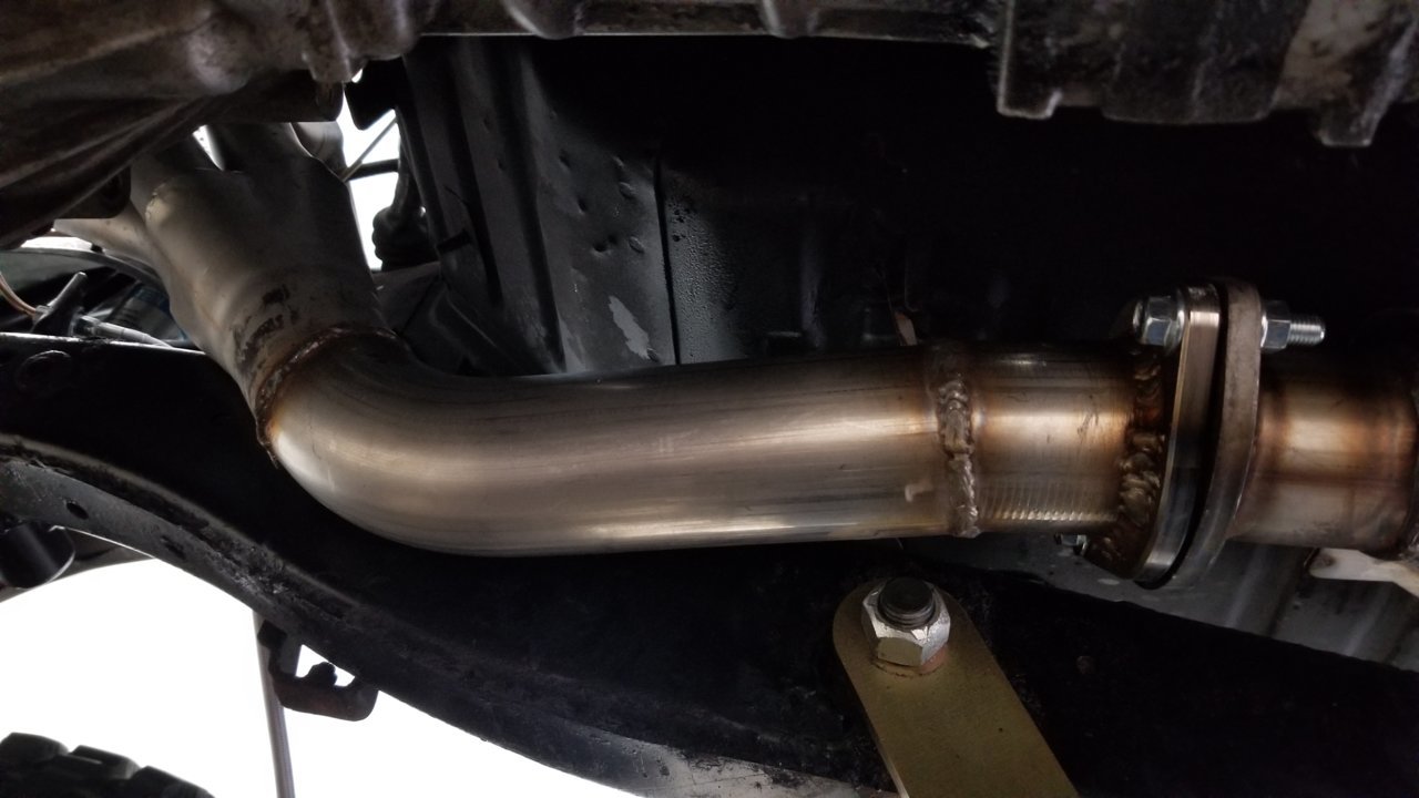

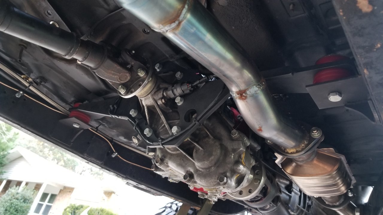

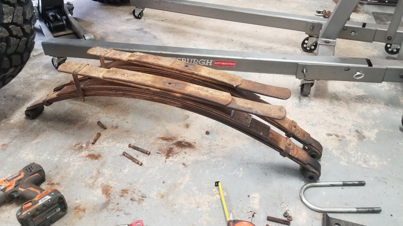

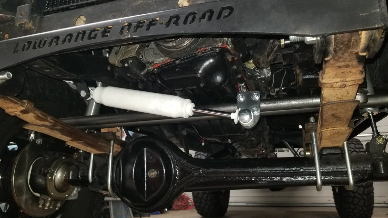

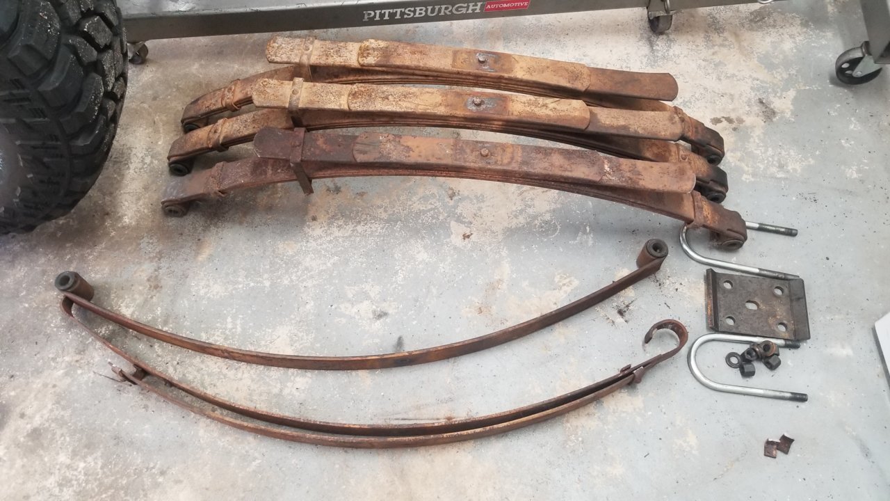

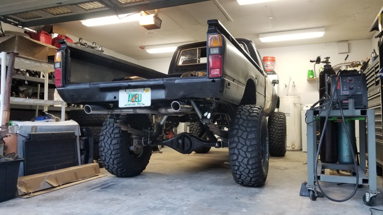

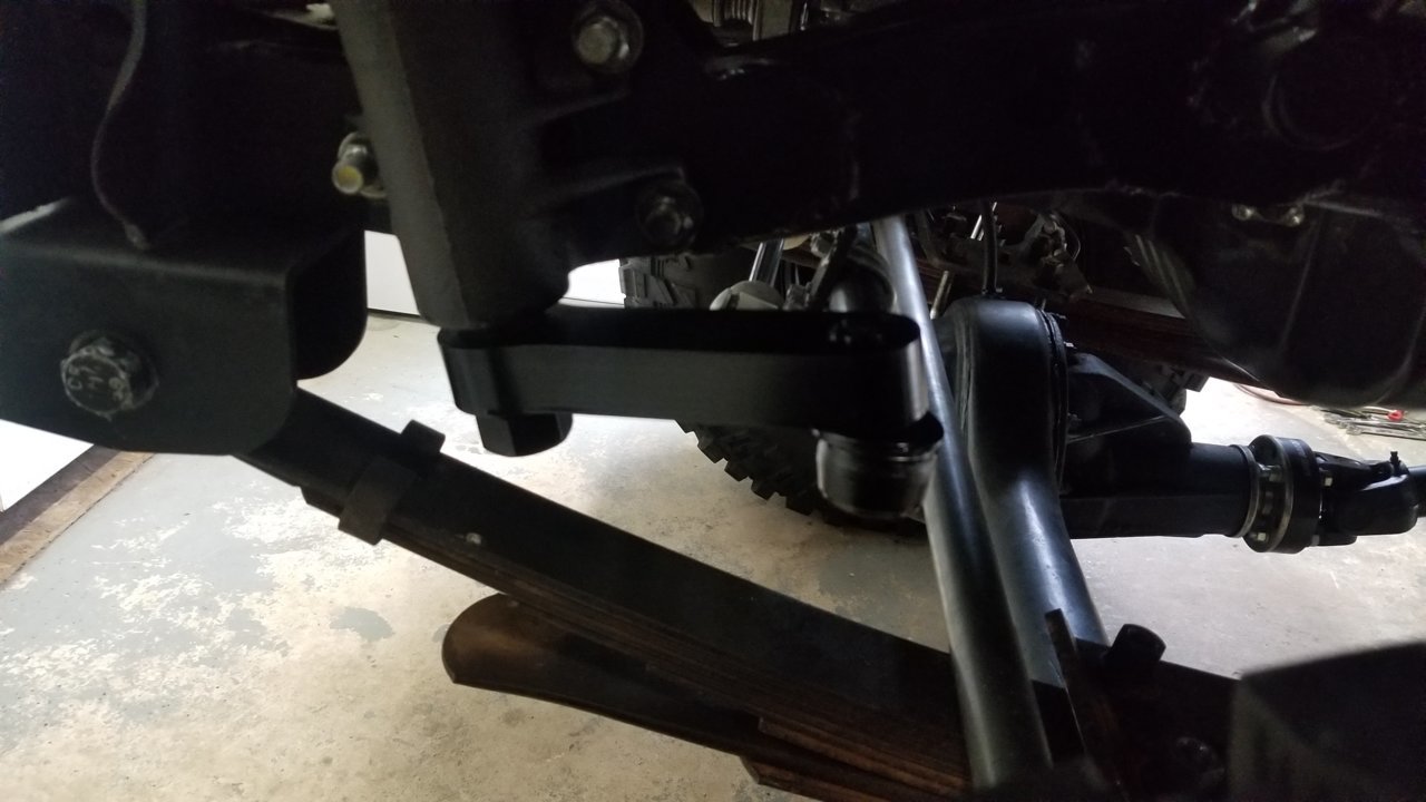

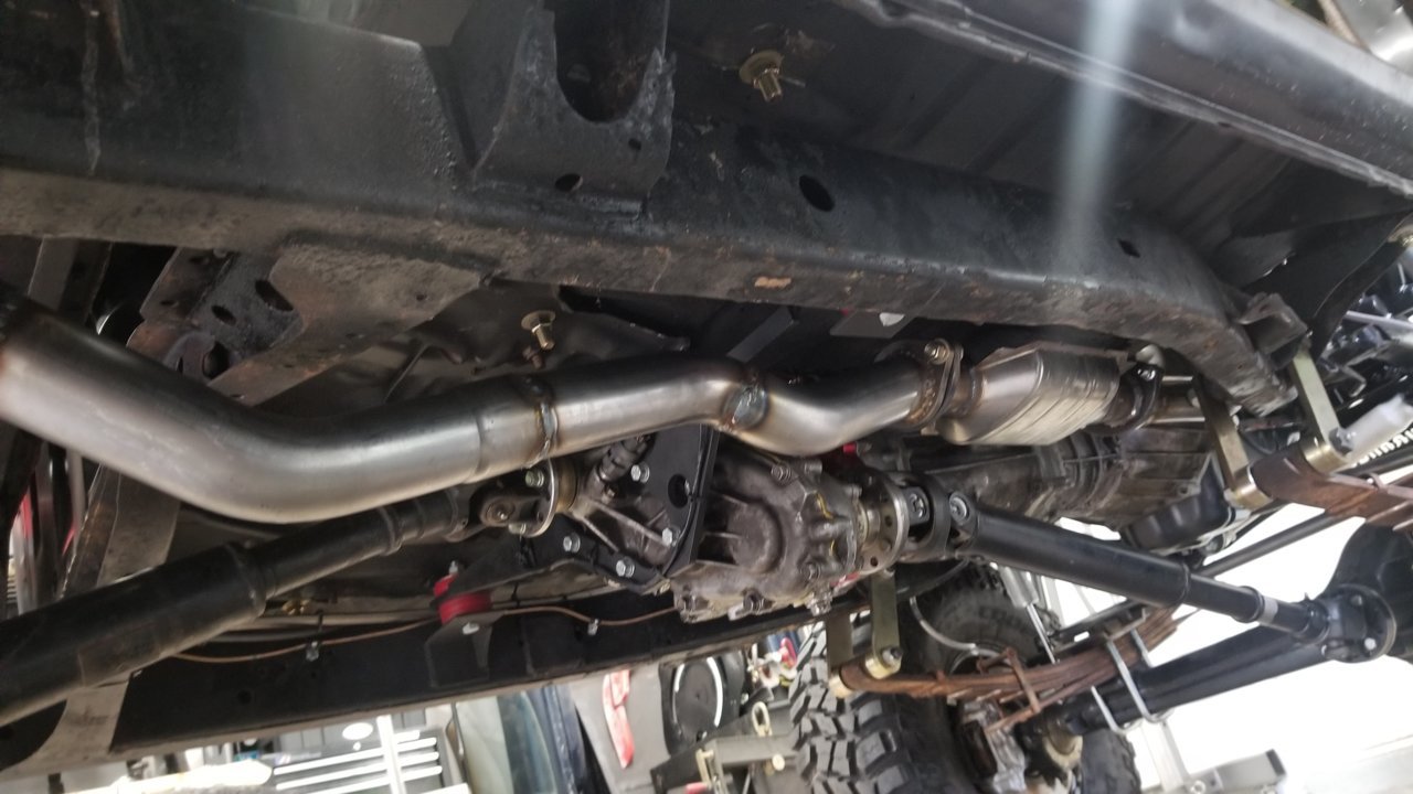

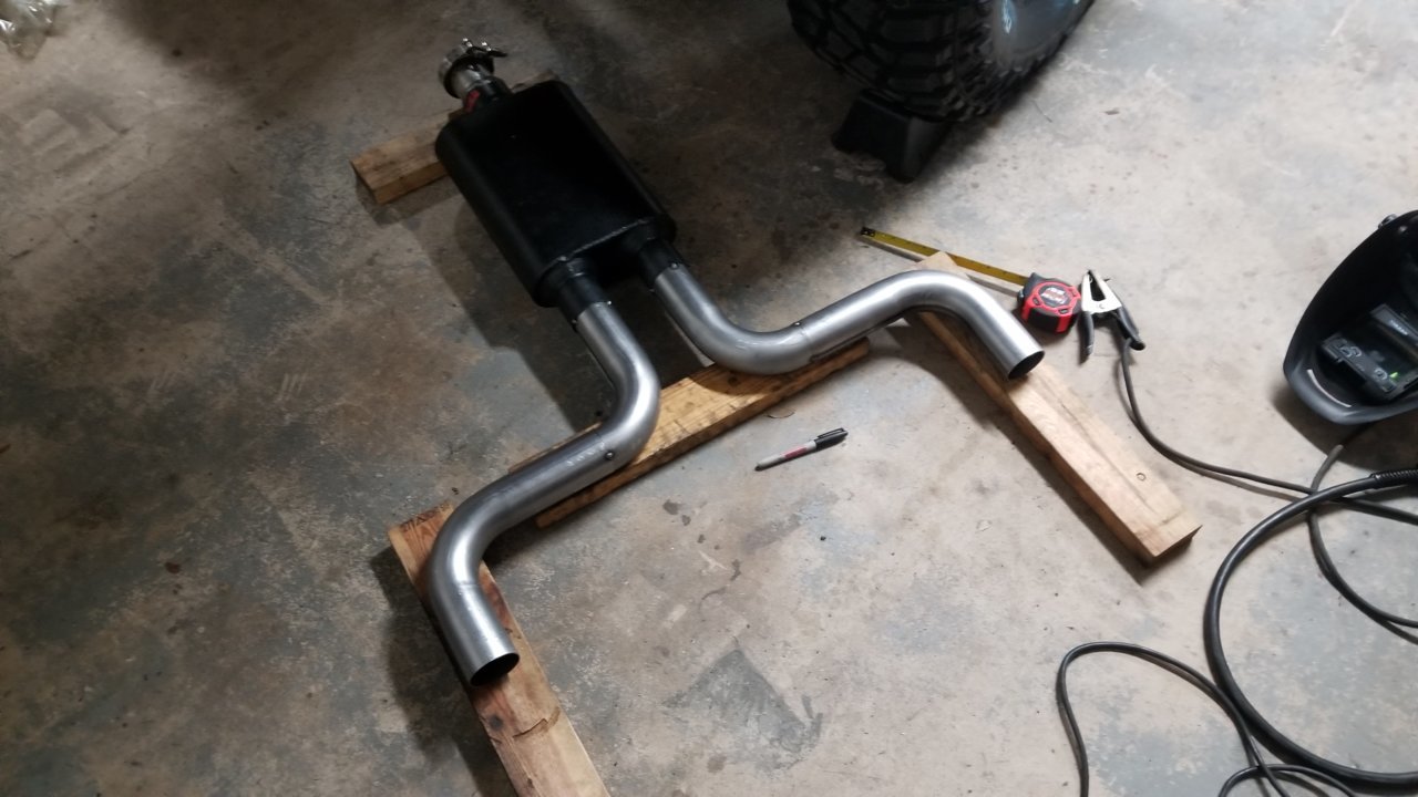

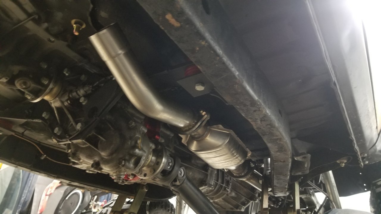

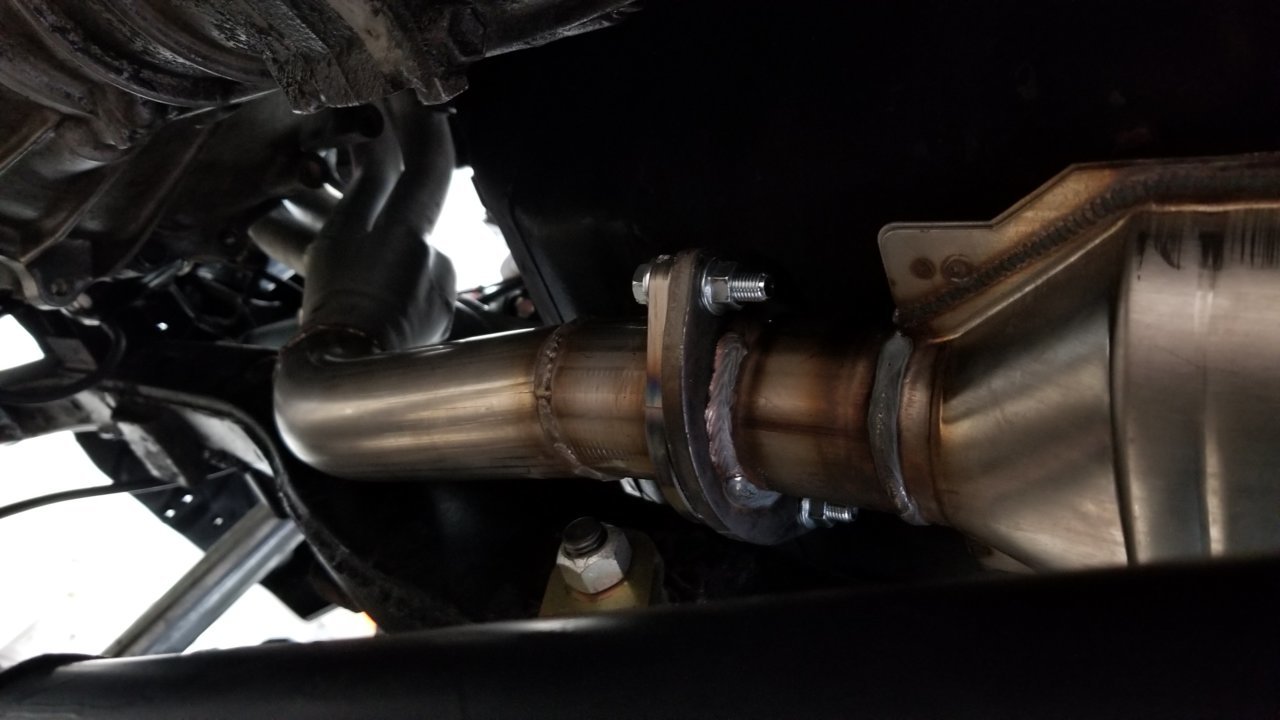

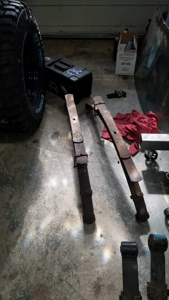

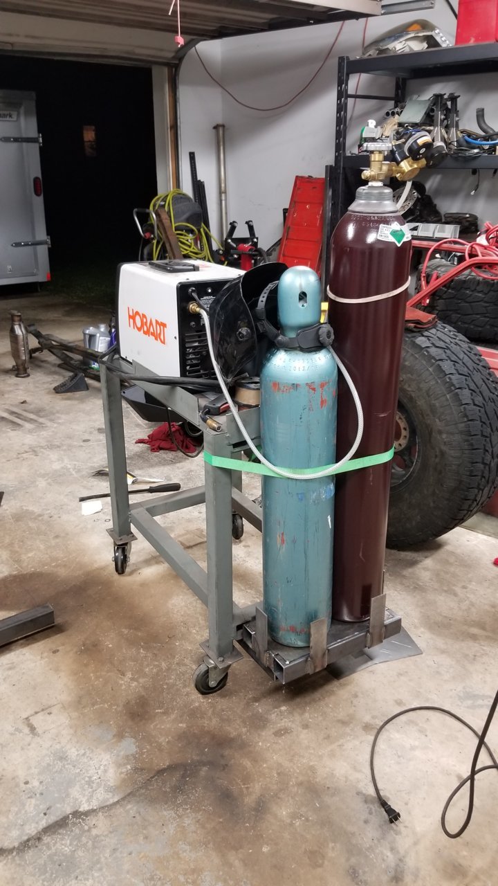

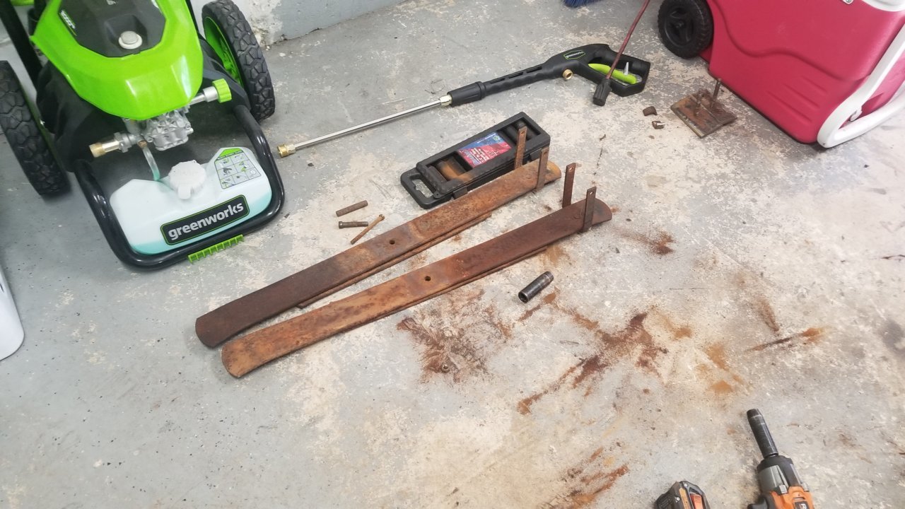

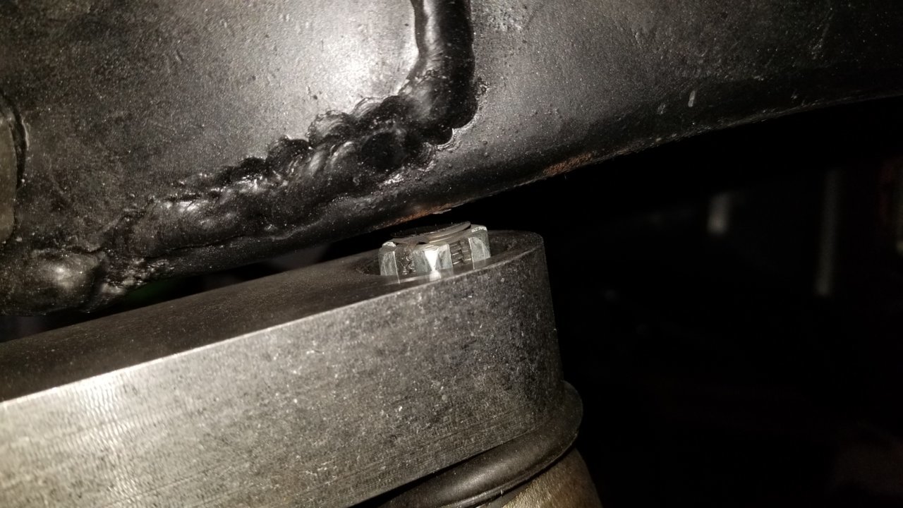

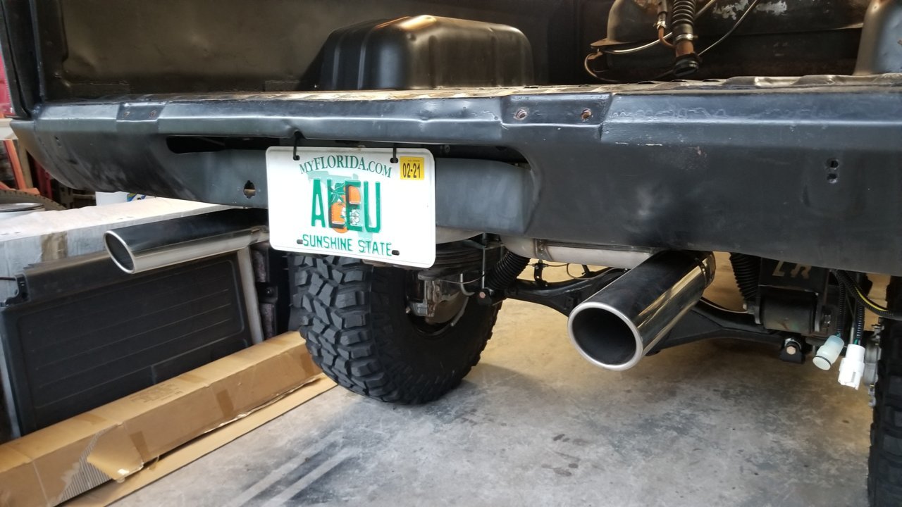

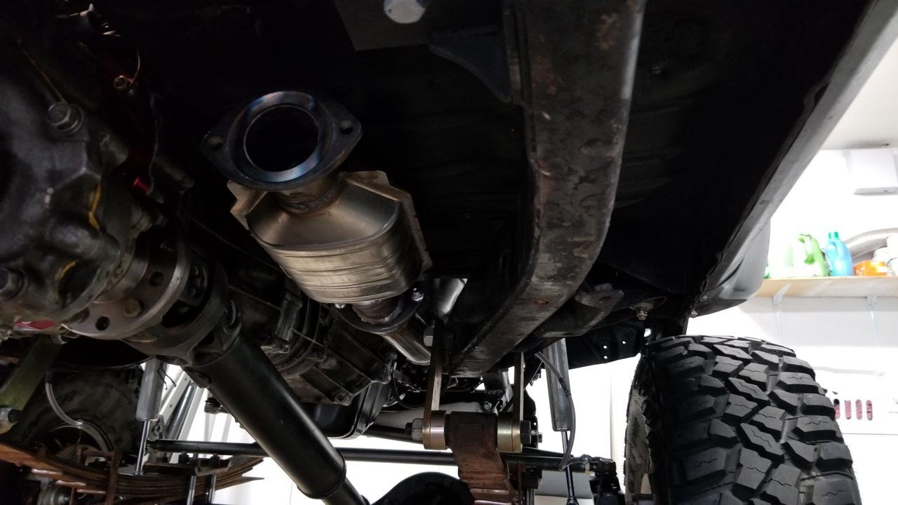

    Hey guys, sorry for the lack of updates in the last few months, been busy with holidays and dealing with stupid overseas shit (not happening....I hate people). BUT, I've gotten a great bit done however. Steering stabilizer has been installed, the new RUF pack has been put together; works awesome since I was bottoming out my pitman arm on the 1 set of leafs lmao; but I will need to get another set and replace the driver set since that whole side is STILL leaning. The truck has some crazy ass flex and since I had my front DS made BEFORE doing the full RUF pack.....my DS is too short and I cant fully flex or the drive shaft pops apart lmao. Also put a flat pitman arm on, might not need the flat one since I had to grind down the bolt just to clear the frame, may end up going to a 3/4 drop rather than flat. It works for now though. then of course got the exhaust cut and welded up. I originally wanted a shop to weld the header up since it was the only thing that was 304 stainless and everything else is mild steel. Ended up not having the tubing size I needed, so I said fuck it and bought my own tank of trimix and small spool of stainless wire. Got the header bashed and welded up so it clears the frame and runs the way I want it. Hangers in as well, everything turned out a lot better than I was expecting, she sound pretty good too! I have 0 gauge wire coming in along with terminals so I can relocate the battery to the bed as well. Going to do some offroad testing soon, so I will need to ratchet down the battery so i doesnt fall out haha

    I just went to a flat pitman arm too. Had to trim the bolt past the cotter pin hole. I used red lock tite as it’s not a bolt you want to lose

    I went away from the drop arm due to it making contact to the leafs on full stuff. Now the limit is the ifs bolt, but that’s a stronger contact point. It’s bumped to protect it but bump stops can fail.

    ohhhh I see, yeah my issue is my front driveshaft doesnt have enough slip iirc, at least with my hoist, it popped apart before full droop haha
