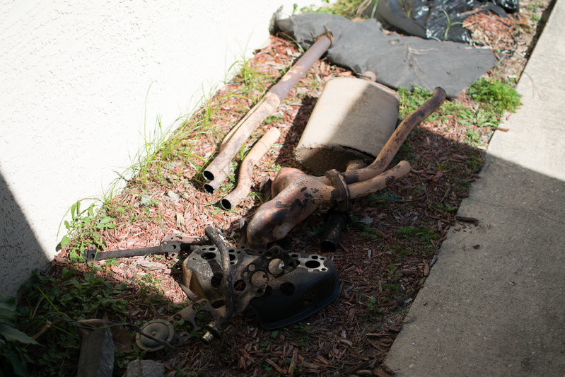

    little update, finally got all of the crappy exhaust out, not sure on how i feel about the sound of open headers lol. cant wait to get the new exhaust put in to see how it sounds. Pacesetter header and flowmaster super 10 muffler to be put in!

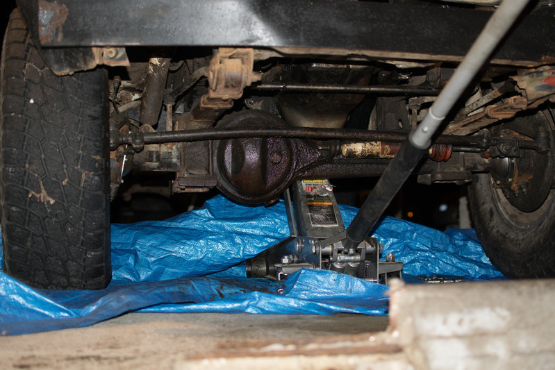

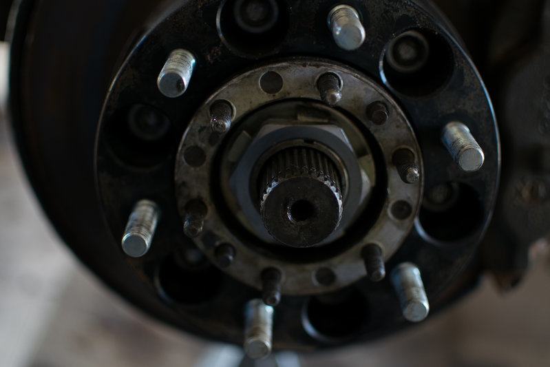

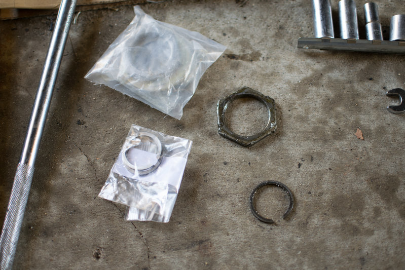

    got as much done today as I could before having to get ready for work. finally got around to completing the front end up with the new bearing nut/adjustment/and thrust washer kit from low range offroad. as you can see in the photo, there's only 1 adjustment nut and the snap ring, thats all that was on both sides; both sides also had their thrust washers. it is supposed to be thrust washer, adjustment nut, lock washer, and adjustment nut then snap ring. So the front end is finally sorted out, that 54mm socket is freaking huge lol. also changed the spark plugs finally. Not sure what the PO did.....but there were 2 different types of spark plugs in there, so they are all the same now lol. hopefully that fixes the missfire the engine sounded like it was having. If not, one of the valves may need adjusting, there was a pop that was going on while the engine idled. who knows lol, ill find out once the new exhaust is in place.
    Tomorrow I would very much like to get some 2.5" piping and get the new exhaust installed to the new muffler. Gonna redo the oilpan gasket with some FIPG I got from Toyota, then I need to mock up or something the new crossmember that needs to get fabbed up for the transmission.

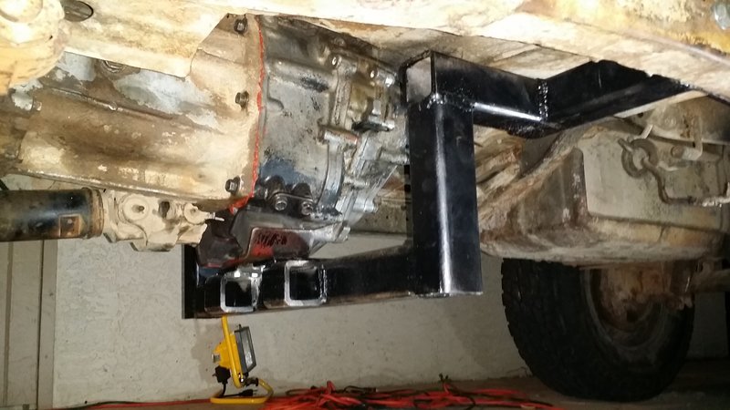

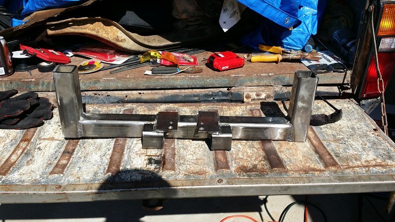

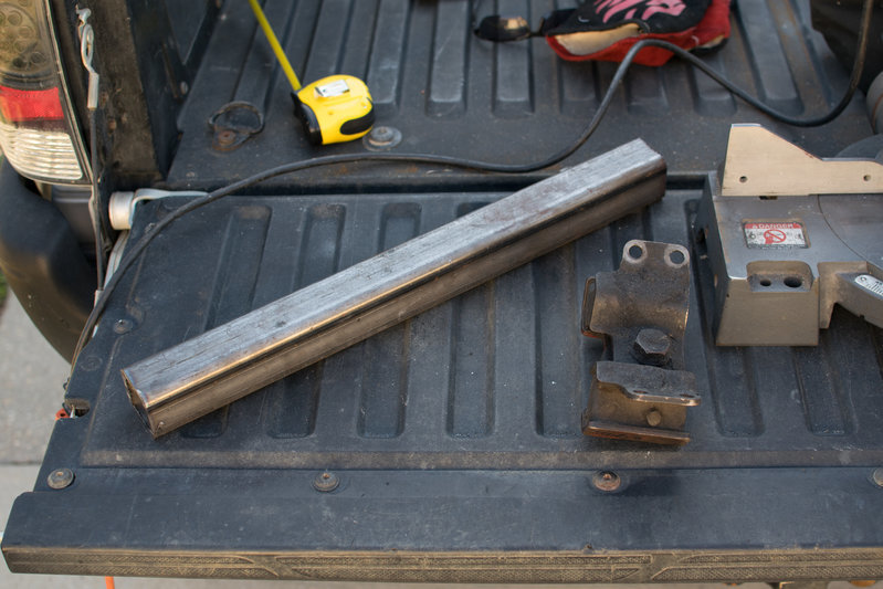

    cross beam welded up today! my first attempt didnt work, so this 2nd try work so much better. Tomorrow I should be able to get the rest of it cut and welded up and get the transmission bolted up and FINALLY be able to drive my Aleu! Also got all my electrical stuff in to fix my issue I was having with the ignition switch wiring frying itself. new alternator, ignition switch, voltage regulator, and just waiting on a 14 gauge fusible link to come in

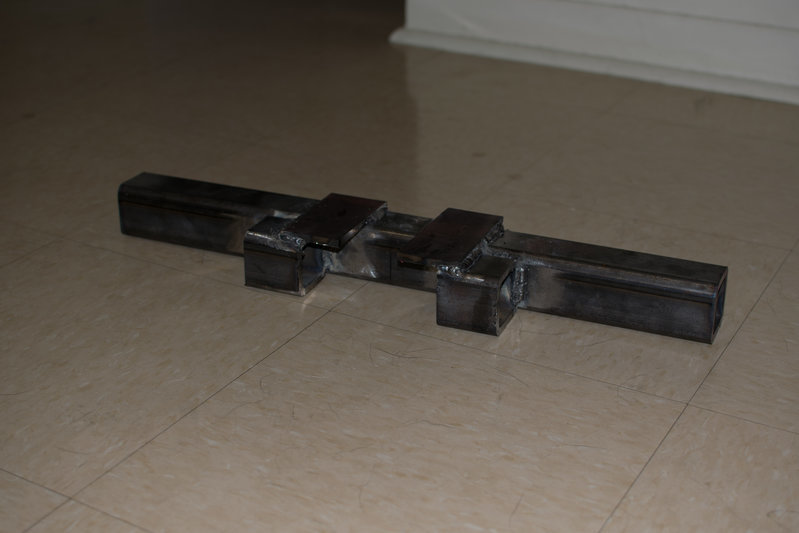

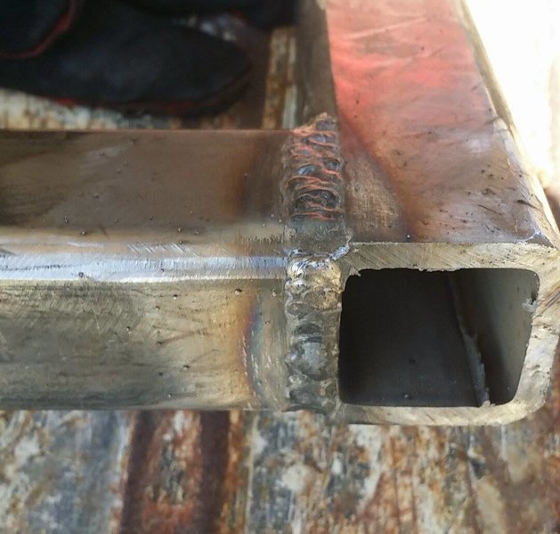

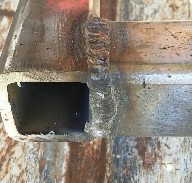

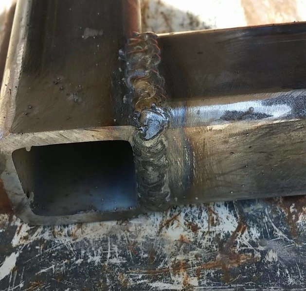

    next set of pieces are on the crossbeam! should be able to get my cross member done today! my welds are not the best....but for the 5th or so time welding, I dont think they are horrible lol

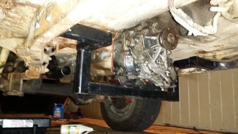

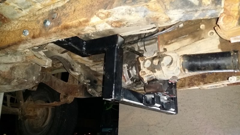

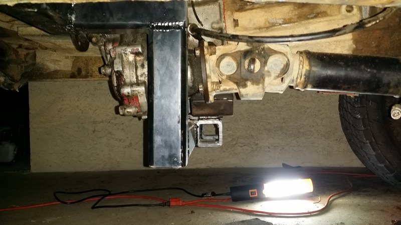

    Current crossmember progress

    Soooooo, the transmission is all bolted up and good to go......buuuuuuuut none of the gears engage....it's like something with the clutch or something isn't engaging properly. I think it may be because of the throwout bearing and clutch fork we reused from the last transmission. Bought a new throwout collar with clips and I have a proper clutch fork that should work. New slave cylinder will go in at the same time that is the correct one for the clutch fork

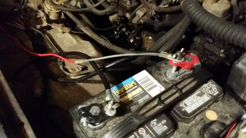

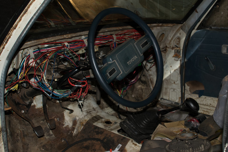

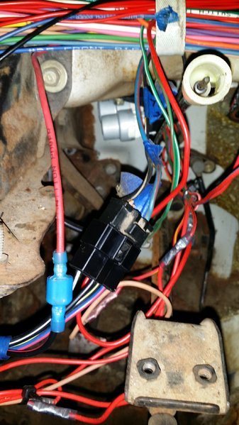

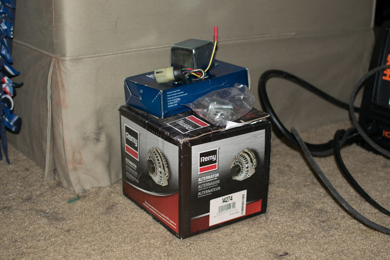

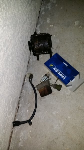

    Aleu is comin along! Got the new alternator, voltage regulator, both sides of the ignition switch (key and wires), installed a new horn, got my wiring fixed to where i have a 14 gauge fusible link going to 10 gauge wiring replacing the power wires for the fuse box and alternator. also got some other wiring routed better, just need to get gauges wired up, the rest of the wires electrical taped up, redo the oil pan gasket, drag link rebuild if i can get the damn thing off, get the rear driveshaft cut to fit the new trans, and then lastly flush both diffs.
    My new throwout bearing collar and clips will be in Tuesday so I'll be able to get the slave cylinder and new throwout bearing installed and that SHOULD fix the issue as to why she doesn't want to engage the clutch all the way

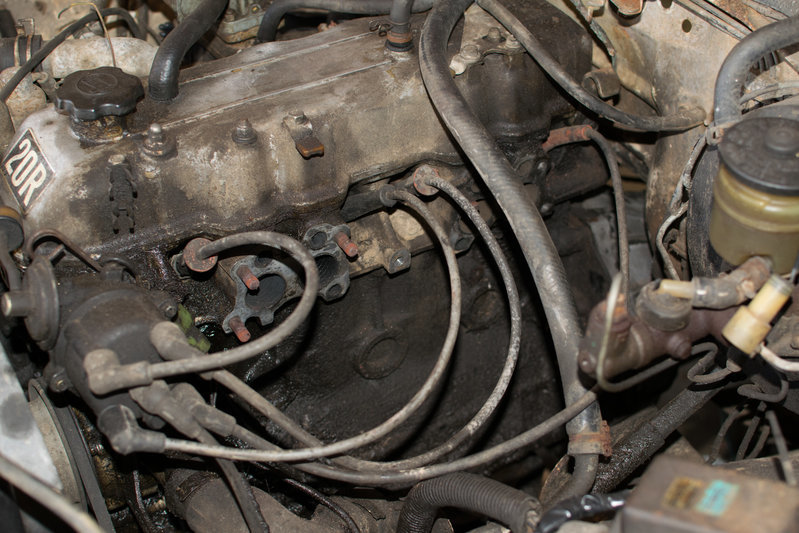

    got the oil pan cleaned up and the gasket redone, Ill have to see how it is tomorrow, saw some fluid on one of the bolts, but no sure if that was leftover fluid that made it's way down or what. but looks like everything is staying in like it's supposed to, I just tightened that one bolt and it SHOULD be good to go lol
