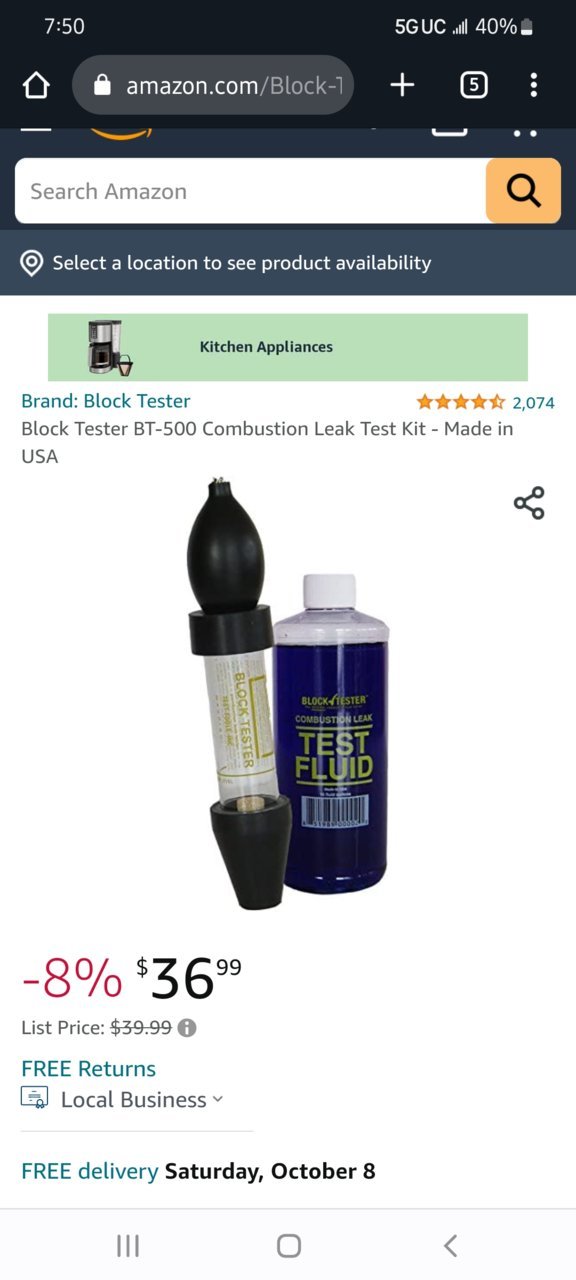

    Get your hands on a chemical block test kit

    Oh god don’t tell me that. :oops:
    I’ll test the block after the coolant change, maybe the engine wants coolant rather than plain water? What are the other signs of a blown head gasket? Everything other than the overheating seems normal, no loss of power and definitely no white smoke.

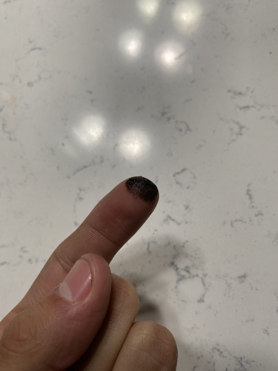

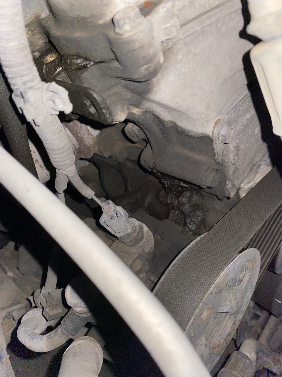

    What could this gunk be? Front right side of the engine.
    lynyrd3 and Taco critter like this.

    That's just oil seeping from timing cover and valve cover gasket

    Tastes like dirt, can’t taste any coolant.

    Normal?
